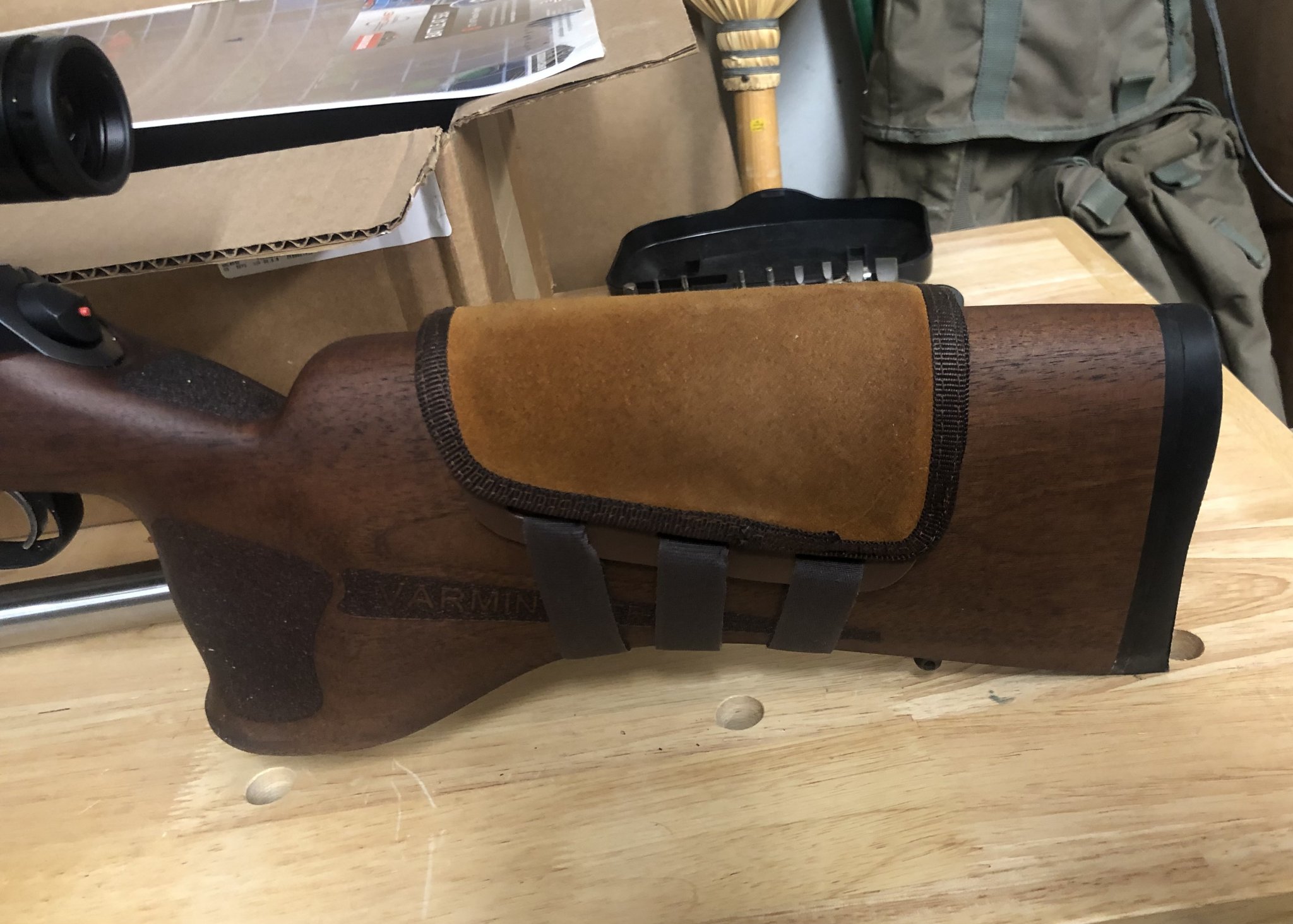

The ITC leather riser pads work really good too, especially since it’s easily removable off on a wood stock. A number of different very affordable models. I’m using the suede one on my CZ and it works great. It actually looks better than this on the rifle.

Also have an ITC. Couldn`t get a decent cheek weld on my Savage 93R17 17HMR. The ITC pad has me looking right down the scope with a good weld. I recommend.

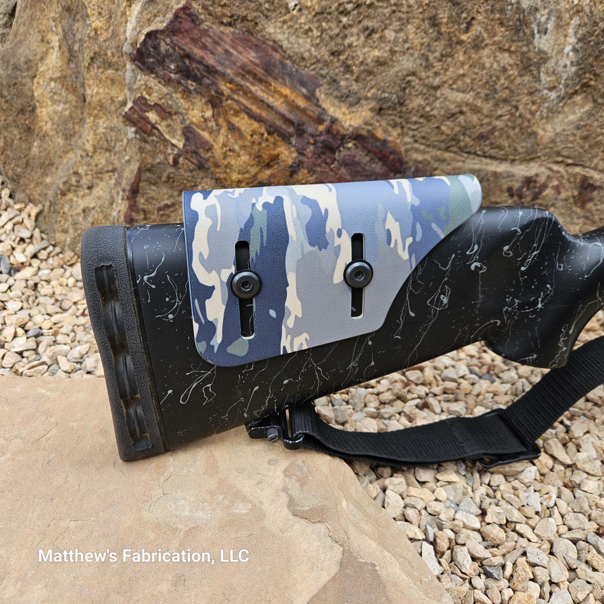

I made my own from a sheet of 0.125" Kydex. Cheap and simple, and it worked great. I heated it in the oven and then draped it over the stock. I drilled holes through the stock and just bolted it on with carriage bolts and wing nuts.

Have you make it adjustable? or just holes for the bolts, do you have a photo maybe?
