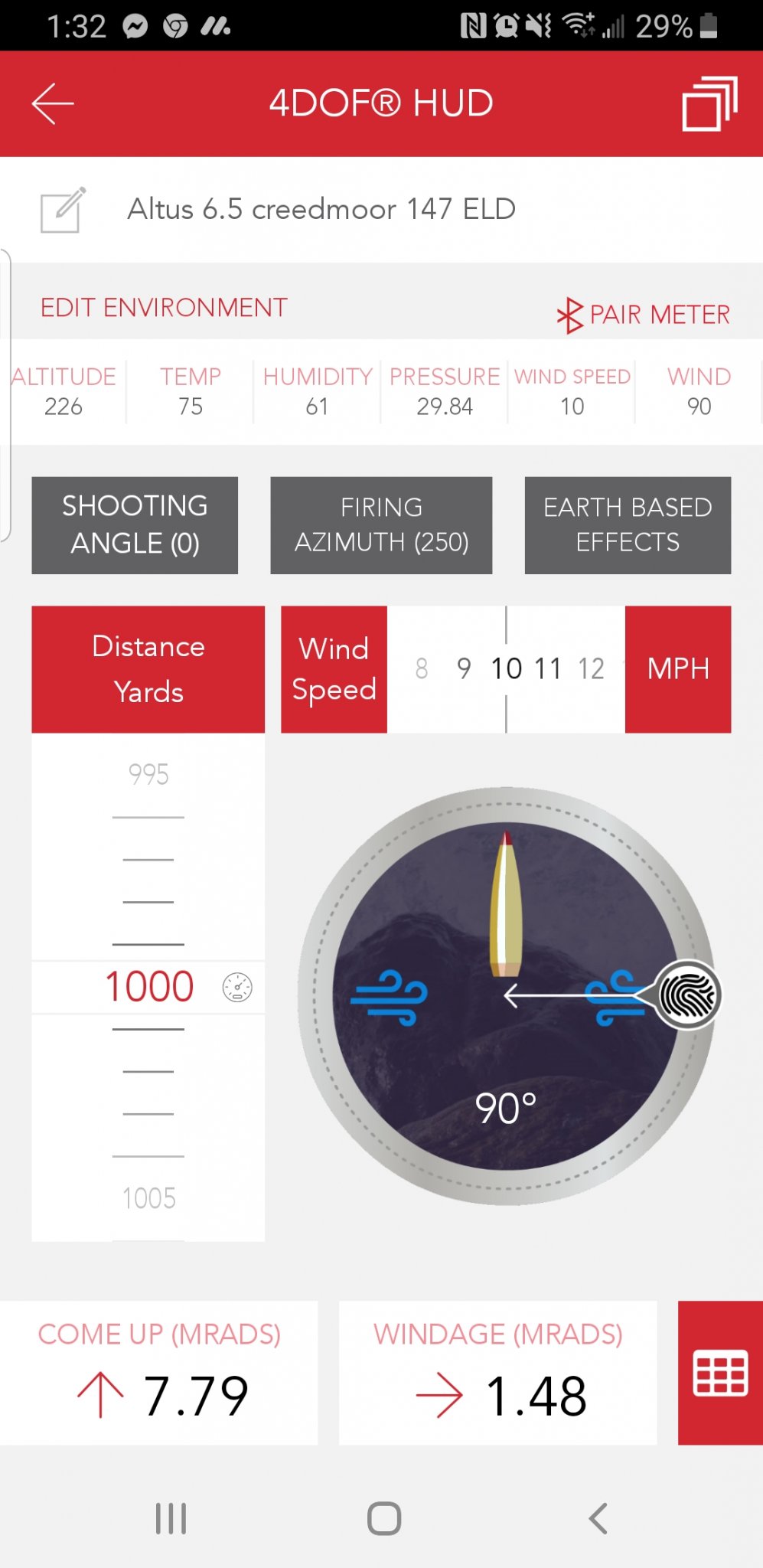

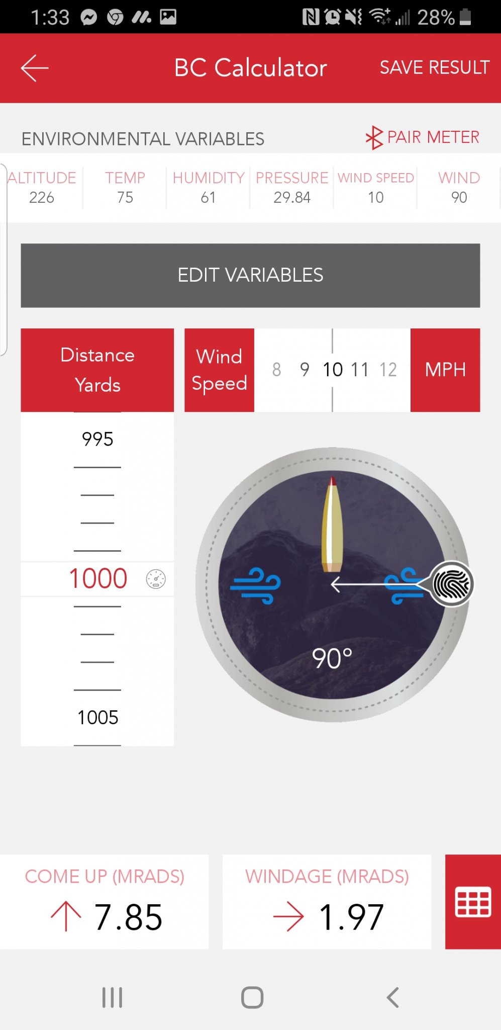

I have shot a ton of the 123 scenars. Several thousand anyway. .264 G7 @ 2950 (I couldnt push them a lot faster accurately), and plenty of 147s @ 2770, well over 3000 of them. The difference is huge at 1000, and even very noticeable at 500. I'll agree picking a bullet for the average target is the best idea, and that if wind isn't present or is at least consistent it isnt much of a factor, but if you are dealing with ranges that have swirling or winds that change/fishtail a lot, then BC is an advantage. Attached is a 147 vs 123.
Also, the little 6mm / 105 H out performs the 6.5 creed / 123 with much less recoil. .285 G7 @ 3000 fps (in my gun) vs .264 @ 2950 (in my gun as well). If the wind is steady or calm it doesnt make a difference, but if it gets switchy I'd rather take the one with better ballistics.

No argument, just a bit more food for thought for thoughts dropping in on this thread, how this relates to positional shooting and why it is so important to understand the complete picture. (because the OP specifically mentioned PRS).
Wind in perspective:
1,000 yards, 10 mph 90° wind at 29.9inHg (most of use don't shoot on the beach so that makes a bit of difference.). Using the much slower 123 number of 2950 and the bit faster of the 147 @ 2750 than "I" am getting for the example, to make the wind difference between the bullets appear greater.
147 = 1.8R​
123 = 2.2R​
The 10 mph wind difference looks scary at 1000 yards.. seems like a no brainer, but is it?
Really what is happening, is that we know what our hold is, what we don't know is the winds uncertainty, so the correct way to look at this is not how we typically communicate when looking at the charts. The difference really isn't .4mil, but rather the difference in the wind uncertainty for each. For instance lets stay the wind is bouncing between 10 and 12 mph.
1,000 yards, 12 mph 90° wind​
147 = 2.1R a .3 mil uncertainly​
123 = 2.6R a .4 mil uncertainty​
The difference between these is only .1mil uncertainly at 1000y - less at the average PRS distances
(yes we can start making all kinds of cases, but my hope here is that it turns on a light for someone. Sure we can increase the wind uncertainly, but also, remember in my personal case where I am actually generating 150fps greater speed difference..)
