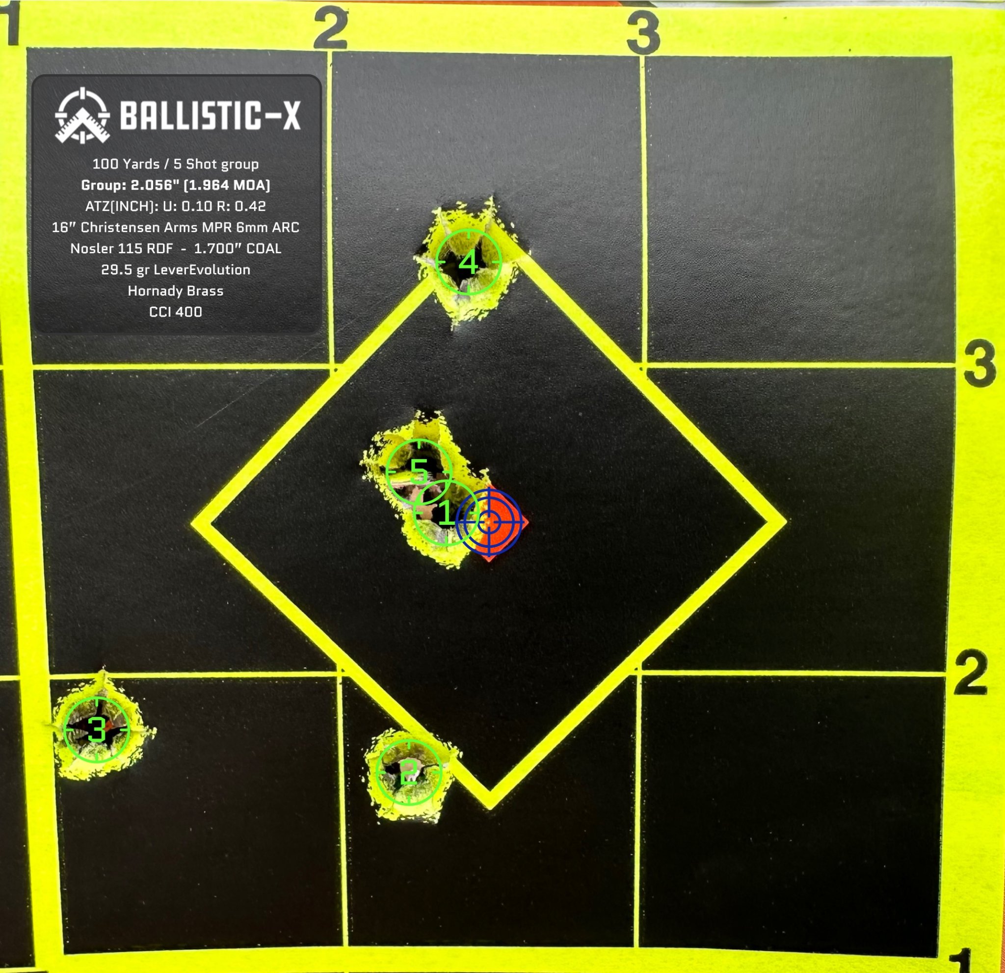

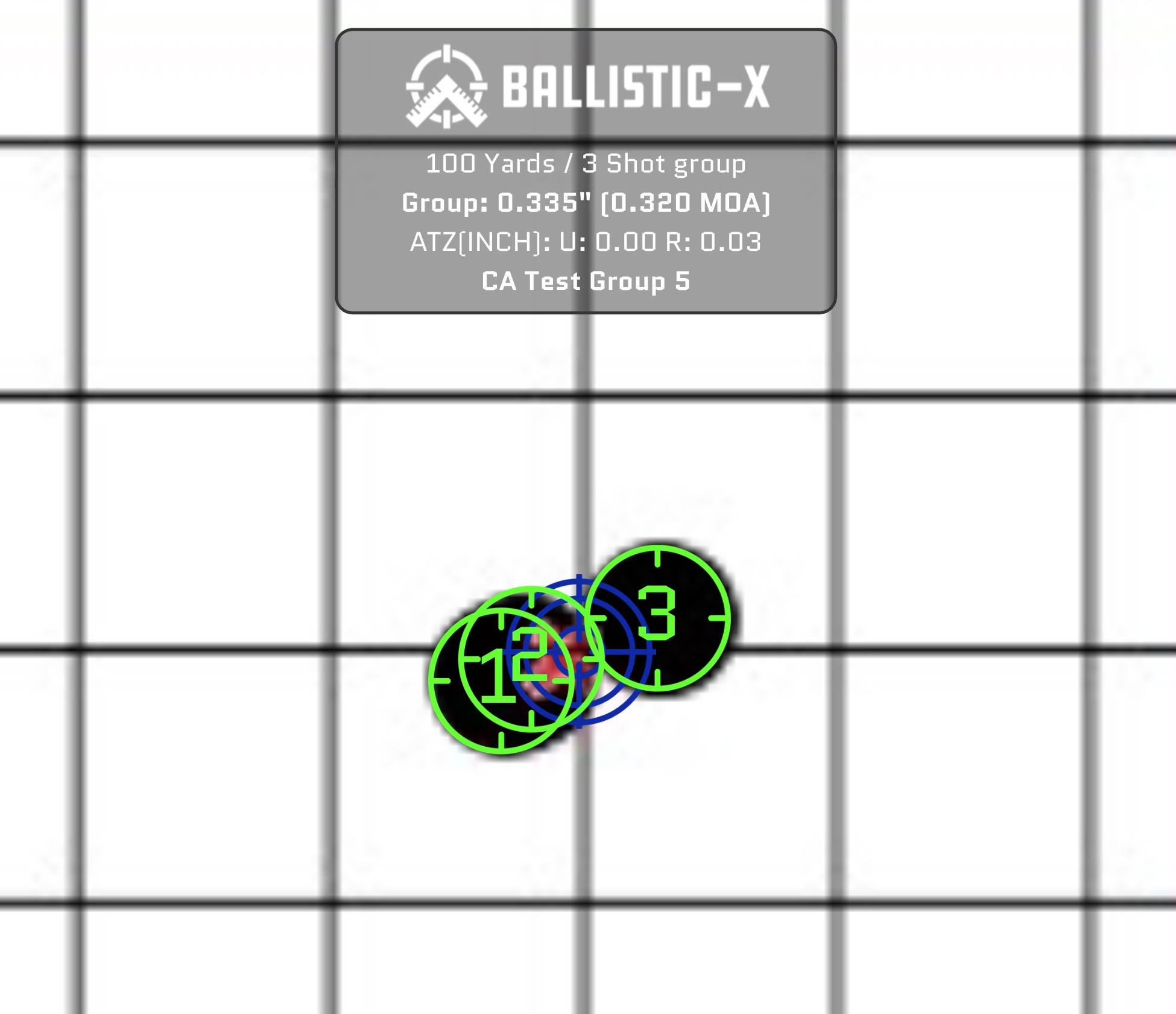

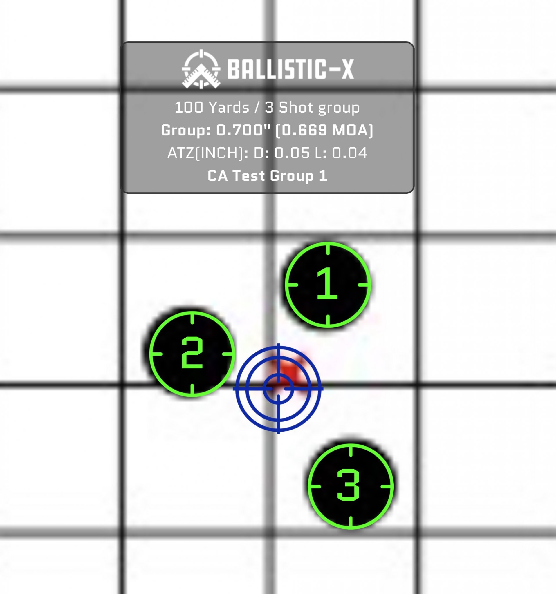

I'm not far from sending my 16" MPR 6mm ARC back to CA for a brand new barrel... I'm tired of chasing this fucking rabbit. I've NEVER had a rifle give me fits like this. I've put over 350 rounds down this barrel, and it's still not settled, and shooting worth a shit. I've pulled the whole rifle and chassis apart, cleaned everything, and properly re-torqued everything to CA specs. And scrubbed the barrel down to the white and dry patched it after each range session. And it still only puts down ONE good group every range session...And it's always the very first cold-bore group. After that, it's like a shotgun... Not impressed.

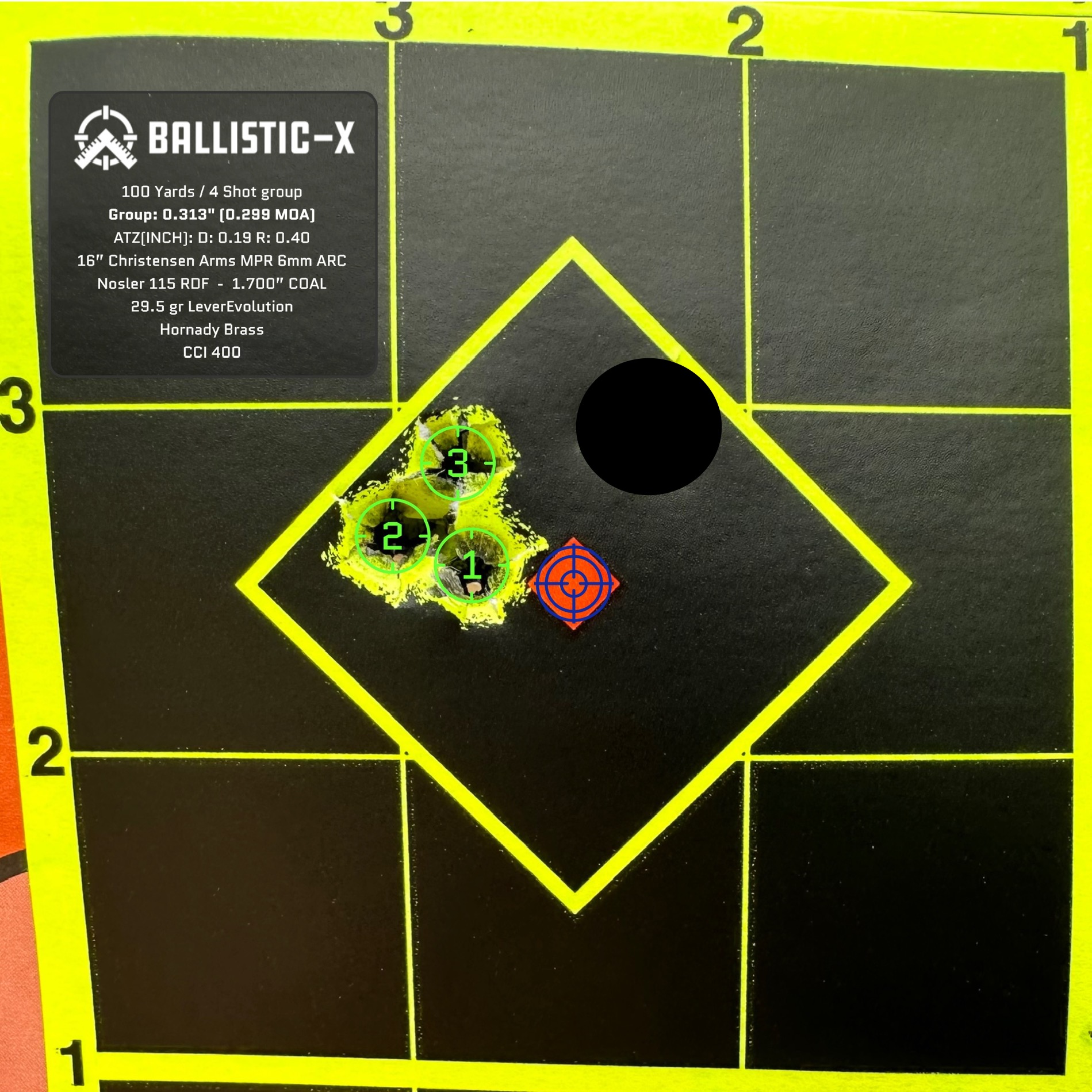

Here's the ones from today. I only shot it twice, before getting pissed and putting it back in the truck. 🤬
First group (excluding flier where I pulled the shot)...
Ballistic-X-Export-2023-05-29 18:28:20.837162.jpeg
Second group after letting it cool completely down...Nothing changed on the gun, scope, or ammo...
Ballistic-X-Export-2023-05-29 18:31:30.040807.jpg
Not what I would have expected I certainly hope you get it sorted out. Please keep us informed of the outcome

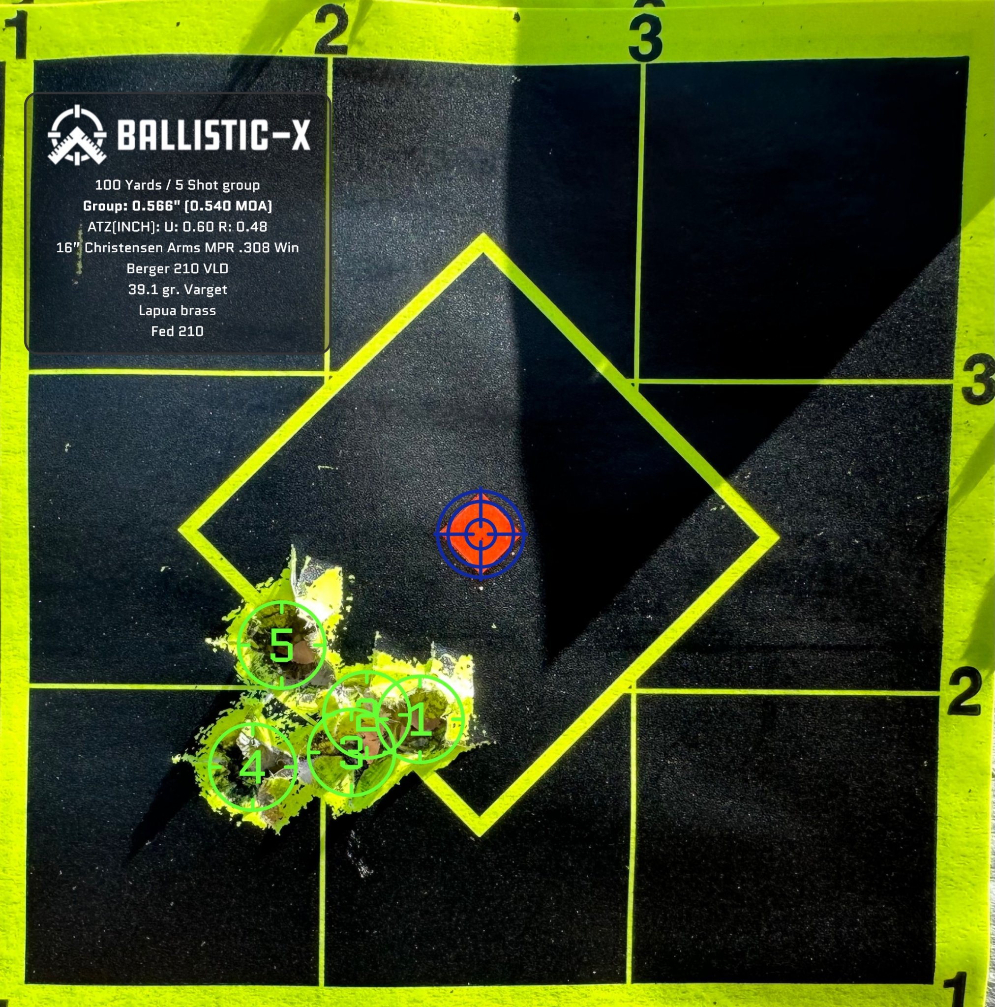

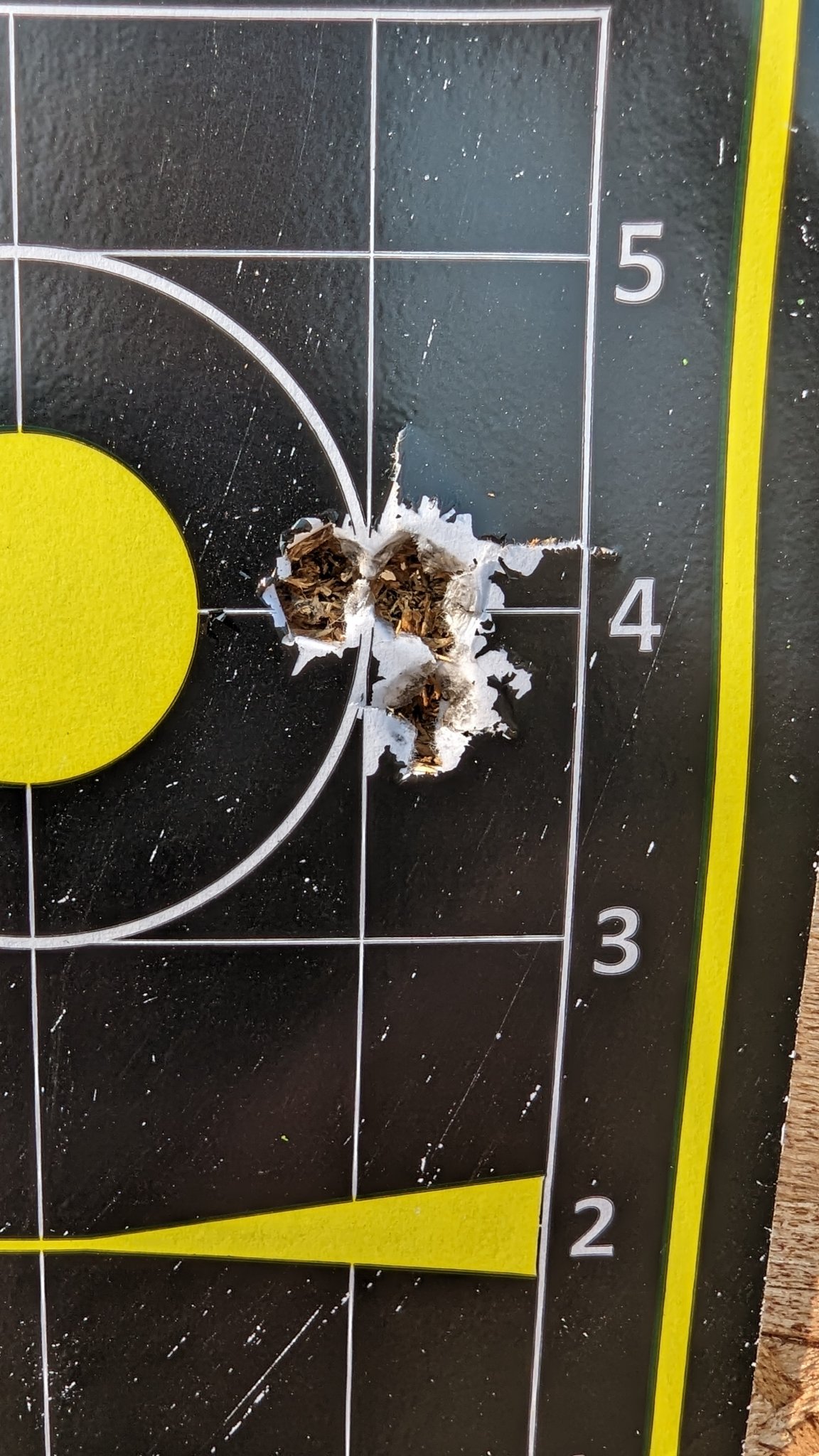

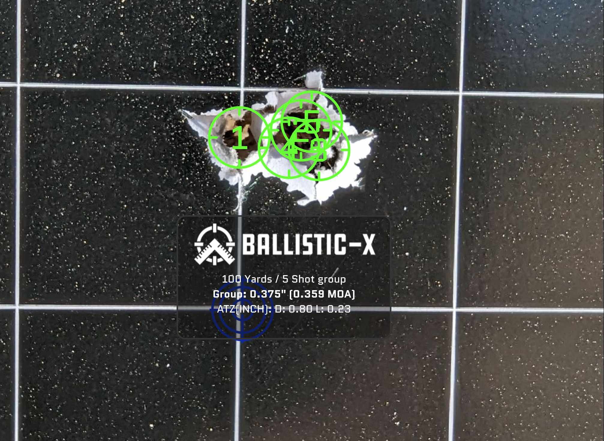

Just realized I never posted a pic of the group my 16” MPR .308 Win put down during the first day of testing. This was a random load I threw together over 10 years ago based out of the Berger manual. I loaded up 100 of them in brand new Lapua brass, and only ever shot 50 of them over the years, because back then, it was during the Obama ban era, and everything, especially heavy Berger bullets (210-215), were nearly impossible to find, so I conserved them, even though my 5R .308 absolutely loved them. So, I figured my new MPR being a 1:10 should love them. And it definitely does. Shot pretty damn good with my new TBAC Magnus-HUB on there. 😏
Ballistic-X-Export-2023-04-30 15:54:56.390625.jpg
Reactions: ArmedGinger

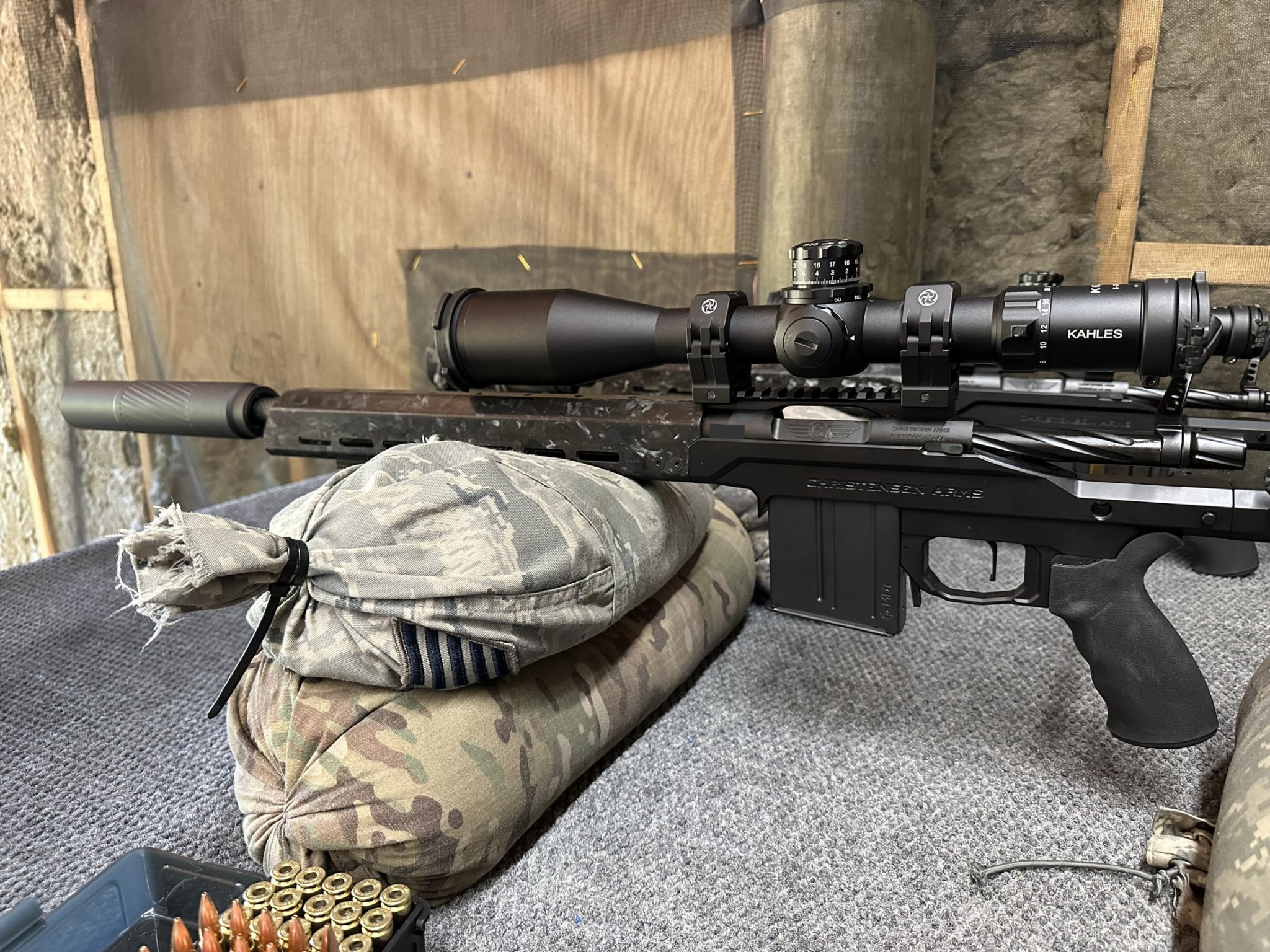

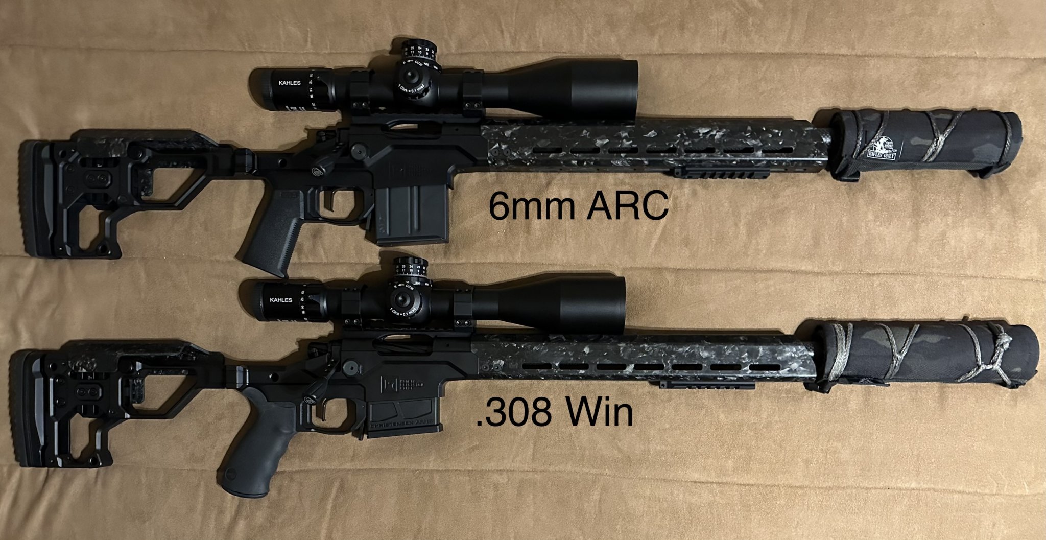

Meet the twins…
16” 6mm ARC (top) / 16” .308 Win (bottom)
With matching new Kahles K624i CCW RSW SKMR4 scopes in Seekins Precision 1.00” high rings. They just barely clear the handguard, but 1.00” rings are G-2-G on the MPR with a factory 20MOA rail, and 56mm objective.
If anyone is wondering, that is my Otter Creek Labs Hydrogen-S 7.62 on the 6mm ARC, and my Dead Air Nomad-LT on the .308 Win. Both cans are running an Otter Creek Labs ZR0-DTA direct-thread mount. The fit is superb. 👌🏼 And they sound just as quiet as they look. 🤫
Zeiss Mid 1.125 rings, Blackhound 4-32 x56, with sunshade on the front I barely see daylight underneath. Could fit 2, maybe 3 sheets of paper. I call that success! LOL

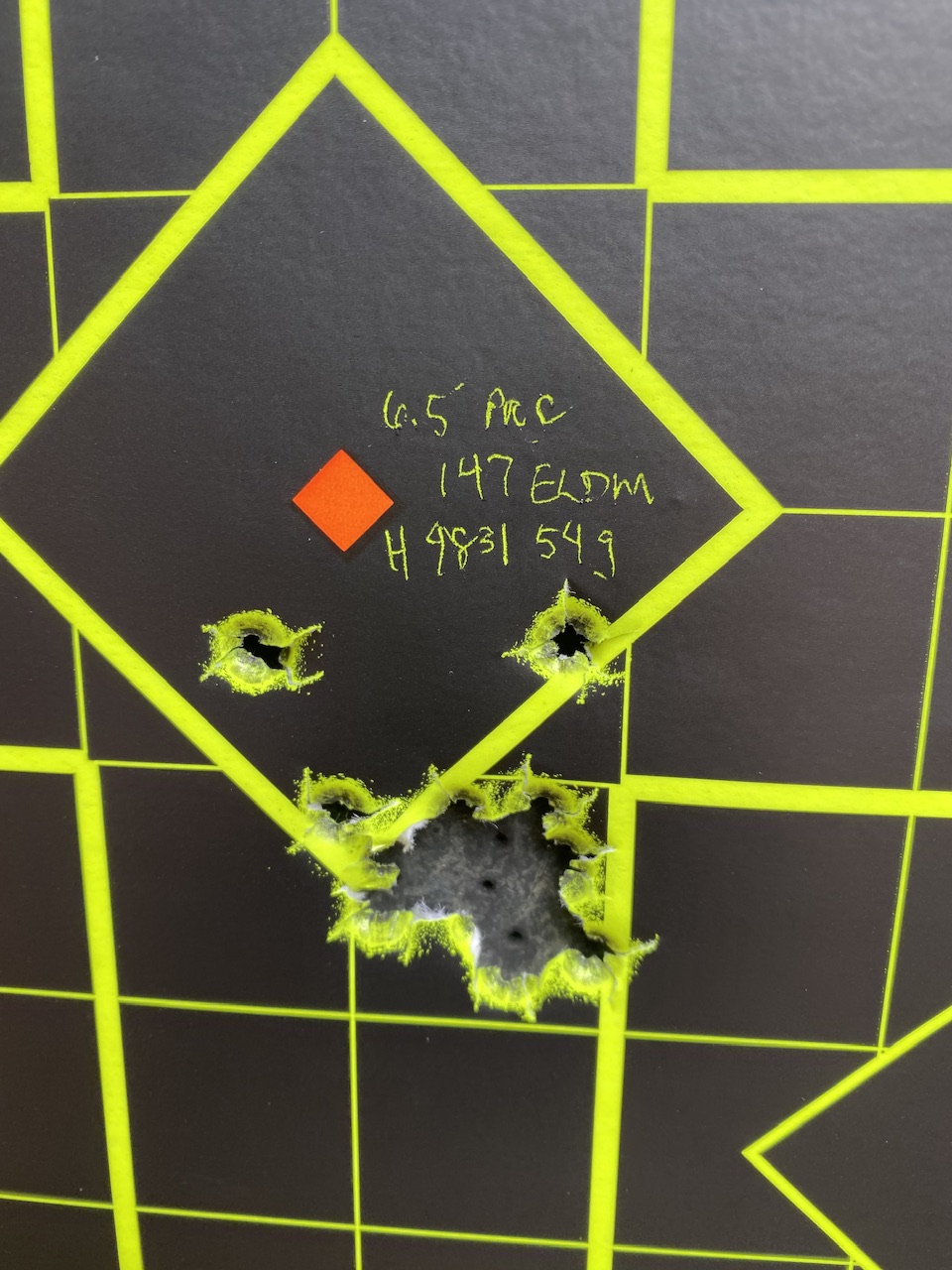

Here's the results from my last range trip with my 6.5 MPR ( 5 shot groups all at 100yds). I think this photo shows the importance of experimenting with different loads. The federal load was a big disappointment. I was really hoping to use these as a hunting round, but with this kind of accuracy at 100 I can't trust it. The Hornady match is kind of the "go-to" factory load, but I wasn't exactly happy with the results. The Nosler showed promise in some earlier tests. It would shoot 3 touching and then I'd get a flier. Ignore the first shot at the top of the target, I forgot to reset my turret from a 300yd hold. The Berger's are where I finally saw what this rifle is capable of.

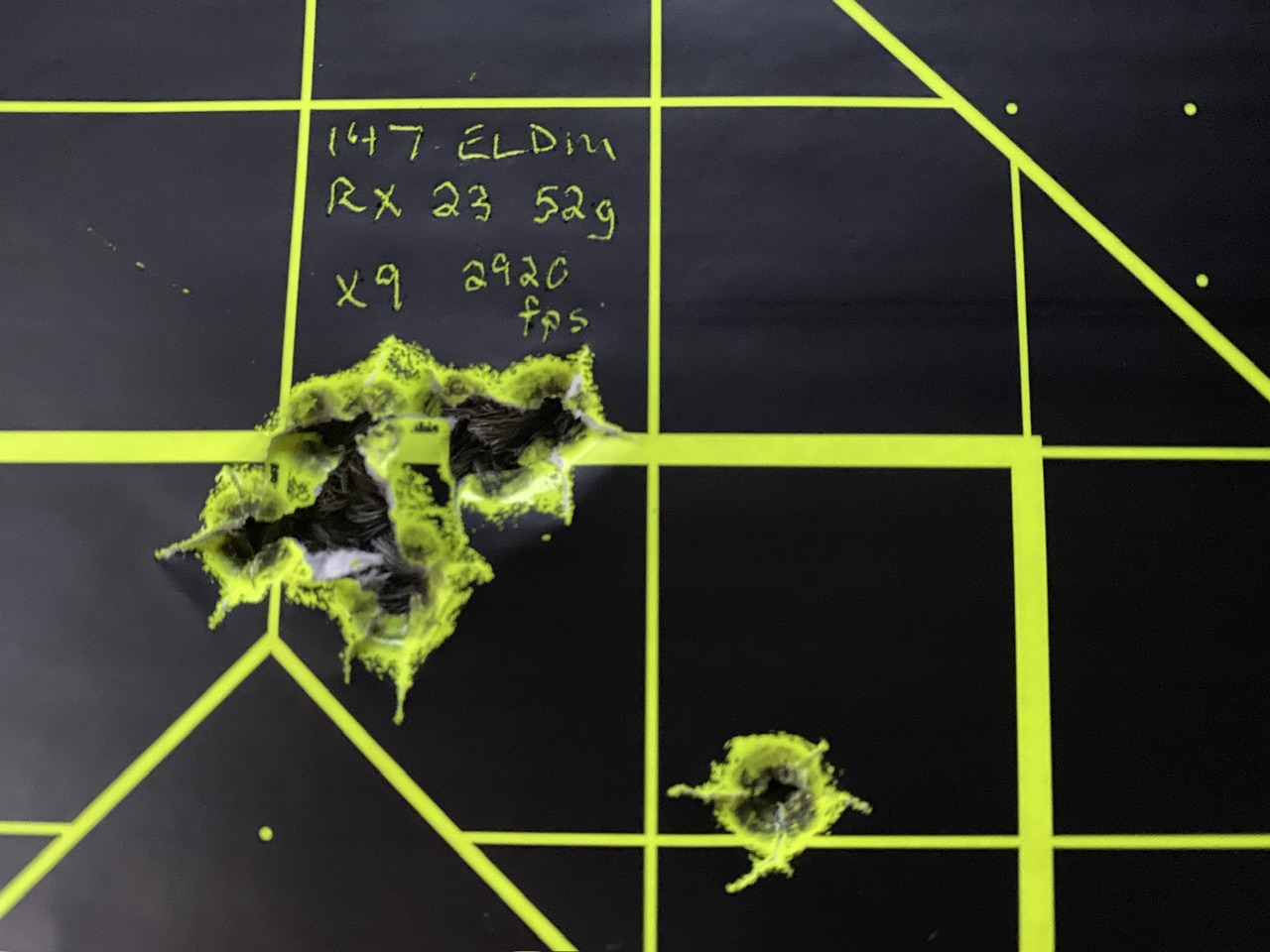

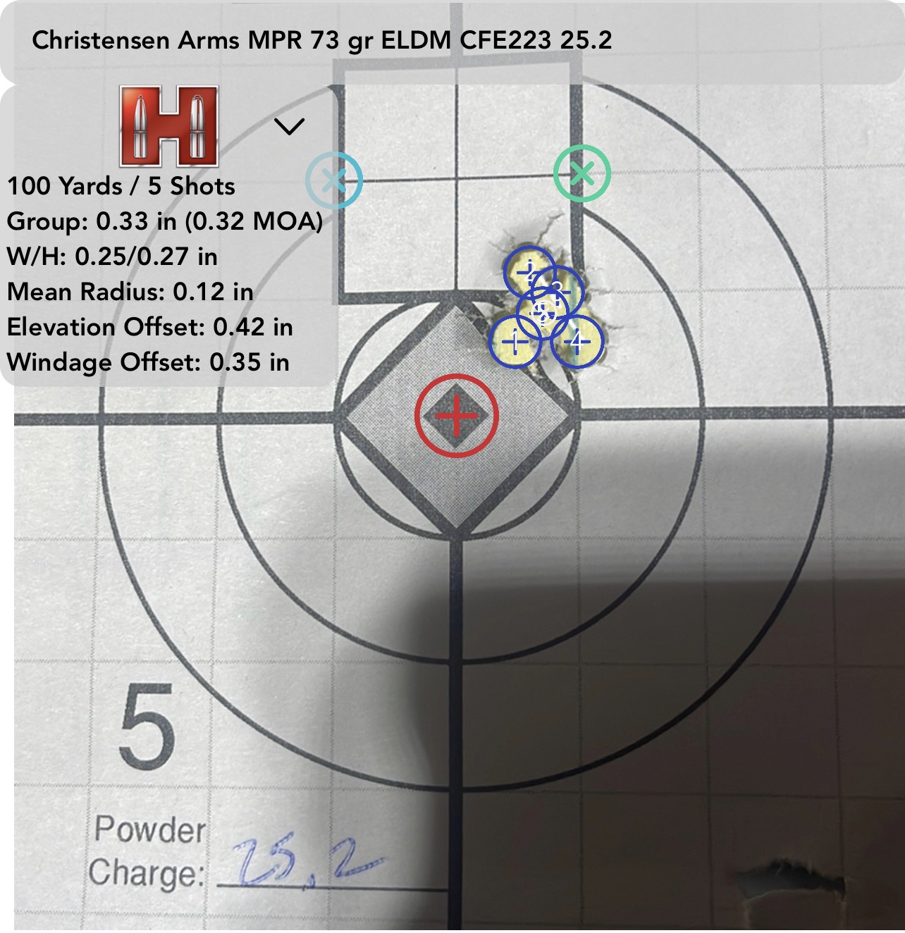

I picked up an MPR in 223 Remington, it has the steel barrel. After a quick clean I put on SilencerCo ASR mount and the Omega 300 and took it out to the farm for a few shots to get some brass to start a load workup.
I shot some Remington 55 gr SP that I had that shoots very well in my all of my AR setups. 5 shot groups of 2"+. I chalked that up to it being late in the day and the lighter bullet in the 1-8 twist barrel. Although I'm not a professional shooter by any stretch, off of bags and a good shooting rifle I can get nearly all of my guns sub MOA.
I put together a ladder test with Horn 75 grain ELDm with some info I found starting at 24 grains and working up at .3 grains. The groups were terrible, best one was maybe 3". I stopped at 25.3 cause I was getting some pierced primers.
I went home did some more reading and decided I was going to put together a couple of ladder tests with RL15 and Staball Match.
I have the Labradar info for each one of these as well. The Staball Match was producing some SD's that were right around 10 and even a 6.9SD with a 17ES at 24.3 grains.

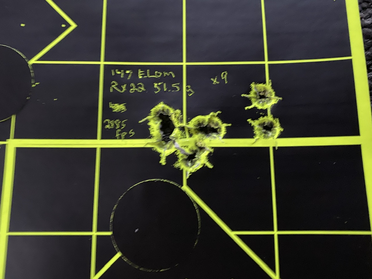

I finally got a chance to shoot my CA MPR in 338 Lapua. I brought five boxes of different ammunition with. The range only has 100 yards but the best 5 shot groups came from RUAG Swiss-P 250gr HPBT and 247gr Styx Action Hyper Expanding Hollow Point. 3-different 3-shot groups were under 1/2”. All other factory ammunition shot greater than 1” groups and one of them couldn’t do better than 2”.

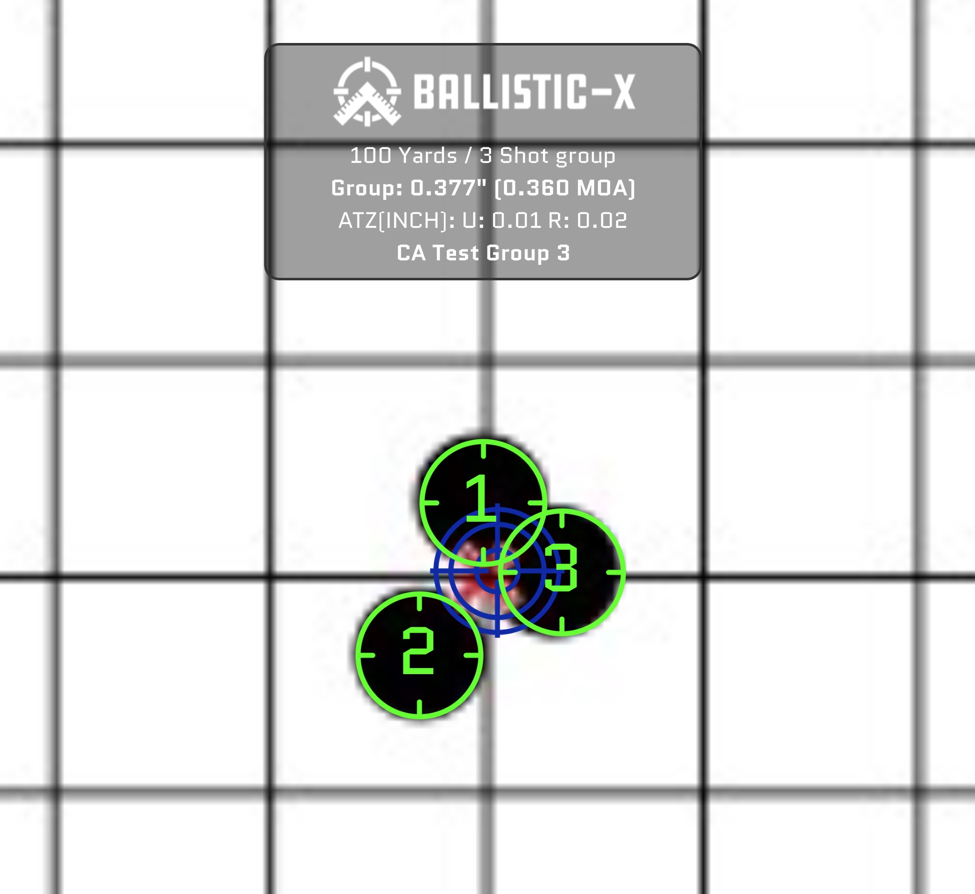

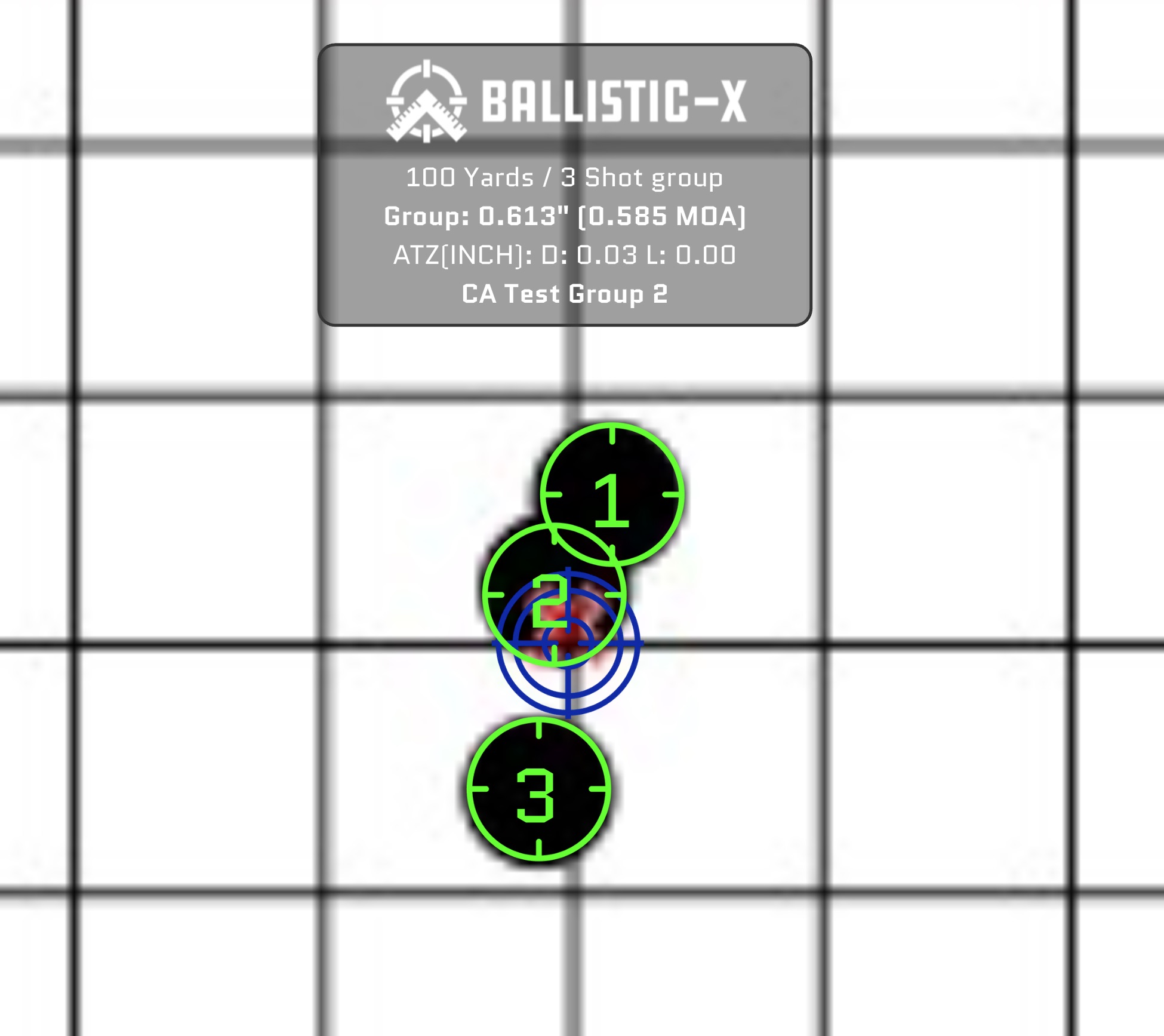

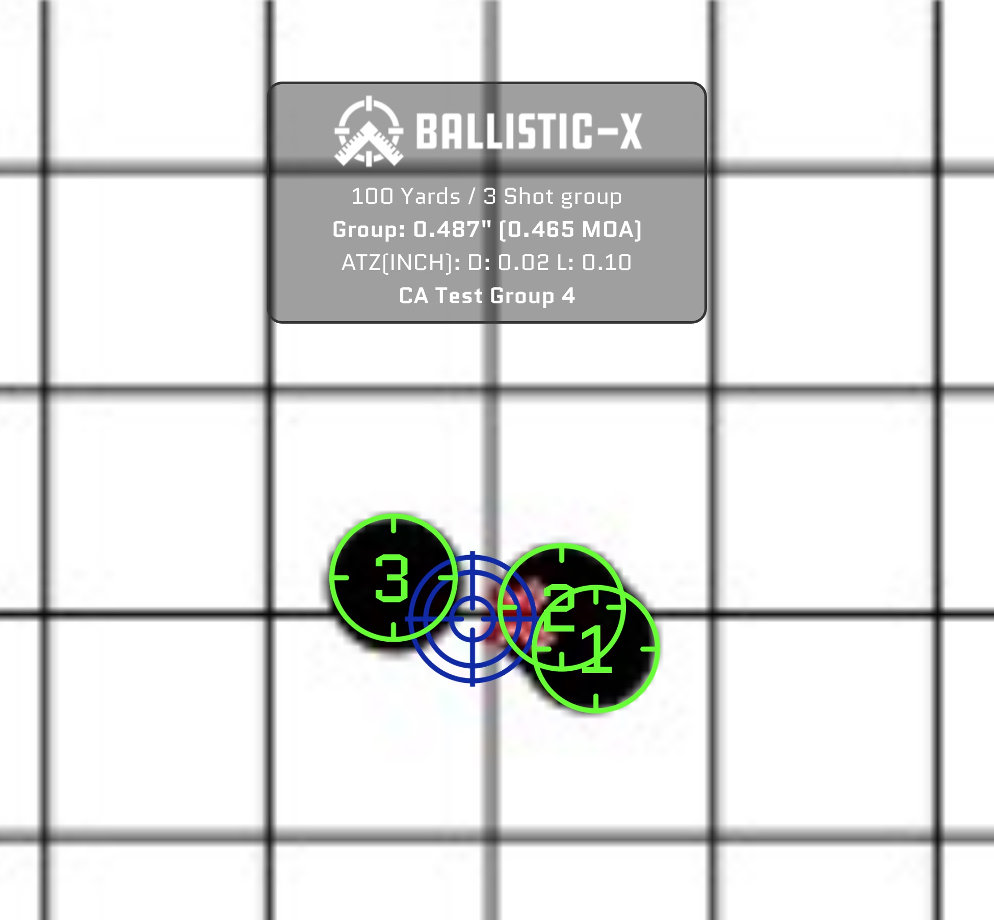

Just got this from CA and thought I should share, they received the rifle Tuesday 7-18 and in less than a week here is their response:
@christensenarms I must say that I am very impressed and can't wait to get it back in my hands
"I'm excited to inform you that your firearm is ready to be returned to you! Your RMA service has been completed and your firearm is being processed for return.
Our top gunsmiths have performed a full detailed inspection, and carefully completed the following services on your firearm:
Installed New Barrel, Installed New Slayer Brake
Aligned Hand Guard, Checked Headspace (Headspace is correct), Engraved Barrel, Test Fired for Accuracy'
They cleaned and performed a final inspection of your rifle and your firearm has been test-fired for function and accuracy. I've attached, for your reference, a picture of the target used in the final firing test.
They used the following ammunition in their testing: Federal Gold medal Sierra Match King 168gr BTHP"

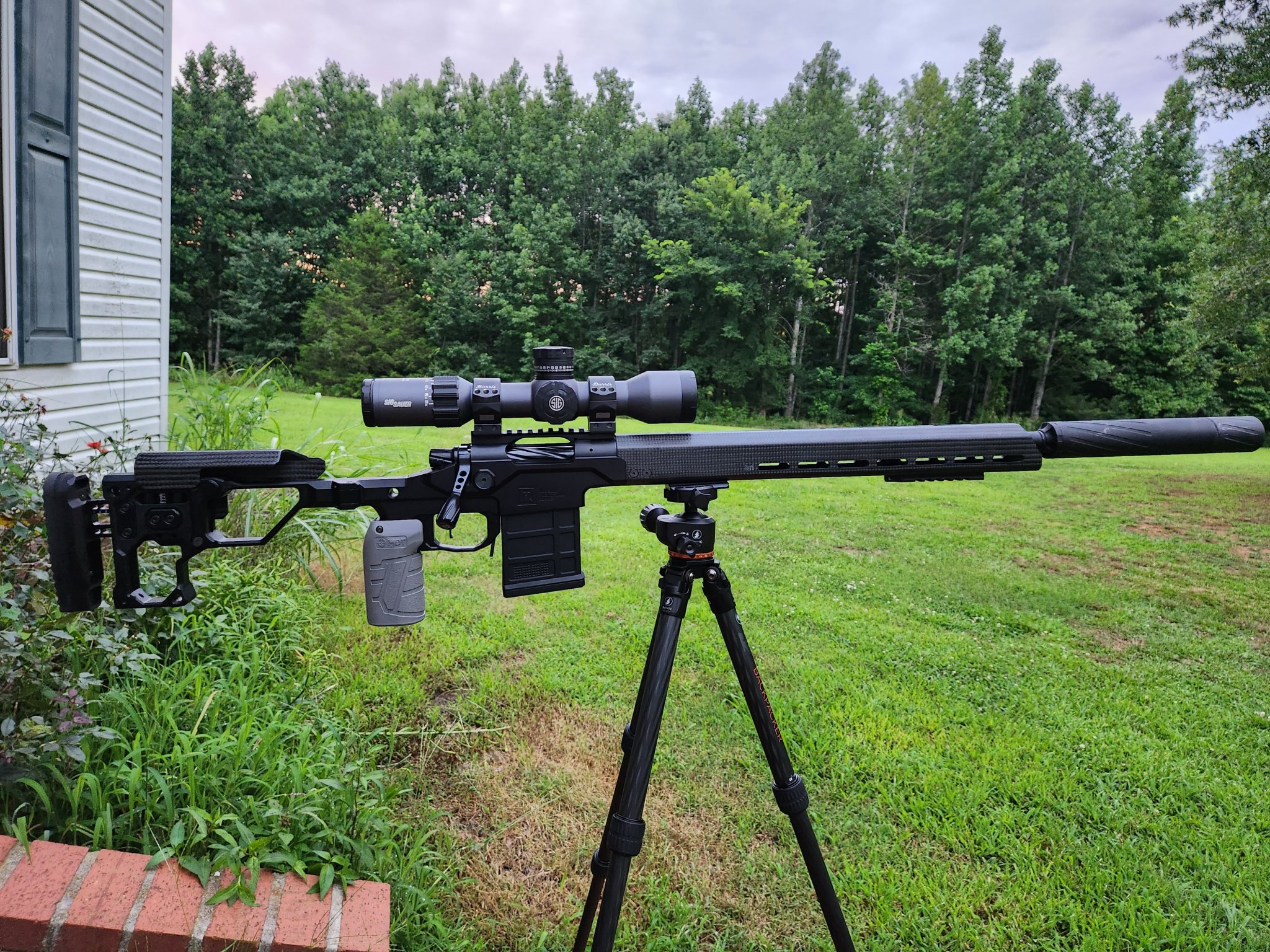

Took my 6.5cm MPR and had the barrel cut down to 18". The suppressor threads up to within a half inch of the end of the handguard. I've got to take the extension off of the suppressor and shorten the whole thing a couple inches. It's going to be a sweet deer/bear/coyote rifle..

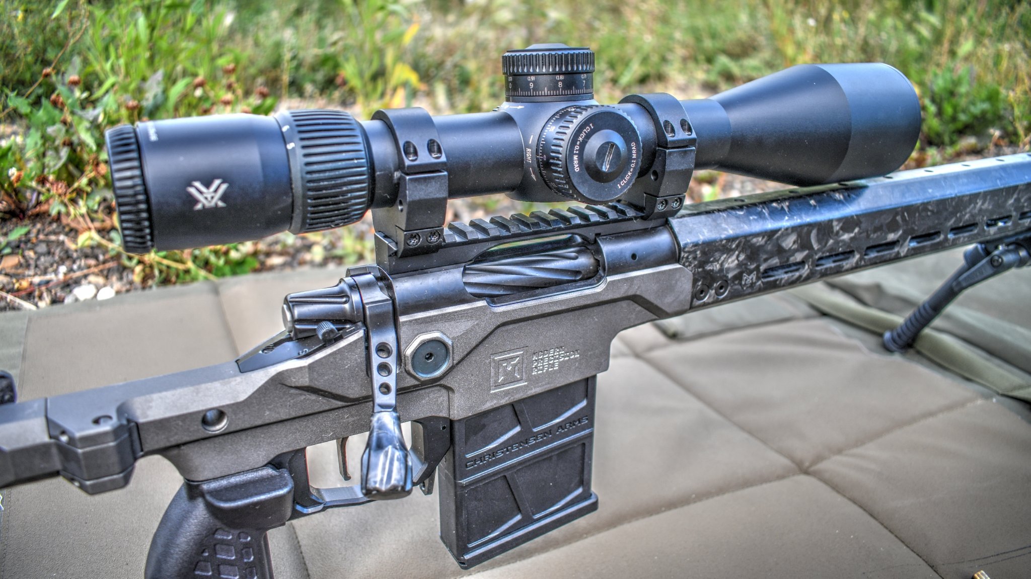

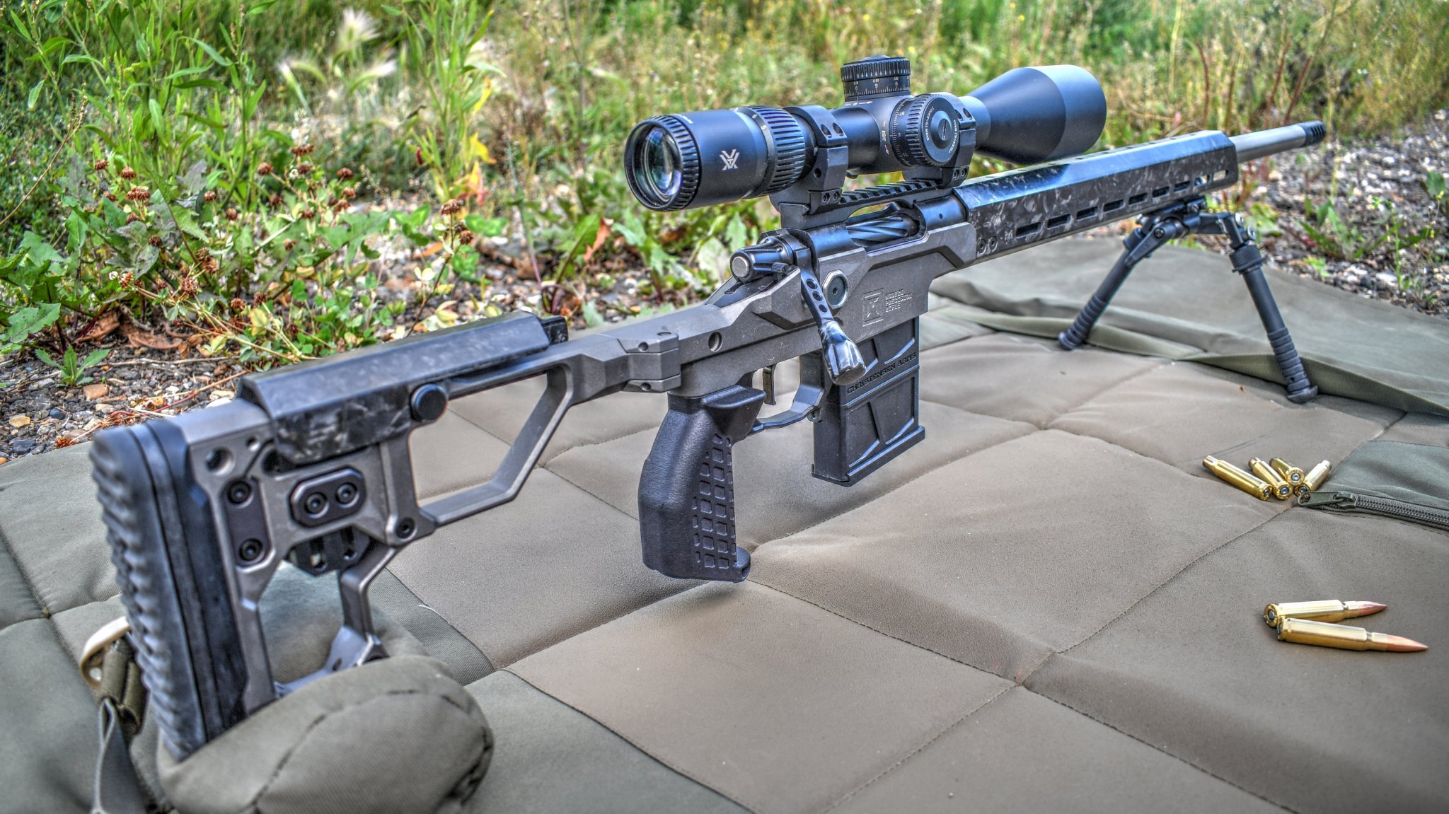

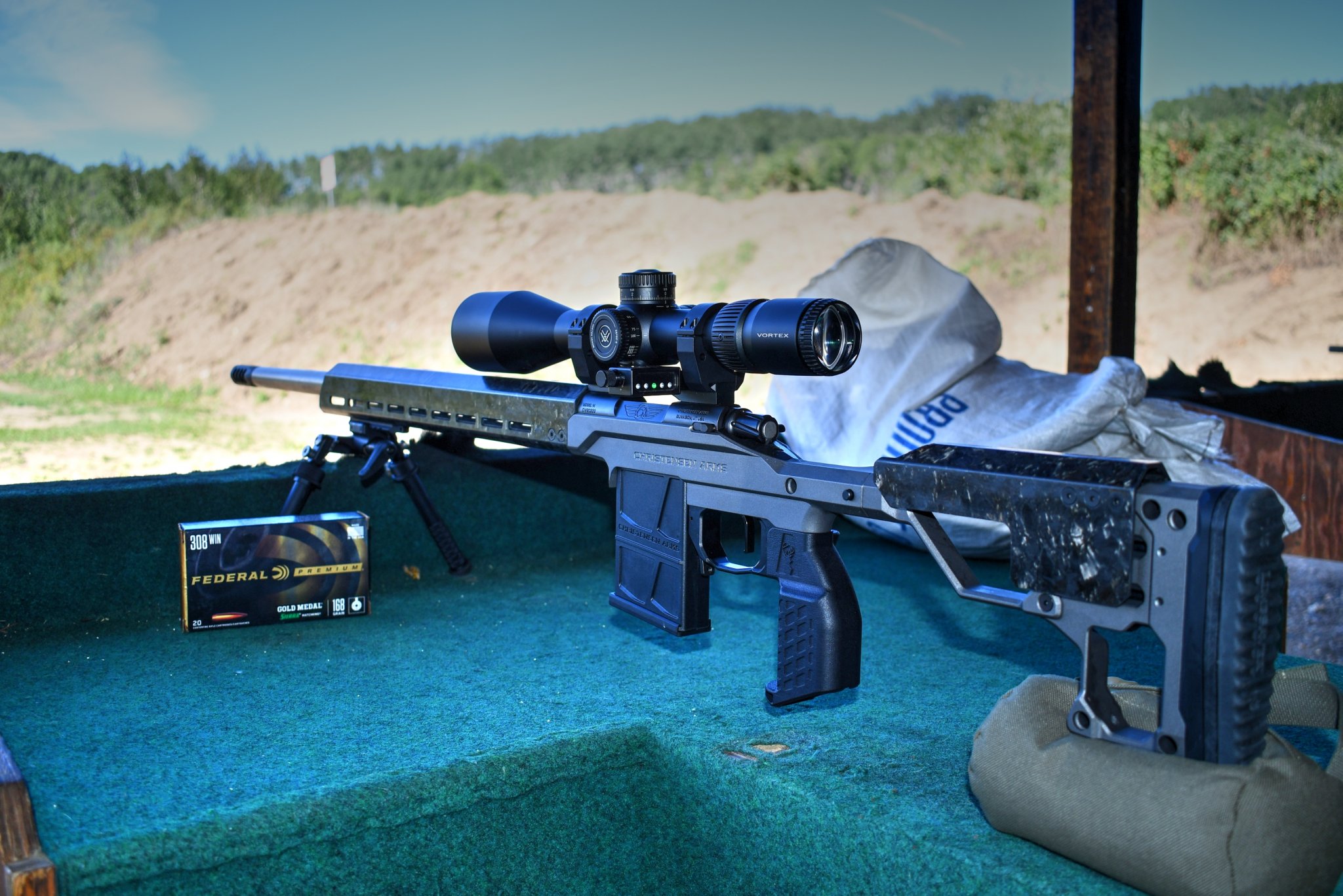

*Christensen Arms has NOT endorsed this review in any fashion! This will be an honest review as I see the rifle*
This is the Christensen Arms MPR Competition rifle. This rifle differs from the regular MPR on a few different levels. Whereas the regular MPR comes with a Triggertech Primary PVD Flat trigger, the Comp model comes standard with their Special class with the PVD Flat trigger. The other changes are the bolt knob, which on the Comp model is carbon fibre like their FFT line of rifles whereas the MPR comes standard with the steel tactical bolt knob. The biggest differences though are the AR style pistol grip and the barrel. The pistol grip on the regular MPR was just a standard AR style grip which I found to be way too skinny for my hands and swapped out immediately on my rifle for an MDT Pistol Grip Elite, sort of an ERGO knock off. The grip on the Comp model though is an Anarchy Outdoors Tuxedo grip, which is more vertical and has a really nice thumb shelf. Finally the biggest change is the barrel. The regular MPR came with either a carbon fibre wrapped barrel of various lengths per calibre or a steel Medium Palma weight barrel. On the Comp model though they are fooling around. Christensen Arms calls this a Target Weight barrel. It's akin to an M24 contour barrel, this thing is large! Further more it only comes in one length no matter the calibre, 26". Finally to top it all off, the Comp model is only available in one colour, Tungsten, for the chassis and plain stainless for the barrel.
The rifle here is one chambered in .308 Win. Other chambers on the Comp model include 223, 6mm GT, 6mm ARC, 6mm CRD, 6.5 CRD, and 6.5 PRC.
I've topped the rifle with a simple Vortex Venom 5-25x56 for the upcoming tests that will hopefully be done tomorrow. I'll update this review as I test the rifle.
For now enjoy some pictures of the rifle.
Reactions: christensenarms
