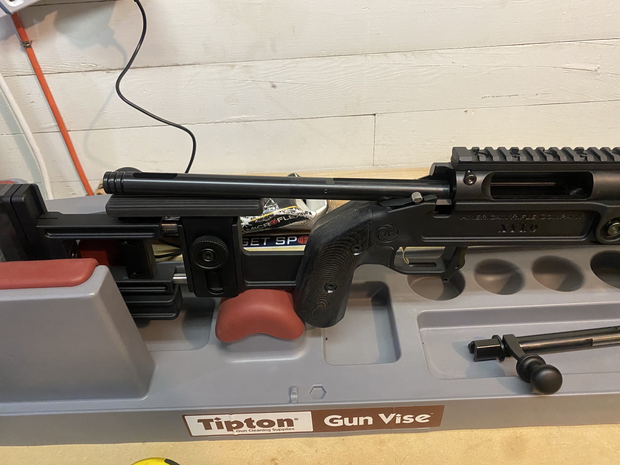

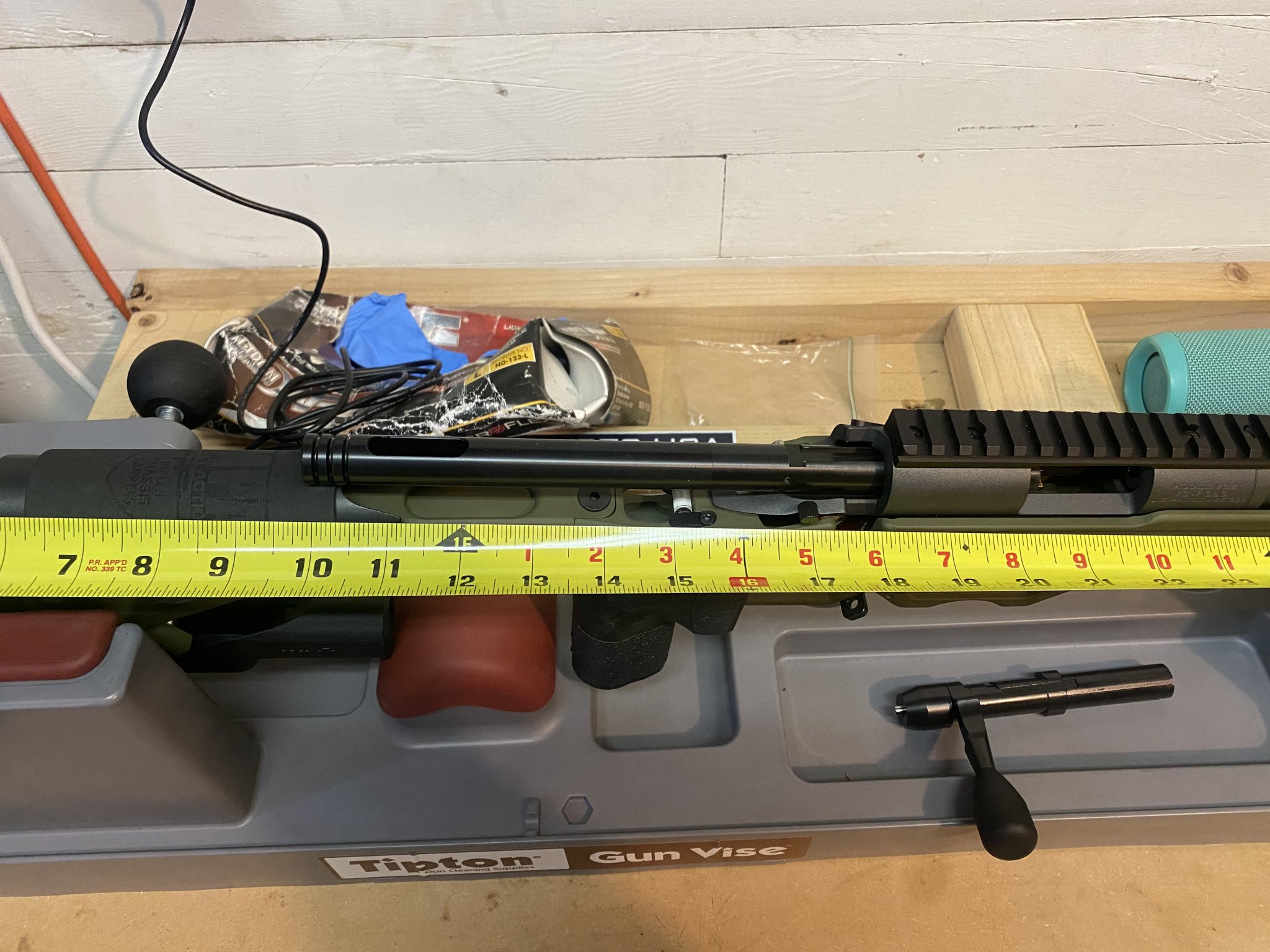

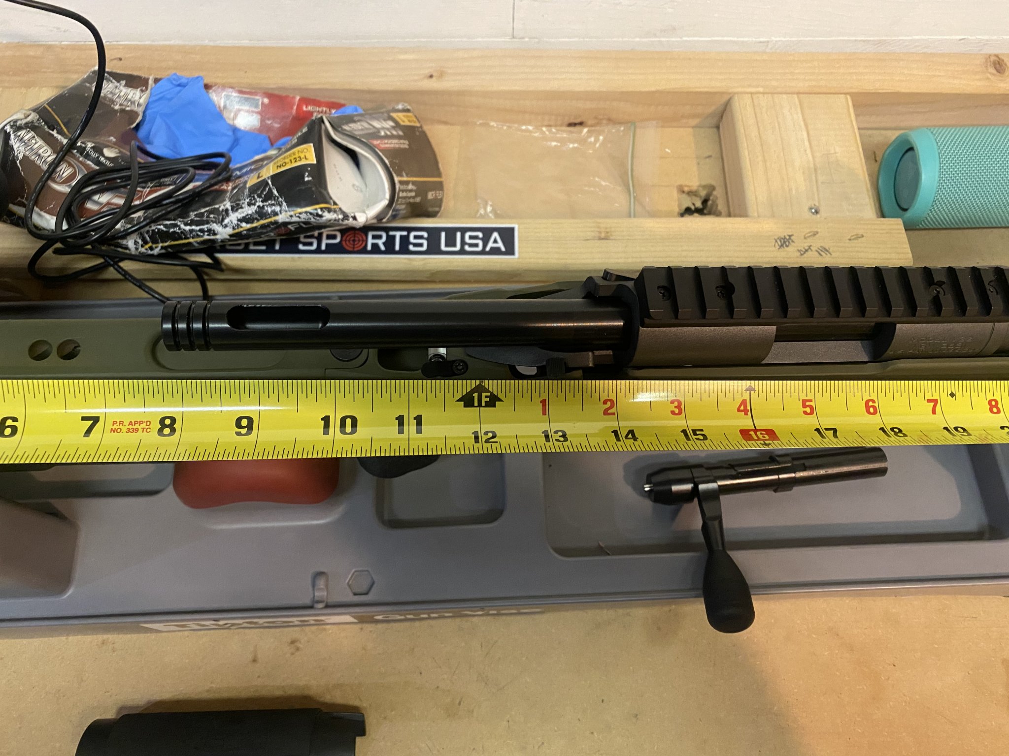

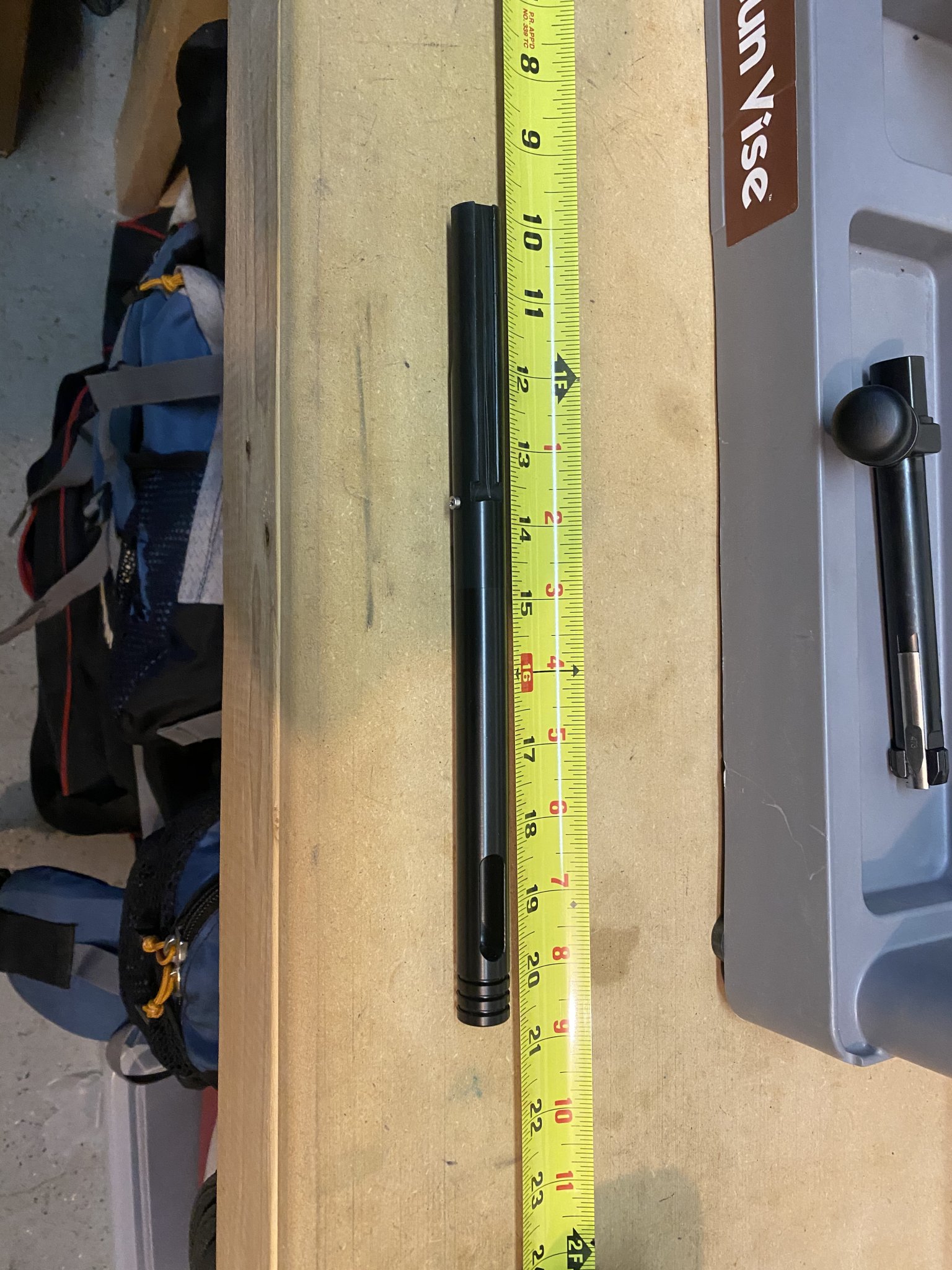

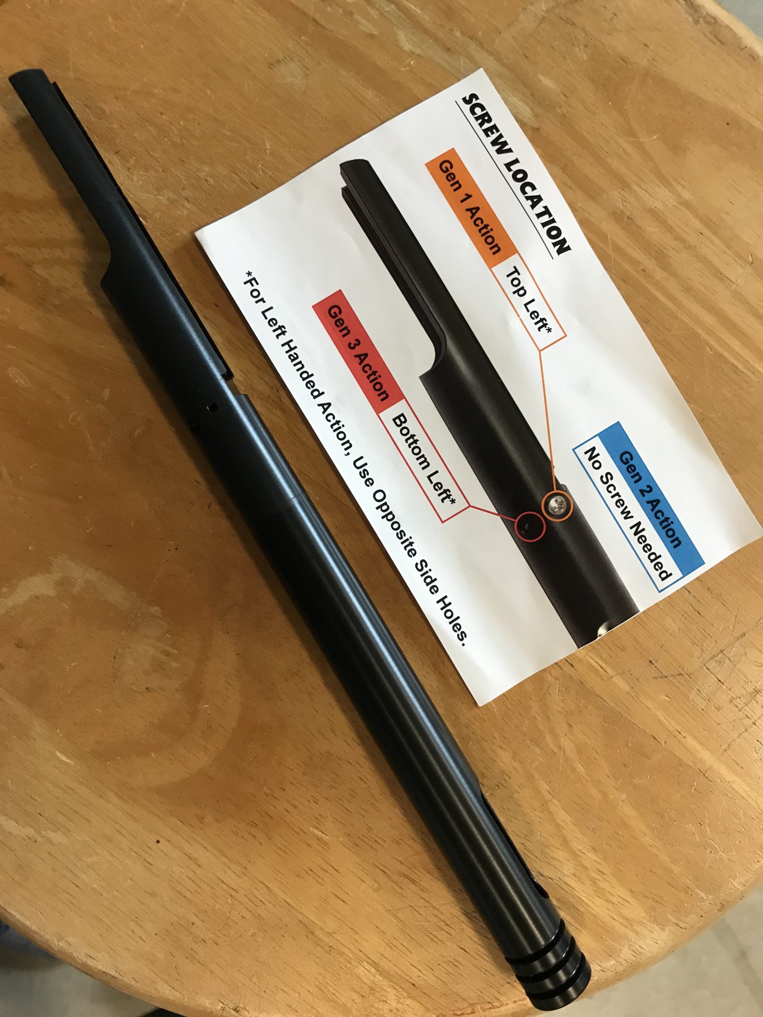

Thoughts I’ll add about the bore guides on vudoo’s website is make damn sure to get their custom one NOT the universal one if you even think you’re gna have clearance issues with your cheek piece.
I added a bore guide to my order and received the Delrin universal one made by bore tech with my rifle. It’s quality but lengthy, at 10.5” long.
I believe with the V22 in my xylo it will clear (currently has my nucleus in it)
In my mpa there’s zero chance of using it with out complete removal of the cheek piece; a known issue with the mpa chassis. It completely binds with about .5” to go. Does not matter if cheek piece is completely lowered or raised as the forward support rod is the way.
Side note And a PSA (because I was unaware and dumb), if you’re in that same boat with the mpa chassis and need to completely remove the cheek piece pay extra attention to the thumb wheel. If the thumb wheel gets removed from its slot the detent ball and spring will launch to the next dimension. (Not taking a photo of that, hunting for them was a bitch in my garage, a needs to add a small parts kit on their site for big dummies like me to buy.
The custom steel bore guide seems like it should be about two inches shorter total length when removing the insert. Hoping that one will allow me to run a guide rod in with out pulling out the cheek piece.
A suggestion for @RAVAGE88 . With the next batch of delrin rods from boretech please make them 1.25”-1.5” shorter. On the current batch there’s about 1.75-2” from the forward edge of the opening to the rear tang. I really like delrin guide despite the length issue.
