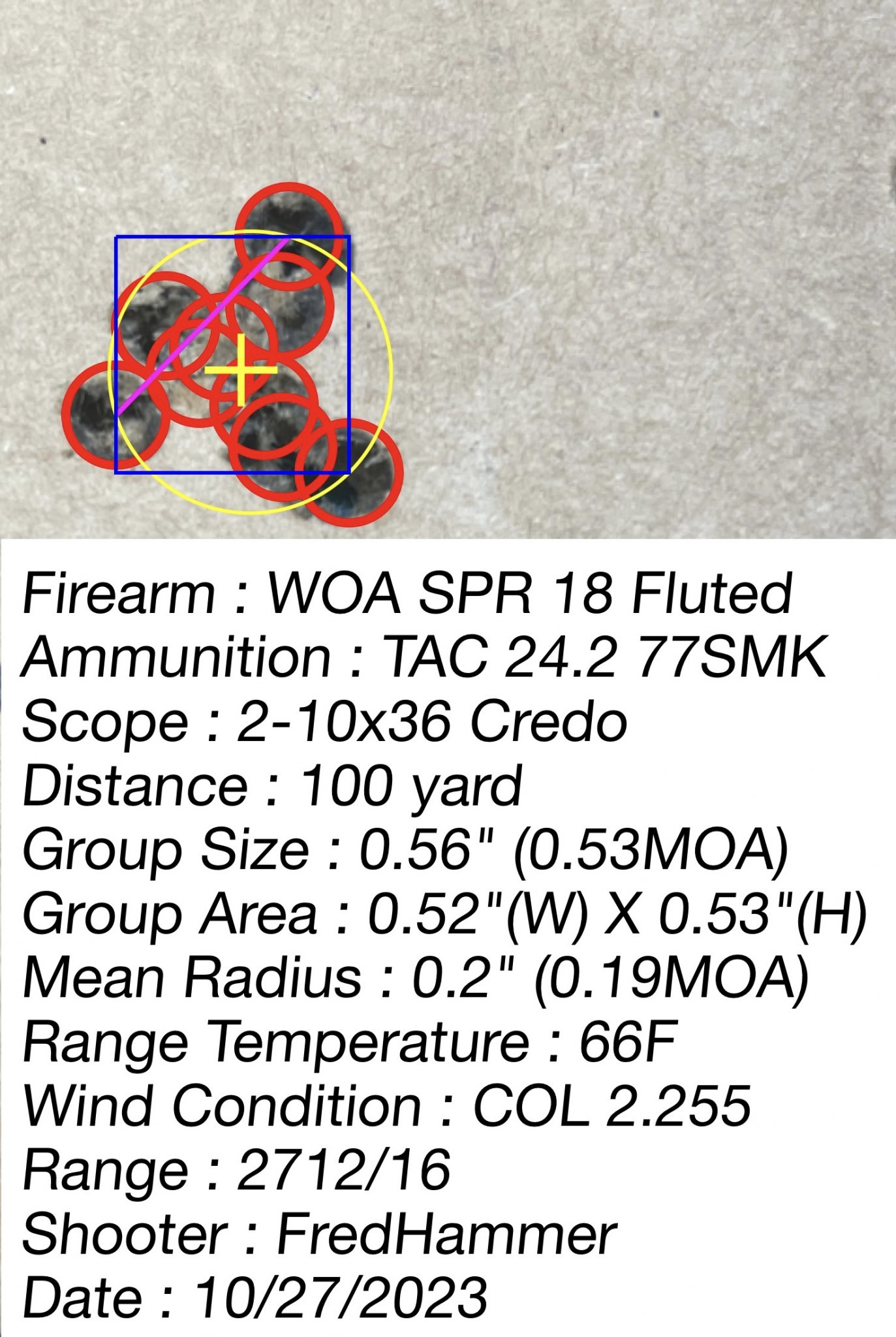

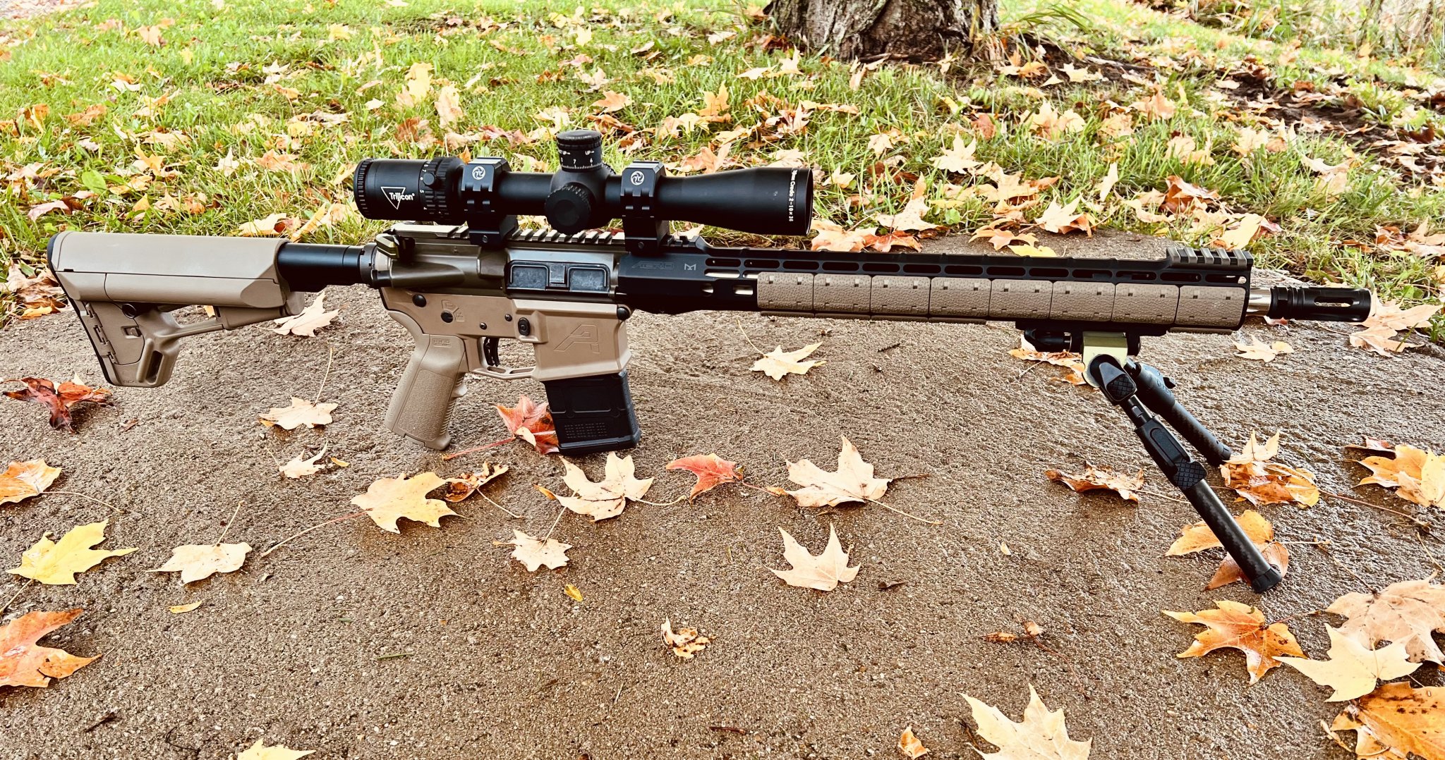

    IMI 77gr SMK Razor Core is some great shooting factory ammo. I haven't loaded 5.56 in 15yrs but saved my IMI brass. Gave it a go with the following best performing powders: (Velocities and group sizes practically identical to IMI 77SMK Razor Core)
    WOA 18" SPR
    2-10X36 Trijicon Credo in ARC rings
    Bullet: 77SMK
    Powder TAC @24.2gr
    Case: IMI 1X
    Primer: CCI 41
    COAL: 2.255
    MV: 2712fps SD: 16fps (IMI was 2711fps SD:15fps)
    Temp: 66F.
    Ele: 750ft
    Group: .53MOA 10 shot
    Neck Tens: .0035

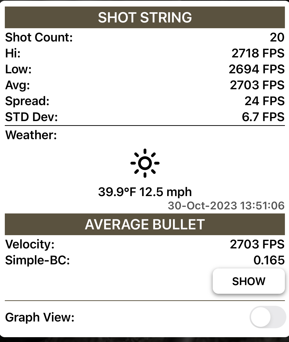

    When I loaded N135 for the 200.20X 308 @25F. it got better velocity than the usual powder players, Varget, N140, 4064, IMR 4895, etc, It also produced the best precision. When I shot at 60F., the regular players were getting back online with the precision more comparable. I haven't shot in warmer weather with the N135 308 yet.
    The 708AR fired from 70F to 90F. with N135 only increased velocity 15fps. That is fantastic compared to other powders, even extreme line of powders by Hodgdon.
    Edited to add: Well, I could just look at my own damned data for temp sensitivity of N135 in 5.56. :ROFLMAO:
    I shot the same load on two different temp days with that data presented right in this thread. (FX True Ballistics Chrono)

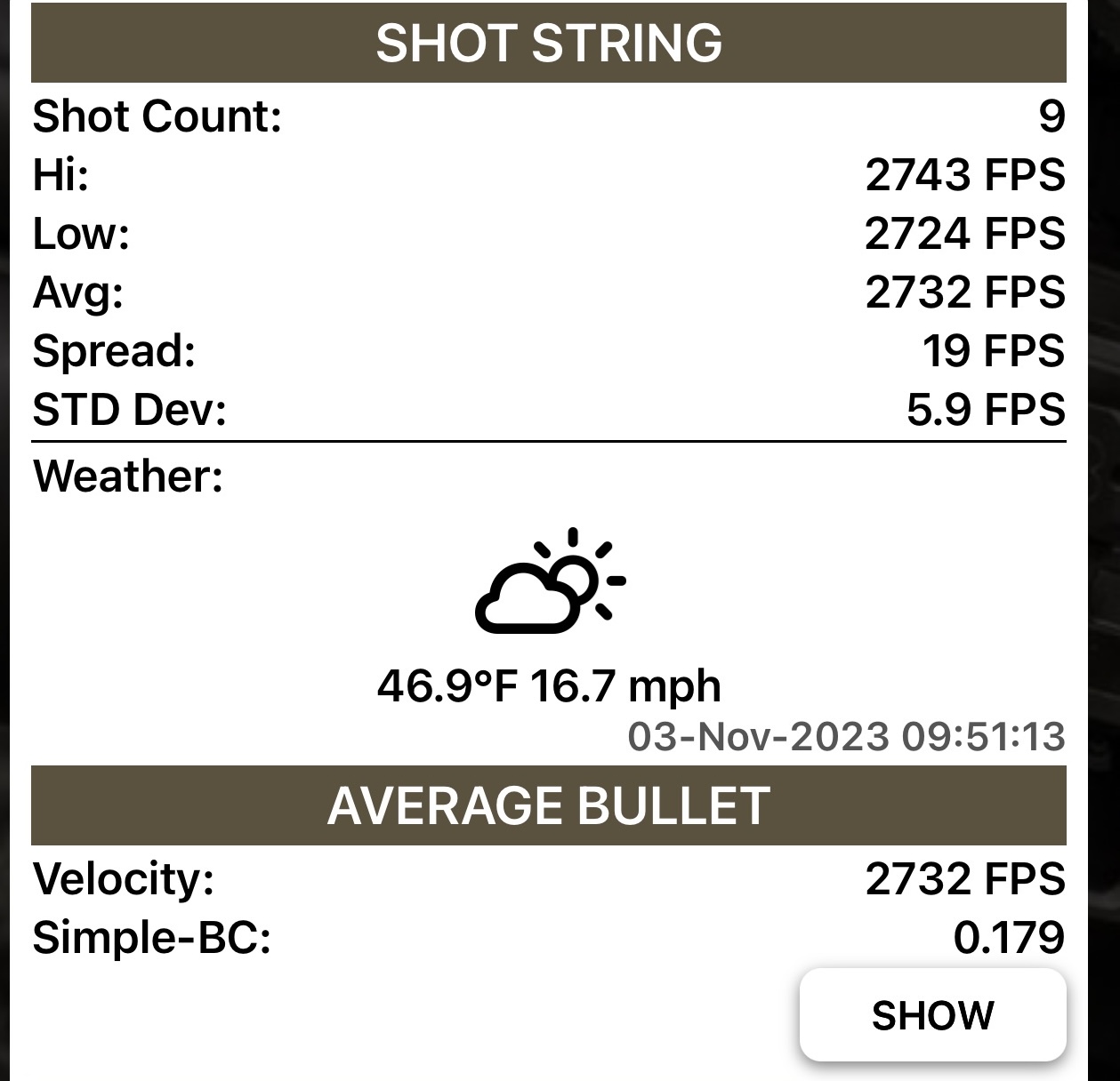

    66F. - 2716fps
    40F. - 2703fps
    26F difference in temp, 13fps in velocity. What's that give, .5fps per degree sensitivity between those two temps? With the powder matching the ambient temp that is great! Seems to stay true to that .5fps in the 708AR mentioned. 15fps increase in the hotter temps, but still 20fps spread between 70-90F. I'm digging it!

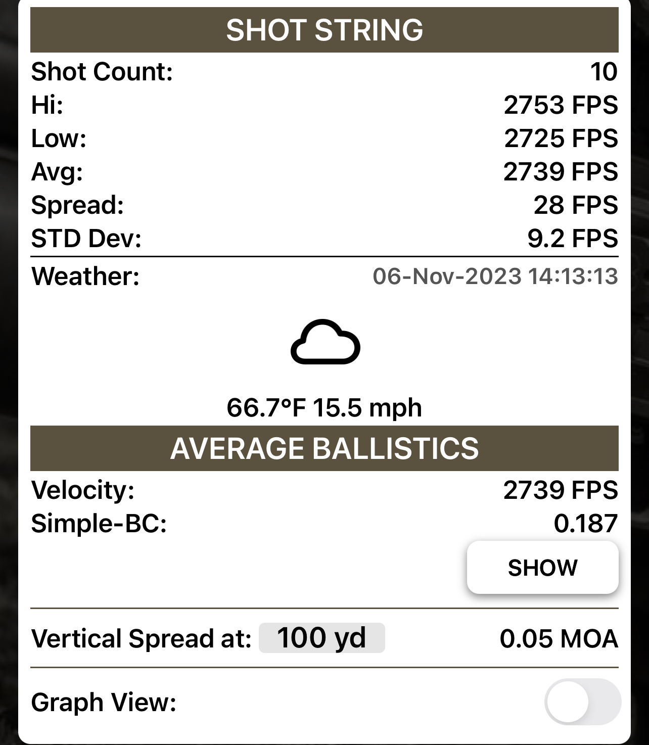

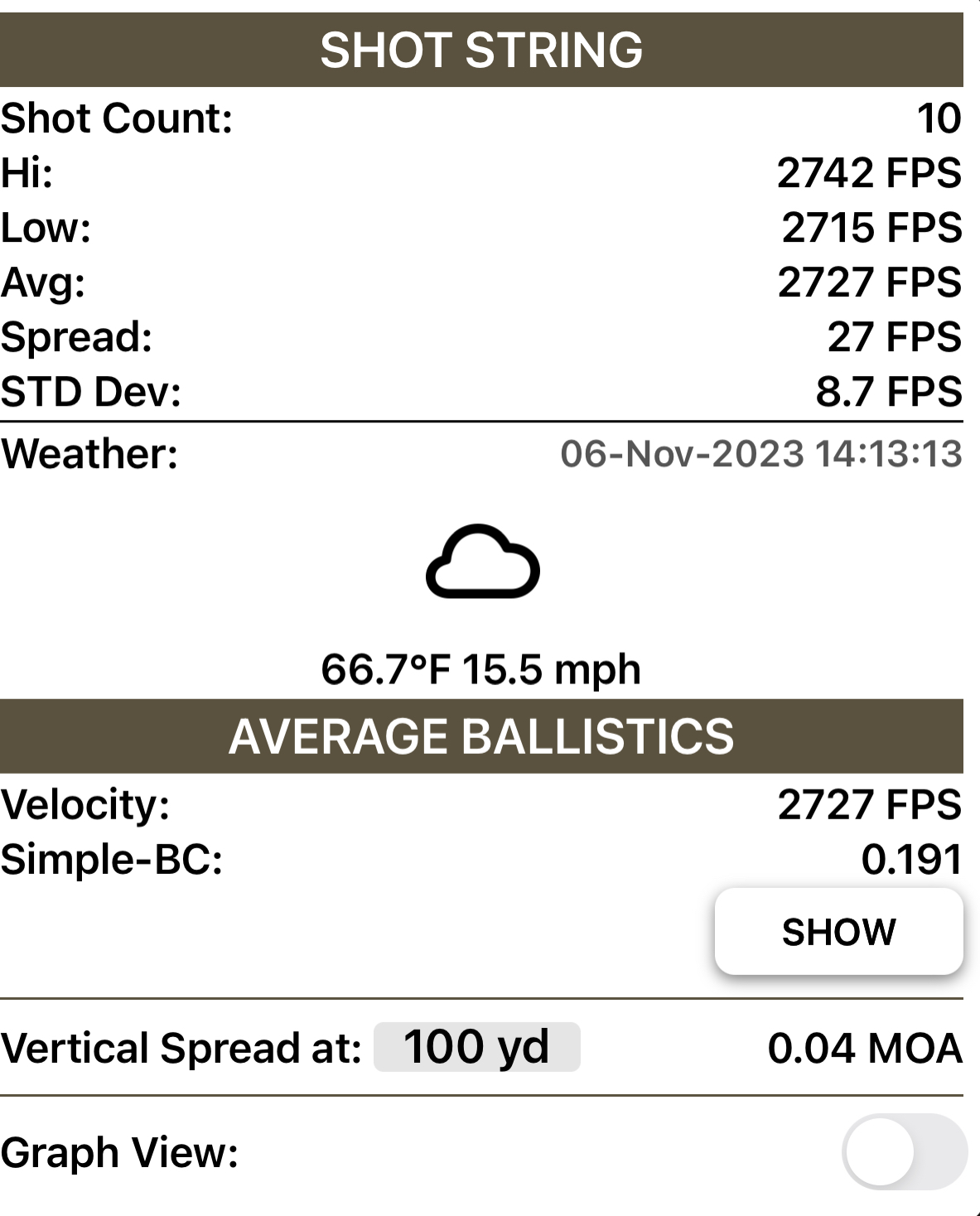

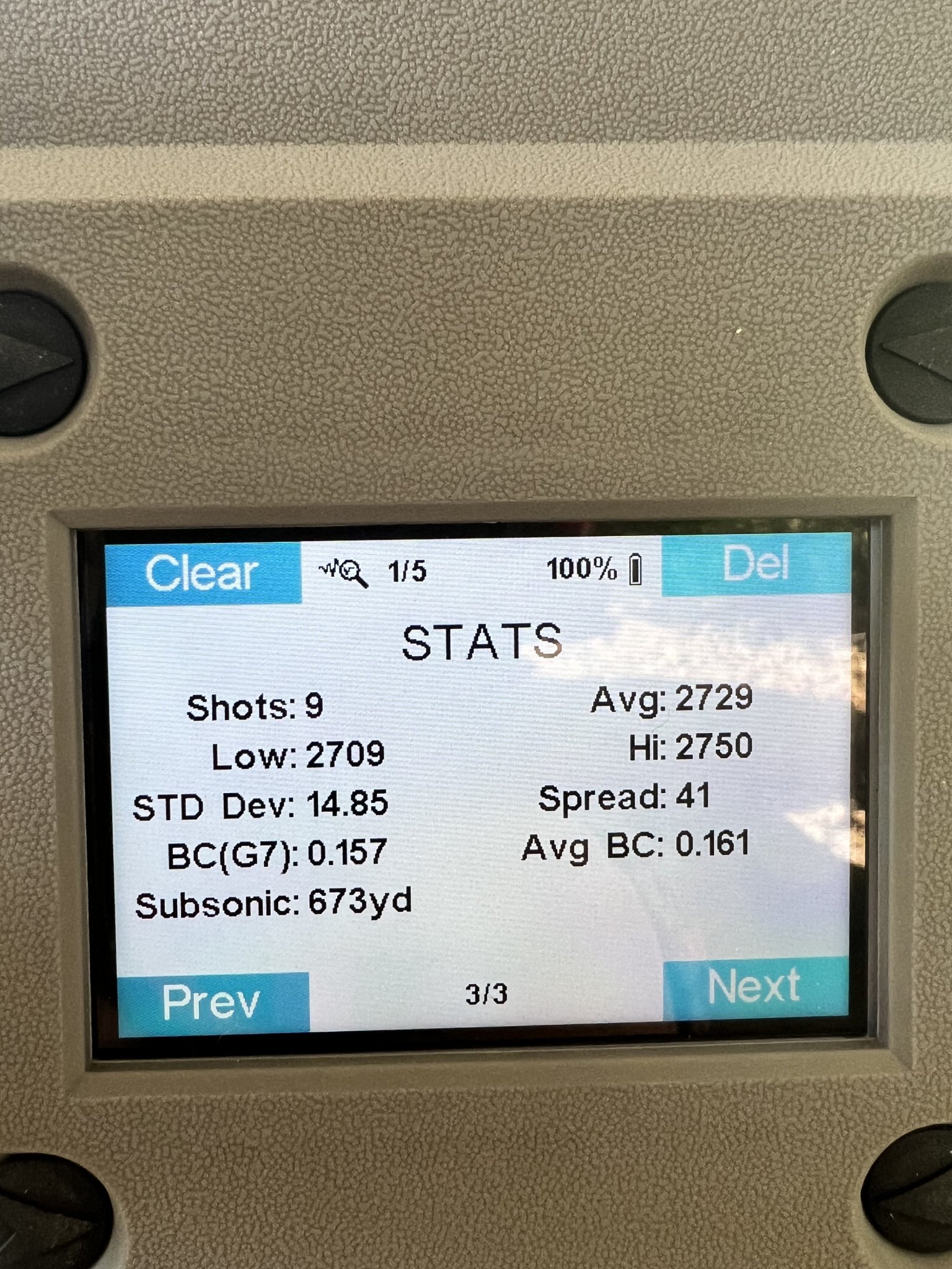

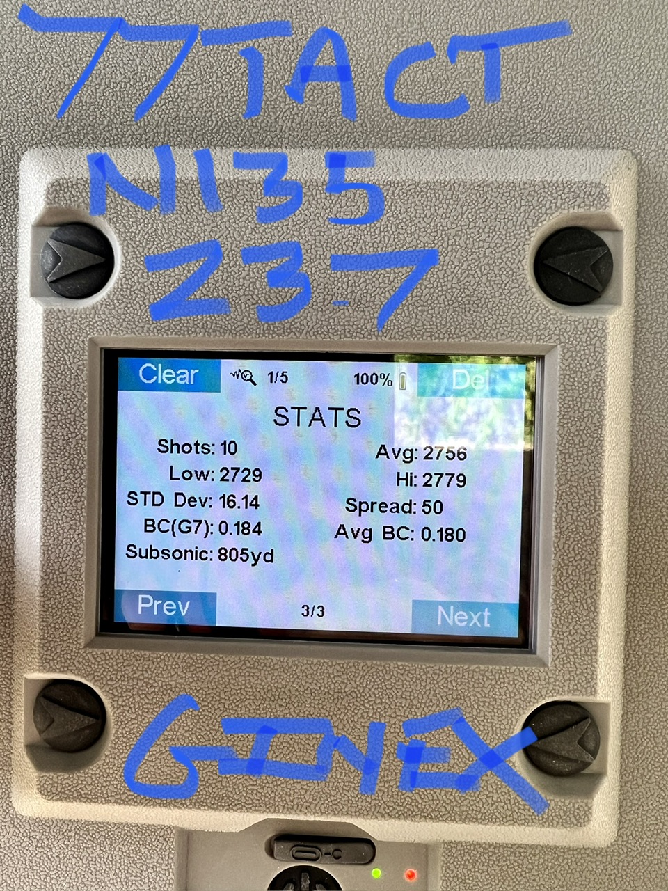

    More Ginex primer testing. It’s like a smooth climb down the ladder per 1/10th grain N135 reduction:
    Berger TACT 77gr
    23.6gr N135
    23.5gr N135
    (IMI 77 SMK Razor core shot 2731fps 16SD)
    Ejector shine on the case heads with the 23.5gr. No shine on IMI razor core. This 23.5gr charge weight is about identical in MV with razor core, with less ES/SD but seems to be pressuring quicker to get that velocity. If I didn’t care about the brass, fire & forget, I’d stay here. I will drop to 23.3 to see if that smear goes away.
    I intend to clean this thread up and provide the conclusions, but two trends I'm finding
    1. It seems N135 pressures more with Ginex primers, but TAC stays the same with both primers. Don't know why, other than the chemical composition differences between the two powders, with one extruded and the other ball.
    2. First precision testing shows the 24.2gr TAC both primers is producing tighter groups than the single digit SD 23.6gr N135. Just my luck this would happen. LOL. TAC - it's like the trailer park hot chick that's rough around the edges, but bangs like a champ.
