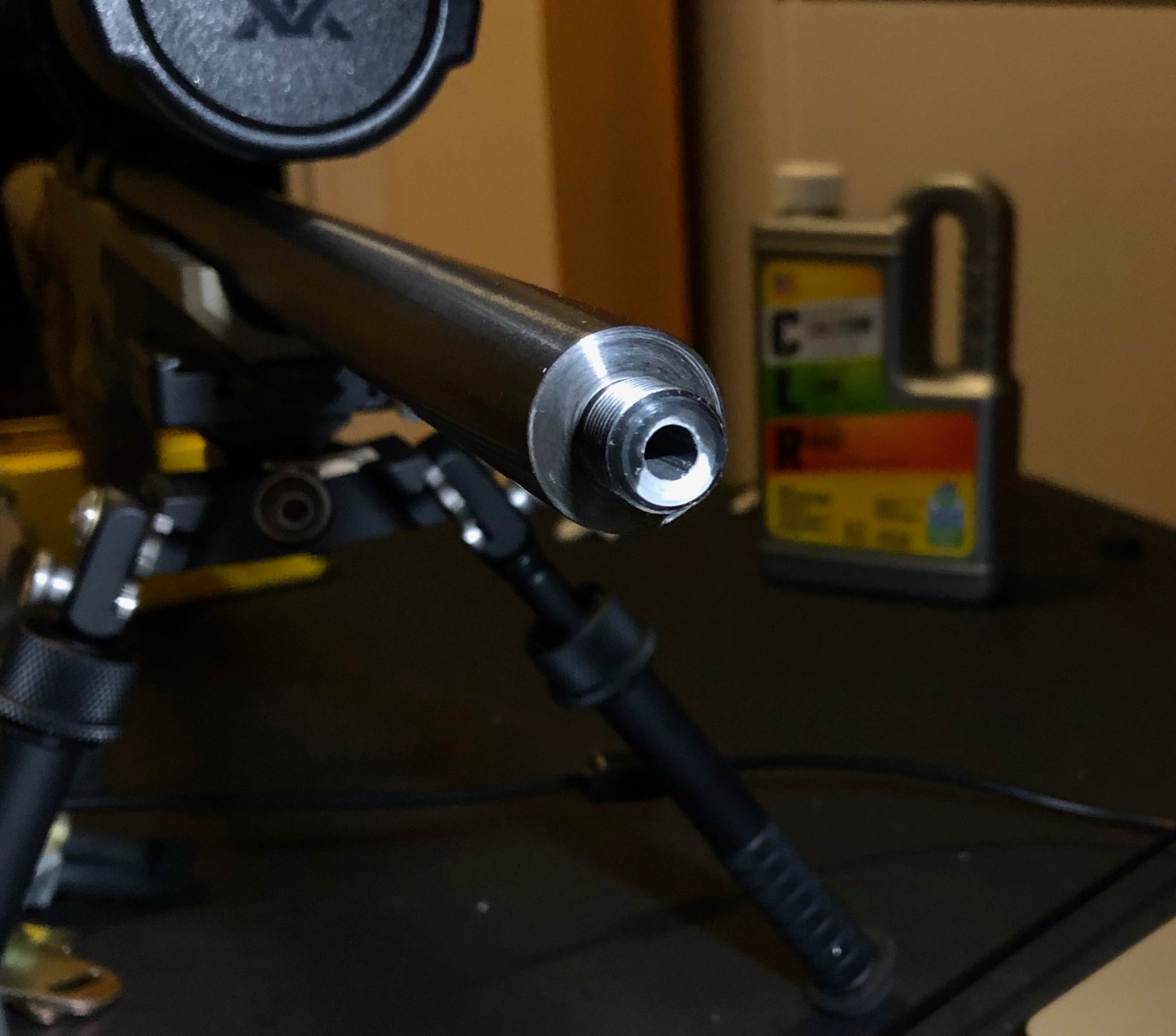

I found that CLR will etch a rimfire (CZ) barrel and totally remove bluing in 15 minutes' exposure (photos below) but doesn't seem to affect unfinished stainless steel barrels if used judiciously*.

I have not noticed any detrimental effects on my unfinished (other than bead blasted) Bartlein SS barrels and APA brakes (I'll soak the latter for a couple of hours but not overnight).
But what about softer rimfire barrels? Mike Bush (@RAVAGE88) of Vudoo fame specifically recommends against CLR, so my Vudoo has never seen it.

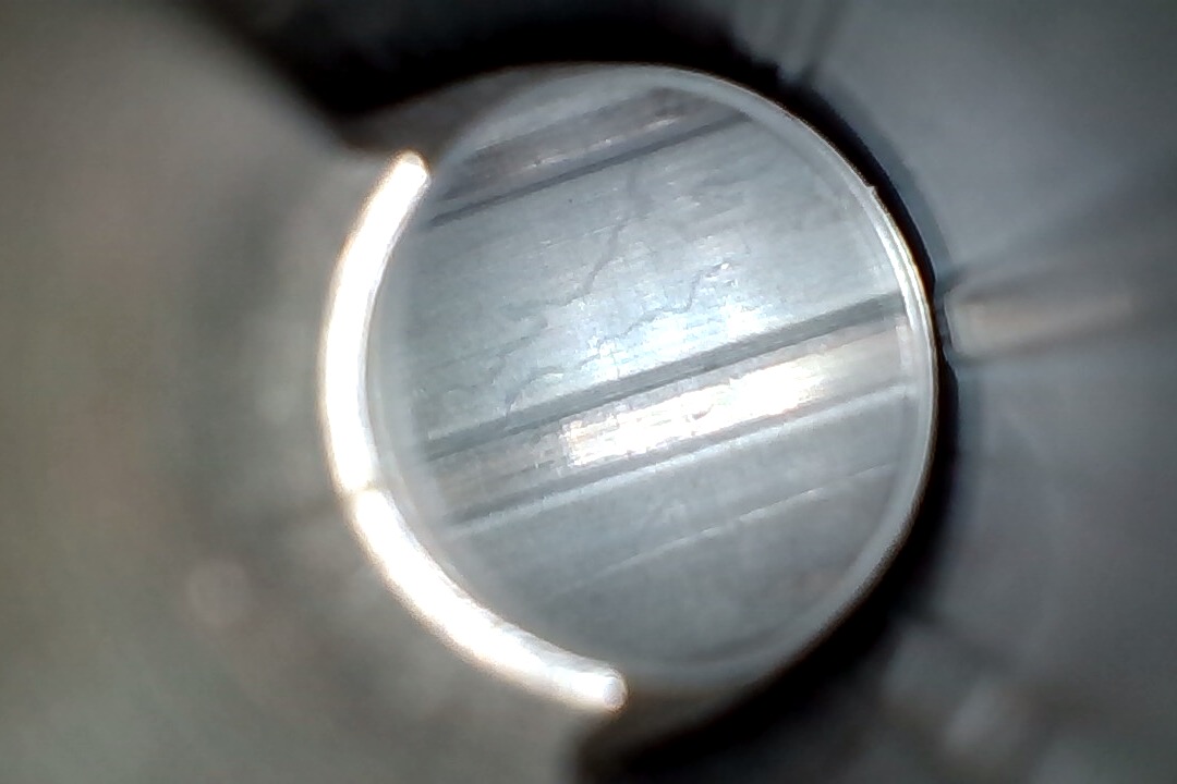

But tonight I decided to try CLR in a carbon ringed CZ 455 factory barrel that might have been made with a cordless drill and a chainsaw file compared to top-shelf barrels; the bore scope and simply the feel of Hoppes-soaked patches going through reveals the barrel is, well, a CZ barrel - it shoots fine for what it is. I figured I'm not going to hurt it with CLR.
The first CLR patch blasted the carbon ring almost completely with a 5-minute patch "dwell" as described above. The bore scope, curiously (or not), showed the first 5-6 inches of the barrel almost completely free of carbon, followed by a sharply-defined 6-inch section of noticeably carbon-fouled bore, followed by a final shiny-clean section. I can feel patches hit the rough section. So I ran another CLR patch to see if more of the rough-section carbon came out - some did, of course, but not all, and I called it good. Three dry patches followed by four Hoppes patches followed by two dry and a final lightly-oiled patch.
Total time of CLR contact with the bore was 15 minutes tops, with only five minutes or so of CLR patch actually in the barrel.
You can see the mild etching; there were maybe five or six of these in the area where I let the wet patches soak for 2-3 minutes. Now, my previous exposure with "etching" was acid rain etching on a German car whose previous owner had let rain-wet leaves sit on the hood/roof/trunk for too long. I could clearly see the leaf etching - but I couldn't feel it, and I knew the car had not been waxed. My point is, given how rough that CZ barrel is, I'm betting the etching means nothing.
The muzzle bluing is gone where the CLR dribbled out.
Bottom line, for me, is there is a place for CLR in my firearms cleaning toolbox, but only for specific cases - not general cleaning. I really need to try the Bore Tech suite of products as well.
Hope this is of some use to the community.
Bluing is a form of rust. I'm not surprised that CLR would remove bluing. Also not surprised about etching. Two of the main ingredients in CLR is Gluconic Acid and Lactic Acid.
Edited: You can use cold blue to touch up the bare spots.
