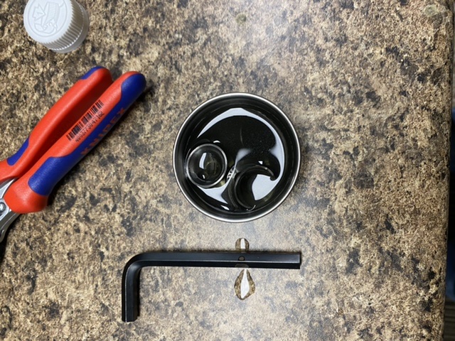

There is no pitting or any of the other things people believe will happen. All it is is clean. Not perfect but almost like new. I do not care about the finish either but it is just like it was when purchased. Now in intend to put a little WD40 on the inside and use it that way.
Reactions: kabarNC

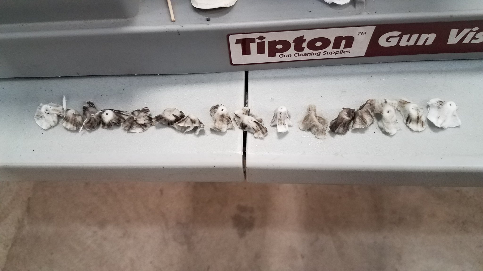

I’ve been using clr lately. I’ll vice the barrel vertically and use an ear plug in muzzle with a bucket under in case it falls out. Fill with clr and leave for an hour or two.
Drain and patch out. Use nylon brush on drill a few passes. Then soak with boretech copper solvent for a while the same way. Nylon brush and patch. Barrel looks brand new with borescope.
My actual amount of time physically cleaning the barrel is 10min or less. Rest of time is soaking and forgetting about it.

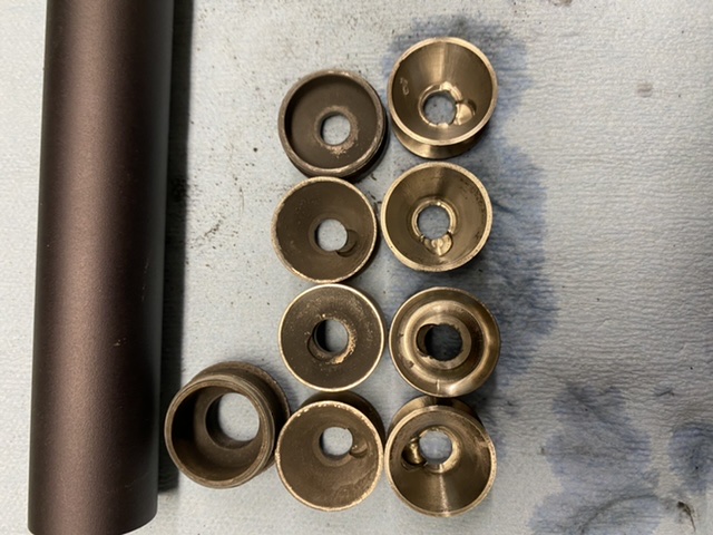

Hi new to sniper hide not new to lr. Just wanted to give the .02 on clr and what I do. I use it on stainless or moly barrels. And I use it usually with can on. If you leave it on a coated surface over night it’ll mess it up. Never any problems with stainless. And I don’t put it on coated surfaces. What I do is leave can on tight and take can end cap off. Use electric tape at very end of can and put a rubber cap over end of can I got from hd I think. Or Lowe’s I don’t remember. But put a ring of tape on outside of end of can. Put rubber over. Tighten a metal clamp over rubber cap. And fill entire barrel and can with clr to chamber. I use a marked turkey baster and know exactly how many it takes to fill it up then start watching to final fill level. Leave it in for about 1-2 hours facing down obviously. Then I just take cap off and pour it into a tub then back into a used bottle. You can use it over and over till it’s black it still works. Once it settles I gently pour off 90% per say every time and just reuse it. I leave bottle tilted slightly so all the carbon goes to a corner on bottom. Take can off take apart or spray out. Run a couple patches through barrel. Then run a couple 90% alcohol patches through. Then copper clean. Then kroil coat everything in the end. Doesn’t eat steel. Or aluminum. Hope this helps. But basically just fill barrel with can on all the way and reuse. Best easiest cheapest method so far.
The aluminum part. Let me clarify. I don’t use it very long on aluminum. And when I did it’s kinda pointless anyway cause my couple aluminum cans are monocore so can’t take end cap off. If you leave it on aluminum overnight you bought it. But I definitely still use it on aluminum. Just not that long 10-15 minutes.

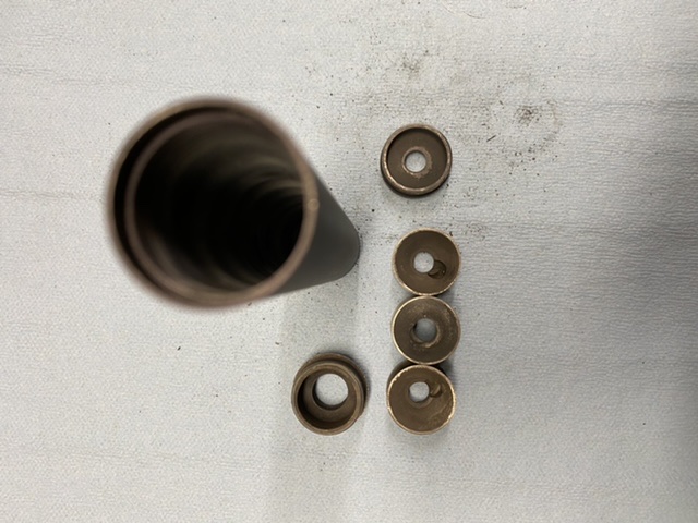

One thing I can remind you guys to do after youve used the CLR, is to stop the reaction. With cans ill use hot soapy water and run it through the can. Rise well. Let dry completely.
With barrels I use rubbing alcohol and run several patches through to neutralize then some dry patches followed by an oil patch, then a dry patch to soak up extra oil.
