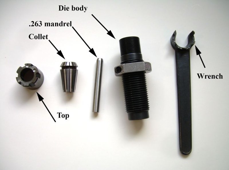

91F3B172-944A-40C3-9E1A-602E10B88134.jpeg From Porter Precision-
The die body & nut is $85, collets are $25, and pins are $10 each. Collets work on a range of pin sizes but generally you will need a different collet for each caliber that you are working with.
You can also use any size pin gauge like the ones off of amazon for three bucks to fiddle around with different tension.
http://www.portersprecisionproducts.com/porter/
