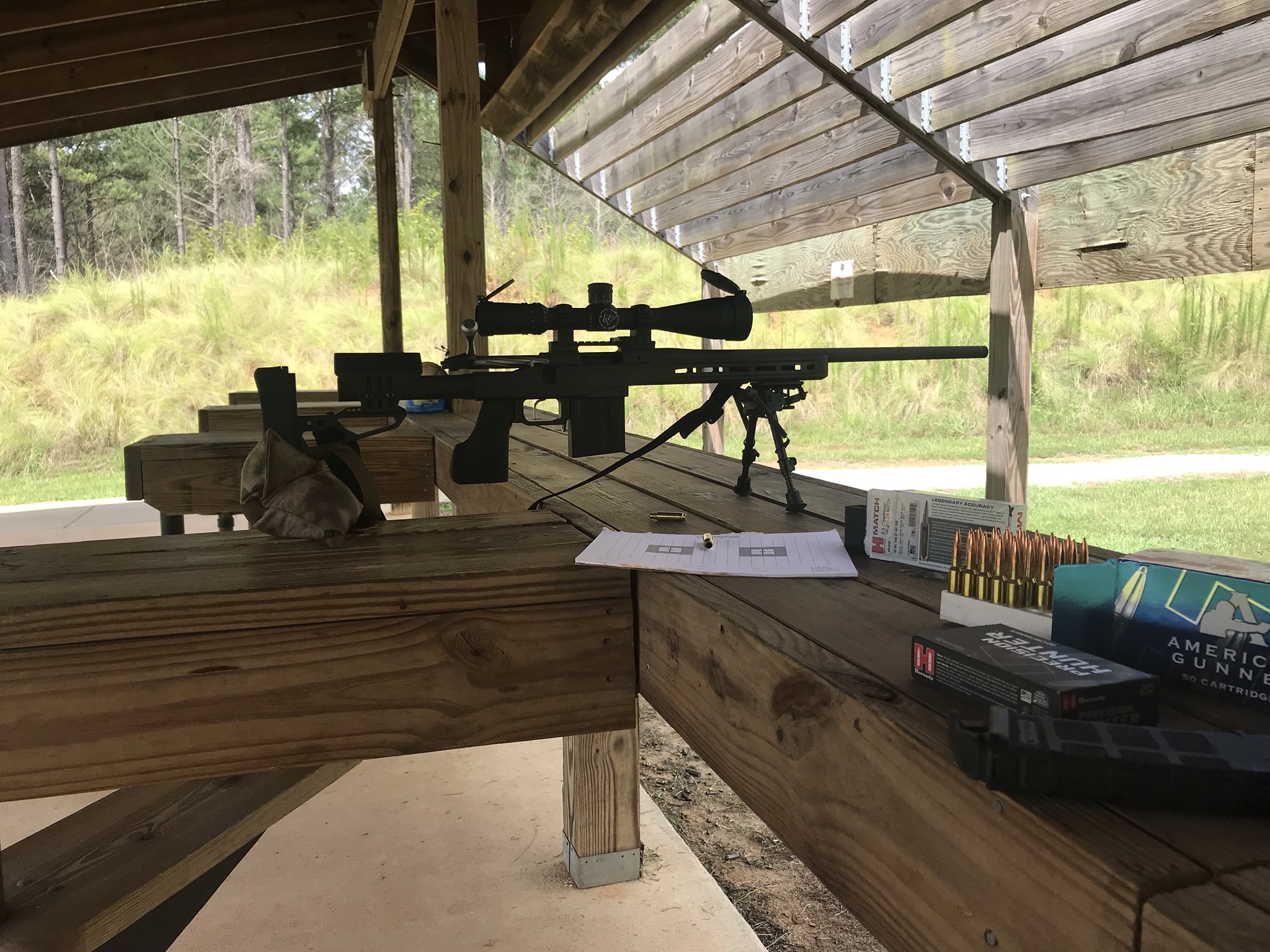

Do any of y'all run copper solvent through your barrel as a "preemptive" measure? I have a factory bergara barrel that seems to have accumulated a decent amount of copper and was wondering if it may be time for a thorough cleaning. I don't think the accuracy of the barrel has really diminished. My groups opened up a little but I kinda contributed that to me being distracted (I let a friend shoot it and he shot one 0.24moa group... I was shooting it around 0.8 :rolleyes:). However when I looked at the barrel a few days later, there seemed to be a lot of copper built up in it. Not sure if I should go ahead and run a solvent through it or if I should just take it back out, see how it goes, and wait until I am confident it isn't performing as it usually does. Thanks
ETA: It has been about 300-400 rounds since it has been cleaned with anything more than a wet patch followed by a few dry patches on a jag.

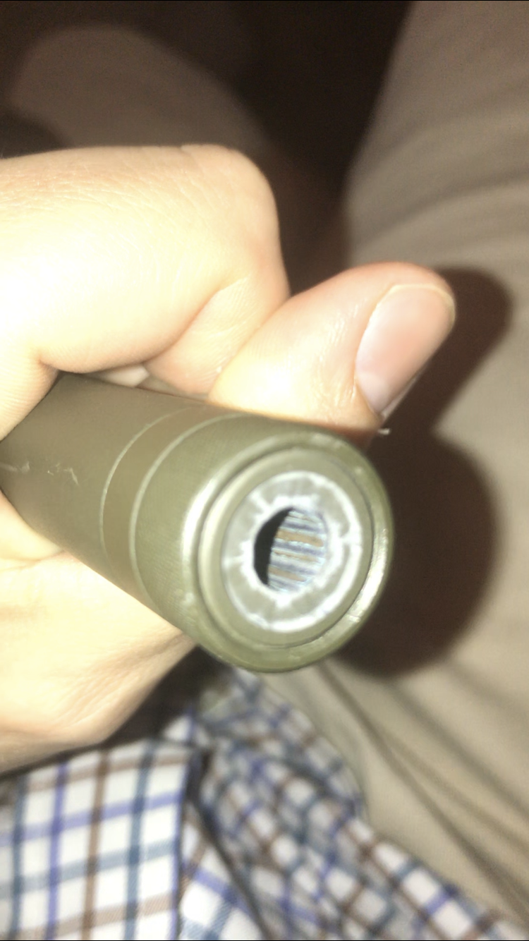

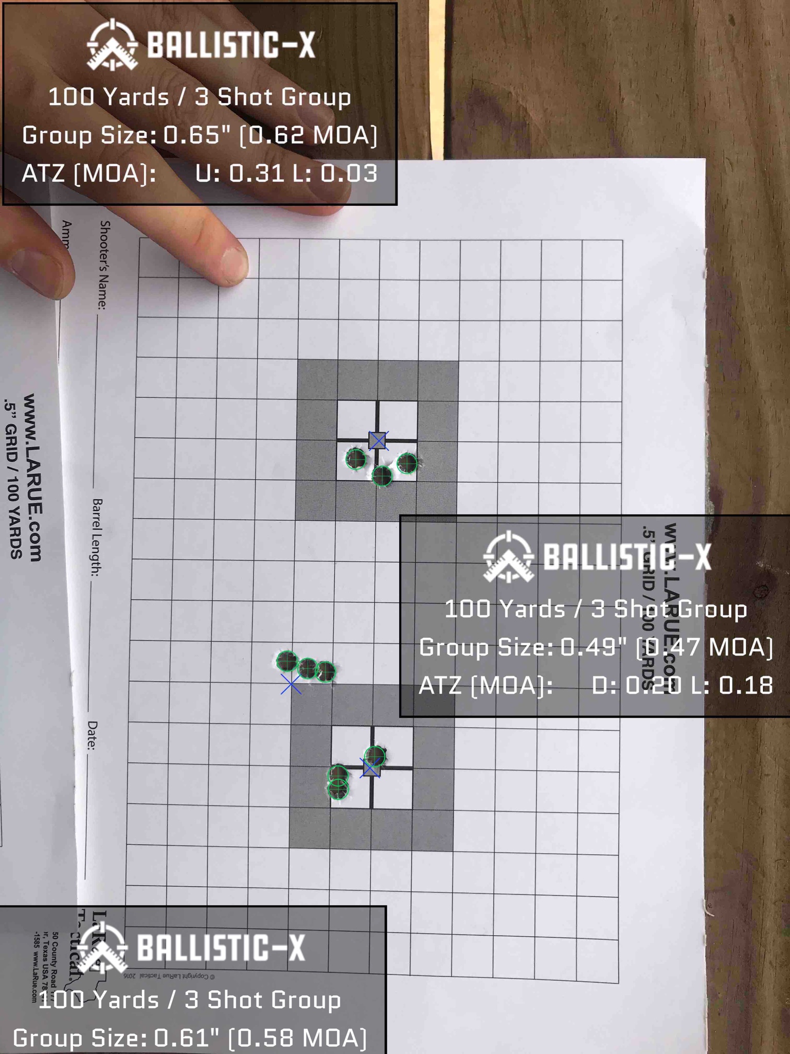

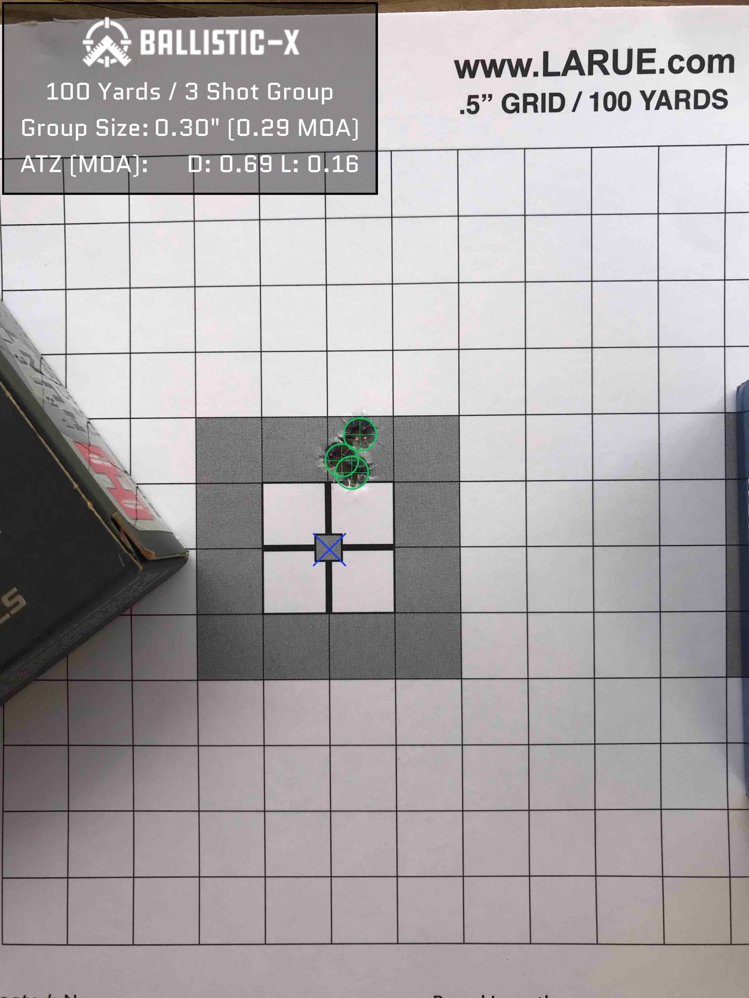

Follow up: Used some Pro Shot copper solvent and a nylon brush and was able to get 95% out after about 2 rounds of solvent + brushing and then took it back out and put about 30 rounds of Hornady Precision Hunter and a few ELD-Ms. It shot ok... 0.4x-0.6x with the precision hunter and shot one 3 round group of ELD-M at 0.29moa (which is about right... it has historically liked the ELD-M better than the ELD-X). Bottom line though is that a fair amount of copper was deposited just after 30 rounds. Talked to Bergara and they said they recommend cleaning copper out every 150-200 rounds with a steel :oops: bore brush and Sweets 7.62.... not sure I am going to take their advice on that one. If anyone has any thoughts let me know... i just feel like this is more copper than normal and looking to some people with a little more knowledge than myself for thoughts and suggestions. Thanks to everyone who has already responded. Pics below. Need to rezero for something besides american gunner
ELD-X
ELD-M
After 30 rounds
