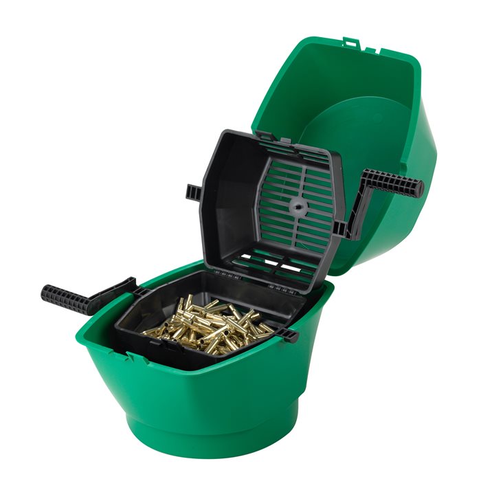

    I also got an rcbs media separator, that helped a whole bunch.
