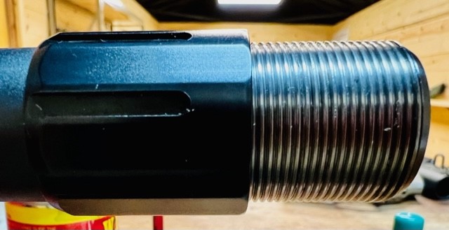

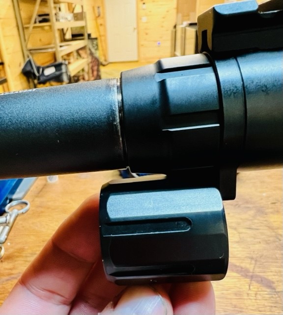

Speaking of nuts. Ran into this today installing a new factory take off Savage barrel on a Nucleus:
The Savage nut wasn't long enough to cover the threads when head space was set. I see why Aero went with the longer barrel nut for the "Savage small shank" pattern. Just FYI.
Some thread conditioning porn: I forgot to take a before pic, but the threads were a hot F'N mess. Go figure, Savage quality.

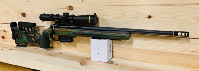

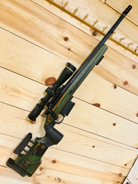

A right daggum Franken gun! Savage, ARC, Aero, and MDT parts. "It's Alive!
Slinging 137gr Hammer Hunters at 3150fps will make it an absolute death ray! (.308 Winchestershire)
