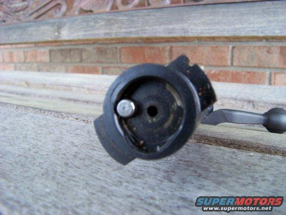

I have a remmy SPS-T bolt that has a crack next to the extractor, and im wondering how soon should I replace it. Im still shooting sub-MOA groups at 100 and 500 yards with it so if it doesn't HAVE to be replaced then im not going to. Also, if it does, what exactly goes into getting one replaced? Can I just buy one from PT&G and slide it in and be gtg?
My groups I shot the other day with the cracked bolt.. I thought a cracked bolt effects accuracy?

that is not a "crack" it is a "tear" and will not effect the safety of the rifle at all. if you had a sako or m16 type extractor installed they would bore that portion of the bolt nose off and shim it anyway. i would run it until the extractor fails and send it in for a sako or m16 or replace the bolt with a kiff. if you want to sell the "extremely dangerous" bolt for a song, i will buy it and install an extractor in it. been wanting to build a bolt action 30-30 anyway.
chuck

That portion of the bolt nose is not the section that would be milled off for a Sako. That portion would be about 180 deg away.
The damaged part actually does have a purpose. It is the first ring in the Remington three rings of steel that protect the operator from blowback in the event of a case failure.
I have a Sako I wanna do, soon. My riveted extractor is broken.

Cracks, even if they appear to be in a relatively harmless place, are not a good thing in a a repetitively, highly stressed part like the area in front of the bolt lugs. 10,000 pounds of bolt thrust is a nice round number to get a feel for what you're playing with.
Every time you fire the rifle, the crack may open and close just a little. Each time it does that, it might grow. If this happens, you will eventually have a catastrophic failure. It might be in 100,000 rounds, it might be in 10. Just because you can fire it safely once does not mean that you can do it over and over again. I'm not saying it will fail, but unless you do some heavy duty inspection (that would cost far more than a new bolt), you can't say it won't.
So unless your life literally depends on firing that weapon, the smart thing to do is to get a new bolt.

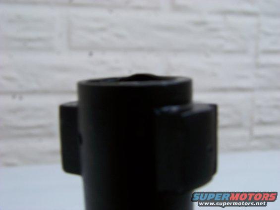

the entire bolt nose can be bored out and a smaller bushing is epoxied or soldered back in to the bolt face diameter that is desired. this has absolutely nothing to do with where the actual extractor is milled into the bolt. i made an offer on the bolt and would not be in the least afraid to use it. go to montourcountyrifles.com and i believe there is an explanation of this process there. i have a bolt that has a very similiar tear in the same place from a heavy charge that stuck a piece of brass to the bolt. while prying it out, the remington extractor goove was torn. still shooting it today but i guess i should throw it away. by the way, the "three rings of steel" would be the outside diameter of the bolt nose, the bolt nose recess cut into the barrel, and the receiver itself. has NOTHING to do with the portion of the bolt facing the chamber.
PS: DCW1284's picture shows exactly what i am talking about. if you will notice the bolt on the left no longer has the remington extractor groove in it. this is because the bolt nose was shimmed prior to the installation of the extractor. look closely at the bolt nose where the tear is on the OP's bolt. you can see the line where the shim and original metal meet.
chuck

<div class="ubbcode-block"><div class="ubbcode-header">Originally Posted By: selfbowhunter</div><div class="ubbcode-body"> the entire bolt nose can be bored out and a smaller bushing is epoxied or soldered back in to the bolt face diameter that is desired. this has absolutely nothing to do with where the actual extractor is milled into the bolt. i made an offer on the bolt and would not be in the least afraid to use it. go to montourcountyrifles.com and i believe there is an explanation of this process there. i have a bolt that has a very similiar tear in the same place from a heavy charge that stuck a piece of brass to the bolt. while prying it out, the remington extractor goove was torn. still shooting it today but i guess i should throw it away. by the way, the "three rings of steel" would be the outside diameter of the bolt nose, the bolt nose recess cut into the barrel, and the receiver itself. has NOTHING to do with the portion of the bolt facing the chamber.
chuck </div></div>
Thanks for the explanation. I had near exactly the same thing typed out and then thought "the hell with it" and deleted it. Too many that know waaaayyyyy more than you and me here to argue with! You forgot to add that the extractor itself is actually 1/2 of the 4th ring.lol

Uhhh...No, they are not. The shaft and the lugs are one piece machined from the same piece of steel.

Uuuuhhhh, I am thinking they are perhaps silver brazed or such and unless they have changed recently(not) they are 3pc bolts,lugs being seperate. Look on a stainless bolt, where they are blued is the actual seam. You can't run stainless on stainless because of galling so the bolt head of a stainless reciever is CM unless I am on a different planet????

Well, ok, guess I shoulda said Remington doesn't run stainless on stainless for their bolts. Comeon give me a break dammit with all your lil technicalities....just cause I didn't say it clearly doesn't mean it ain't so. Yer makin this harder than it has to be!!!!lol

It is not necessary to "bore the entire bolt nose", or "shim" (?) it, as has been said, to install a Sako. But, it can be done for cosmetics.
But when you install a Sako, the "three rings of steel" has just been compromised.

Let me clarify, the TIG I was referring to was to have the handle TIG welded to the bolt while you have it at the smith. Not an essential, but it might save you from headaches later. It has nothing to do with the crack, which could be bushed as has been said, but if it were me i'd just sell it to the guy who insists it's fine and put a one-piece PTG in my action, lol.
Also, Hooper does a screw mod that is an alternative to the TIG welding if you prefer. Either way, you need to address the nose first and you might as well do the other stuff at the same time.
PS- SD is correct about remmy bolts, the heads are separately attached as are the handles. 3 pieces.
Dave Kiff of PTG is making "drop in" bolts for the m24, so it's possible he could make you a "drop in" as well, then all you'd need is to have the headspace checked (and reset if it is too far out).
I don't know about Tulsa, but there are a myriad of good smiths on this board who could potentially do it for you. Some have longer wait times than other, call them and ask. You can mail your barreled action directly to a smith for repair without FFL involvement, and it will come right back to you the same way.

The damage is a tear where the bolt seems to have taken an impact on the nose. I have seen this common damage on many Remington bolts and even some Remington clone bolts. If you will look at any other R700 bolt in that exact area, you will notice that the area torn on your bolt is extremely thin and is easily damaged. Its sole purpose is to help retain the extractor. I would also share my opinion that the damage has no chance of spreading to any critical area. This is not a material defect but rather a design weakness that puts a very thin piece of material in an easily damaged area.
The <span style="text-decoration: underline">outer wall </span>of the bolt nose is one of Remington's "3 rings of steel". That outer wall is still intact and is in no danger of the effected area spreading or cracking into it.
The damaged area has zero function as far as pressure containment during firing. You could basically mill away the entire bolt nose down to the breech face and not effect the strength of the action. What that area does do, in theory, is help slow down some of the high pressure gases in the event of a case failure by making the escape route less direct. Most catastrophic case failures are around the case head/web forward of the rim at the exact point that the case ceases to be supported by the chamber. Again, it becomes strictly a gas flow route not a mechanical means of adding any strength to the action.
Some will even argue that the countersunk breech area around the barrel chamber helps redirect any high speed gas evacuation right down the sides of the bolt body toward the shooter. Many, many other sucessful and famous actions have no bolt nose countersink or breech/chamber countersink.
After sharing my above opinion I would still say that I would want the bolt repaired just to have it back to spec. and looking right. The torn piece could certainly move into a position to interfere with the ejector or any rounds trying to seat against the breechface.
All of the above is only another opinion to be thrown into mix. Sorry if my opinion contradicts others.
Re: Crack in bolt! Need to replace? *pics*
Just buy a new bolt. You should have common sense enough not to use gun parts that are damaged like that. Retire the gun for a couple weeks until you can afford to replace it if you cant right now.
