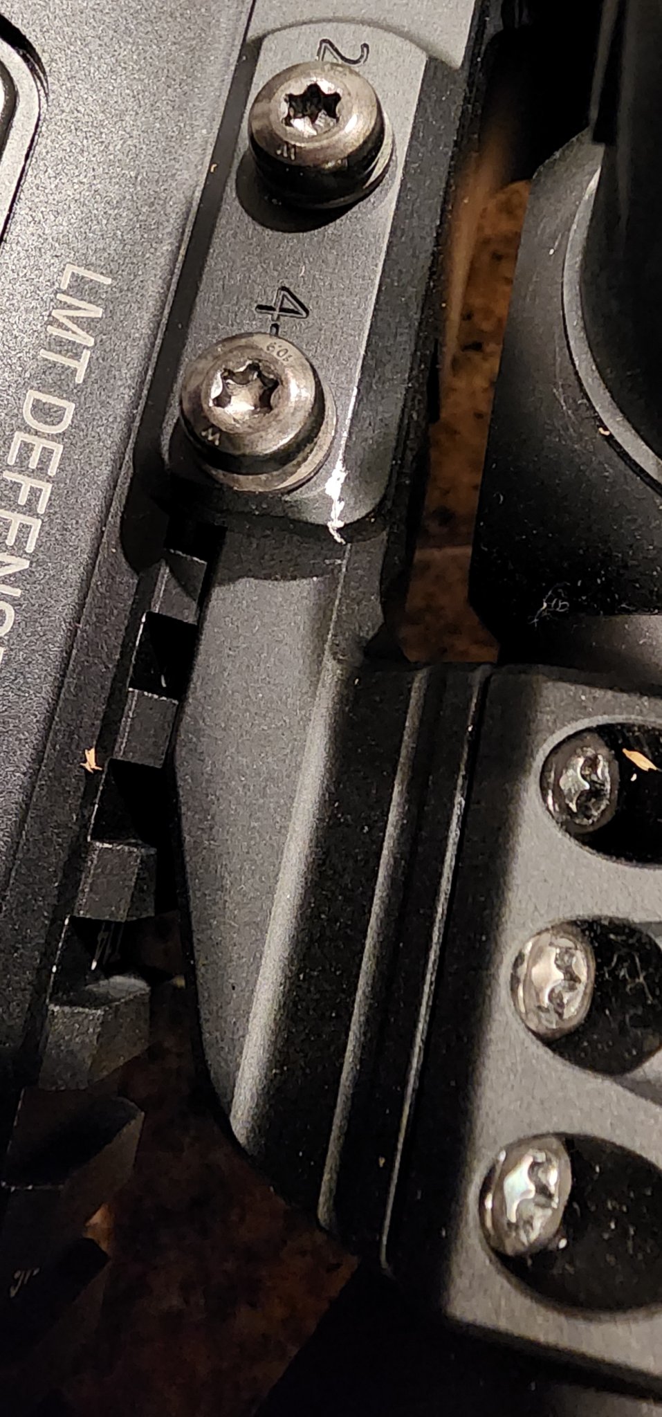

Anyone else ever experience a Sphur mount cracking? I have one on another rifle no issues, This is on an LMT MARS in 6.5

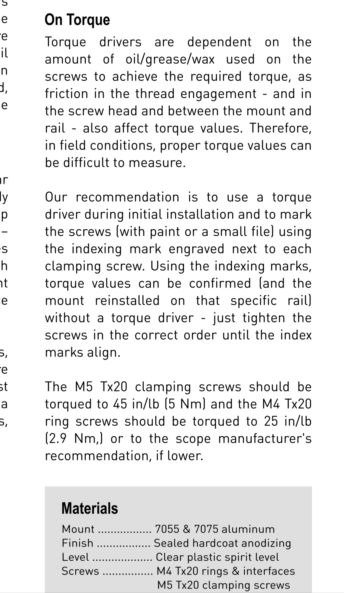

Their spec is 45 inch lbs. Mine cracked well before that when tightening. If it was only user error you’d see many more mounts with issues here. Mile High wasn’t remotely surprised when I called for a replacement.

Gota be smarter than the engineers. 45lb lbs is a fuck load...especially considering action screws which are way bigger and holding much more weight/mass are like 55lbs. You don't need anywhere near that.
15 on the caps 25 on the rail fastners.

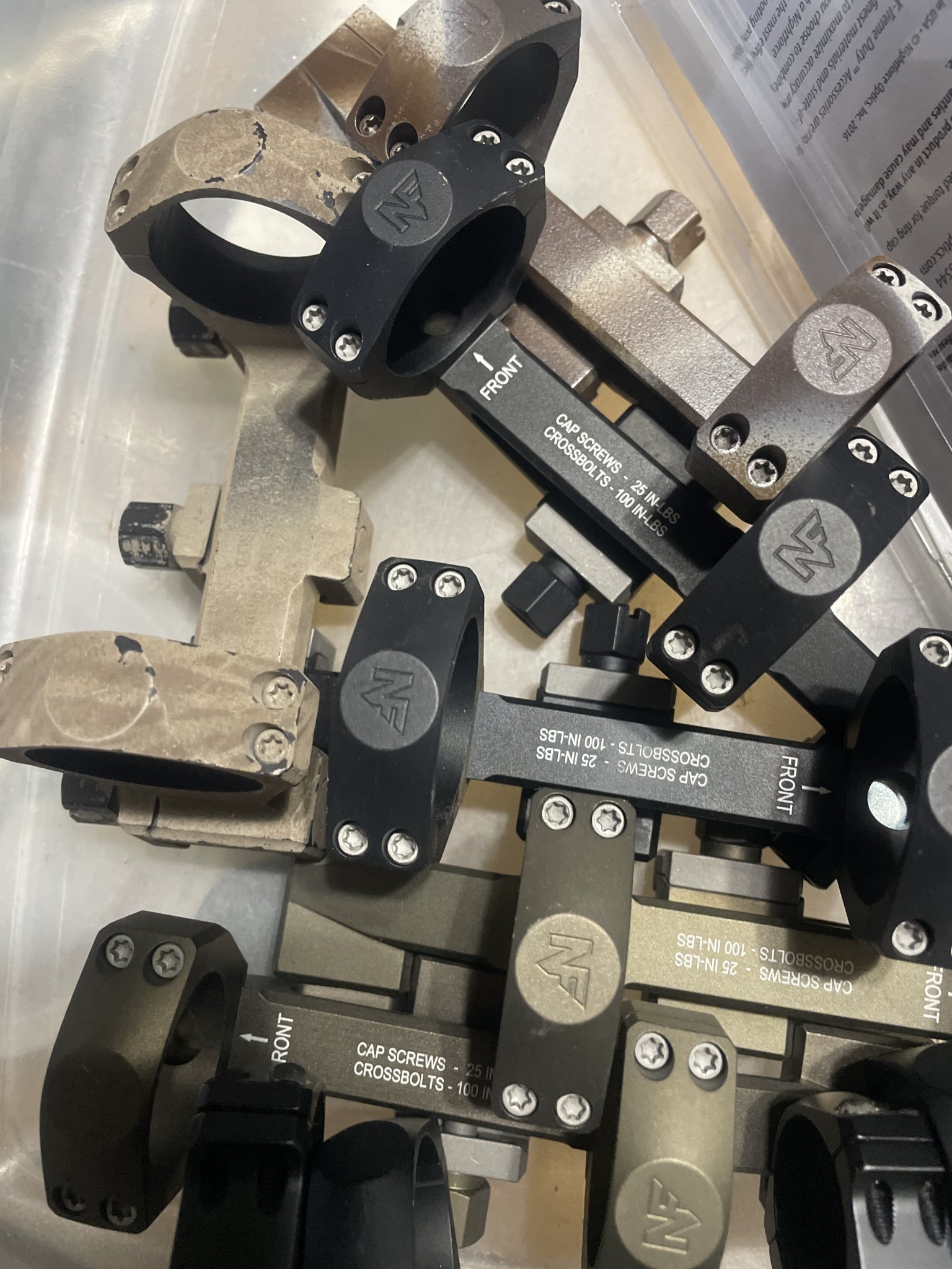

How many these almost perfection NF mounts y’all hear cracking ?
