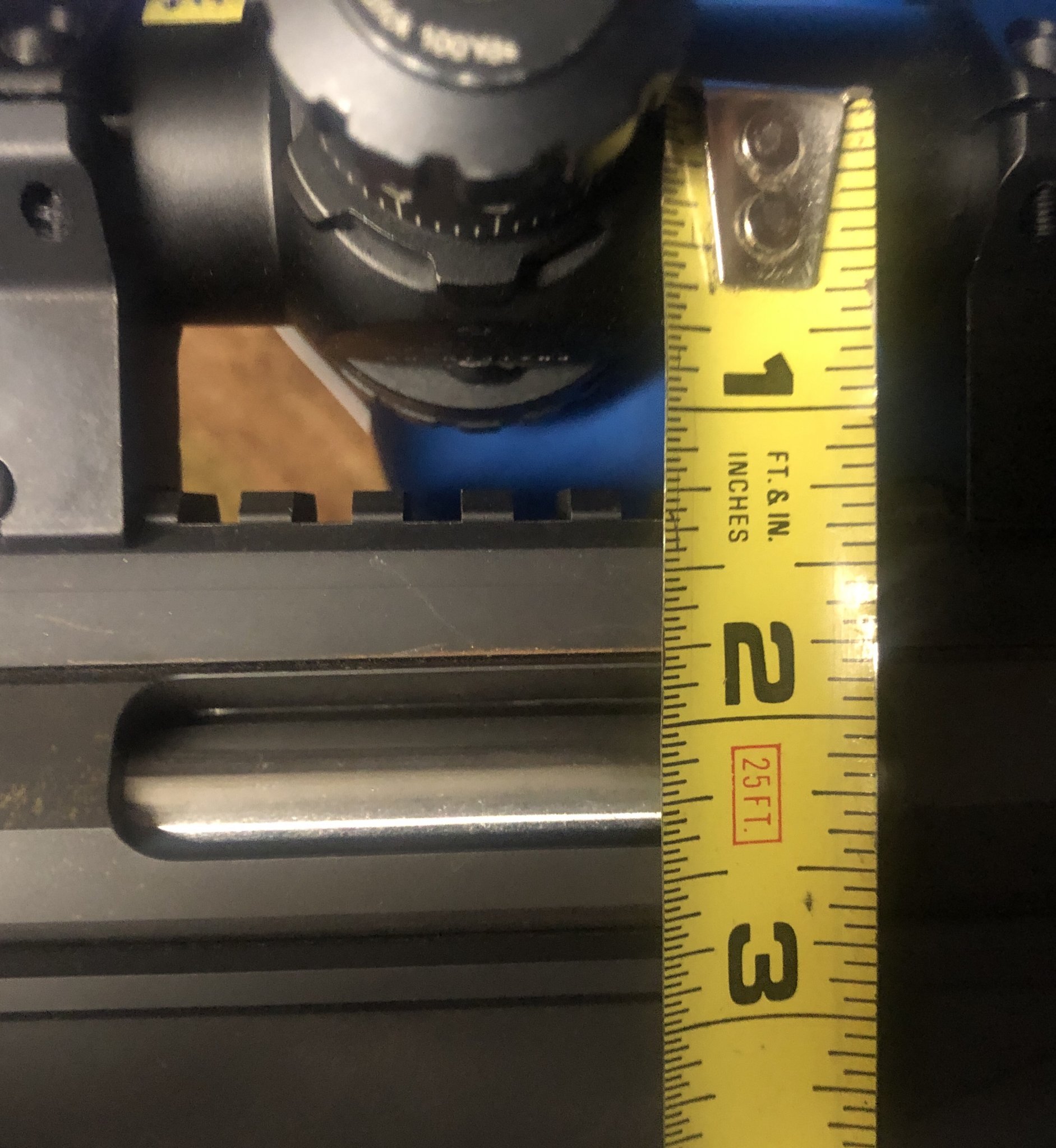

Not that it makes a huge deal but AR height is around 1.46” so on your RPR I would imagine closer to 2.5” not a big deal but worth double checking.

I have a buddies RPR in the safe with AR extra high rings — I’ll measure - give me 2 min.
Ps I also use AR hieght on my AX and it is 2.4”
Edit to add image of RPR with Extra Height AR rings.
Reactions: 1shotyouknowtherest

I think this thread actually shows how many of us are lacking base knowledge.
I am saying this not to be an ass, but hopefully a few guys will drill down to understand the numbers better as well as what true differences angles make. How severe they need to be and how hard it might be to shoot some of the scenarios presented, that some of the examples are actually backwards.
The issue here is that the rounds that were 4+ moa low at 200, or 3+ more than they should be as as the speed and zero presented.
I use one example posted. Please note I am not trying to pick on anyone just trying to help get people to question some of what they think is correct.
As an example: “So if the target was 45 degrees uphill then you would actually have a ~70 yard zero.”
First it is important to know that a cosign of 30 or 45 degree shooting angle is very difficult to find, much less shooting it at at square range. It also exceeds almost all natural dead fall of soil. So without a cliff, tall building and standing, a 100 yard target at 45 is just damn hard to find..
But let’s just say you zeroing and your target is at the top of the redwood tree that you are almost standing under. Sorry for the visual, but it is important.
Ok we do the math and end up with what is effectively 70 yard gravity distance.. all good.
We know that at about 2900fps with a 100 zero and 2.5 SOB, the drop will be approximately 1 moa on a flat range @ 200 and that the OP found that he was 4+ low not 1.
The closer we set our zero distance under 100, the less the predicted drop would be. This is because we are dealing with an increased angle that we created between the Bore and the scope by bringing the zero close. So a 70 yard gravity zero would have an expected drop .4 MOA LESS than the 100 yard zero at 200 or a predicted 200 yard comeup of .6MOA.
Same goes for SOB the taller the delta the less adjusted drop at 200. A 3.5” as the op stated vrs a normal AR height of 2.5” would result in a .5 moa 200 yard prediction.
Anyway, understanding our angles are important, especially if we are attempting to giving others information. I hope this is seen as helpful not a anything else.
Okay, since we’re explaining our questions now, here’s why I asked the simple questions that I asked. First off, HOW the OP measured the drop is important and from what I’ve read has not been answered yet. Since his scope is SFP and assuming that the reticle is in plane at 24 power (I confess that I’m on my phone and have not verified this), then if he measured the distance using the reticle (4 MOA, remember?) at a place in the power ring where the distance was amplified, then his measurement could well have looked like 4 MOA (8-9”) while actually being only 1+ MOA (2-1/2 to 3”).
Thus why I asked how he had measured the drop. If the drop was measured using a ruler of some sort, then it eliminates that possibility.

Weather or not the closer zero helps or hurts depends on SOB height. .
1. Please rethink this. Closer zeros always causes a more acute angle zero.
The military was pushing the 25 and 50 precisely because where the second zero crosses. Us, match type shooters use 100 because the drop is always hold overs.
2. As a separate issue SOB. High SOB does creates a similar effect. so a 3.5” SOB he mentioned would result in 1/2 the comeups and making your zero example exempt worse.
F’d Parllax that’s 3moa jacked would never produce repeatable groups especially with someone who has no idea of how to use scope shadow.
Using crazy tollerance stacking is not a reasonable approach or fix your examples.
“If” his groups were good, repeatable, same hold and if the mention velocity was in that normal 6.5 velocities that he mentioned, the answers seem to point to simple shit like an offset between ammo or the range was wrong. My guess would be on the first one.
But that’s no longer my point. If we are going to answer we should try to be correct. When we arn’t we should at least own up to it so “we” can become more knowledge shooters.
Creating arguments to try to make our points correct doesn’t really help us grow.

You are correct. Regardless of SOB, a closer zero than 100 will always produce less drop at 200 yards than a 100 yard zero. Parallax does not cause POI shift and neither does changing magnification.

Just wanted to restate a couple things we need the OP to verify still:
1. How was the 8-9 inches of drop measured? Tape measure/ruler/etc? Were you using a target with grid lines on it that you were going off of to get the 8-9" measurement? Or something else?
2. If you don't have a friend you can borrow a rangefinder from, you can pace off the distance between the firing line and the 100 yard target, and then pace off the distance between the 100 yard and the 200 yard target. If it's roughly the same to the 200 yard target as it was to the 100 yard target, we can rule that out. But if that 200 yard target is actually 300 yards, that should clearly show up in counting paces assuming you do it with any sort of consistency lol.
3. You gave a muzzle velocity (a high one at that lol), how did you come up with that velocity number? If it was with a Magnetospeed, at what point in the range session was the MS used?
Edit: Just had a thought. We don't even need you to go back to the range to verify that it was a 200 yard target, assuming it's an outdoor range and there's a decent satellite view of it. You can measure the distance in Google Earth. I just measured a couple known local ranges with it, and it's within a few yards. I can measure it for you if you'd like, I would just need to know where the range is.
