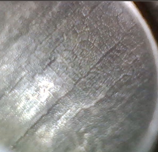

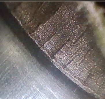

I realize this is an old thread, but for the record, i got 2,500 rounds of good accuracy out of a Savage factory barrel. Was remarkably accurate for a factory barrel: Averaged around 0.35” three shot groups and 0.5” five shot groups.
Over the next 100 rounds, speed became erratic, between 50 and 100 fps variation. Still accurate at short range, but mostly useless at longer ranges (400 plus). So retired it.
However: Did not have a bore scope at the time. Yesterday took the barrel out and bore scoped it: It had a noticeable carbon ring in the chamber, big enough to get under the case neck.
Could that carbon ring perhaps have pinched the bullet and caused higher speed, and maybe contributed to the speed variations? Busy scrubbing it with Ballistol and a bronze brush. Looking a lot better already.
I have a barrel vice, barrel nut and go/no-go gauges, might try to put the old barrel back on the gun and see if it perform again. Takes about 15 minutes.
Worth the effort? I would be happy if it achieves 0.5-06” groups, and then use it as a hunting rifle. Best barrel i ever owned.
Or ask the gunsmith to cut off 1/2” and rechamber? It is a 1” bull barrel. Not sure if there really is enough material for the new threads.
Advice would be greatly appreciated!

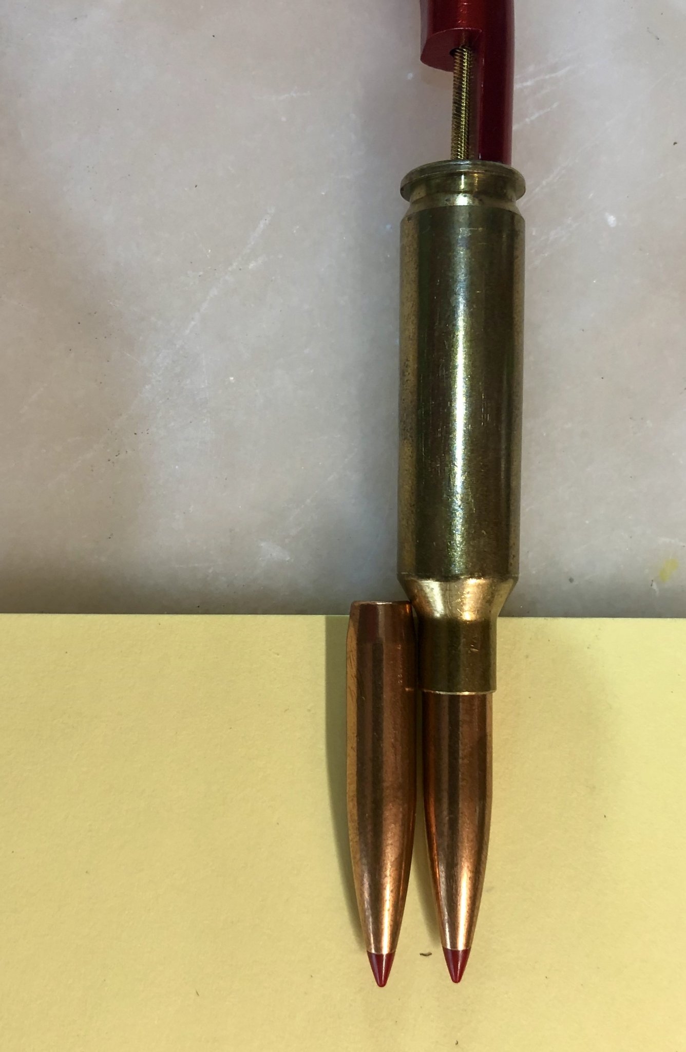

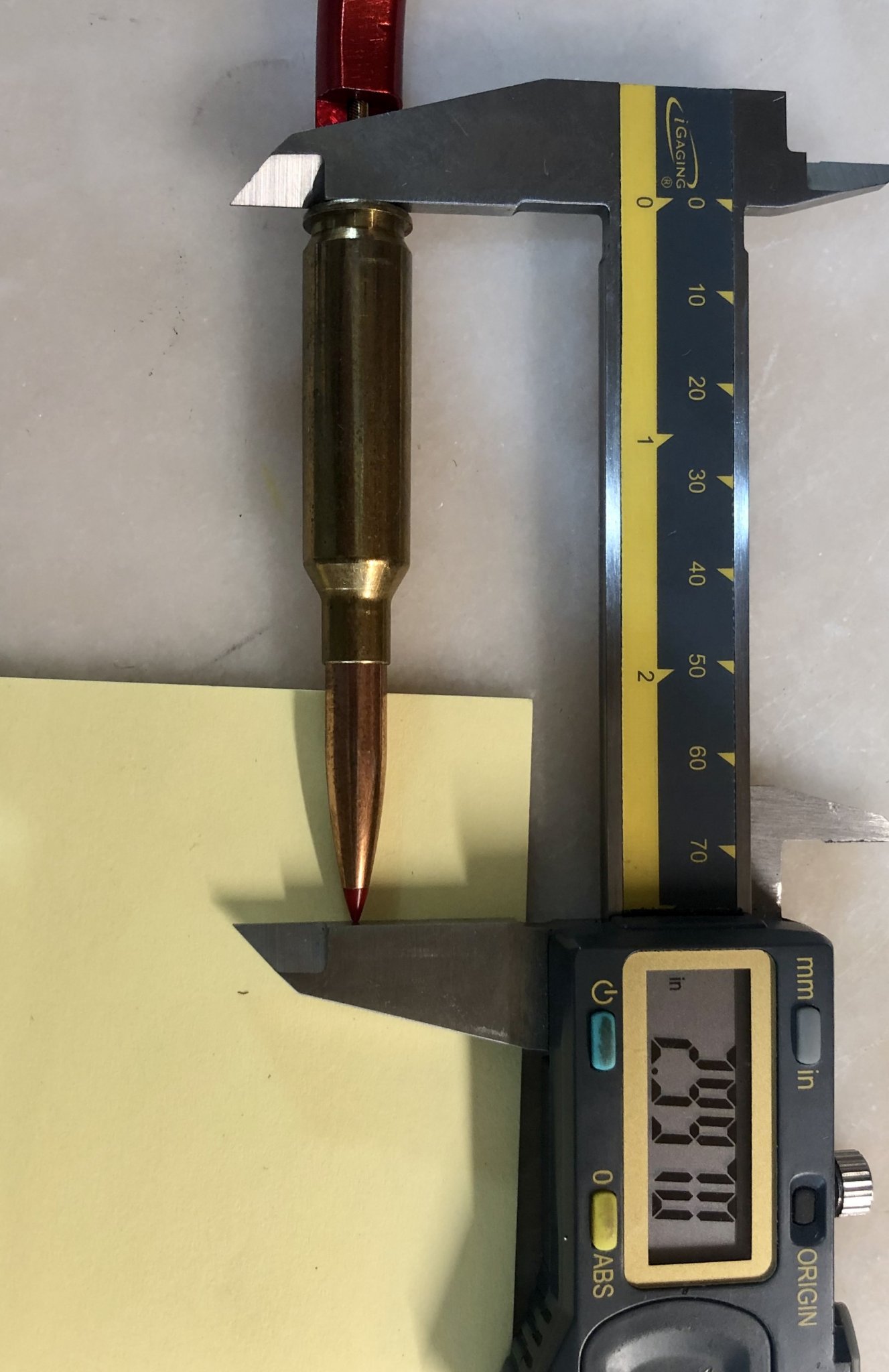

Maybe i’m just a hopeful soul, but: Just checked and a Hornady 147 gn ELD-M can be loaded to a jam in this 8 twist barrel. Maybe there is another 500 rounds of adequate accuracy in it.... or not, but i am very tempted to spin it back on the rifle now that the carbon ring has been cleaned out.
Will not feed from the mag (2.997” COAL), but happy to single feed, if i get adequate accuracy again.... Would make a good long range hunting rifle, even if the speed is a little lower than desired, as long as it has ES below 30 fps.
Am i being overly enthusiastic?

View attachment 7189583View attachment 7189584
There is no need to jam that bullet. Seat it back about 2.860" and you can load from AICS mags and get good accuracy. I shoot factory ammo that is jumping .090" and it's very accurate.

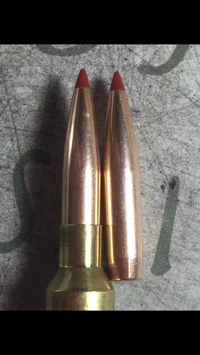

Hi Rob, thanks for the advice. Got good accuracy with this barrel before with 20 thou jump. Tried it once with a jam, and the gun did not like it. Kept chasing the lands as they wore out, and eventually the 140 Berger could not get that close to the lands anymore, without falling out of the case.
At that time, 140 gn projectiles were the heaviest and longest available for 6.5 CM. Since then the Hornady 147 ELD-M and 153 A-tip and the Berger 156 gn became available, so i can now chase the lands again with these longer bullets. [It is an 8 twist barrel, hope it will stabilize these long heavy bullets.]
I deep cleaned the barrel over multiple days, and a lot of carbon came out. Amazing what is left inside a “clean” barrel when you put a bore scope in there. There was defintely a carbon ring in the chamber as well, but the entire barrel had severe carbon fouling. Too much RL-17 perhaps. Such a dirty powder.
So really hoping the extreme carbon removal cured the erratic speed issue... and that the barrel can become the basis for an accurate hunting rifle.
This is what a dummy round looks like when loaded to a 20 thou jump with the 147 ELDM... Bordering on the ridiculous, but what do i have to lose....
My point was you don't have to chase the lands. The ELDs can jump. They don't need to be .020" off although they shoot good there too. Something you might think about though is your barrel might be coming to the end of it's life if it has moved that much also.
Also that dummy round doesn't look ridiculous. That's about 2.870" if your almost 3" touching distance is correct. I load mine at 2.860". I load the 140 ELDs at 2.850".
As for final finish, no don't use it on that barrel. Final finish is made more for factory barrels. If you wanted to try something the TMS rounds are what i would recommend. A much finer grit and it will smooth but not remove a bunch of material. Make sure the bore is cleaned very well before using them though.

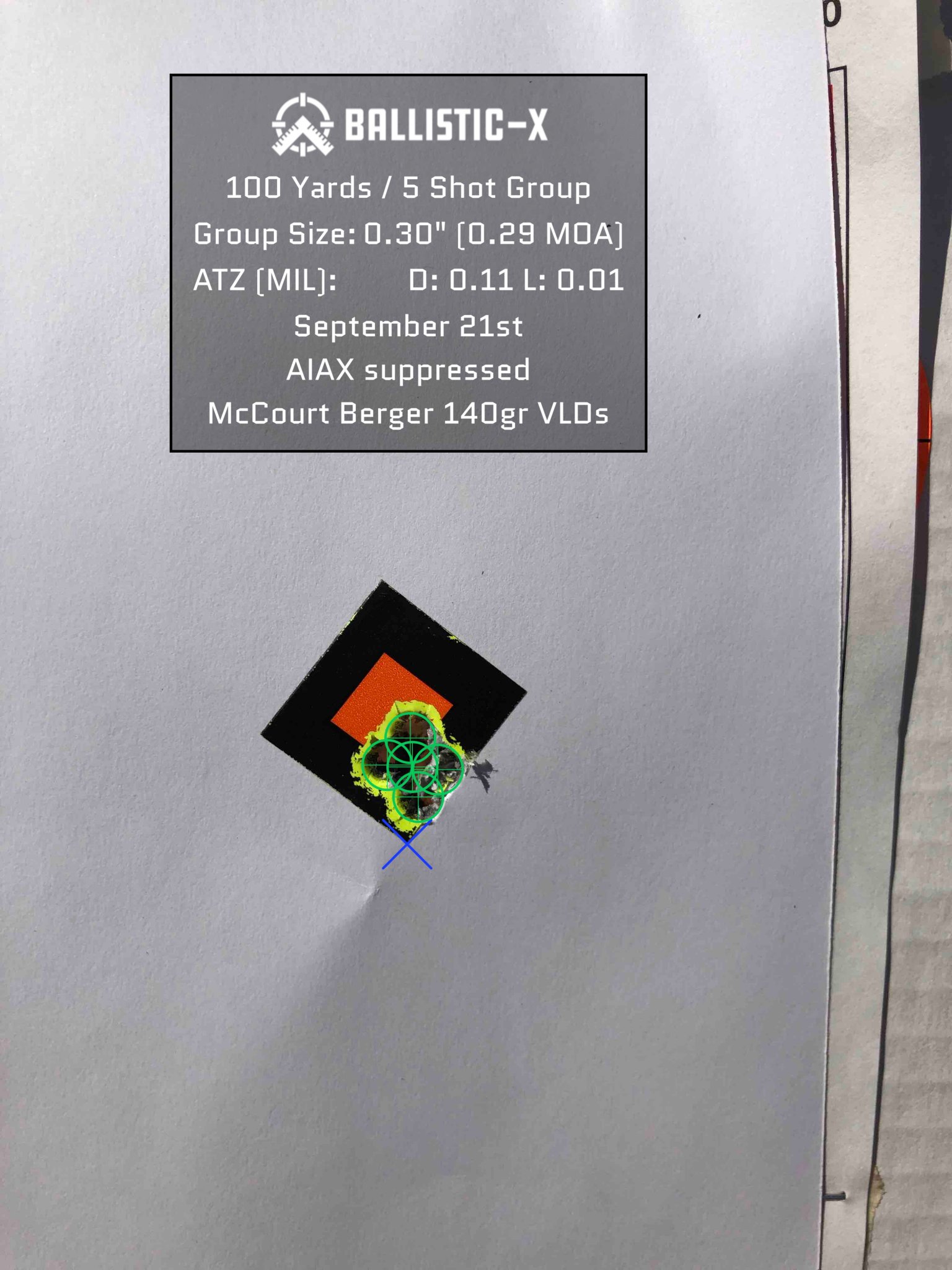

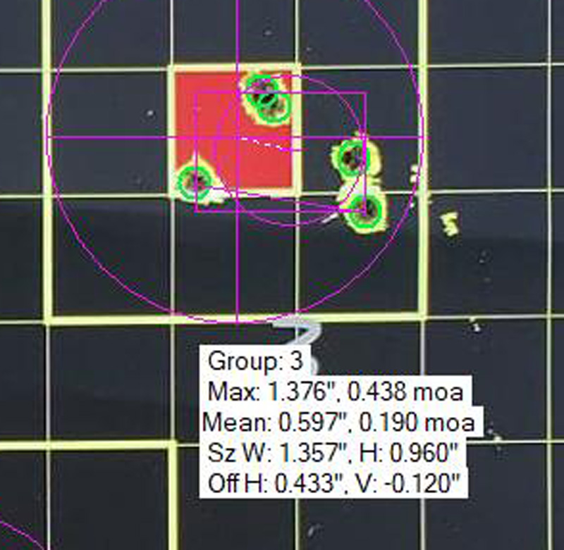

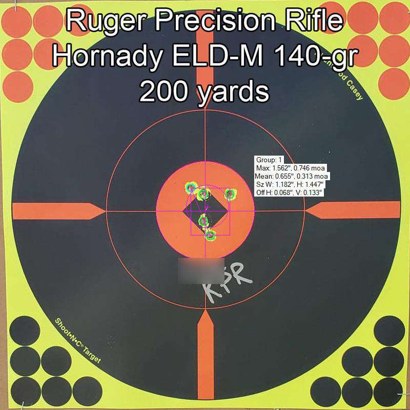

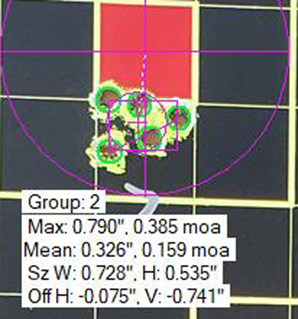

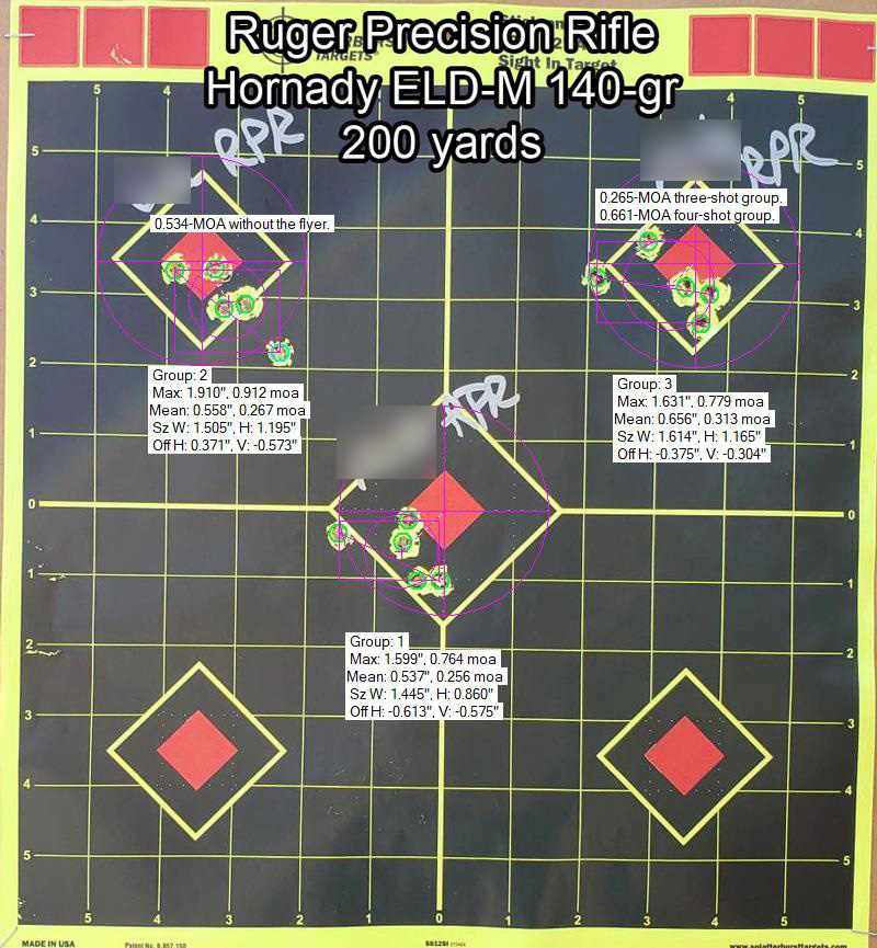

I've posted about this on other threads, but this thread is specific to the subject. I've got 3,259 rounds, to be precise, through my Ruger Precision Rifle 6.5CM with the original barrel. And, it's still doing this with factory ammo (the last few range trips):
100 yards:
200 yards:
300 yards:
I'm eyeballing a Krieger barrel to replace the OEM barrel. But, damn... it's still shooting well! I'm calling it the "Hannukah Miracle Barrel!" It never burns out! :geek:
Reactions: Darqusoull13
Very impressive sir! Any barrel that consistently shoot 0.4 MOA or better is very respectable. A 6.5 mm barrel that does that with 3200+ rounds down the tube is seriously impressive!
How far has the lands moved forward during this time?
What powders are you using? Presume no hot loads ever.... what do you think caused the exceptionally long barrel life?

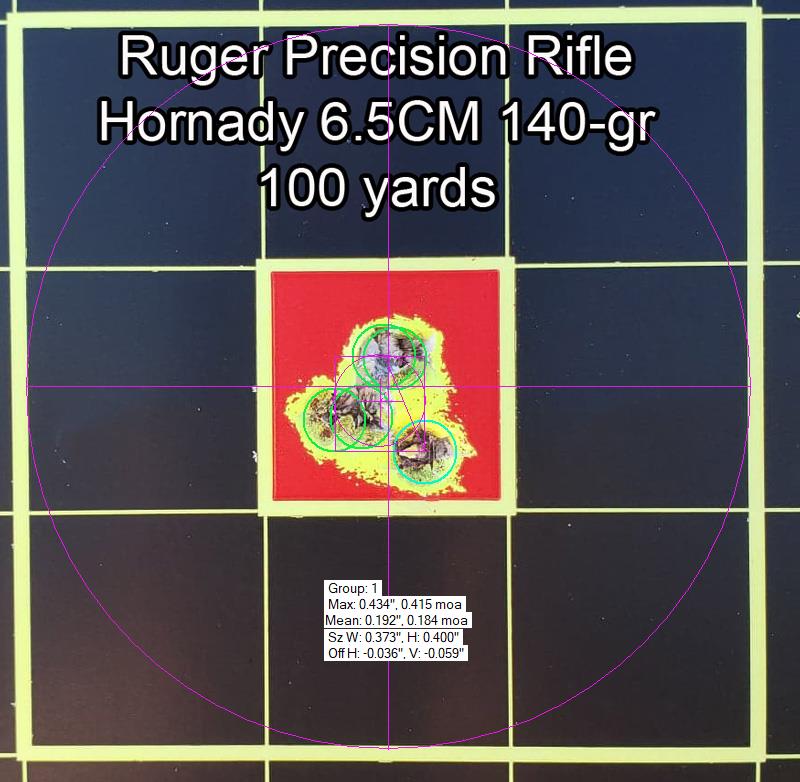

3,360 rounds as of yesterday. And, even though I didn't feel like I was "on" (just wasn't shooting my best) plus I had removed the muzzle brake in anticipation of a match next weekend, it was still capable of this. My name and my daughter's name have been redacted. We shared this target. :)
My daughter's last target for the day, yesterday:
I don't reload. Factory match ammo, only. No idea how far the lands have eroded. :) Perhaps of note: I don't clean it very often... usually around 400 - 500 rounds between cleanings. A few passes with a nylon brush and then just patches with BoreTech products.
We're going to take it to a 600-yard match next weekend. We'll see how it goes! :)

i probably did not clean often enough, which allowed a carbon buildup in the neck area of the chamber. That alone could explain the erratic speed... Cleaned around every 150-250 shots... What is ideal?
First pic is the freebore “before TMS” taken from the chamber side, second pic is “after TMS” taken inside the freebore. Raised areas have been (mostly) removed, and the shine was not there before. Used the Teslong bore scope.

I tried brake cleaner and bore tech carbon remover, neither touched the carbon ring I dealt with. I ended up using iosso bore paste as much as I hated to, not a fan of abrasives but couldn't come up with other ideas.
