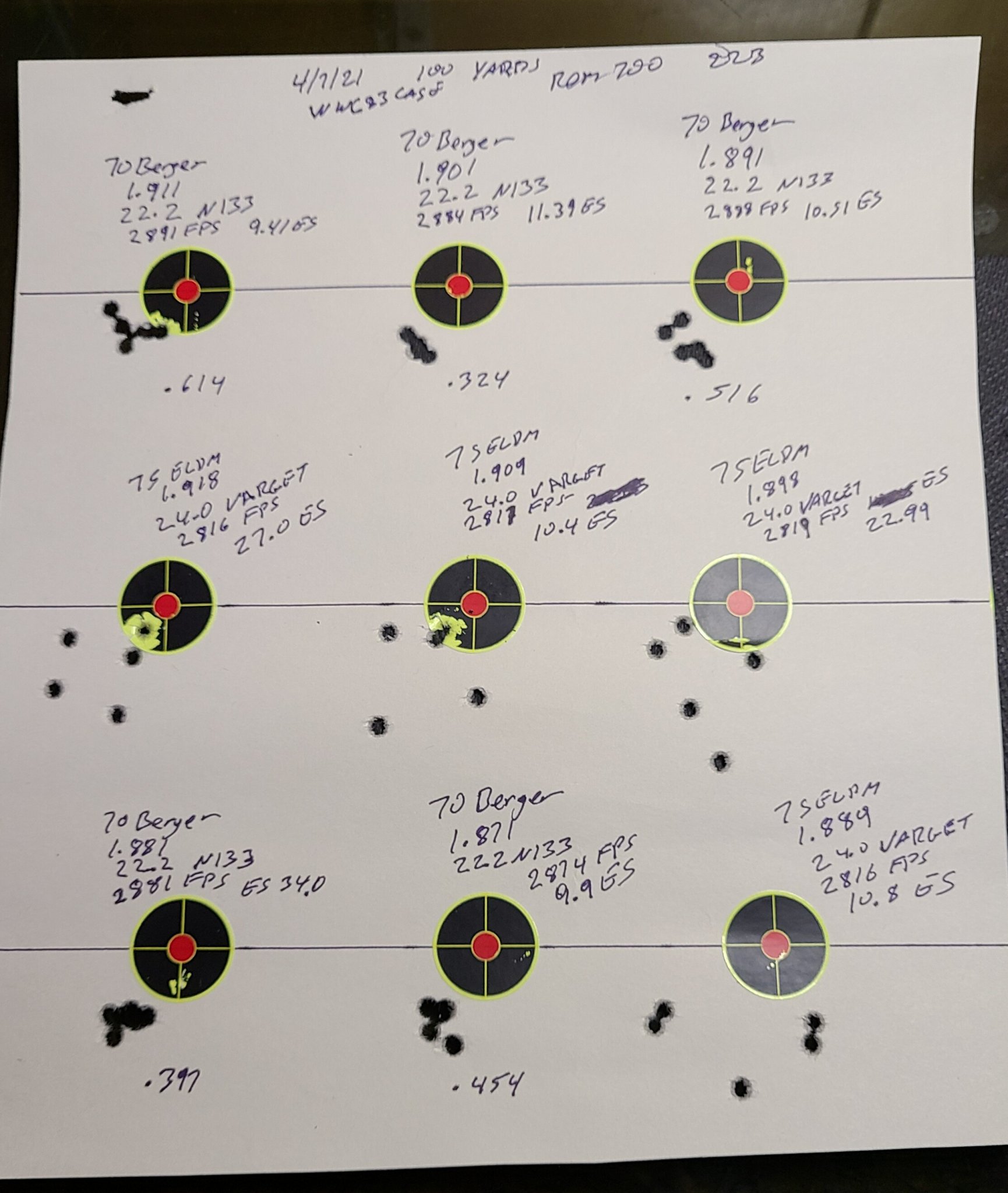

    Im running a 700 with a 223 Criterion Remage 7 twist. Shoots everything well so I bought some
    75 Eldm's and it just fell apart. Tried Varget, 8208 and H4895. Various jumps made little difference.
    So anyone have a Criterion Remage and shoot 75 ELDM's?
    What are you using?
    Today I tried 70 Bergers and 75 Eldm.

    What's your jam measurement? I see you're doing 0.009" increment then a 0.011" for the ELD-M but you only have 3 values in that set. Lots of people have good results at 0.02" off jam. Some even go as much as 0.05" off.
    I have a 26" Criterion 1 in 8" twist with a Wylde chamber. It LOVES both 73gr & 75gr ELDMs. I use the same powder charge for both bullets and am getting 3025fps & 2985fps respectively. It's been awhile since I measured the jump but I think it was 0.010in or 0.005in. I am using MDT polymer magazines and seating the bullets VERY long 2.545in.

    It makes sense if OP is doing a seating depth test before a powder charge work up. Although there's not enough sets of data on the seating depths and the increment may be too large. Although I'm leaning towards not enough jump. His Bergers are jumped much further based on the CBTO's listed.

    Tried different powder charges with three powders almost no difference so I tried jumping .010 to .030.

    If a bullet is shooting 2 moa with an arbitrary charge weight, I am not doing to do a full work up with it. Its not going to tighten up top shoot like the other load. IMO.
    I'm fairly quick to write stuff off that doesn't work and not waste time with it. And I'm not telling you what to do, just sharing some experiences I've had. I have made the same bullets, primers, and cases at the same seating depth shoot 20 shot groups that were 0.45-0.6 MOA all the way up to 2-3 MOA by adjusting powder type and charge weight. No bullshit, all within the expected burn rate for the cartridge, all within published load data. FWIW I've never experienced a "high node". Good powders have a flatter slope, but all of them that I've tested dispersion increases with increased powder charge. So often if something is not shooting great, I'll drop a grain and see if it helps dramatically. Sometimes it does.
    After having seen the aforementioned 0.5-3 MOA from the same components, I will try 2-3 different powders before I nix a bullet for a particular barrel. And it's not always bad bullets. Sometimes they just aren't happy with something that happens in that barrel and will shoot fine in another. Throat geometry, twist rate variation, bore/groove ratios or dimensions, etc...
