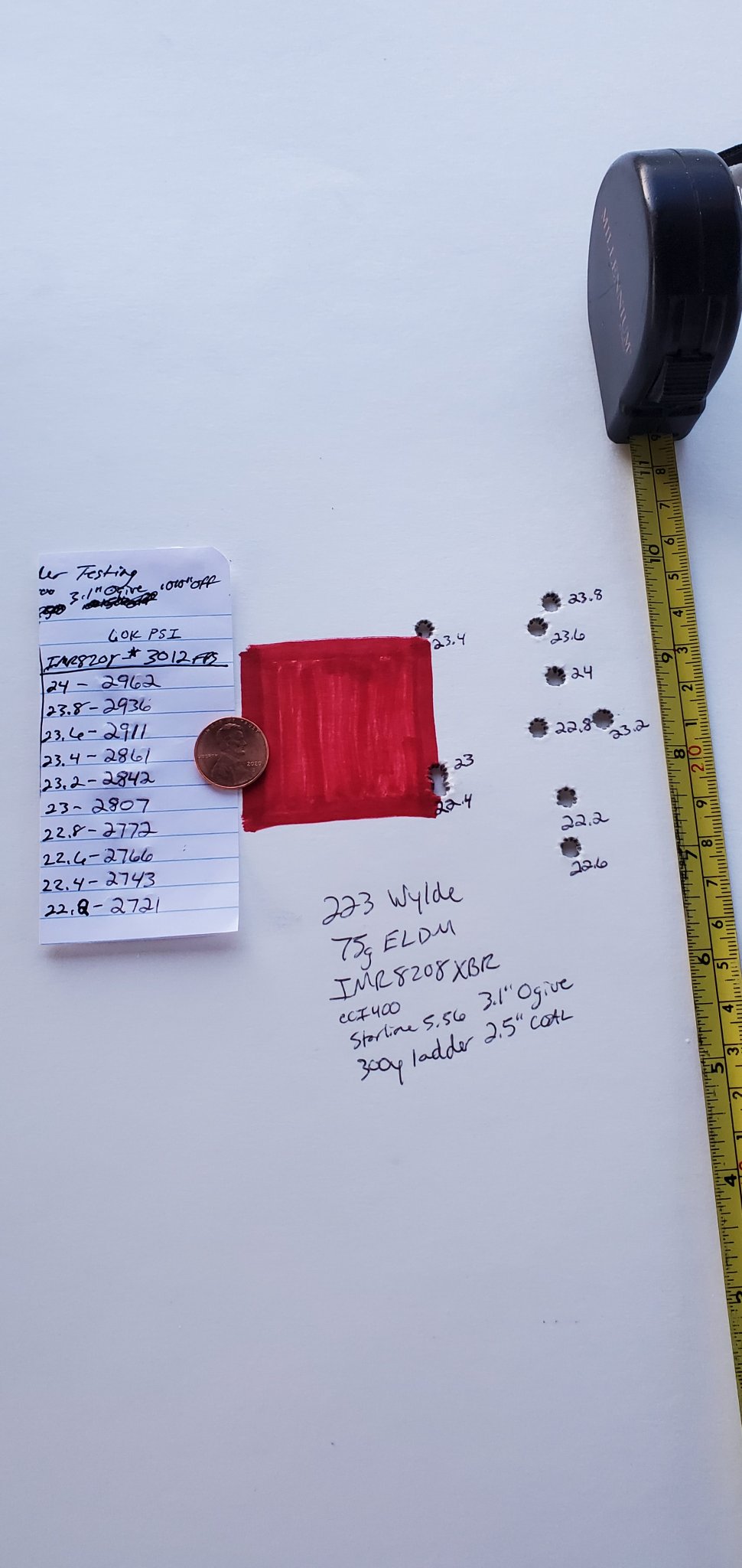

This is 8208/75g ELDM since your patiently waiting...I'll get to the others a bit later this evening.
Reactions: Mauser48

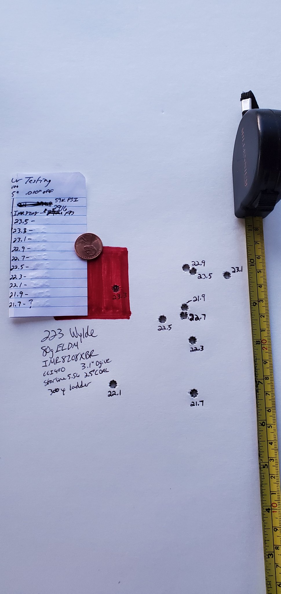

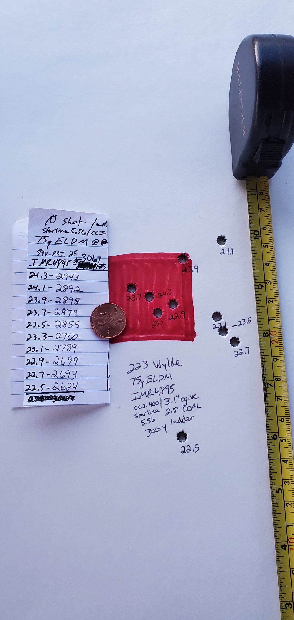

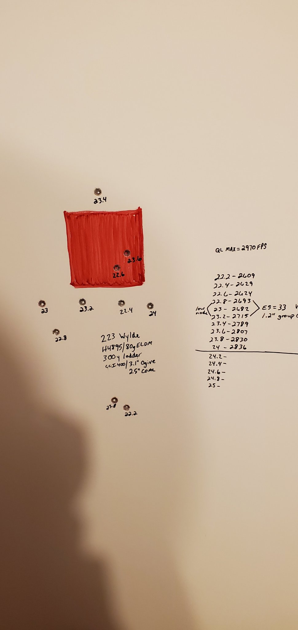

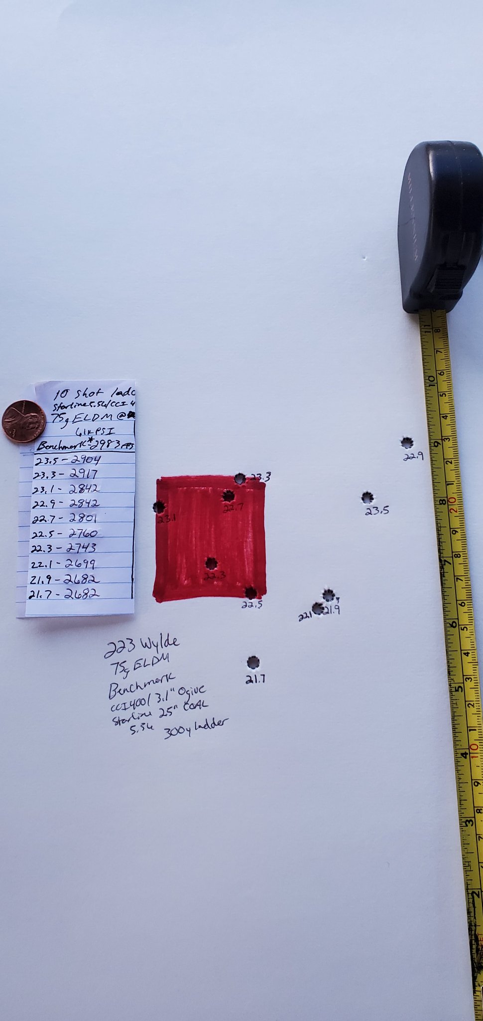

Here are the all the ladders for review. 8 total, with 4 powders (IMR4895/H4895/Benchmark/IMR8208XBR) and 2 bullets (75/80 ELDMs)
I'm just going to concentrate on the 75s from here on out. I have 82 rounds down the barrel now. Will do a light cleaning of the barrel and shoot the remaining 120 virgin cases with IMR4895 and the 75s to get the 200 cases fireformed and barrel broke in. Then I'll start tweaking the loads.
80s
Battery died on the last ladder of the day here. Not a huge deal, 80s shoot like shit and slower than dog shit anyway...
75s

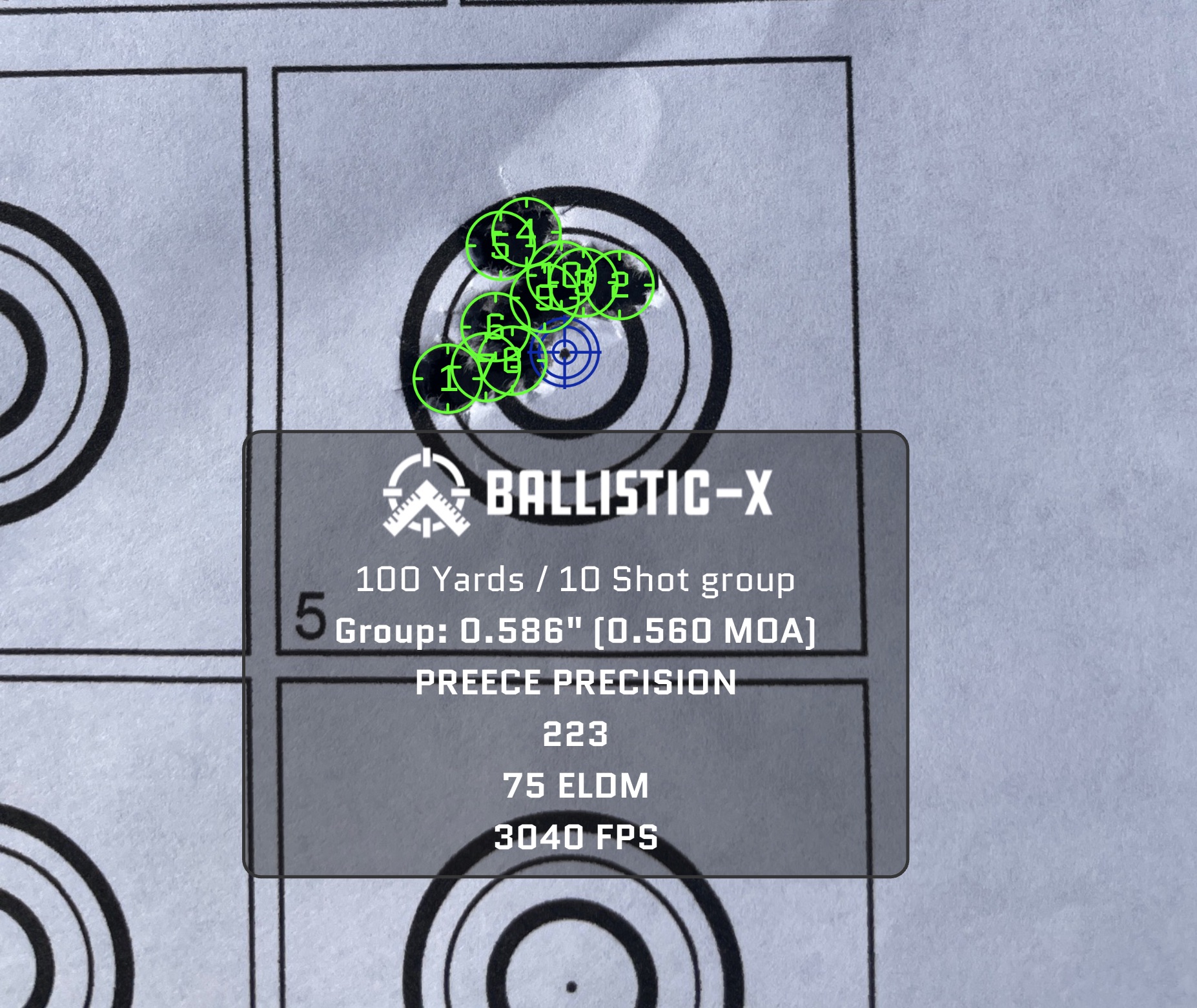

I run 75s in my 26” 7.5 twist Bartlein with 25.5 grains of Varget at 3040 fps. My ES sometimes is higher than I’d expect but it shoots so damn good even at distance that I just quit caring about the numbers.
That load killed two rock chucks over 1200 yards last spring. I would never have believed that was possible with “just a 223”.
