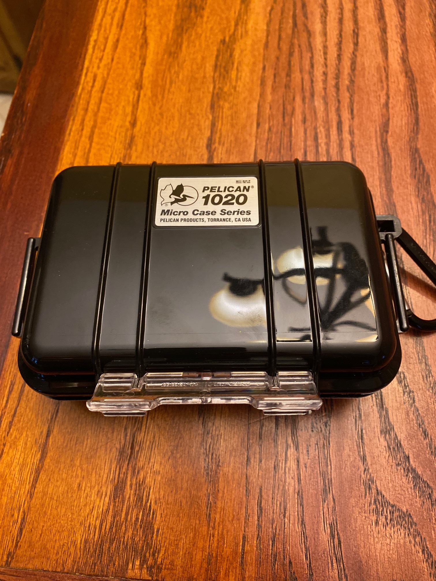

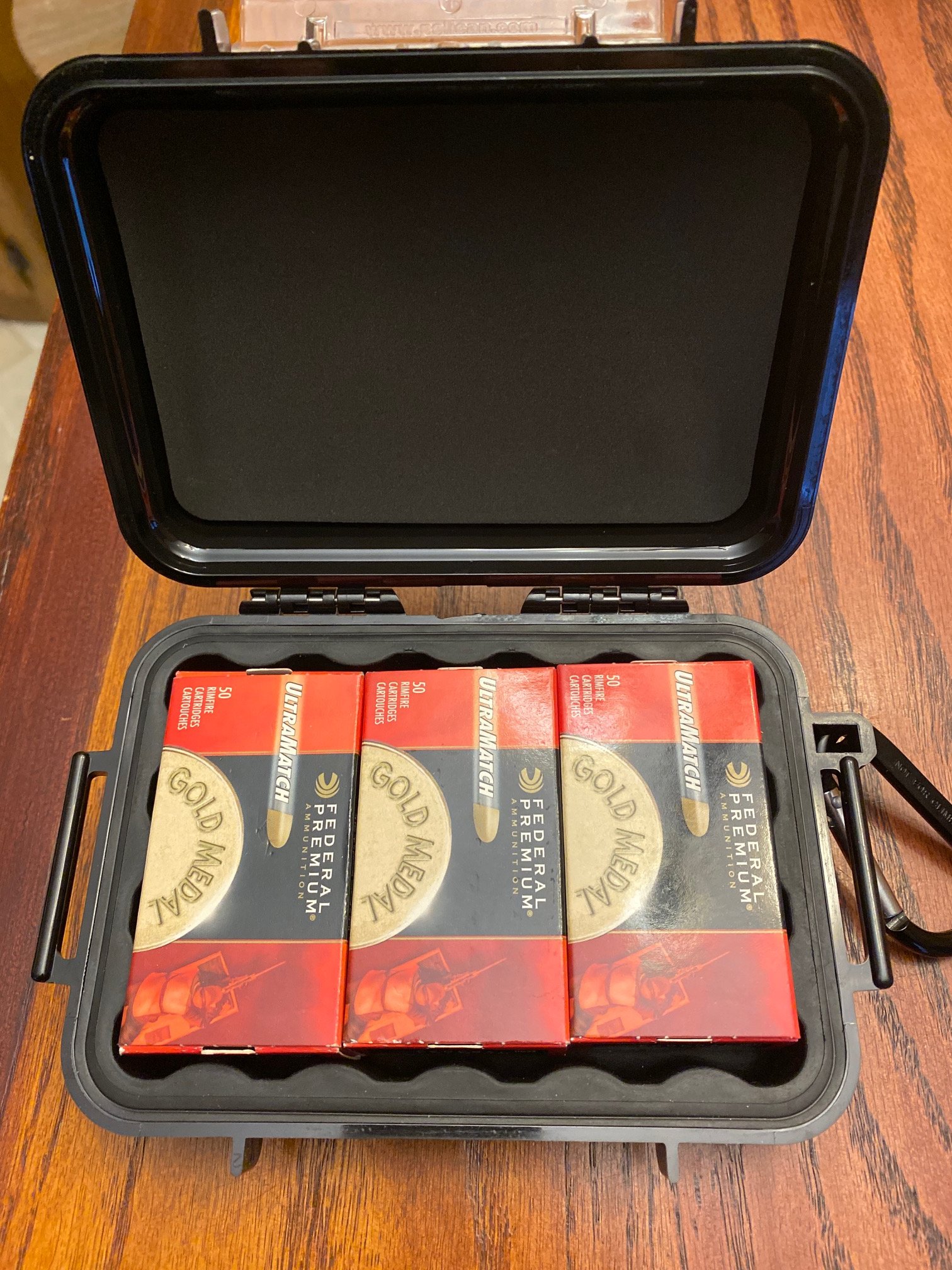

Hey guys, I have read a number of threaded about temp sensitivity of .22lr ammo. I intend to verify my temp sensitivity shortly via the use ammo at ambient temp, use ammo from out of a chilled cooler method.
I have heard about, but not found, a "storage box" that you put handwarmers in to keep ammo at a consistent temp. Are people using lunch boxes, pelican cases, the inserts from Grey Ops or something different to accomplish this task?

Just get something that will hold a consistent temp. I have found that a good temp controller is a mason jar full of hot water in a cooler/thermos. It will maintain a consistent temp for quite a while, and is reusable.

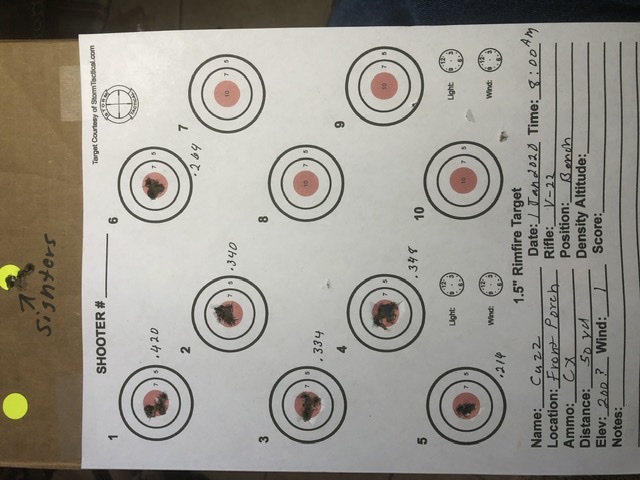

i put mine in my pocket yesterday when shooting this at about 45 degrees f.
i just realized target was only 50 yd, longer range would probably give more vert stringing.
I use an empty box from 500 Lapua 6mm bullets, with a cloth pad and a coupla "Hot Hands" hand warmers. It'll hold 2 boxes of .22LR. Seems to help but I really don't have any hard data to confirm it. I just figger it can't hurt and it might help.

Seems to me that accuracy drops off measurably somewhere around 40 deg. F. Not enuff to matter for casual shooting, maybe, but for benchrest it isn't subtle. The distance between the x (actually a dot) and the 9 ring isn't a whole lot.
