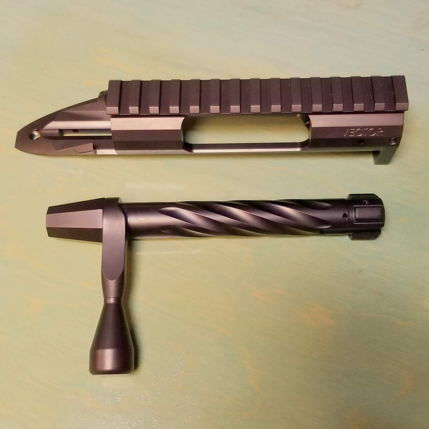

Anybody else receive one/get it built and care to share their impressions?

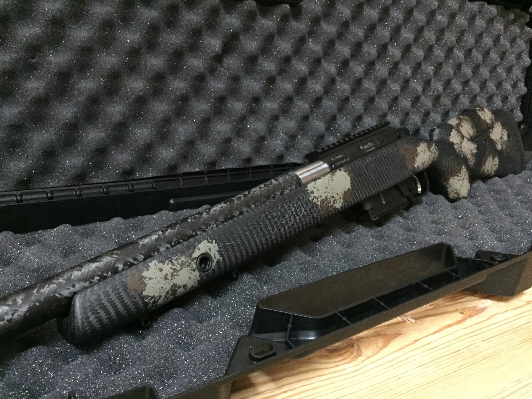

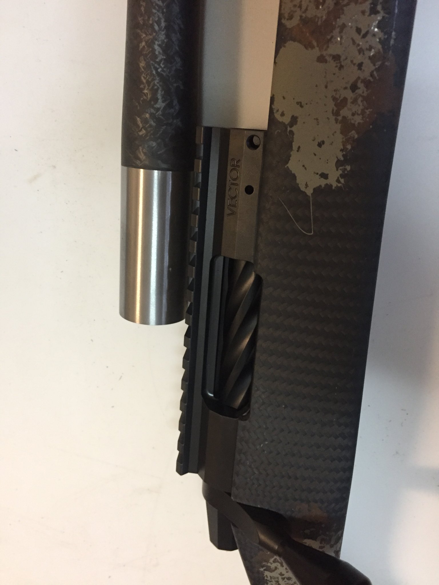

Here’s some pics and a quick video. I’ll do a full review as soon as my barrel gets here and I get some shots down range.

Any updates? Mine is at my smith being bedded and chambered now.
I've used it in about 5 matches now and it's amazing. I intend to do the full review after the AZ national match next weekend, but so far so good. Very smooth and I'm running AW mags. Took some slight bending of the feed lips outward but they run flawlessly. So nice to use AW rather than standard AICS.

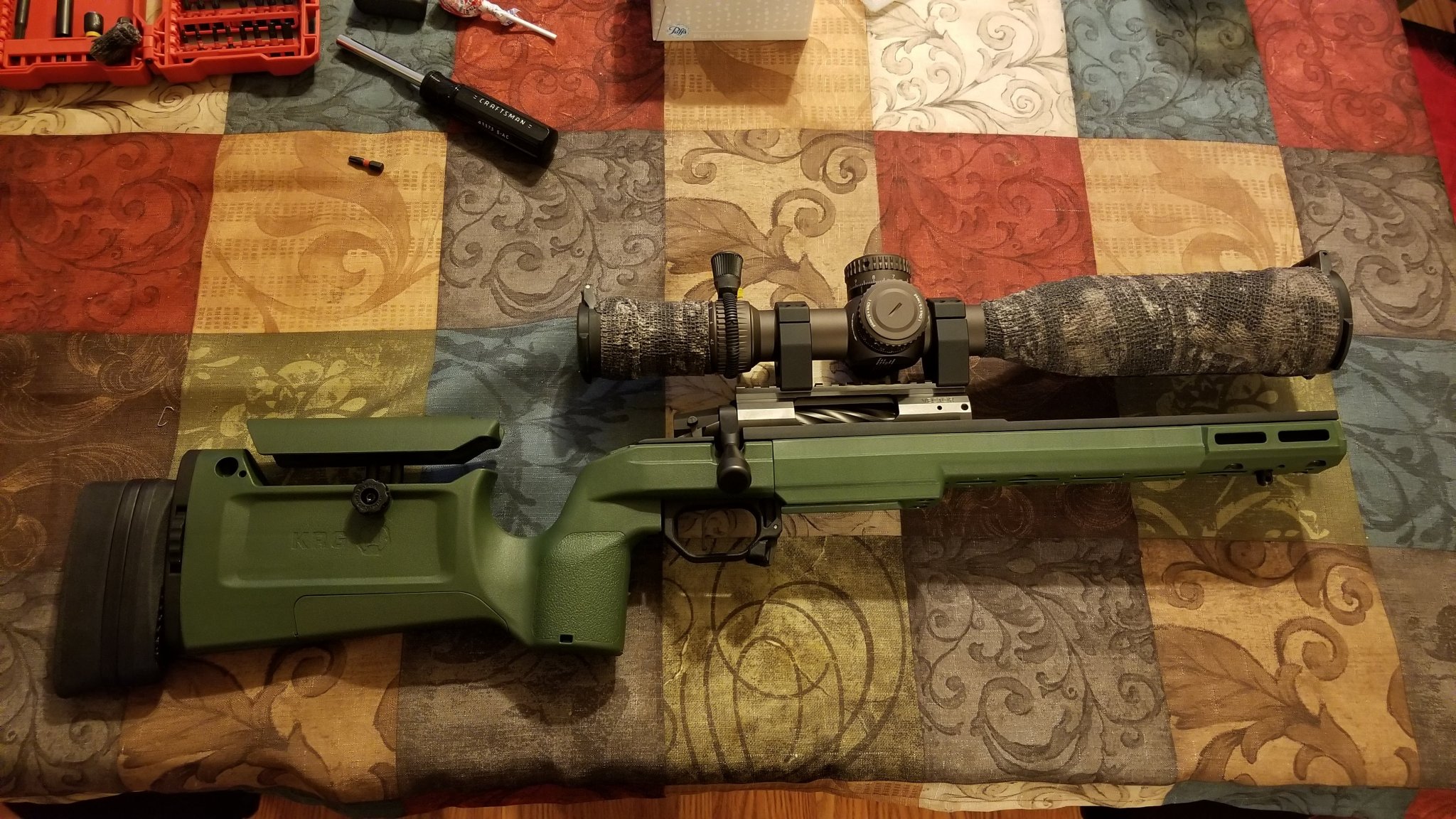

Here’s a teaser pic while I wait impatiently
Have you ever used/felt an Axiom? If so, what is your opinion between the two?
They feel the same when you run them. They also use the same bolt so very similar. Basically it’s the switch barrel capability, integrated recoil lug, integrated rail, and styling differences. Those are just my observations, not sure if there are more differences or not.
It looked like on early versions of the Axiom at least, they were trying to save material by having their bolt knobs thread INTO the bolt handle. Have they changed that to a male threaded shank on the bolt handle that you can thread a typical aftermarket knob ONTO ?

My vector bolt knob threads into handle

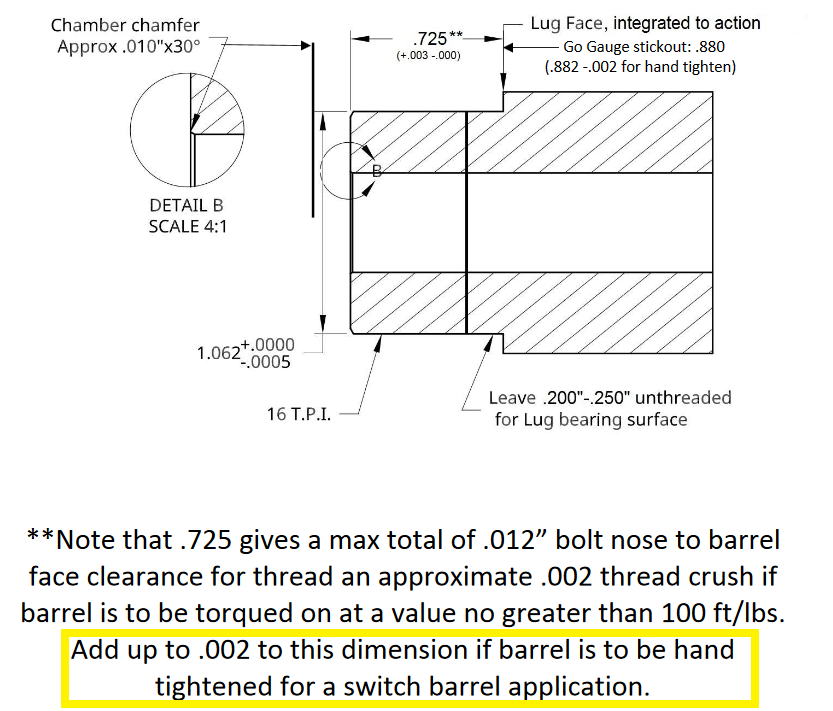

I remember reading (prior to them coming out) that if you didn't want to do the hand tight and set screw route, you could instead torque the barrel on as a normal action. Is this still correct with the production run models?
Yes, can just use regular remington threaded barrel and use barrel nut. Just have to set the barrel dept.

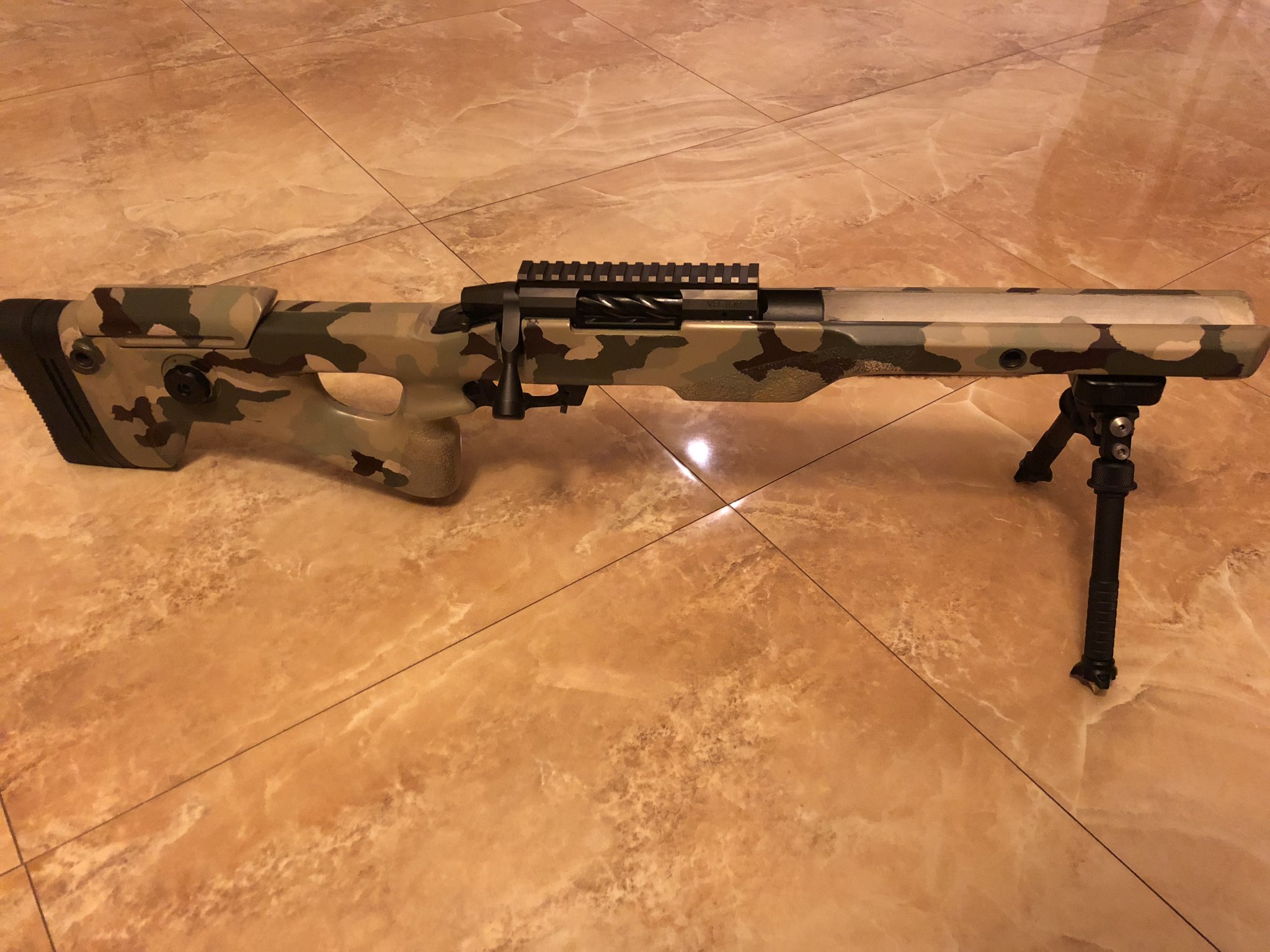

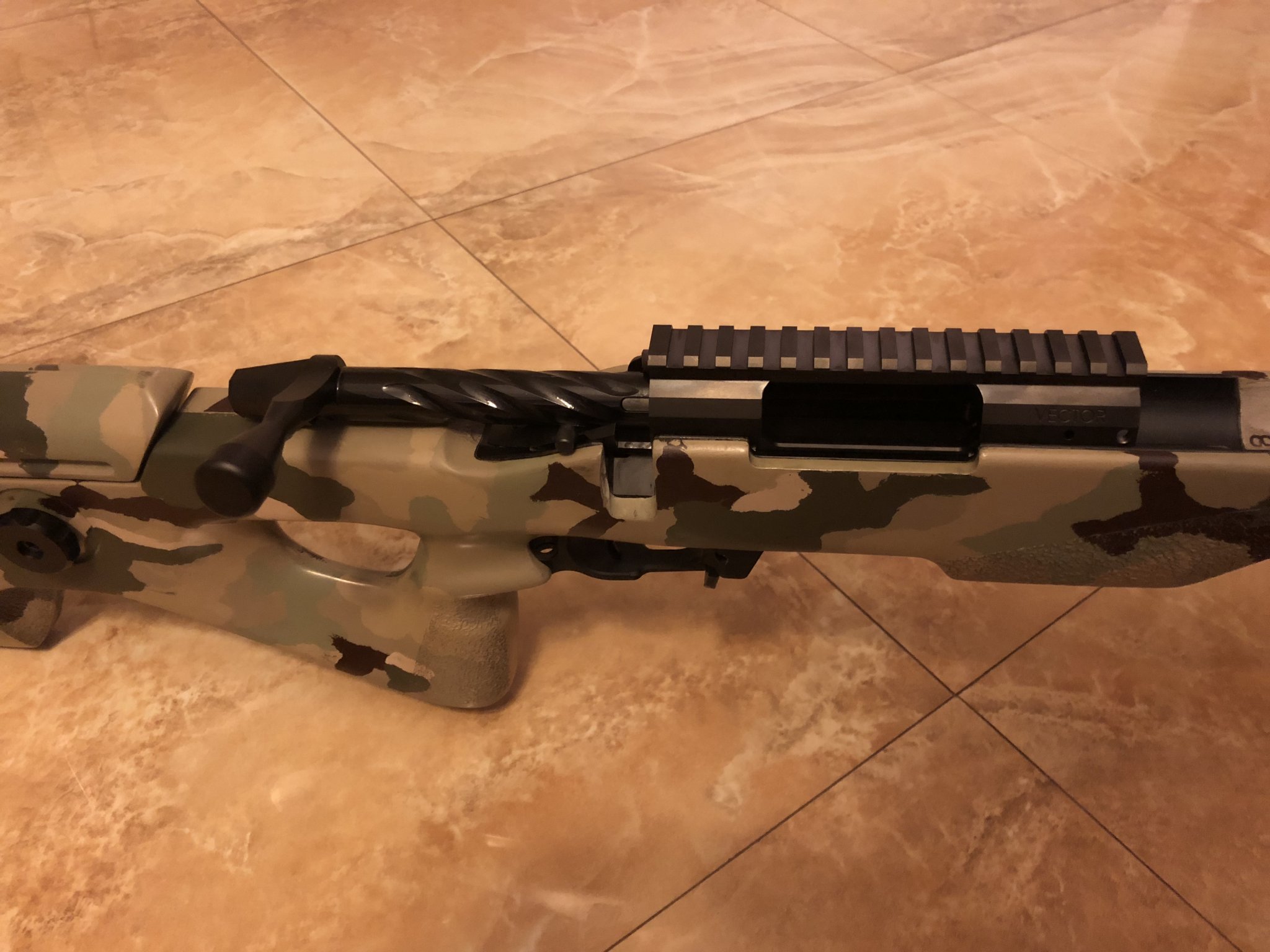

Vector came in today. Nice redeployment present. Got 1 barrel in 6.5 creedmoor and the other in 223 wylde. Got to trim down my mag latch on my chassis so the bolt doesnt drag on the magazines lips. Other than that Can't wait to shoot this thing this weekend. And start load development.
