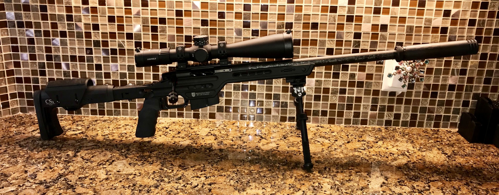

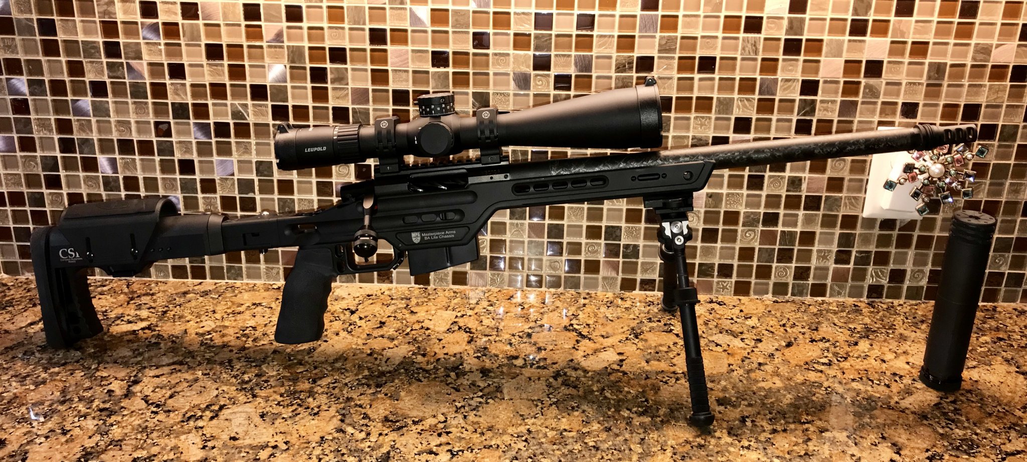

I just picked up a brand new vector build by Alamo from a member that I stumbled across while looking to buy an action. I’ve been shooting AI’s almost exclusively the last year and a half so I really wanted the 60° bolt. I am very impressed with the vector after getting it here. Finally got to shoot it yesterday and it didn’t disappoint! Bolt lift is awesome for a 60° and it’s very smooth. Ejecting cases I noticed it is different than any action I’ve had it tosses them very consistent into same place regardless of how I run the bolt. The AICS mag I was running in the MPA chassis needs some adjusting but when I got home I tried my AT mag since the action is AW cut and feeds very nice and no slop like the AICS mag had in the mpa, I’ll be going that route. I’m very happy with my purchase and so far my only minor gripe is the bolt is very tight to remove out of the action as the lugs come through back of action but that is being very critical. I think I found my new favorite action and I’m really excited to see the new long action helix being released for a 338 Norma build I’m waiting to do.
Mine has trigger tech diamond which seems like a great trigger. I had thought I’d swap it for a two stage being that’s what I’m used to but I don’t think I will.
You're not being overly critical. Mine had the same issue. Joel corrected it with a few swipes from a fine file at the 12 o'clock position where the top lug enters the action. All it needs is a tiny chamfer and the bolt slides in and out easily. You probably have an early version of the Vector. This was corrected in the current version. Contact Joel, he'll either talk you through it, or fix it if you ship it to him.
It's an outstanding action with a number of innovative refinements. Joel's a stand up guy, he'll take care of it.
Can't wait to shoot this rifle, I have an 18 inch 6.5cm and 16 inch 223 barrel, ready to go. Would like to try a 22 inch 224 in the near future.
