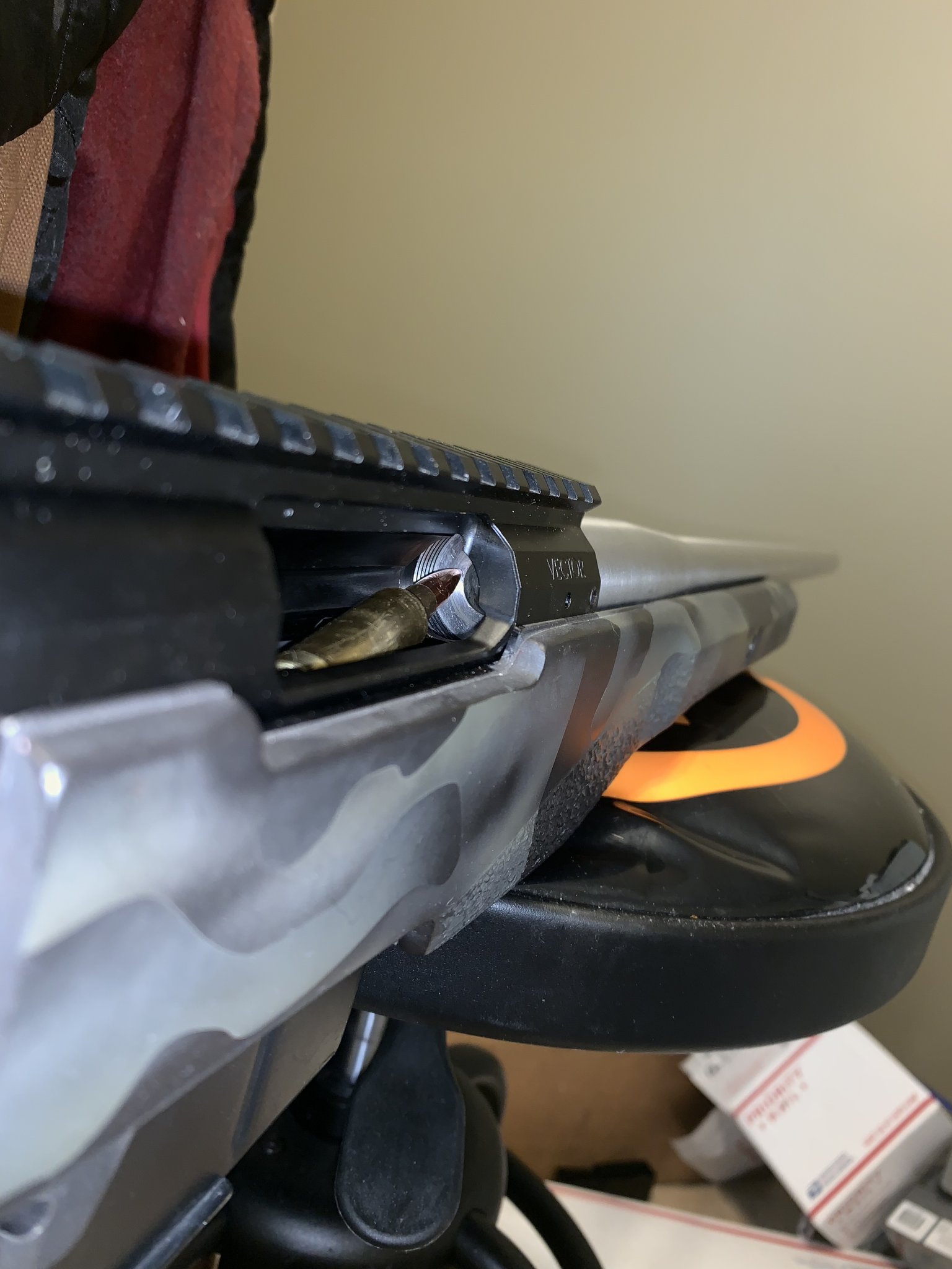

    Why can’t you run AWs?
    Minor filing allowed it to catch.
    But now I’m having issues with either
    A: bolt riding over round
    B: some rounds angling too high on feed ramp and missing the chamber
    Did you have either of those issues in the sentinel?
    I had an issue where my 2nd last round would hit the feed ramp and not feed. I opened up the feed lips slightly. Haven't had any issues since.
    You opened the lips on the mag? Front, back, or evenly?
    Here’s a pic of a round that missed the chamber. It was on right side of mag and missed left.
    7104666
    Yup looks similar to mine. I opened it up in the middle evenly and it fixed itself. I just used needle nosed pliers. Only opened it a very minor amount. My second to last round would always go left and miss the chamber
    Got it working. I took note where the back of the casing was in the mag when it would malfunction. Took needle nose pliers and opened the mag lips from that point forward.
    Feeds perfectly now.
