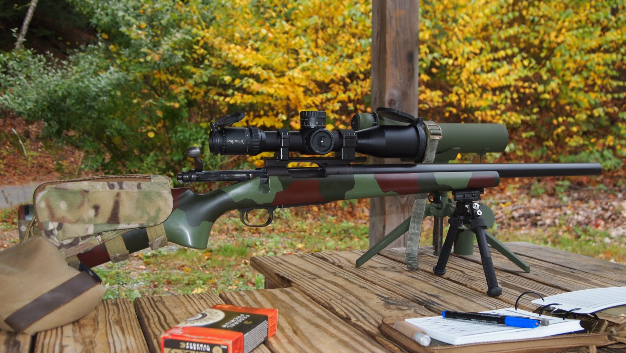

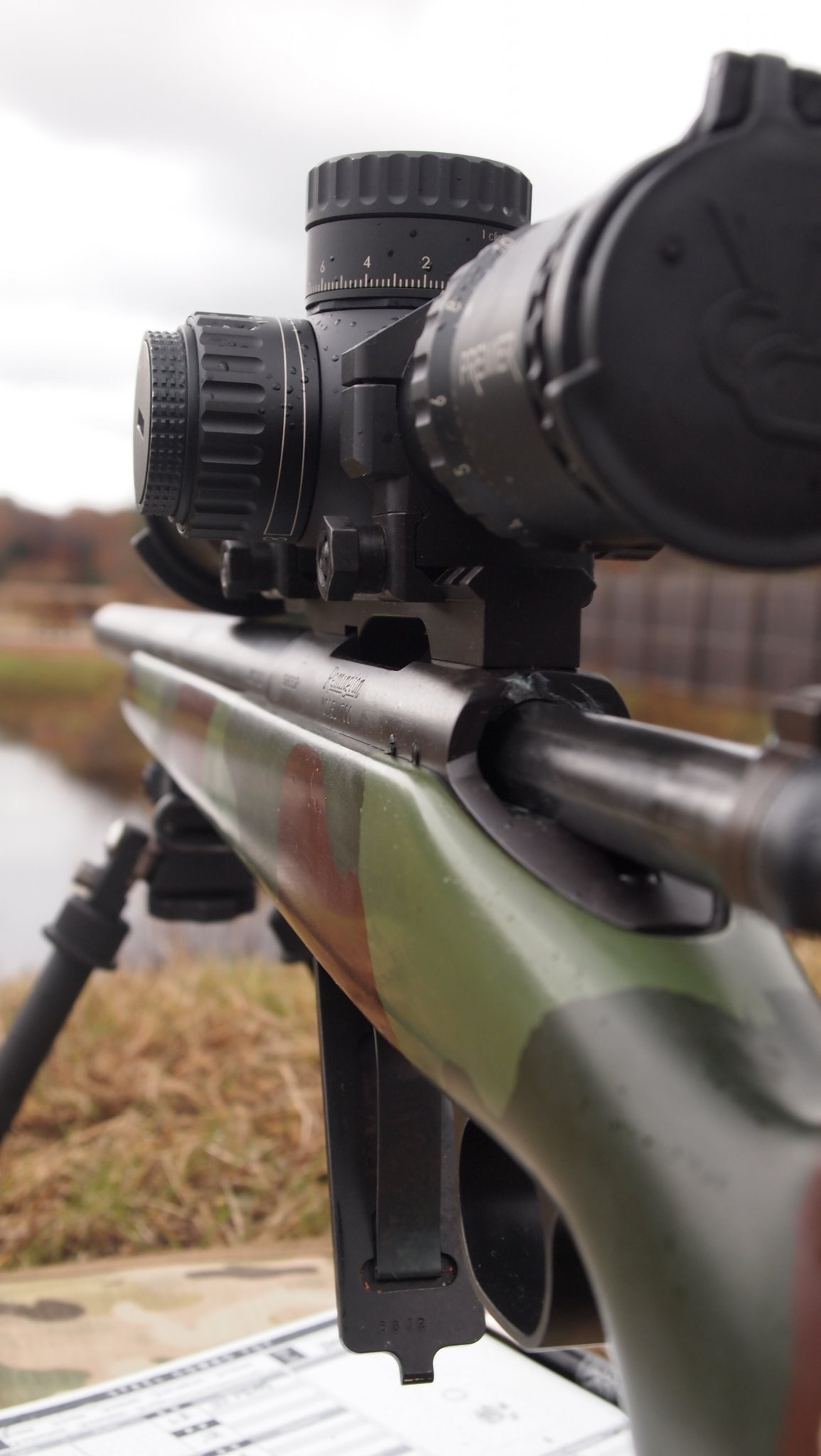

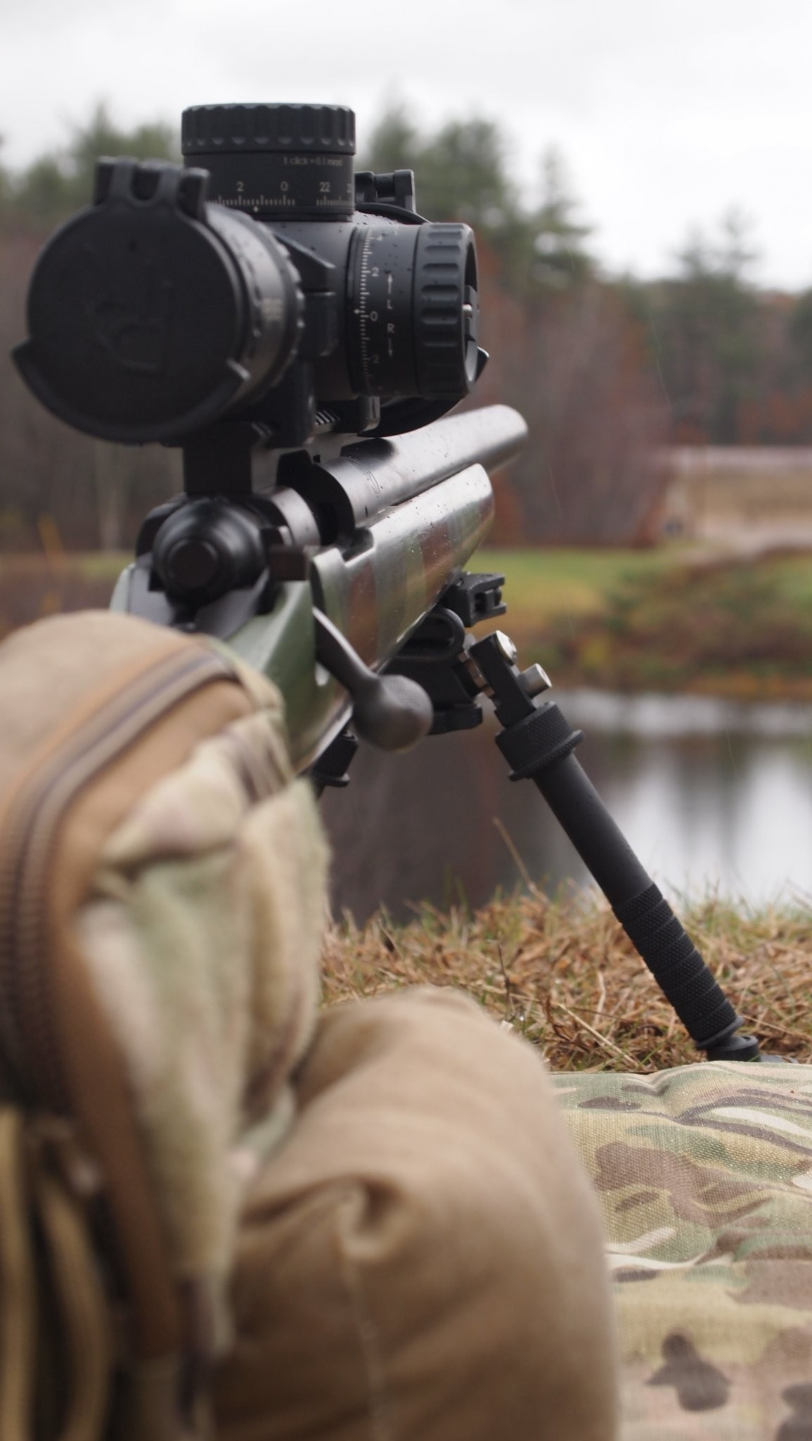

Build a custom R700 in the M40 style is my vote.
3 to 5 degrees of bolt slop from locked to pulled to the rear should allow any dirt to drop as long as you properly lube. Just beware the weak internal magazine design - fail to get one round just right you may either ride over the top of the round or bind on the feed ramp.
Otherwise you want perfect feeding go with a Pre64 Model 70 or a Springfield 03 in 30-06. Their mags never seem to fail.
beware my advise though as I am a fool and me and my money frequently part.
