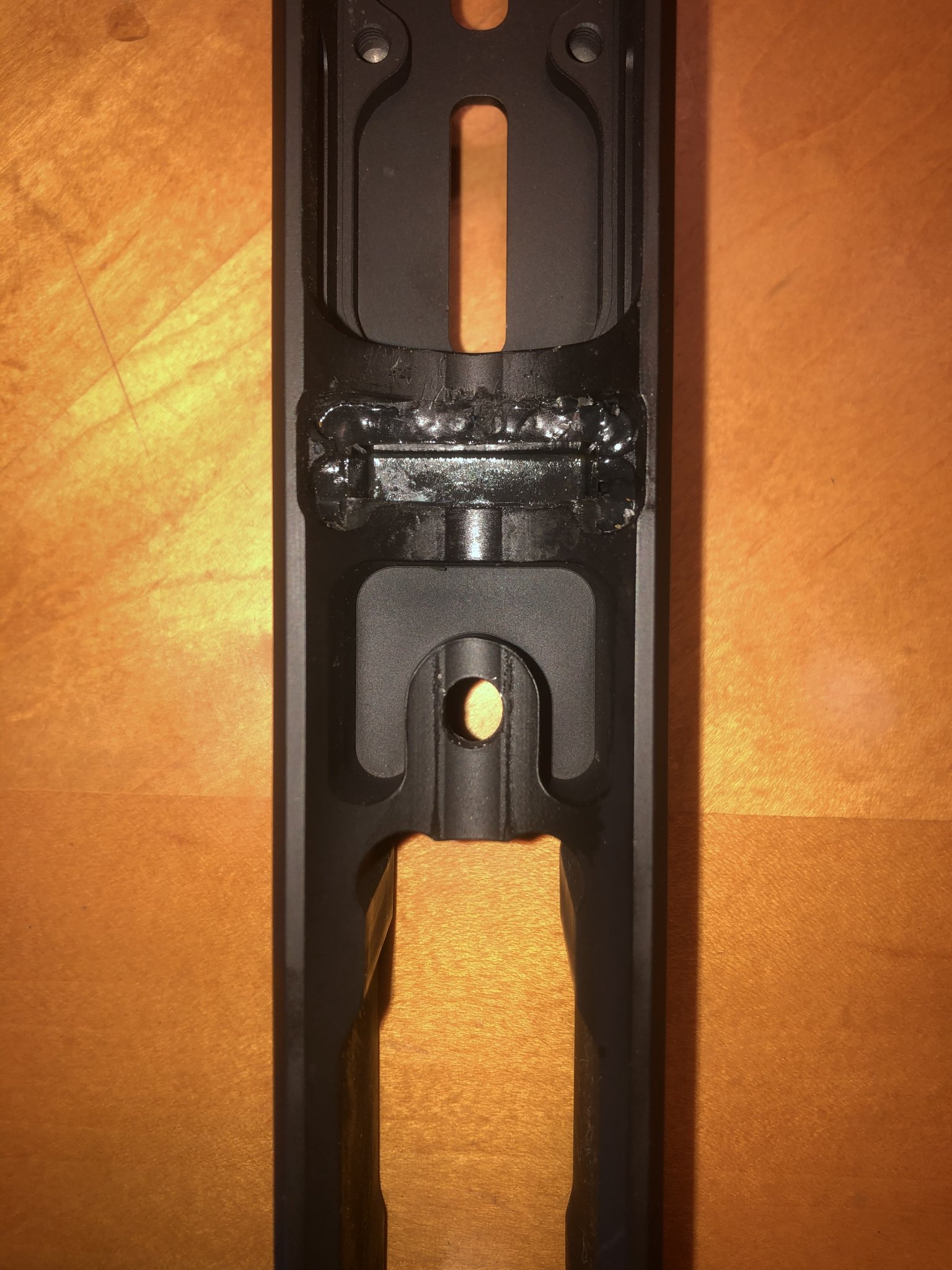

Here’s a pic of the bedding job on the recoil lug. Spoke with xlr today and I’m sending the chassis back to them to check it. The fact that the trigger isn’t centered in the trigger guard and leaning towards the same side as the barrel is making them scratch their heads too
I had completly forgotten about this thread since i have been just reading and not logged in for a long time.
I am not claiming to be a master at bedding like LRI and many others im sure but that is one ugly ass bedding job for just a lug.
If i had done that myself i wouldnt share pictures of it and sure as hell wouldnt want to charge someone for it.
