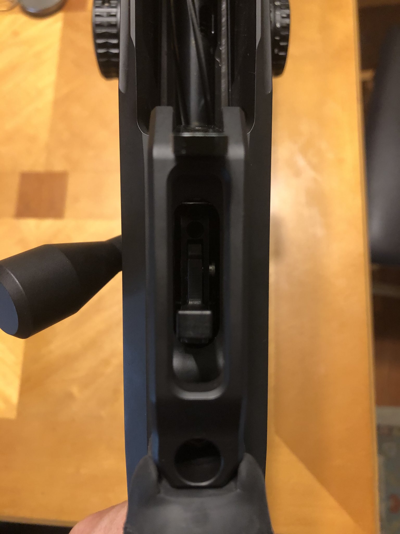

Custom bolt action barrel not centered with stock
Not sure. I just couldnt close the bolt handle with that round only. Maybe a faulty round? I set it aside and tried it again later and it still wouldn’t chamber. You can see the marking on the casing where it wouldn’t load properly. I’ll take a pic of the round when I get home

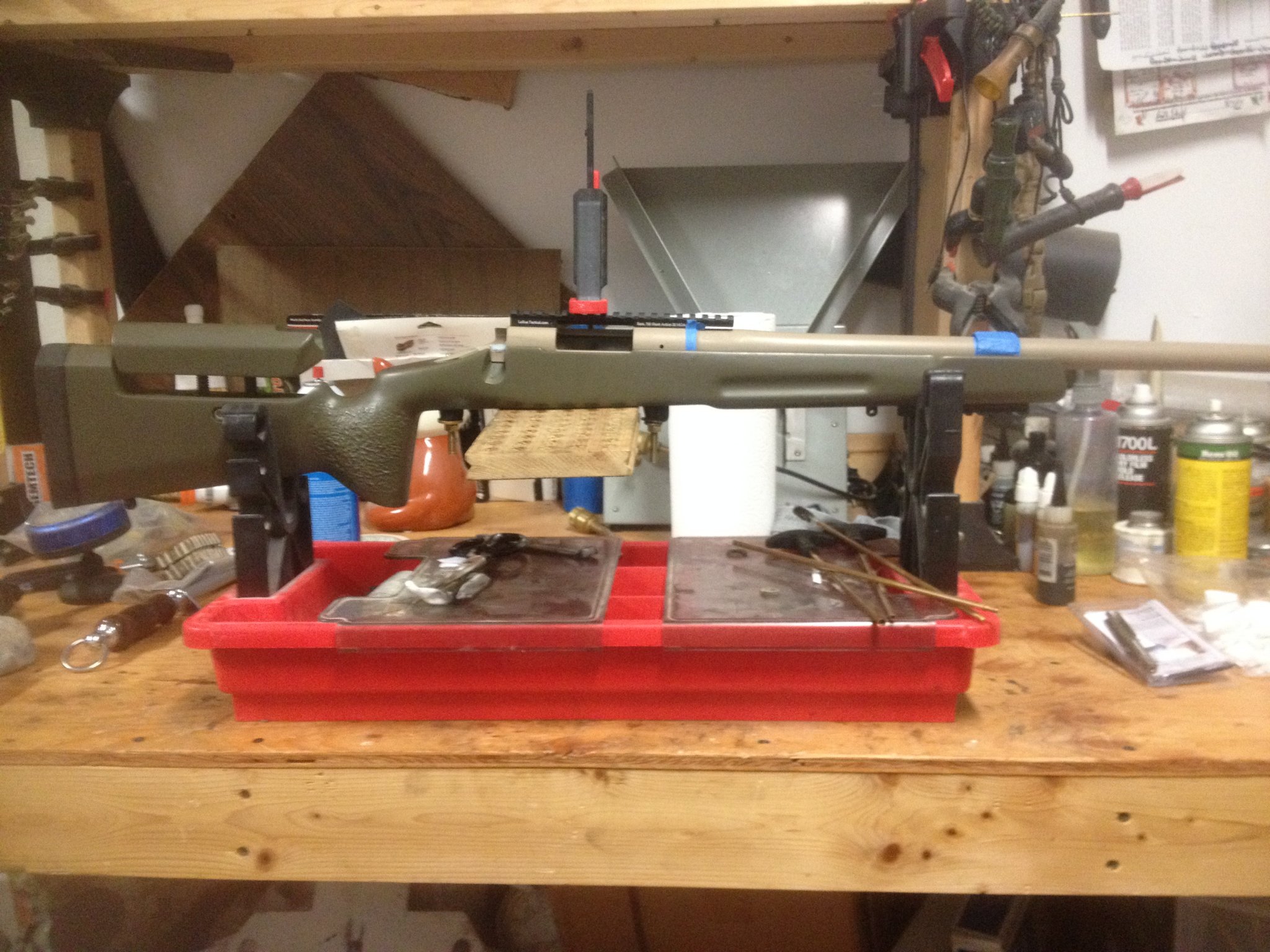

This is why when i bed an action i put a few rubber o rings on the barrel to center it in the stock.
I use eletrical tape with enough wraps to closely match the channel near the end of the forearm.

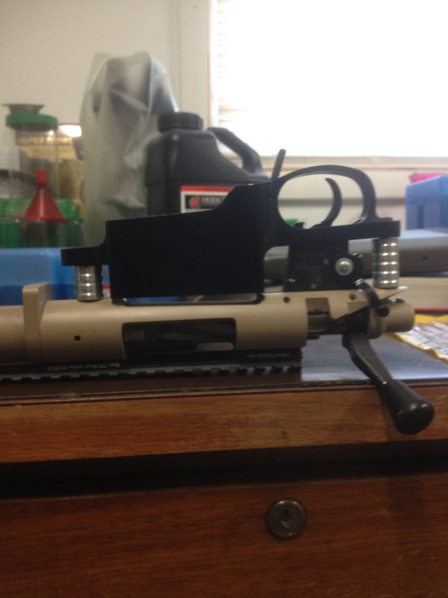

The kicker is if the stock allready has pillars or in this case a chassis it needs to be check fitted with studs to verify it wont have unacceptable contact when the action screws are installed.

I do it the same way, although I’ve never bedded a chassis. I actually just hogged out and bedded a B14 HMR stock because the barrel wasn’t aligned in the channel, but the only way I could make sure it ended up right was to do a full bed job. Skim-bedded the tang just to give it a locked-in home, full bedding at the front pillar and recoil lug. Nothing forward of the lug recess since it’s a barrel-nut setup, plus I tend to prefer a fully floated barrel anyway. One less question mark, ya know?
A chassis is a different animal though, or can be. Not always a lot of surface available to bed to in the inlet, depending on the design.

I'm with Oregun with this one. The op stated and the pics clearly show the barrel is angled in the channel. Now the only way this could happen is if the bedding job on the recoil lug is so fubared that it has caused the barreled action to sit crooked in the chassis. Now if that's the case how did the action screws (specifically the rear one) line up? If the chassis was fubared to start with a good bedding job should have straightened things out?

I used masking tape last time I did one. As noted above it shouldn't be needed in a V block style chassis with a custom action. It is much more likely the barrel is a little off. On a traditional stock you would just sand the gaps in the stock so they are even, and no-one would know but the guy who sanded it.

Just left the gunsmith and he’s saying that this chassis is made for a Remington 700 and my custom action isn’t exactly the same as a Remington 700. I thought the origin was a 700 clone? He says the barreled action is 100% true and accuracy shouldn’t be effected that it’s going to be cosmetic only. I asked him about the bedding and he said he only bedded the recoil lug so there isn’t much compound to effect it. He’s standing by his work
The Origin is a Rem 700 "Clone" as in it has basically the same foot print but acually has tenon threads machined straight, the race ways and bolt face are alighned to the tenon and action face, the scope base screws are actually drill and tapped straight and the primary extraction is correct 🤣🤣🤣

The trigger isn’t centered…kinda makes me think the chassis inlet is off center. Really doubt bedding the lug could do that…and still have the screws line up and thread properly. Is the trigger vertical through the slot or tilted? I have an XLR that is terrific but you never know. Still curious to know what they have to say.
Anyone you know have a 700 clone action you could test fit in there? Anyone have a chassis you could try yours in?

All snark aside should the origin action fit in his chassis?

Very true. I emailed xlr this morning. I’ll give em a call tomorrow. My buddy that convinced me to build a custom has a defiance tenacity. Not sure if that’s a rem 700 clone too. I’ll reach out to him. Bout to take off the barreled action and see what’s going on. I’ll upload pics soon

XLR should be able to clarify if your action should fit in their chassis without any problems then it gets interesting
Try your friends tenacity and see if it exhibits the same behavior.
If it does then it could be the bedding job or the chassis.
This has prob been beat to death, but from Bighorn's website:
"ORIGIN features the same footprint as a Remington Model 700 action to allow for easy installation into most stocks and chassis as well as utilizing the same trigger configuration as a Remington Model 700."​
So, I'm throwing out the BS flag on your smith's statement about the action's compatibility.
