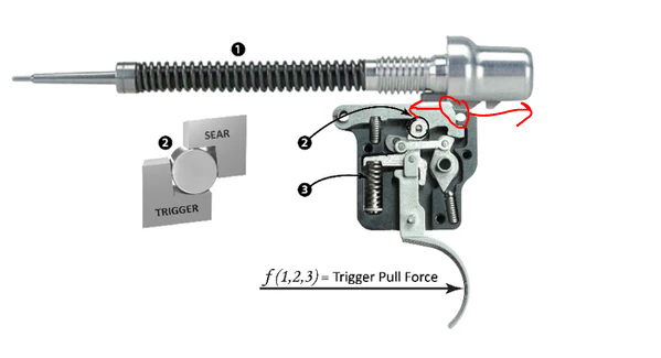

Are you familiar with how they work, what parts interface with each other, and how to adjust each individual piece?
Unlike a "mil-spec" AR where there are tolerance designed for mass production and fitment, bolt guns generally need a little tweaking.
Timing the trigger, making sure the sear is holding the striker with enough overlap, and feeding are the main things I've seen frustrate people.
A full chassis is the way to go unless you're comfortable bedding and doing final inletting on a stock.

Can you expand on this a little bit? I just purchased an Origin and was planning on just throwing my TT Primary on it once it arrives. What am I missing out on here?
On most bolt rifles when you lift the bolt handle you are actually pulling the firing pin back against the forward spring pressure with the mechanical help of an inclined plane (cocking ramp) which spreads the force out over a longer distance to make it easier to operate without having to flex your muscles. The trigger then catches the firing pin and holds it back when you lower the bolt handle.
The sear location which catches and holds the firing pin back is different in all the different triggers, there is no set standard.
As such the location where the sear on the trigger and the cocking piece can vary in its location front to rear.
If its too far forward relative to the action then the spring isnt held back far enough to provide enough spring pressure to set the primers off.
Set it back too far and instead of the action only using its mechanical leverage on the spring pressure to close the bolt you end up having to overcome the pressure yourself which can often be described as heavy cock on close.
Sanding/grinding/trimming up the cocking piece on the firing pin can allow you to time that interaction up in its relative location to the action to where it uses all of the built in mechanical leverage of the action without having to physically overcome the additional spring pressure yourself.
Personally, I dont mind the bit of cock on close. Sure you an notice it if you deliberately look for it but in actually using the action I havent noticed my extra .020 or whatever it is of cock on close. And by not trimming it I ensure that I dont inadvertently remove too much material should I put in a subsequent new trigger in the future that puts that interaction at a different location that my current trigger (though Im not ever gonna swap out my bix and andy).
From a couple posts above yours: "Timing is very much isolated to how an action feels, not how it performs. Feel is subjective to the user, not a standard. However, a timed trigger does give a LOT of people warm and fuzzy's when it's done right. And, as stated in this thread, we will do it for free if you send your trigger to us prior to your action shipping."
Without timing the action and trigger interface, there will likely be between .015" and .030" cock on close. That produces a stiffer than typically desired bolt close. What we do in house is measure the amount of cock on close your trigger is presenting then replace the cocking piece to get it as close to zero as possible. It's an easy process and we do it during assembly of your action. So if you send your trigger prior to action shipment, it only takes us as long as receiving your trigger to complete your Origin order.
If you've got any questions, feel free to reach out here, at my email ([email protected]) or call us from 8-4 central M-F. Thank you - Ray
