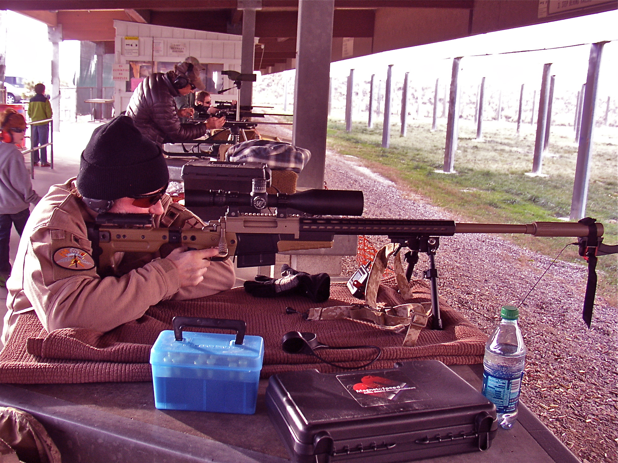

I work with a Surgeon built .338 PSR rifle with an AWC Thor Ti suppressor and NightForce ATACR. Bipod is an LRA tactical, the barrel a Krieger. Not sure I could do any better for the investment. The rifle is very accurate and should exceed the most discriminating shooters' requirements. Surgeon built these same rifles for SOCOM. I regularly shoot it to 2200 yards, and in the right environments, beyond that. Here is a target shot 10x at 300 yards for sight in. There are many great rifles, this is one of them.
Beautiful System Kilmore! Thank you for the pictures. Food for though because I hadn't considered a Thor Suppressor which I have heard great things about. I am very excited to get this build underway. You will see pictures once it's built. Right now It's looking like 8 months until it's completed. Everything is backordered so I have to be patient.

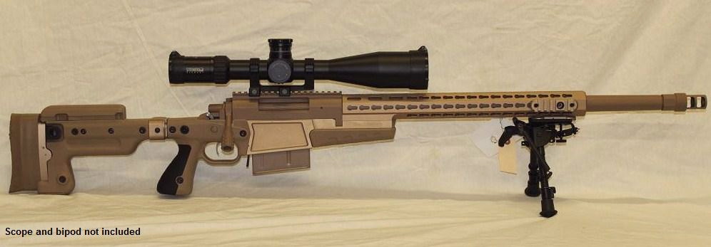

Mile High Shooting has some AX338 rifles on close-out for under $6k right now. If you want the best, well, it's really damn hard to make an argument for buying anything else. It is possible that I am slightly biased:
Thanks for the pictures Gunny! That's a great looking gun. I was considering using the XLR Carbon Chassis which has just recently been available for purchase
