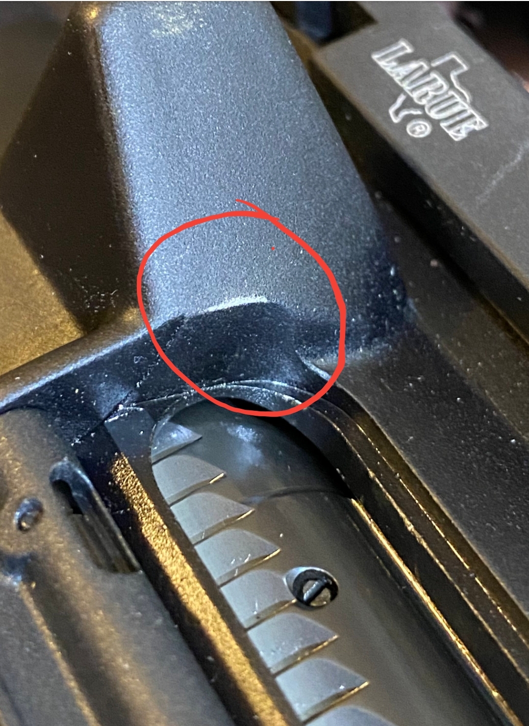

    It'll feed/cycle no problem but I'm leaving nice dents in the side of my cases. I went out to test various loads today and the case denting became progressively better throughout the test. The upper is entirely new, I've shot less than 100 rounds through it prior to today's testing. I did four different bullet weights today and it became better (dent size lessened) with the heavier bullets. Not sure if this is a coincidence? I started out with 52gr, then 55, 68 and finally 73gr. The 67's and 75's ranged from very light dents to none at all. The cases which housed the 52's are not reloadable again. This is a problem as I have a LOT of the 52gr. bullets and I can practically put five of them in the same hole. It'll make a nice plinking round.
    Photo of the cases. It's a hard crease, definitely not reusable:
    Corresponding photo of the deflector. One question I keep asking myself is it partially caused by the shape/design of the deflector? There's a steep shoulder with a sharp edge which leads out to the deflector's extension. Notice the excellent product placement in said photo.

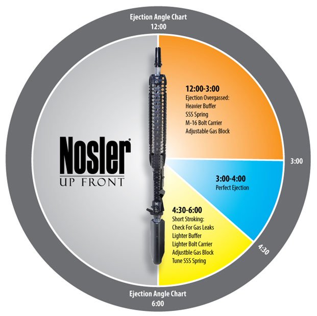

    Are the spent shells ejecting consistently at around 4 o'clock?
    Is it hitting the deflector or the inside edge of the ejection window?
    [Edit]
    Looking closer at pics your deflector is pretty clean except for this edge.
    I would guess some cases bounce forward.
    If so
    I would try heavier buffer and or spring or tune down gas.

    Likely your bolt is unlocking too fast with too much rearward velocity. So you need to increase weight of the BCG/buffer and/or reduce gas.
    You should at least be using a 2-3 oz buffer, a Sprinco blue or ywhite spring & your gas block adjusted to just let the gun lock back on an empty magazine. A bare buffer is not a good idea with full power loads, IMO.
    The ejected cases should be landing at around 4 o'clock.

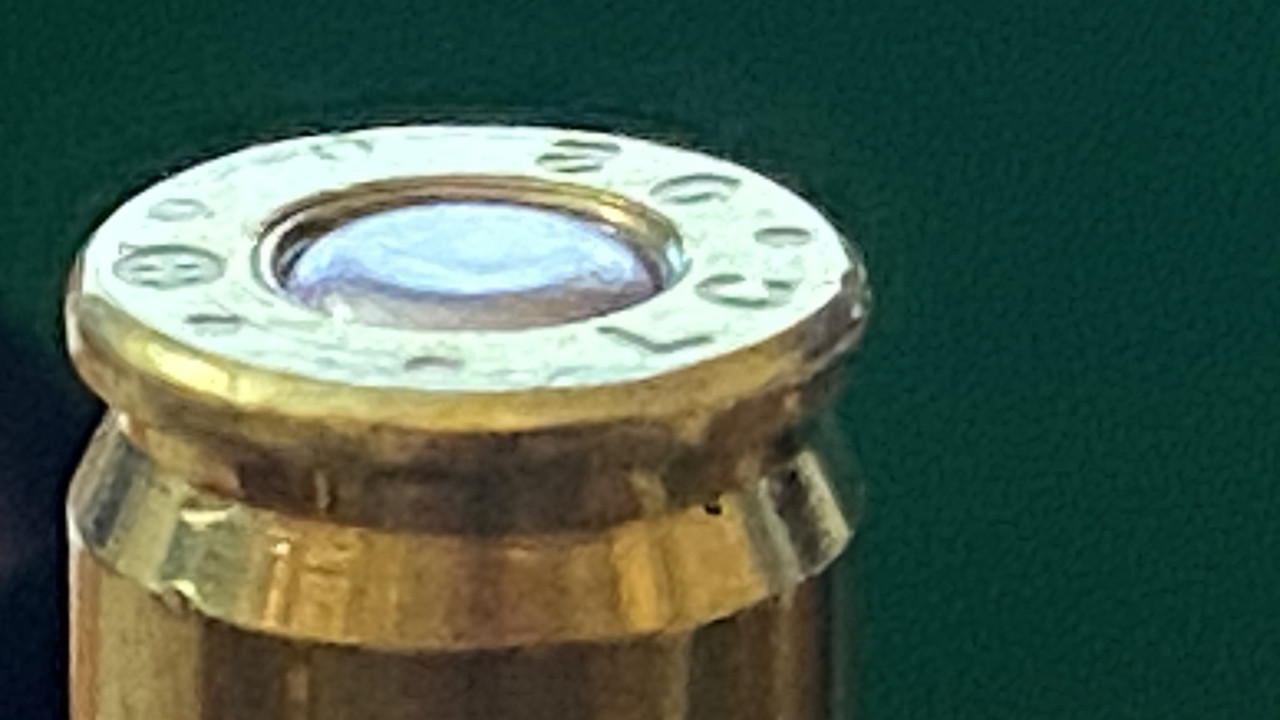

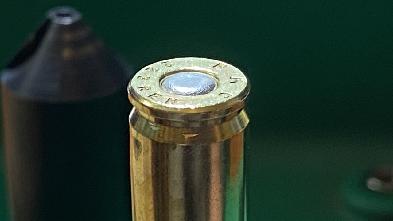

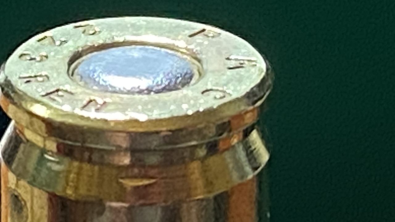

    Here's a photo of the back end of a slam fire case. Note the primer is now protruding, no dimple.
    Photo of a primed PMC case. I know it's really hard to tell anything from a photo without physical measurements.
    Lake City

    One other thing I noticed tonight..worked up the tail end of an LC 5.56 shell and a PMC .223 shell. The LC's have already been swaged but I reamed it anyway and then unified it. Did the same to the PMC and the unifier never reaches a majority of the bottom of the primer pocket. You can sit there and let it spin forever (RCBS case prep center) and it'll do a ring around the outside and nothing more. On the LC, it unifies the entire bottom, removing material from the flash hole to the primer pocket wall.
    Still, the PMC stuff doesn't have a crimp and even if you didn't ream/unify the primer pocket, it should still accept a CCI primer no problem.
    Conversely, PMC .308 you'd think I had been mining for gold dust. Takes out lots of material off the bottom of the primer pocket. And again, zero issues with the .308 today.

    Update. I got the sense, after disassembling and examining several cartridges plus my Lyman primer seater that the issue lies with the seating process.
    I am using the Lyman hand-held EZ prime and chose it over it's mostly metal construction. My shell holders are both RCBS, #10 for the 223 and #3 for 308. I notice a fair bit of play on the .223 with the shell inserted into the RCBS shell holder. It would physically lift the case up when I squeezed the handle all the way.
    On a whim I ordered a Hornady shell holder for .223 and got it overnight (thanks Amazon) and there's less play. As a result, the primer was ever so slightly deeper. I could barely tell using my digits. My neighbor loaned me his backup primer, an older Hornady hand-held. That combined with the Hornady shell holder (doesn't work with RCBS shell holders) did the trick. The primer is now recessed and I can feel it, easily, with my fingers and see it with my eyes. Takes a bit of a squeeze to get it there.
    As for the primer becoming an "outie" instead of an "innie" I can only think the bolt face slamming against the primer, with the firing pin not forward, caused the metal to flow into the firing pin hole. That's my very uneducated guess. I have yet to come across a photo in the internet of a similar-looking primer.

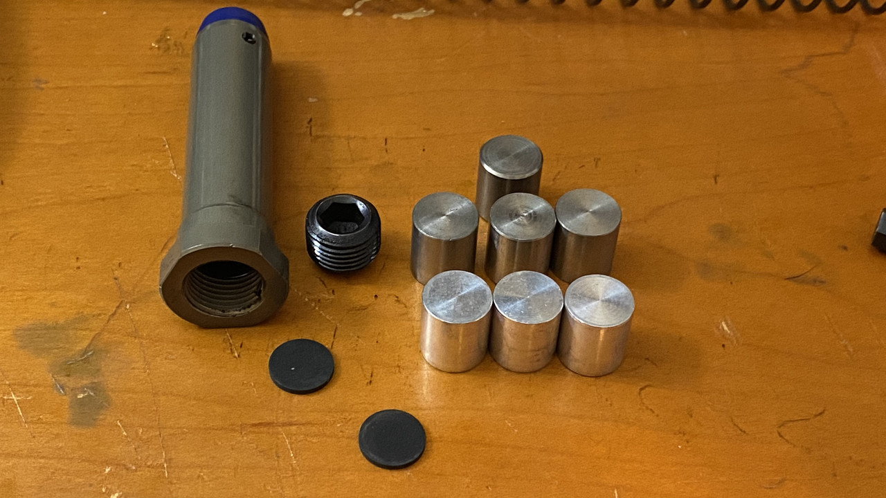

    The Odin Works adjustable buffer comes with three aluminum and stainless steel weights along with one tungsten and I can go from 2.1 to 4.2oz with it. So I could just add one or two aluminum and go back to the softer spring and see if it makes a difference. I'll just have to test and test again.
    From what I can remember, the gun was ejecting at about 3 O'Clock. Didn't check last time as I was using a brass catcher but I'll do so next time out. Gas block is halfway open in restrictive mode, mid-length gas system. I wish I'd measured the gas port but alas I did not. It's a Faxon match-grade 416R black nitrided barrel with a 223 wylde chamber and so far, it shoots exceptionally well so I'm excited to get the entire setup dialed in.

    Update. So far I've changed the following:
    -Seated the primers slightly below flush, it's visible to the naked eye and to the touch.
    -Went back to the weaker spring
    -Added two of the aluminum buffer weights to the buffer (not much weight change, I know).
    -Wiped the BCG down and did not re-lube it. It has a DLC coating to begin with.
    I loaded up 15 more rounds of the PMC brass with the 52gr Nosler, 3 different powder charges, all on the light side. Did 15 more of the Hornady 68gr, same deal.

    On my second set of five with the Noslers, I had a slam fire. I pulled the buffer and added one more aluminum weight. Happened again when I moved over to the Hornady 68gr. loads. It does not happen every time, very sporadic. But I had an LEO training in the next range over so I started single loading out of an abundance of caution and I was the mostly the only one at the rifle range.
    I'm headed back tomorrow morning. Going to load up some cheap stuff with PMC and then Lake City brass. I don't think I've had a slam fire yet with the LC which is peculiar and it may be a red herring/nothing burger. I'll swap in one of the steel weights and keep adding weight until it stops or I run out of ammunition. If I can't get it to stop, going to take a look at other things, maybe the firing pin length.
    Primers are CCI 400's and I know a lot of folks use them successfully in AR's. Maybe I'm not so lucky. Maybe with the shortage the QC isn't there and they're pumping them out as fast as they can. Dunno. Grasping at this point until I can start testing with more buffer weight tomorrow morning. Going to be really frustrating if I end up running a full-weight buffer (or greater). Then again, gives me an excuse to spend money on a lightweight lower and titanium bits.
    I know trigger issues can cause this but I'm using a drop-in Velocity trigger and I had it in there prior to the lightweight BCG with hundreds of rounds through it and no slam fires.
    After all this I think I'll just keep running standard bcg's and conventional buffers in varying weights.
    It seems like many threads of trouble revolve around adjustable buffers.
    Have you tried the bleed off mode on the agb?
    And yes dump the aluminum buffer weights for steel or ti.
    Some place has to be a sweet spot unless the bcg has a defect ?
