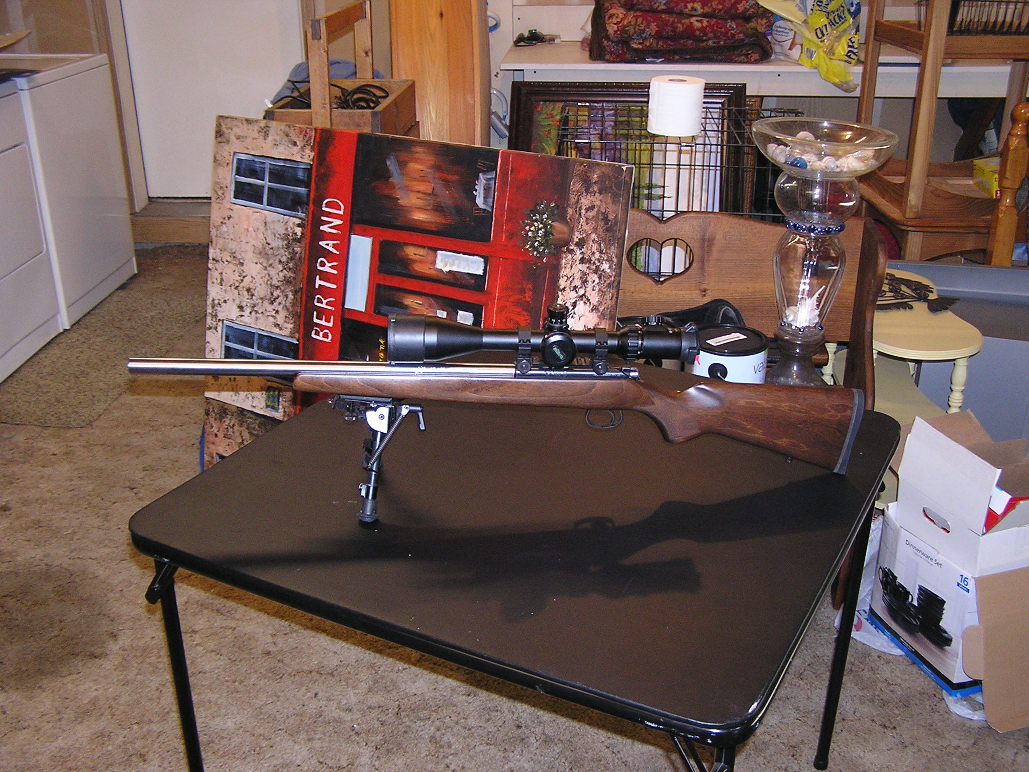

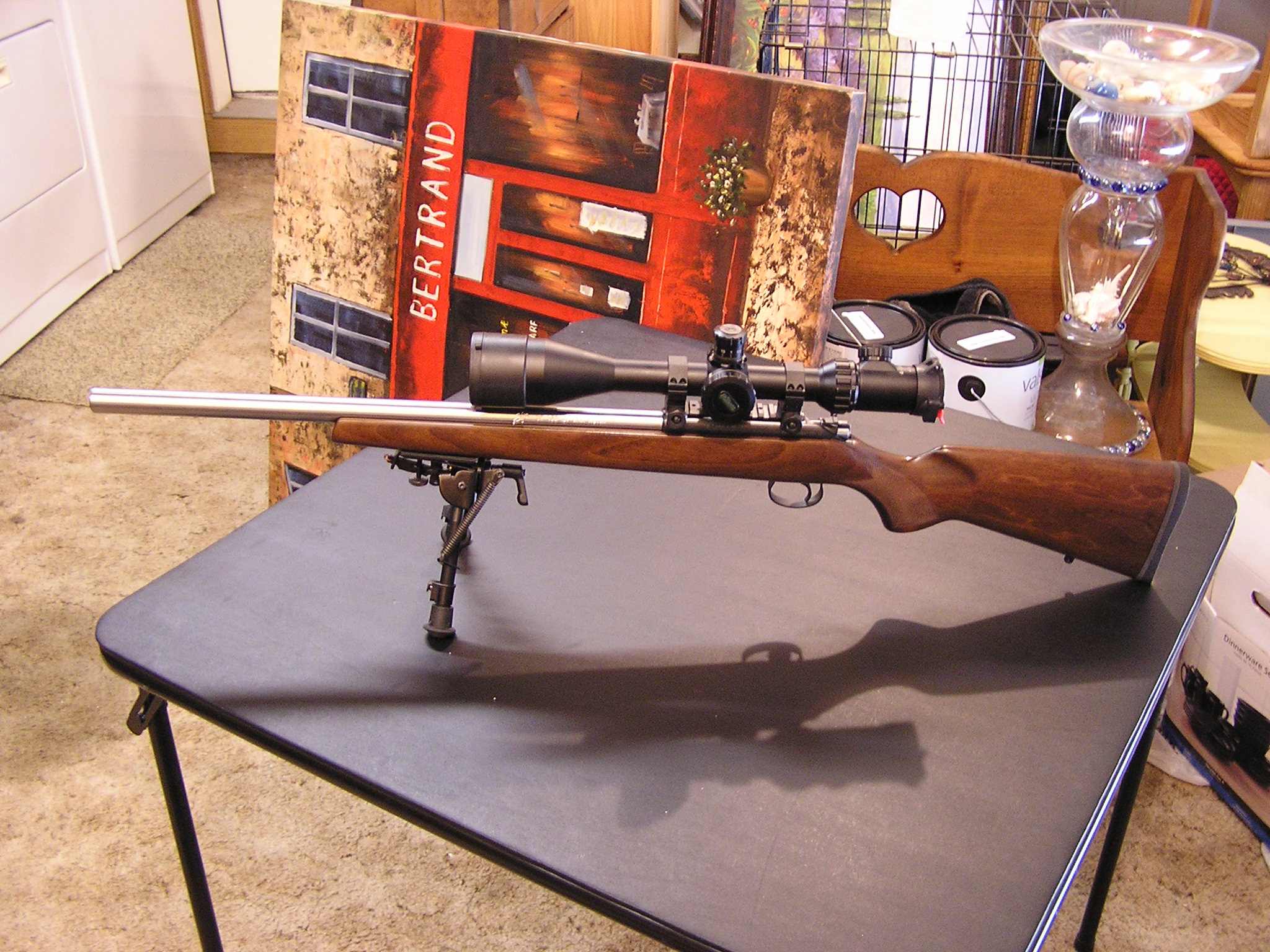

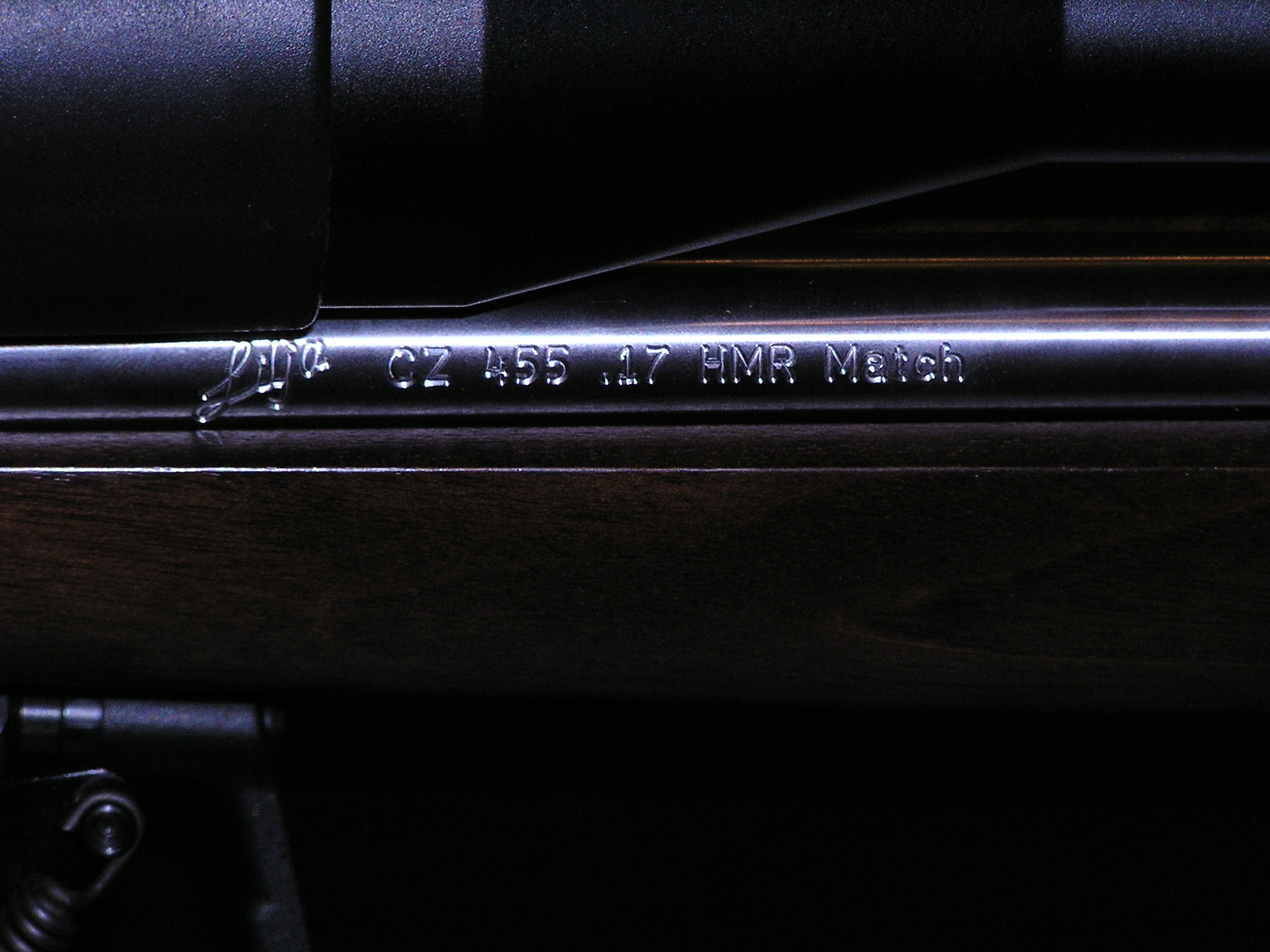

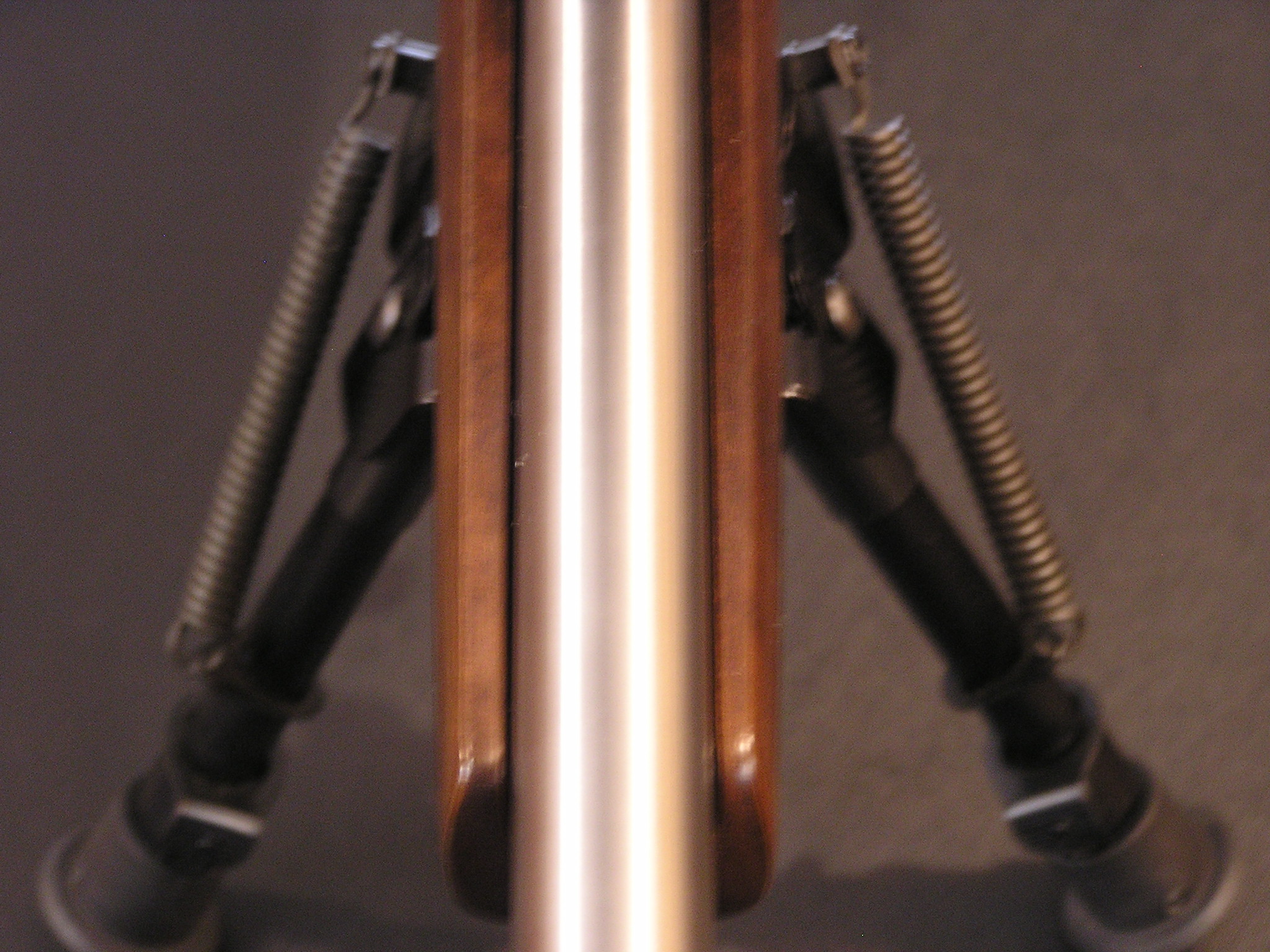

Trying for pics now. Found plenty of clearance between barrel and stock, at least two business cards. Balance point has moved forward a little. Can't wait to try it out, maybe tomorrow. As you all can see, I'm no Bob Cummings as a picher taker (does that date me as older than most?).
Shoot it as it sits but I highly recommend you pillar bed and glass bed it to get the most out of the barrel. Since you have an hmr and it fires jacketed bullets, you must break in your barrel! Those who got a 22 LR barrel do not have to break in there barrel. Here is the recommended break in for the lilja barrels using jacketed bullets :

I've already pillared and partially bedded the action in the front and the tang areas only. A very snug fit. Now I'm just wondering if the barrel might need pressure pads. I also stoned the sear and cut the trigger spring a little. It feels better now than my friends with a Timney. Smooth, light and crisp release with very little take up.

All the Lilja's I've done in the 455 have shot best with the first 3" of the barrel channel bedded. Some do even more than that and get great results. She should shoot damn good with what you have done already. Def give us a range report!!!
