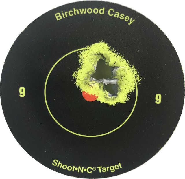

Did a little testing today once the winds died down. Rifle hated SK rifle match. CCI SV did okay, if this were a cheaper rifle like my 10/22s I’d call it acceptable accuracy, then SK standard plus, finally wrapping up the top place was Lapua Center-X. Still wrapping everything up, but will provide details to follow
SK flat nose match works pretty well in my CZ 457 MTR. 1st 10 shots are normally terrible then it will group much better. I have not shot beyond 50 yds, yet.
