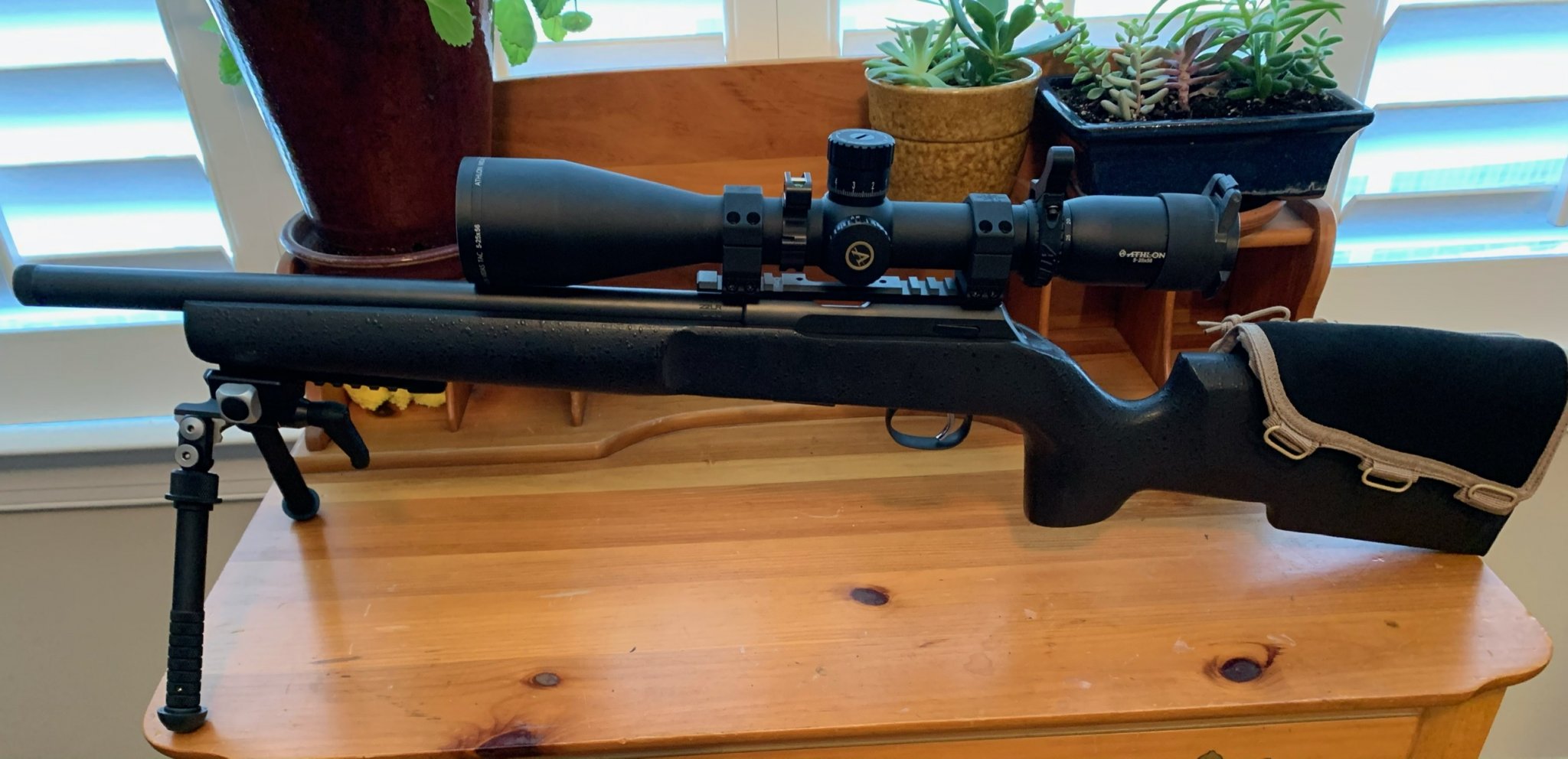

Need some sage advice. Time to get the CZ up and running so I ordered a Midas TAC and some Vortex Precision low rings. I plan on using it for target shooting (might try the base class thing I keep reading about :) ) but I will also use it to lay waste to the squirrels that are infesting my bird feeder and possible my attic (No I won't be shooting them in the attic) so I wanted to ask what base ya'll suggest. The bird feed is 15 to 20 yards away and I'm not sure what the max distance is in competition. Planning on going with a BScar or an Area 419. Do y'all suggest 15MOA or 30/35MOA base. Thank you for the help and putting up with the stupid question! :)

If you're putting a Midas tac on it then a 30 moa will still let you zero at 25 yards and shoot out past 300. Might as well get the 30

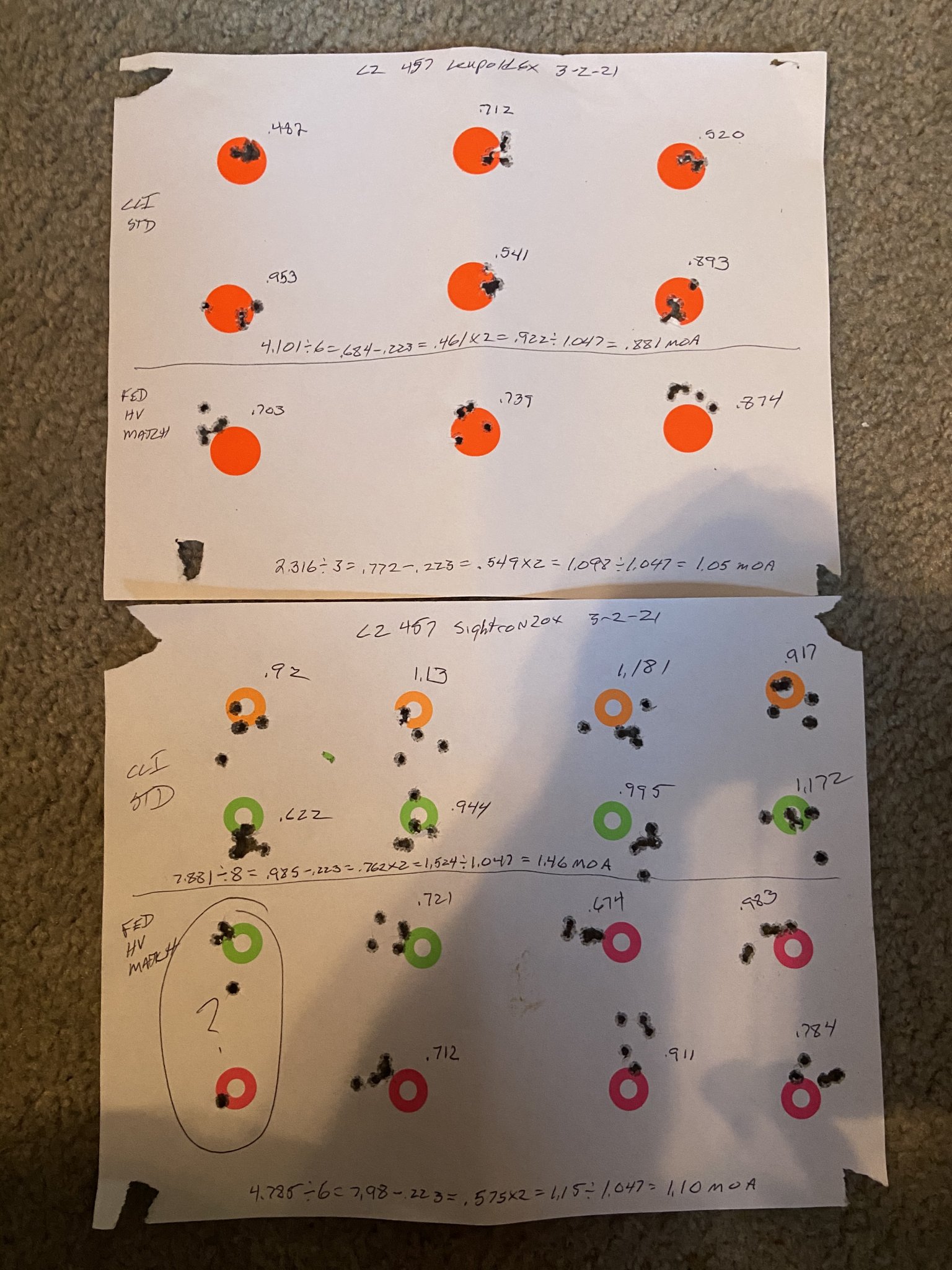

i picked up a pro varmint last week, figured it would be a good compliment to my vudoo, and a platform to shoot less expensive ammo, and see what i can do. got it home, and installed a 20x sightron i have. couldnt get the eye relief right due to space limitations on the 11mm groove. tossed a 6x leupold in my bag, grabbed some CCI Std and Fed HV i have stashed and headed out to the field.
bottom target was fired with the sightron, no way i could make it work with the poor fit. swapped to the 6x leupold and was happy with the results. not too bad...i got a rail and super sniper installed now, cant wait to shoot it again.
hth anyone on the fence on purchasing a CZ. the trigger was easy to adjust, i set mine to 2lb with no creep or overtravel. For the money this is a fine rifle. i have been dissappoitned with the other sub 1k 22 i tried, a ruger rpr.

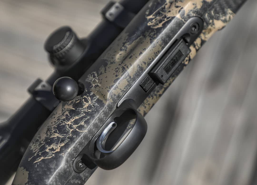

They've been pumping out some pics on Instagram today.
Smaller, lighter and sleeker -- here's a first look at the new CZ 457 rimfire platform.
The biggest change is the switch to a push-to-fire safety system, which means the safety is no longer 'backwards' to many in the American market.
But that's not all -- other upgrades are as follows: The action has been shortened and slab-sided to reduce bulk and weight, reduced bolt rotation means increased clearance for large scopes, the trigger is adjustable for creep, poundage and overtravel, the bottom metal is now sculpted and sleek, metalwork is finished in nitride to give it the look of a quality blue with the corrosion resistance of stainless, and the interchangeable barrel system and smooth-running magazine system of the 455 is retained unchanged. Last but definitely not least, the firing pin weight has been significantly reduced, resulting in less disruption at the shot and enabling a tad more accuracy.
Shown here as the new 457 Varmint Precision Trainer, it wears a carbon fiber composite stock from the fine folks at @mannersstocks, a 24" heavy threaded barrel and the CZ Rimfire suppressor (sold separately, of course).

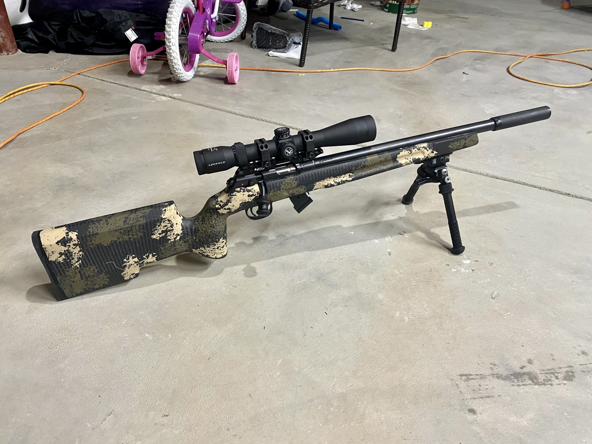

Got the 457 slapped together and about to head to the range for a sight in. The next barrel will be a 16.5" or 20" but I am digging the little dude and it is too much fun with a Deadair Mask on it!

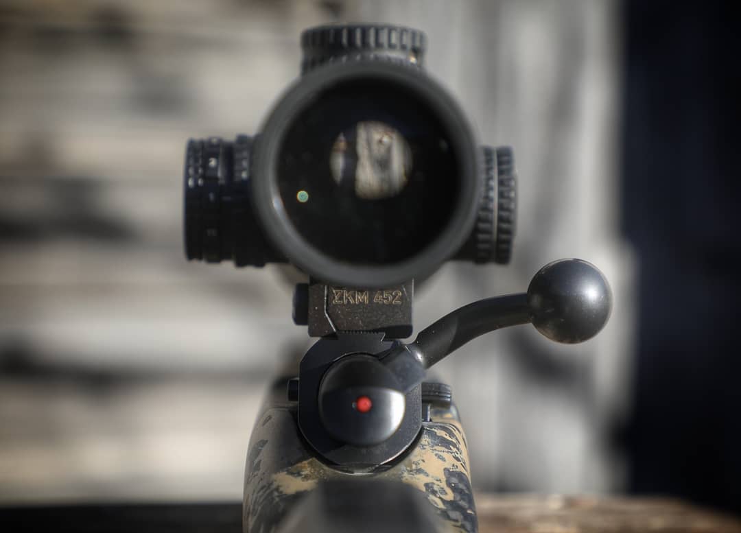

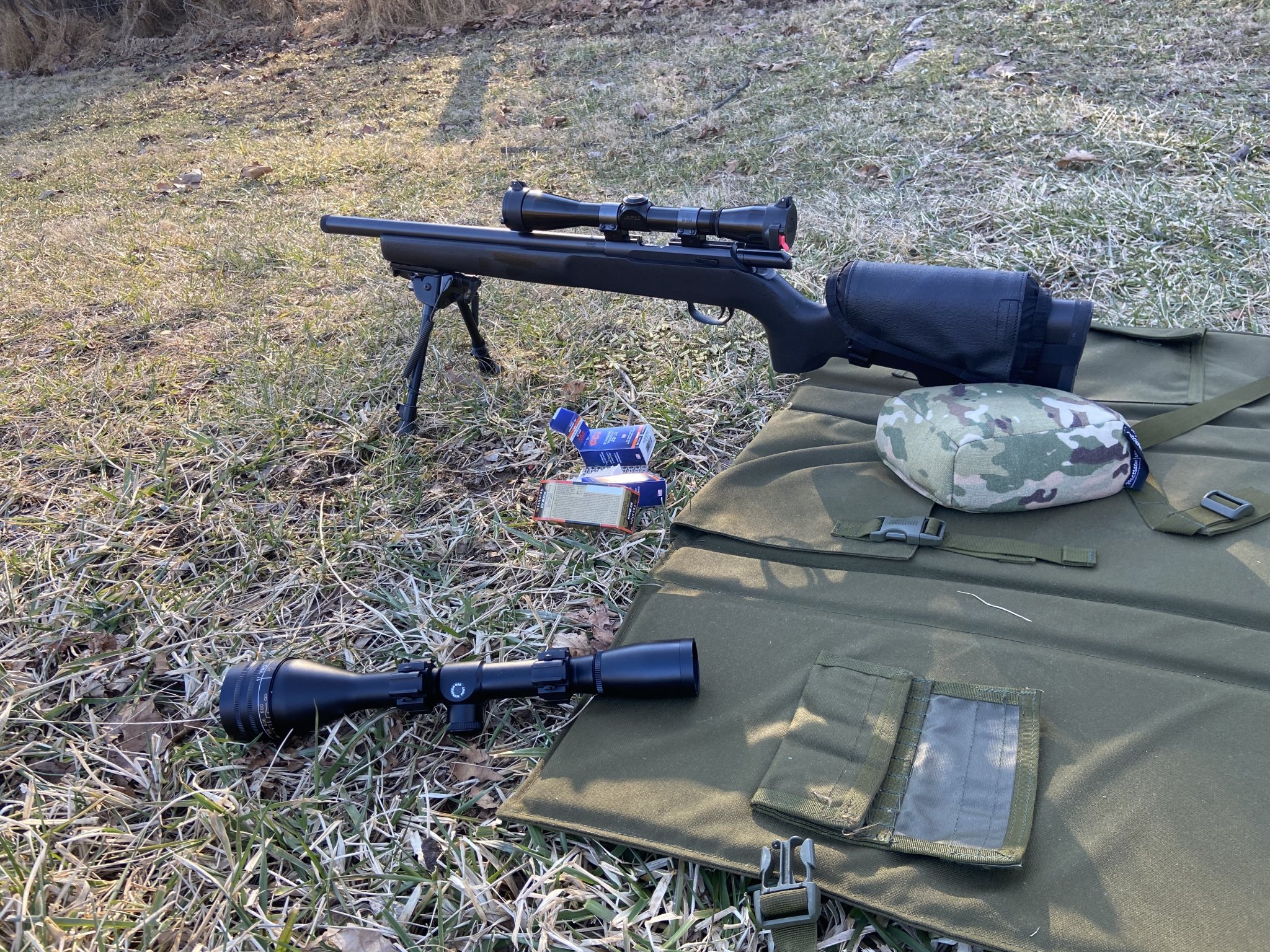

Wondering if anyone here has come up with a DIY adjustable cheek setup on a ProVarmint stock? My dad and I have pretty dramatic differences in what fits us....the Hide has some amazing creative ideas.
Get a cheek pack. Triad Tactical makes a nice one with a synthetic suede side that is comfortable. You build the height with strips of Velcro that come with the pack. Super easy to add or remove the Velcro strips to change height. I used strong adhesive Velcro to attach it to the stock so it does not require the straps around the bottom. I have also seen people add the victor titan cheek rest, but it is not adjustable.
I heated a sheet of Kydex and layed it over my stock and let it cool some. Then cut and shaped the kydex into cheek rest shape. Then run a strip of Velcro down the center of the cheek rest and down the comb of the stock. Simple.

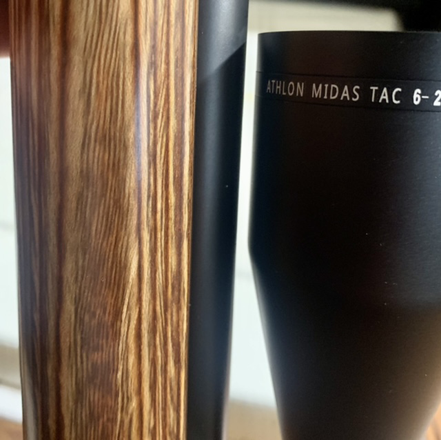

Nice set-up. I usually mount my bubble level in front of the far forward ring and had enough clearance.
I like the low sight over bore. I sanded down the front scope cover and it now clears easily. My objective is 50mm and depending on your scope cover it may work as well.
YMMV, happy shooting.

I will tinker with it this weekend. The caps I am running are Monstrum and even the rubber cup that holds the cap on the bell interferes so I am not sure what my final out come will be but I love experimenting! :LOL:

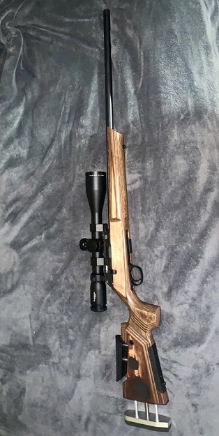

Odd question here: Can I put a Varmit/Heavy barrel into the CZ 457 Royal stock? Will it fit? If not what type of barrel do I need, they don't sell them as "Royal" just "heavy" vs "American" profile from what I can tell.

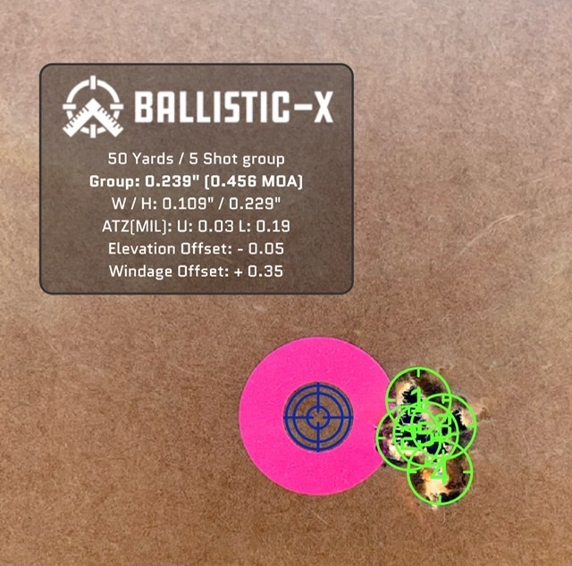

Anyone have any tips to get the most out of a cz457 pro varmint? It’s shoots pretty well I think anyway. Bone stock but can shoot one hole groups at 25yds with good ammo. Just wondering if there are any tips/tricks etc to help even more. Any ideas are appreciated
