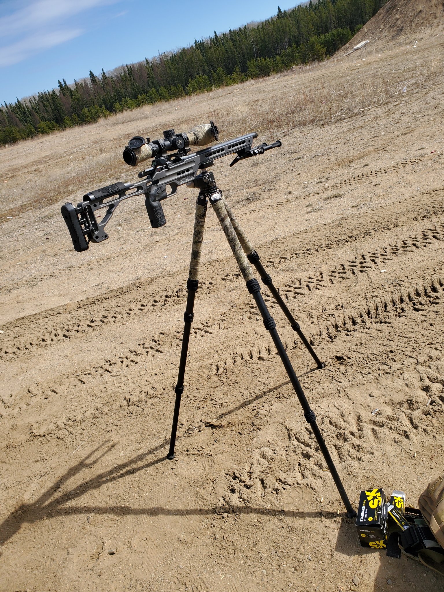

Of course it decided to get breezy today. But it was fun shooting with my kids. The rifle really likes the Sk standard plus. Not my best shooting, but I was also dealing with twin 9 year olds cracking away at their rugger 10 22. I started with a zero. Then I shot top right going left. Middle right going left. Then bottom right going left. I shot two other groups up higher that got some scragglers from my kids. 😂 I just wrote those scores below the sk groups.

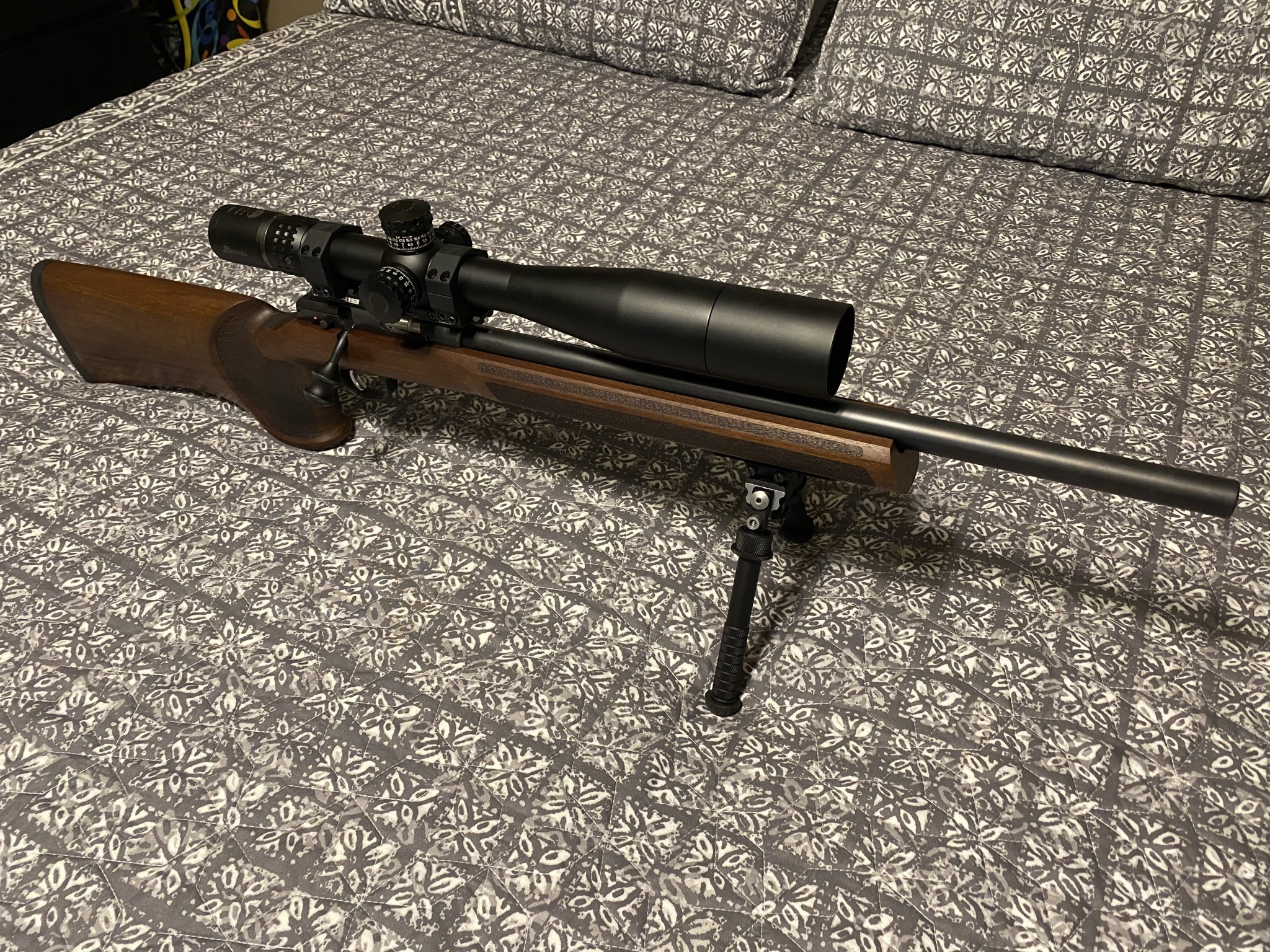

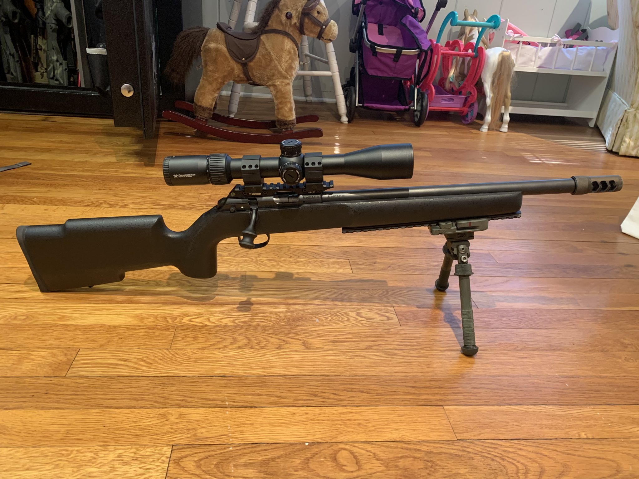

Finally getting back into 22lr after selling my beater Savage MK II FV-SR earlier in the year. Bought a CZ 457 pro varmint and it feels infinitely better than the MK II did. Was going to keep it in the factory stock but changed my mind and ordered an MPA to try out. Threw on an Area 419 30moa base and bolt handle. I think my NX8 finally found it's forever home on top of this rifle as well. Finally found some used 10 round mags online the other day, so those will make my life a little easier. The 5 round mags don't work with the MPA mag funnel installed. Had to pull it out to shoot in the mean time. Hoping I can do some actual groupings once a calm day rolls by. Winds have been all over the place lately.

Nice looking rifle! Let us know how well that SK Standard Plus shoots in it.

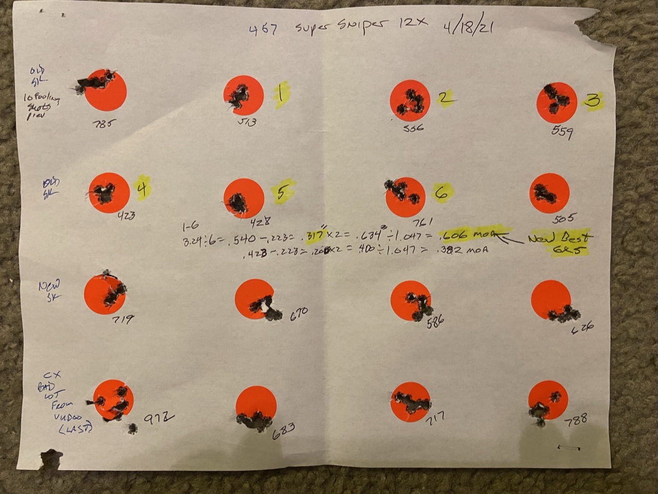

gotta say i love my Pro Varmint 12x Super Sniper and SK Std

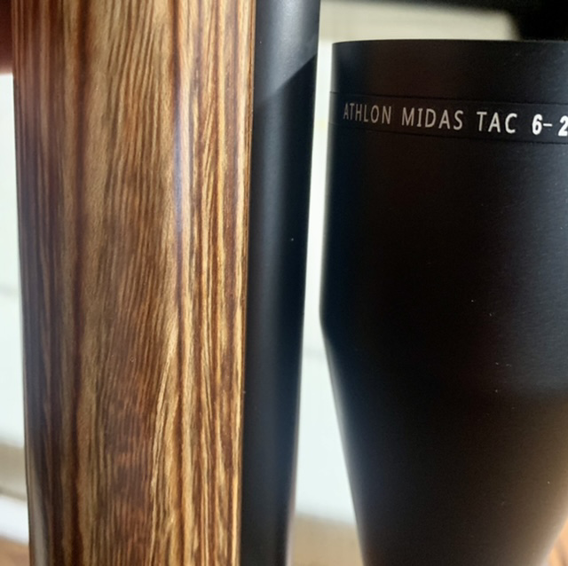

So this is the Midas TAC with low rings on a 25MOA BScar rail. Scope caps are not an option (I run a scope coat). I might have 1/8" clearance...
