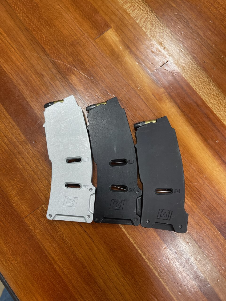

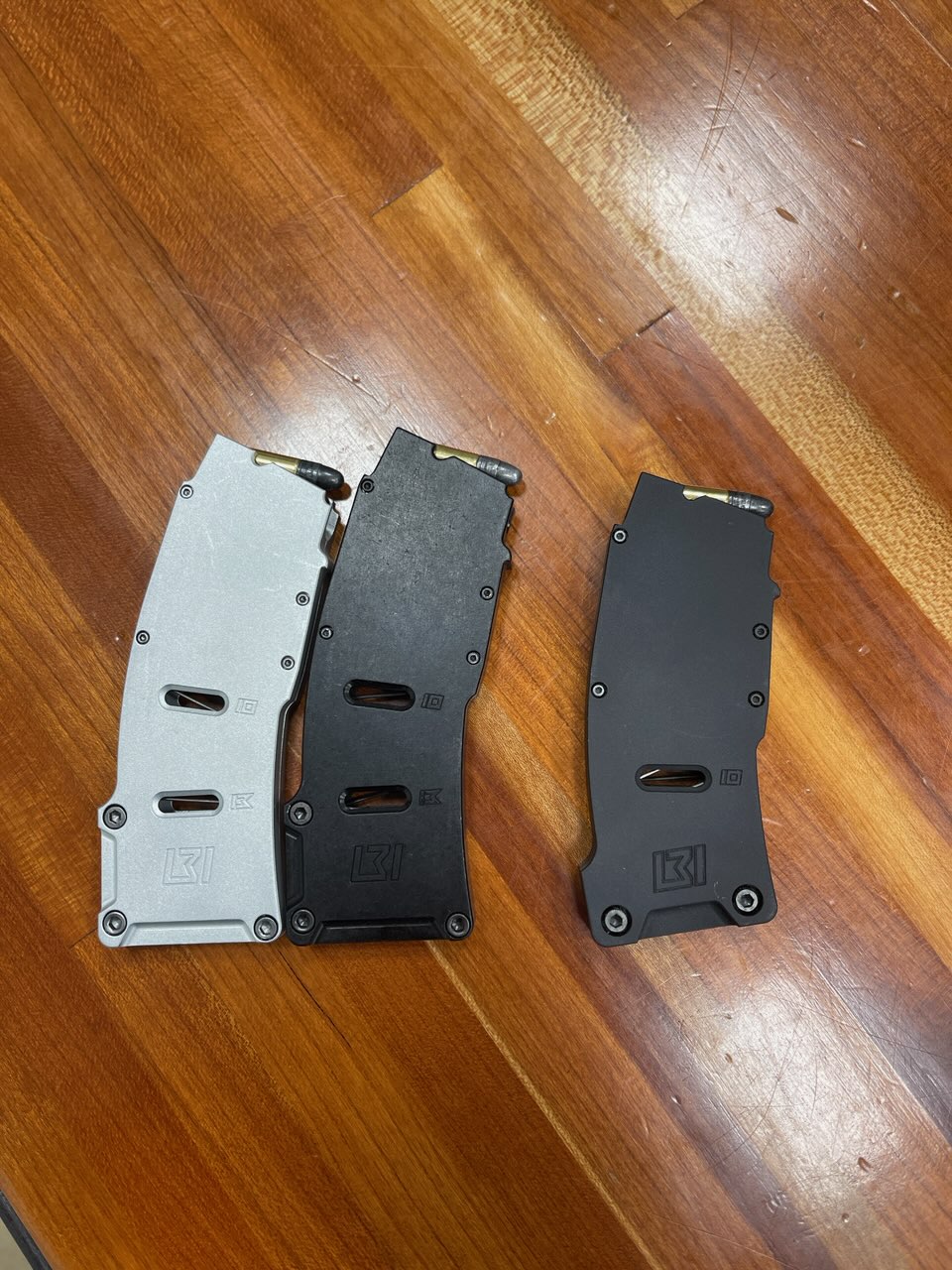

Mags are still moving forward. Springs are in and good to go. First mags run will be a limited clear anodizing since we've had a ton of interest in the raw aluminum. The clear will protect better than just leaving it raw machined although really it's a metal mag so it's not like you can hurt it. The clear will be limited qty's and then black will be the standard so if you want to wait on the black rest assure that it's coming. If things stay on schedule be looking at the site for the 13rd within a couple of weeks. Coming it hot right after that is the 10rd for guys in "those" states, and then a 15rd bench version for guys who want all the rounds and don't mind it curving forward, should be nice for bench/prone days.
The 10rd is looking cool as well!
Just a little curious, is there a reason why 13rd capacity is chosen instead of 10rd or 15rd? I only ask since it's easier for me to drop 5/10rds out of the tray than anything under that.
13 was chosen first since it's geared toward positional shooting and that's what I wanted for my son's rifle lol. The 10 and 15 are coming as well, just already had the 13 started when we decided to jump into volume production.

Also, as mentioned earlier in the thread, 15 round mags have an issue with barricades and bags. For bench, okay. I’m all in for a couple 13 rounders as soon as they’re available.
I'm curious how easy is it to reach the mag release with the new 13 rounder? Ive heard the ACC is pretty impossible to mag change with mag extensions...
It’s a fair question. There is not much clearance between the mag extensions and the mag. I bought a metal mag from czparts overseas. It was too big for the mag well and then jammed the release latch tight. Not enough latch movement available to unlatch the mag.
I had to remove the action from the chassis and remove the mag well. Then pop the pin out of the extended release and remove it to free the magazine.

We also have done extensive testing to confirm these are compatible across various stocks and chassis combos.
I have used these for numerous matches these last few months with no issues, and let others try them out after matches without fail.

These aren’t those stock ones, and do run much better than the stock plastic ones.
Reactions: Frankr
What do you mean by that? I realize that the 10 rounders are not supplied with a rifle as purchased, but they are most certainly stock CZ mags.
That the pics I posted aren’t the stock stamped metal ones. They are machined and have been running better than the standard 10rd plastic ones.
Ah, okay. I missed the reference and thought you were talking about the plastic ten round mags. As I may have mentioned before, I bought a metal 10-rounds mag from cz-parts in Czech Republic and it did not fit correctly into the mag well of my stock 457 and then I was unable to get it out without taking the action out of the stock and removing the mag well.

I can only speak to the 10 and 13rd versions.....the 15 rds are on the way. I have tested a pair of 13rd ones in many matches without any issues and that was before the specific longer springs were used. These are dialed in.
