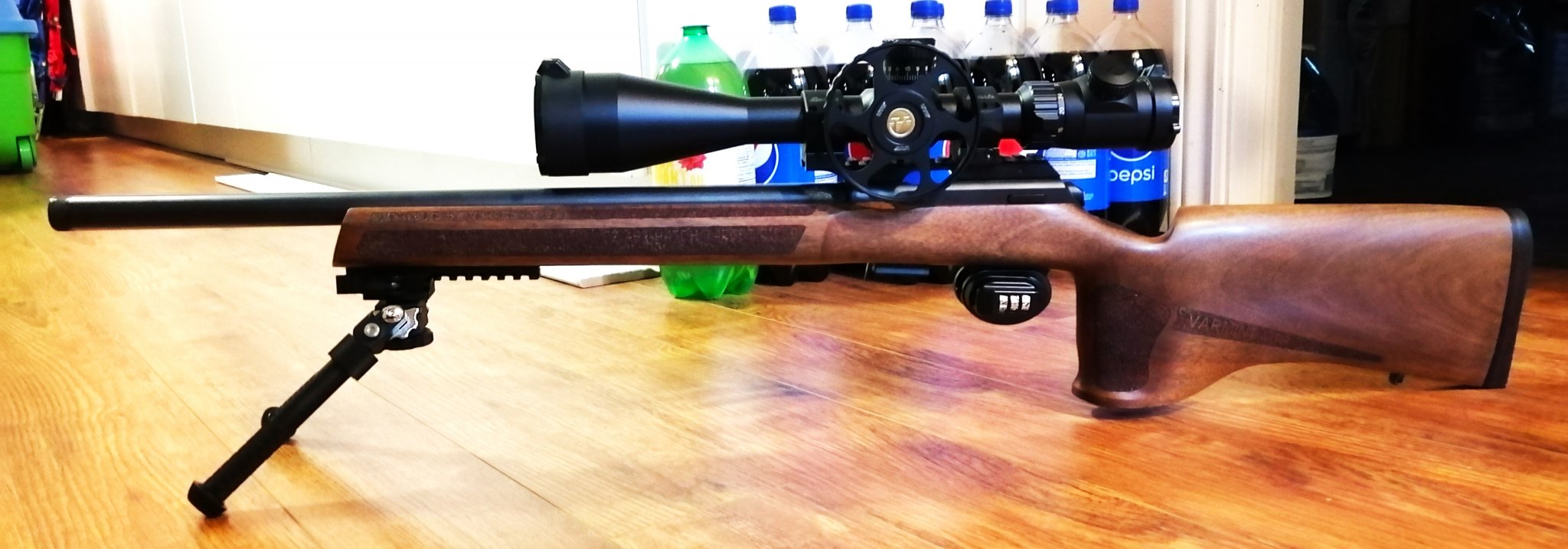

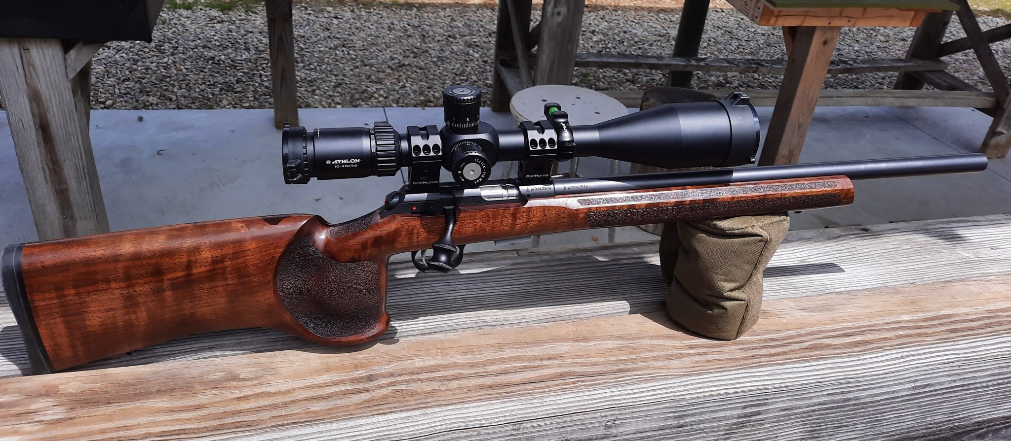

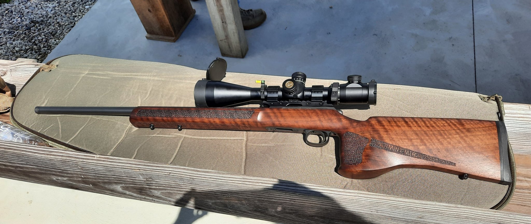

Here is the just unboxed CZ 457 MTR with AREA 419 Rail and bolt knob and Vortex Venom 5-25x56
The scope rings are what I had and are a bit high.
Update: I got to the range and am very happy with the MTR!!. The wood stock has a very natural shooting postilion for your hand, CZ did a great job with that. The action is smooth but a little stiff on closing but it new so I expected that. I shot CCI Standard, Norma Tac, Wolf Match and RWS Match Rifle. As I thought at 50 yards the RWS MR shot the best followed closely by the Wolf Match. The CCI did shoot great at 25 but not to good at 50 along with the Norma. I have Lapua Long Range, Center X,RWS 100, RWS Special match, RWS Target Rifle and Eley Team to try next time I just wanted to get about 200 to 300 rounds down the tube before I really start looking at what ammo it likes best.
I am thinking of going with a Timney and mounting a pic rail were the studs are. I do need a check riser but that is an easy fix.
Over all I am impressed withe the fit and quality and the accuracy is better than I hoped for. I have a Vudoo 360 to compare it too. I look forward to doing side by side shooting out to 200 yards at the range.

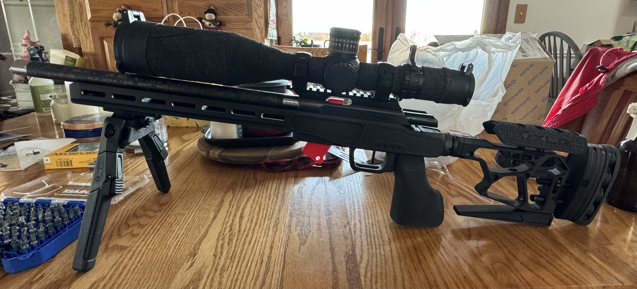

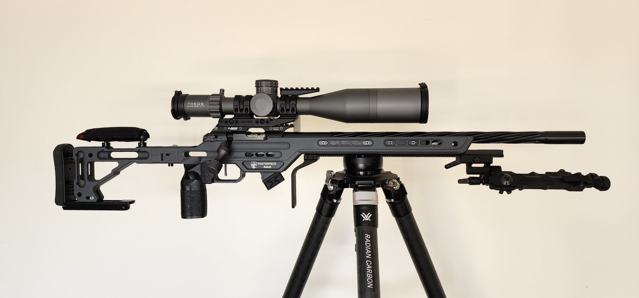

Vudoo in MPA CZ 457 MTR

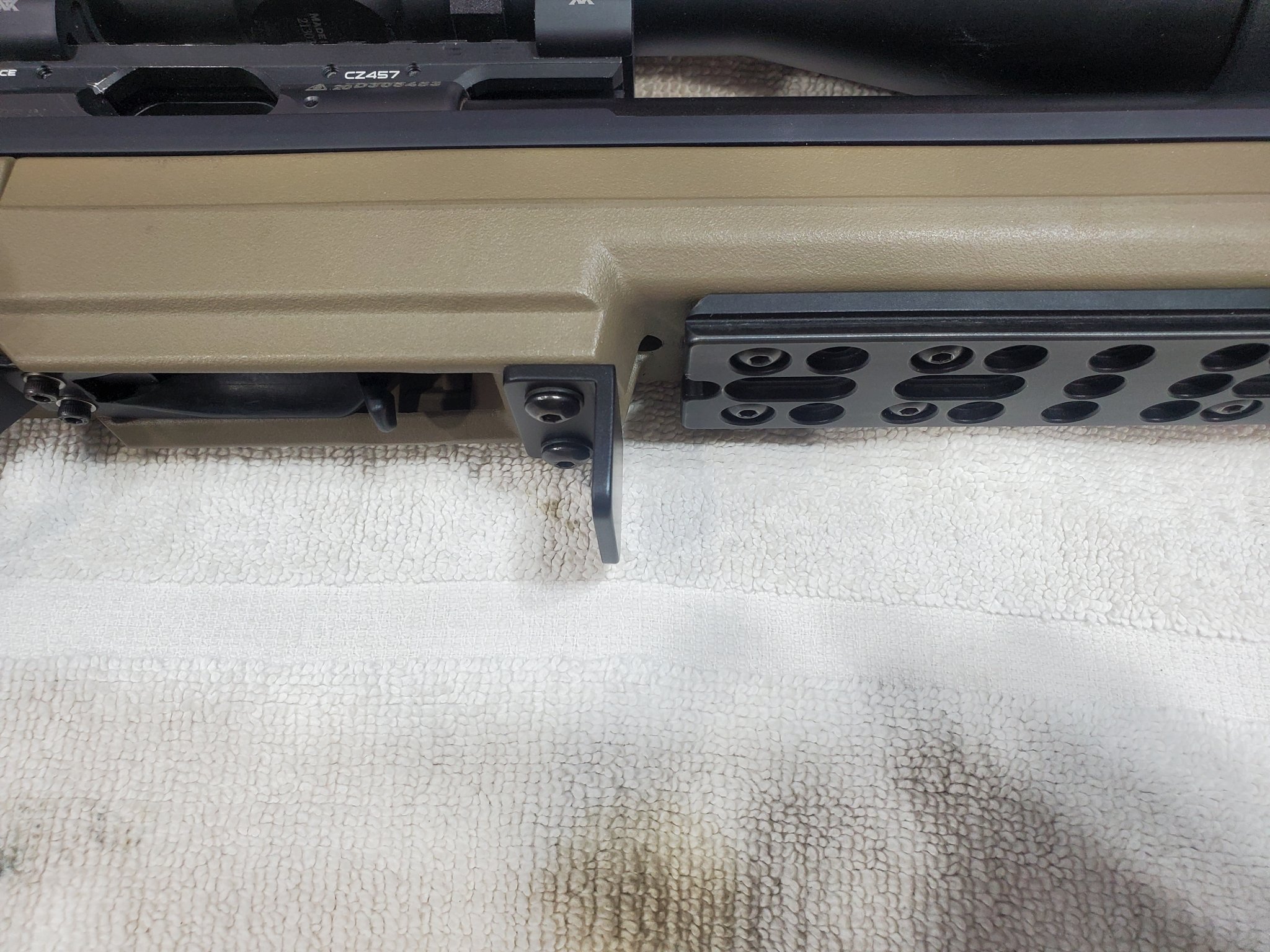

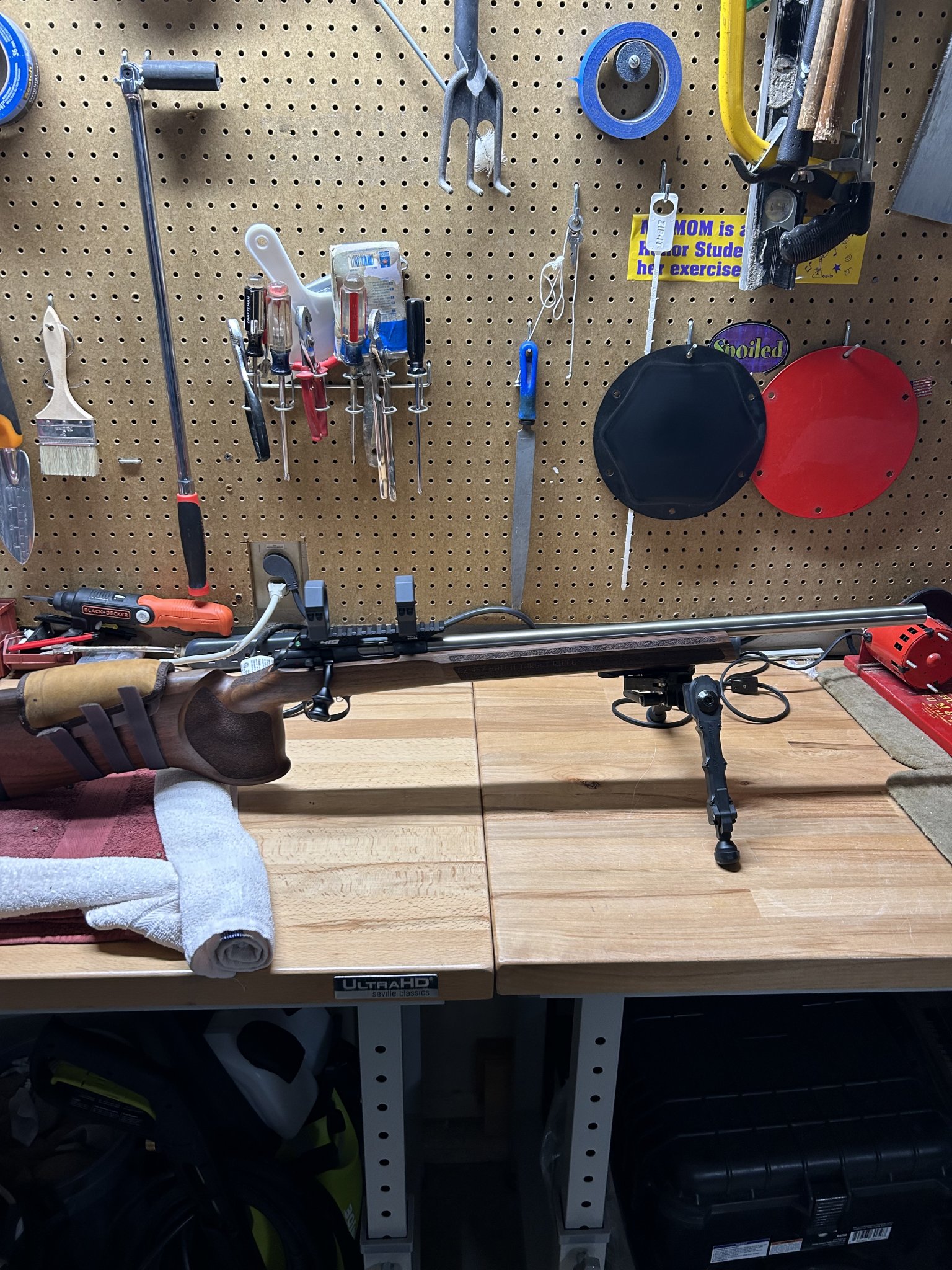

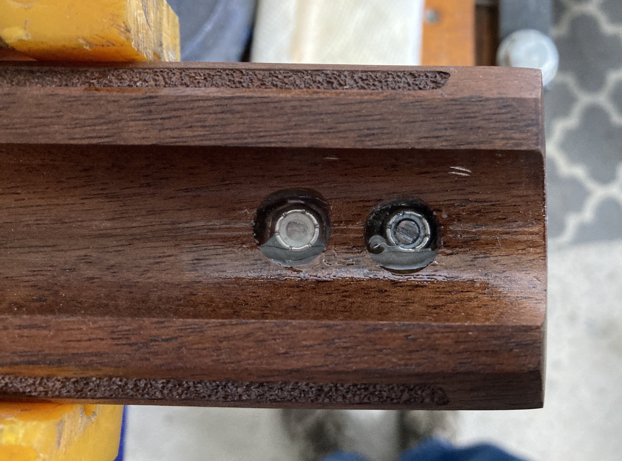

Here’s some pictures:
BT-17 using sling stud locations to drill and insert the T-nuts. Note that mine gets a lot of outdoor use in rain and high humidity, thus the rust on the screws. If yours only sees fair weather bench situations, you won’t need to replace them with SS.
Regarding mounting the rail in front/behind the sling studs, note that it would end up in that red circled area. Too close in to the action.
The flush cup is a quick connection method that us extensively used these days. In the following picture, I’ve used red to indicate the flush cup receptacle. If you have a need for a sling stud, buy the $15 adaptor I linked above and it can sit in that flush cup if you prefer. Or you can leave it on the end of the sling and snap it in and out of the rail as needed.

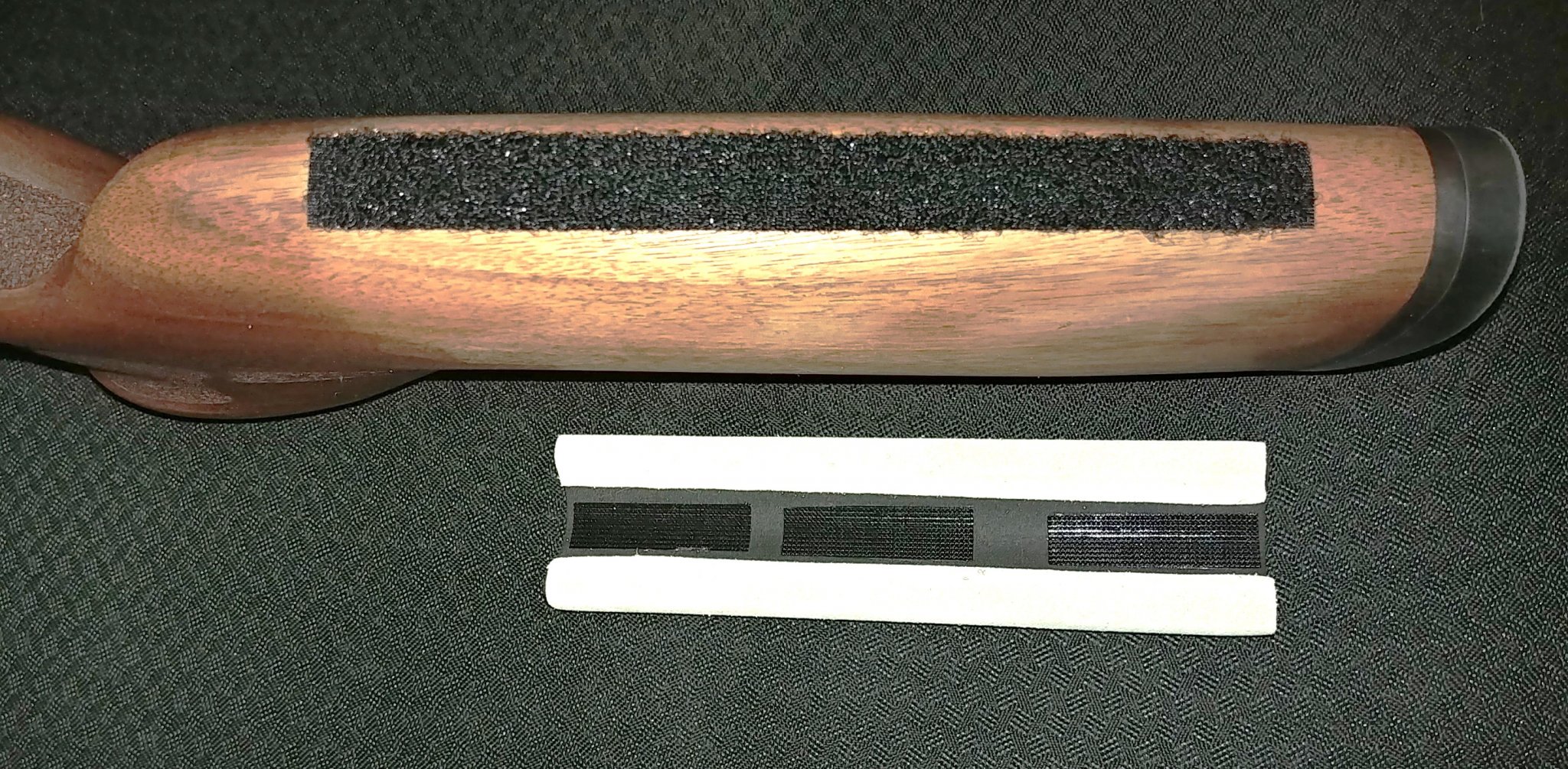

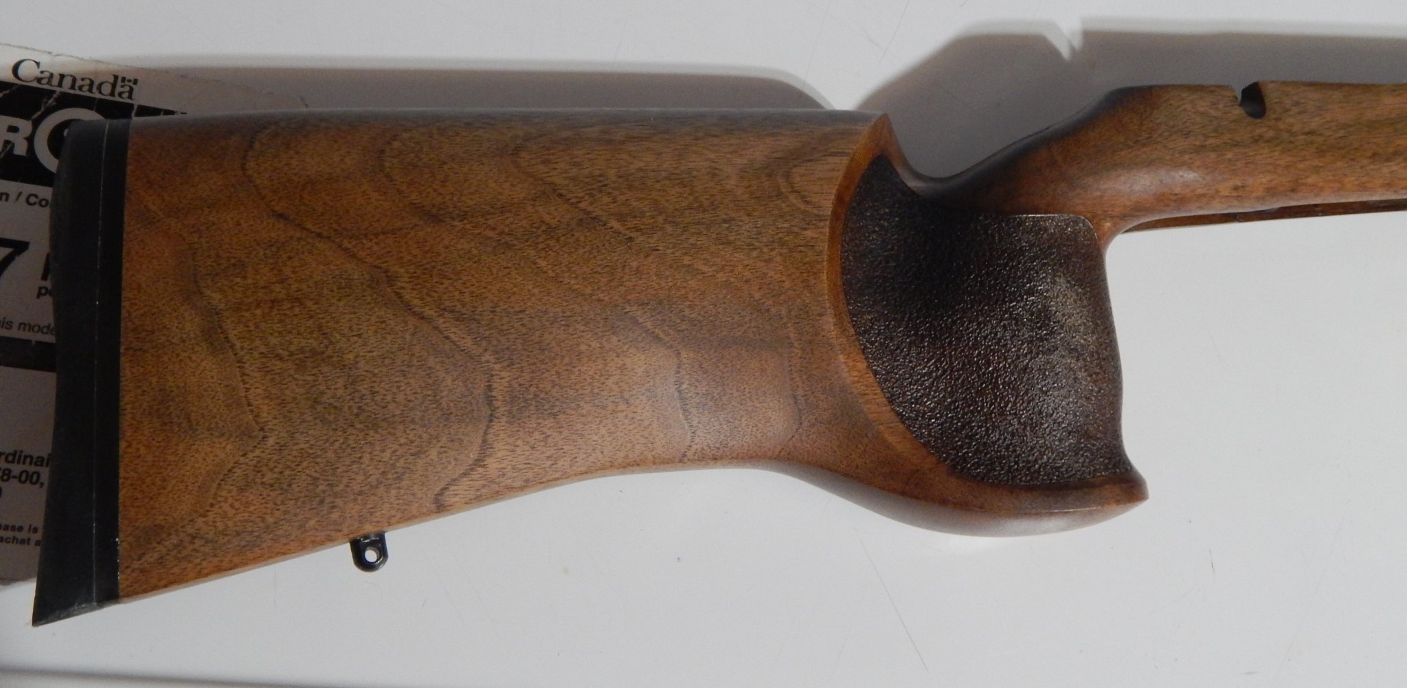

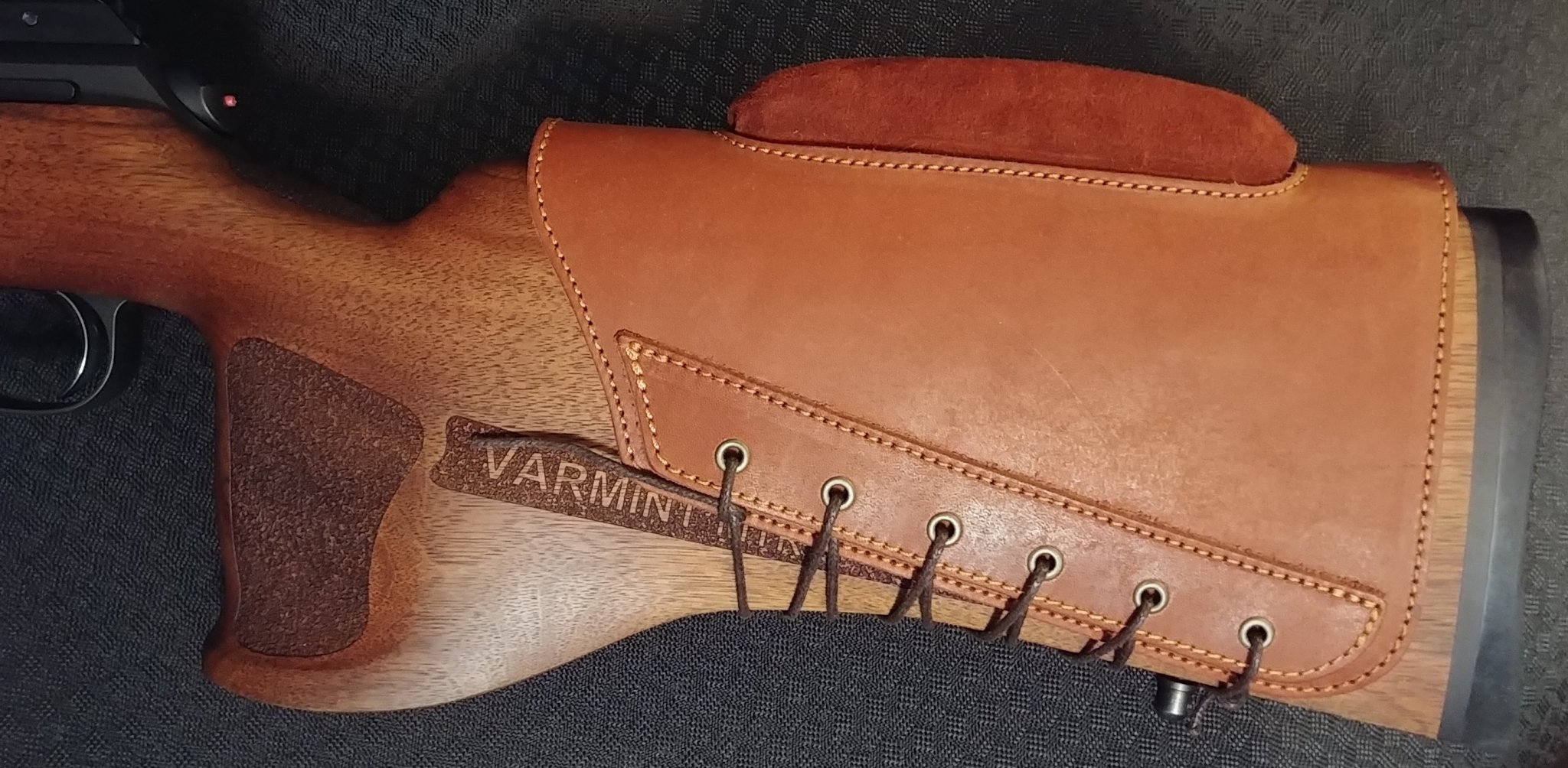

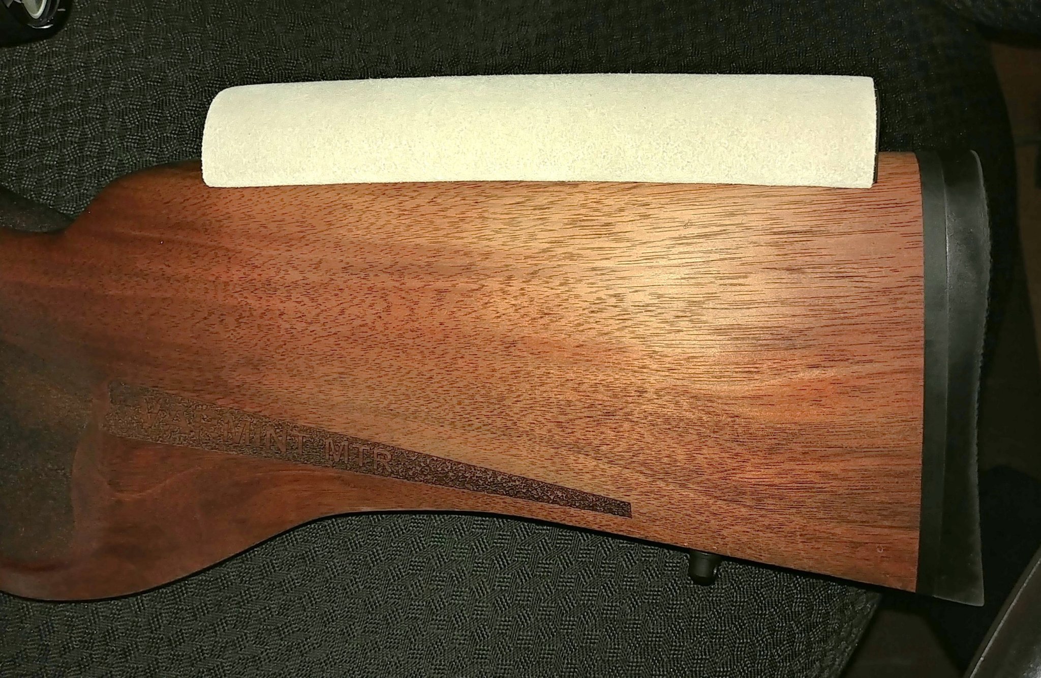

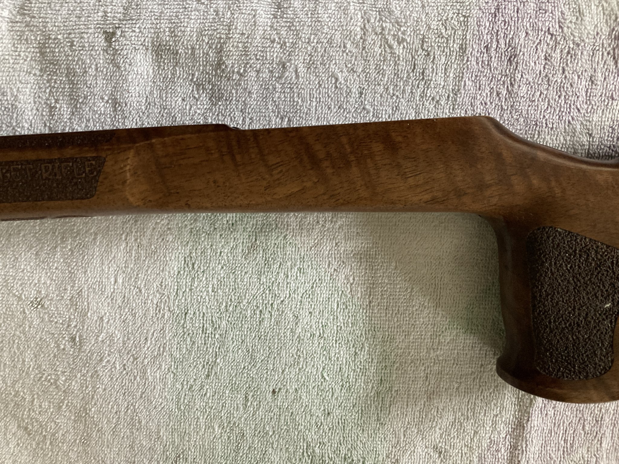

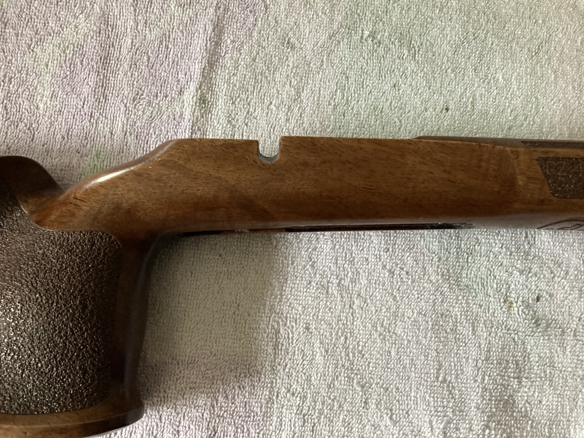

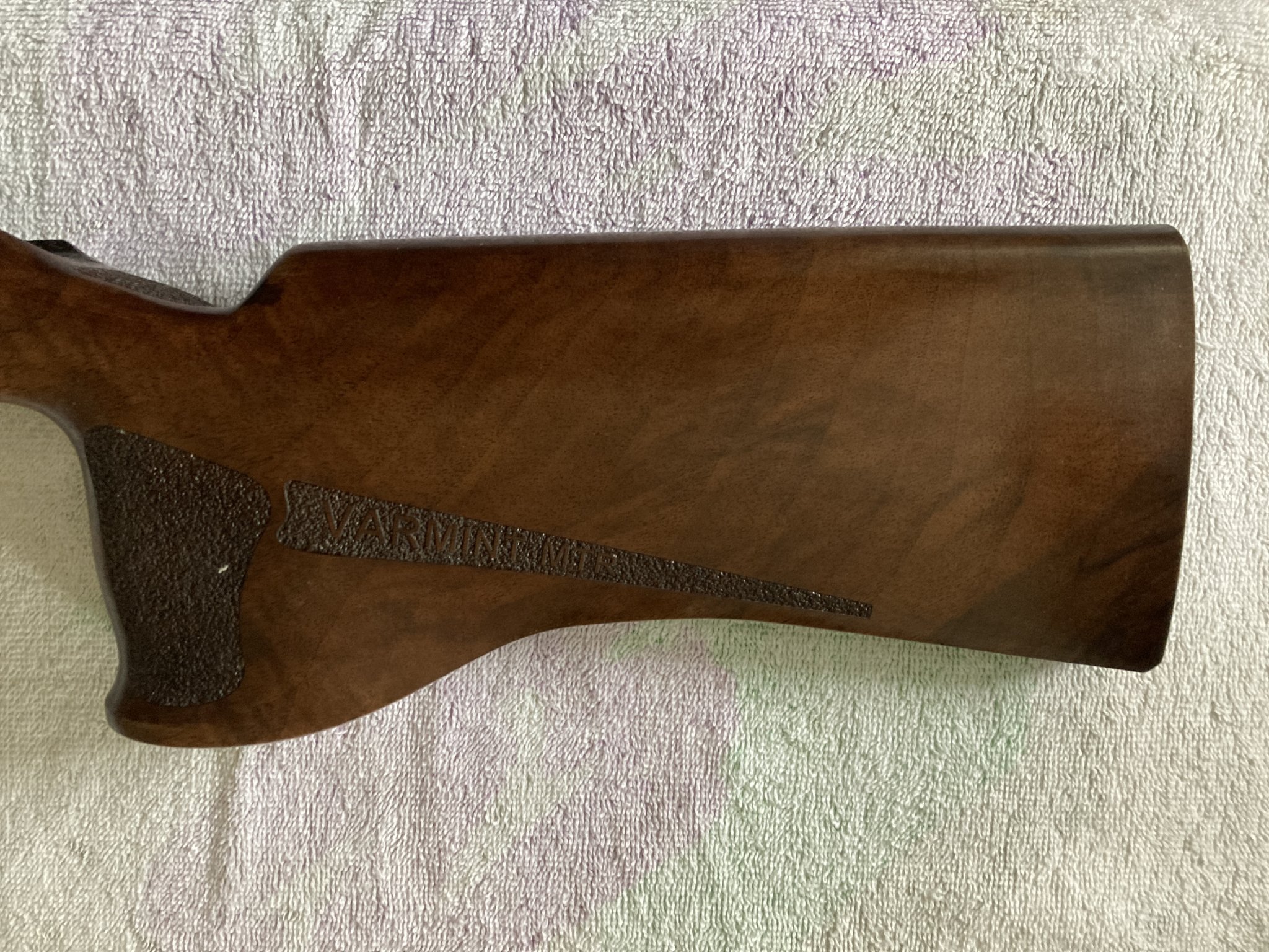

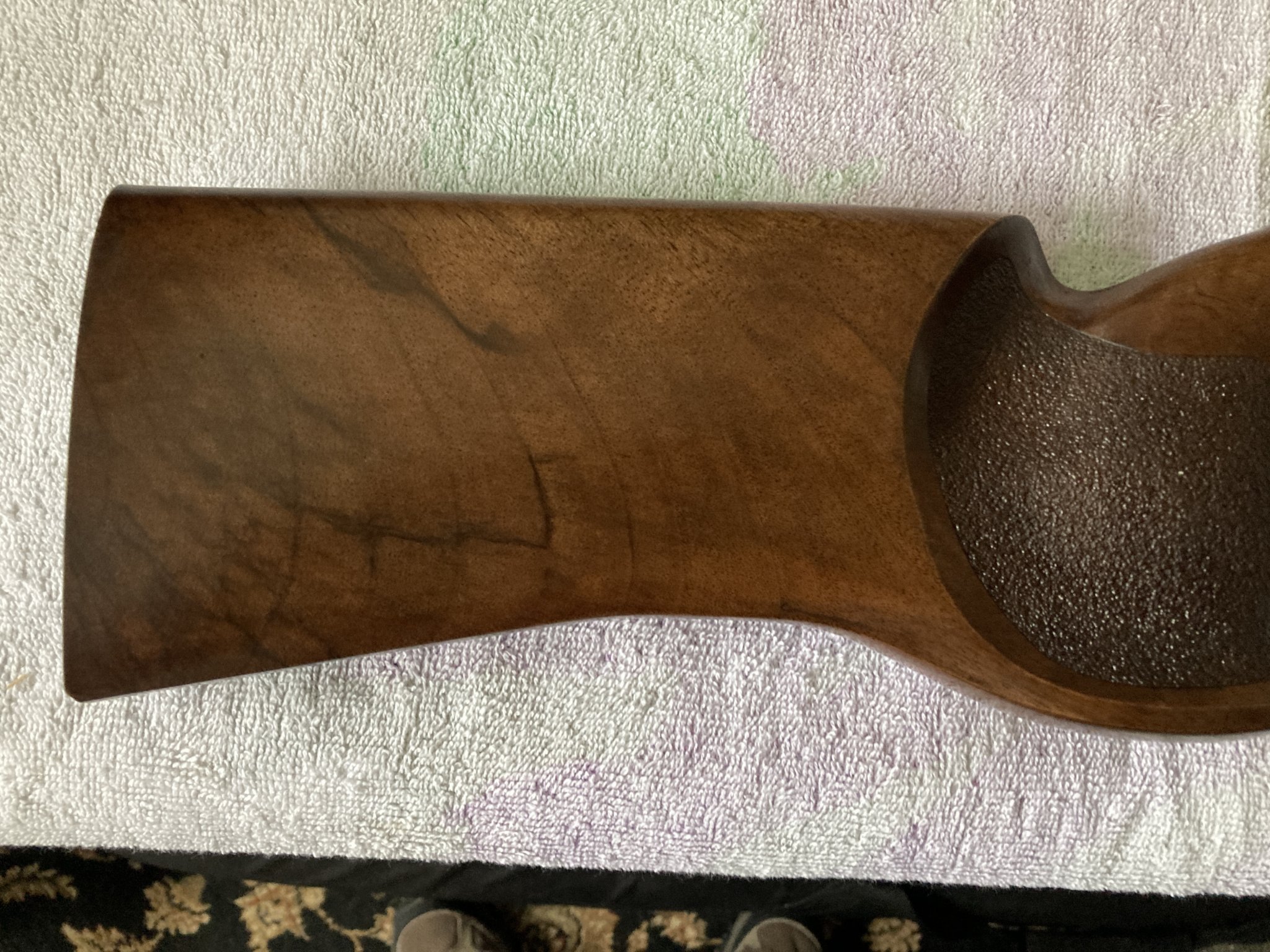

The walnut on this MTR is beautiful... wanted a cheek riser but didn't want to permanently alter the walnut.
This Brit has a great solution, but I don't have a bandsaw
https://youtu.be/B0HQzRWHsNc?si=G80yJOmYCZs8Gylc
So I tried a cheap Amazon leather riser, which works well but is in the way of the bore guide and a PITA to get on & off
eBay has Tourbon foam risers... covered one in soles2dance stick-on suede, some velcro and it works pretty well. The one velcro strip on the walnut is easily removed later.
Reactions: Grey Kiwi and lash

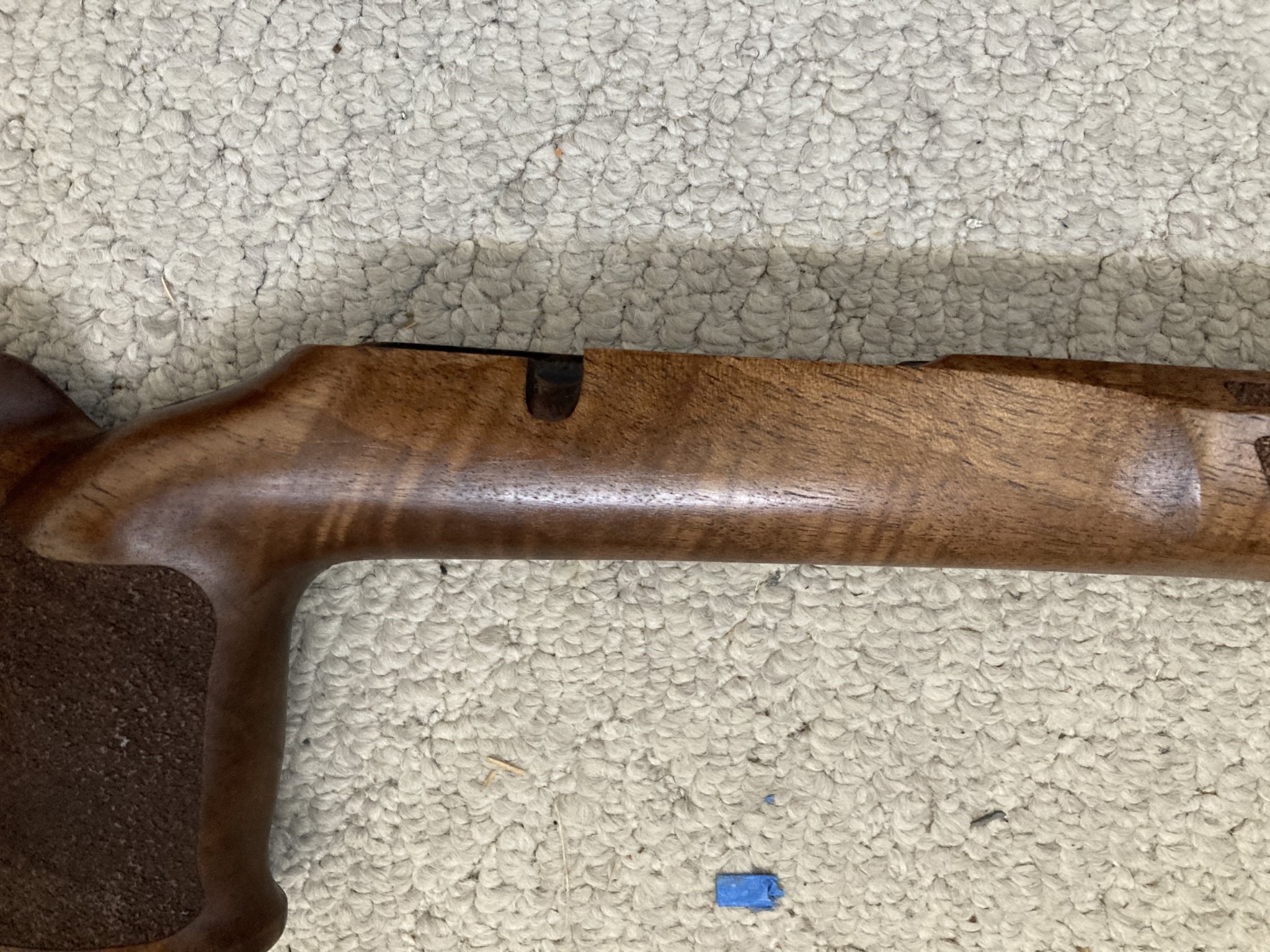

Question to MTR owners. Will a Lilja straight .900 barrel fit in the wood stock?? The stock barrel is ,860 so it looks like it should fit. Anybody has one that can post a picture that would be great.
Thanks
Pretty easy to open up the barrel channel to fit the .900 barrel. Had to do it on the Boyd's stock that came on a 455. Wrapped sandpaper around a deep socket and went at it. You could even wrap a long strip of abrasive paper over your factory barrel if you were in a hurry.
