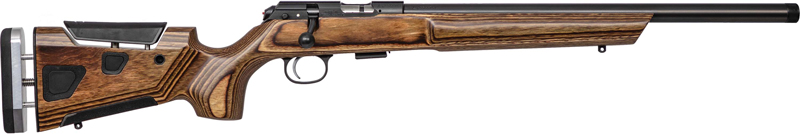

For those of us in the DEEP south,
these are available in Aus,
I didn't know if they were all metal or plastic.
Was more showing there is an option here with the barricade stop also.

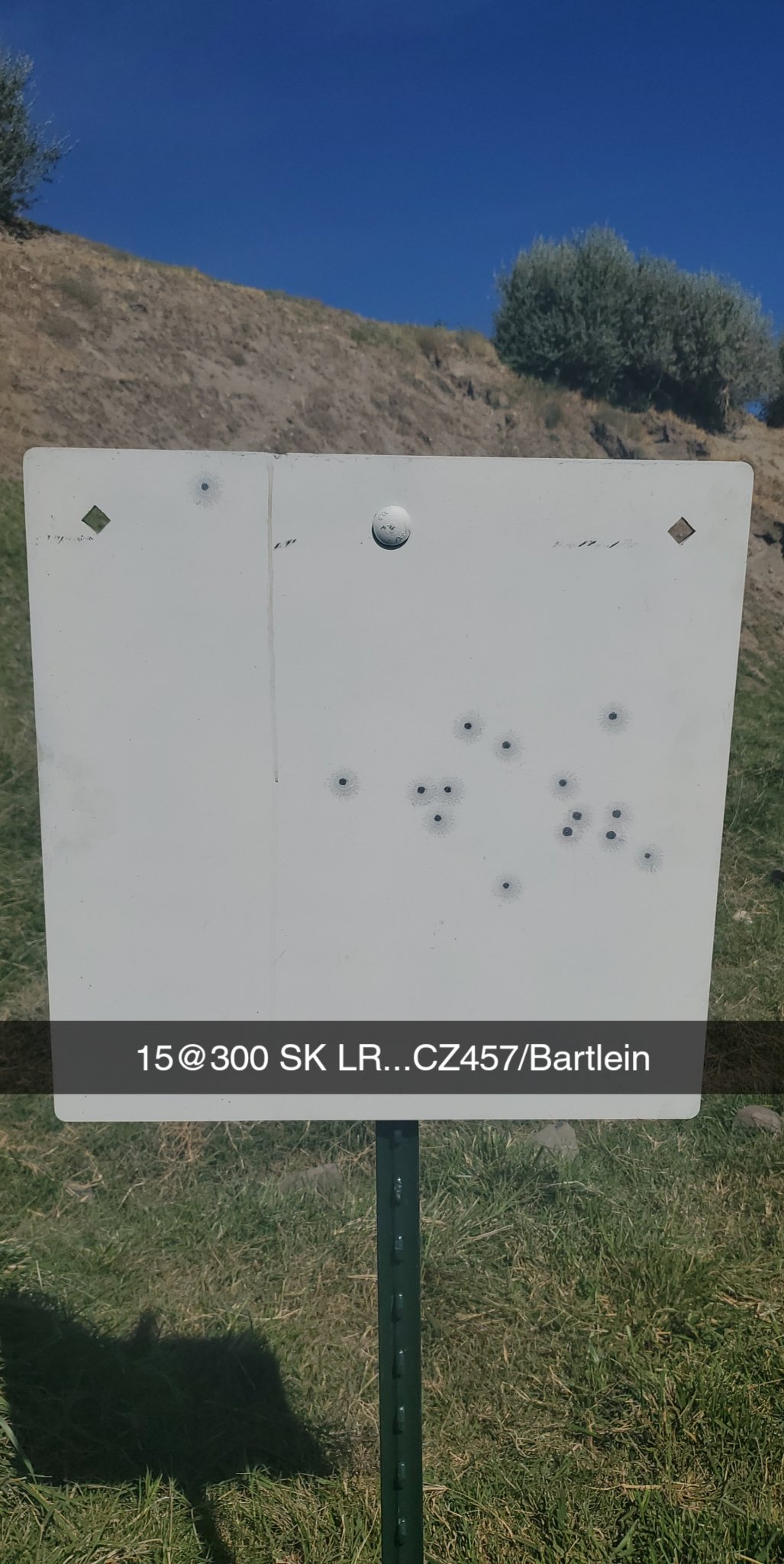

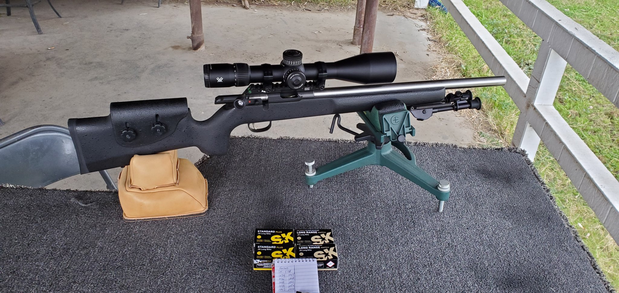

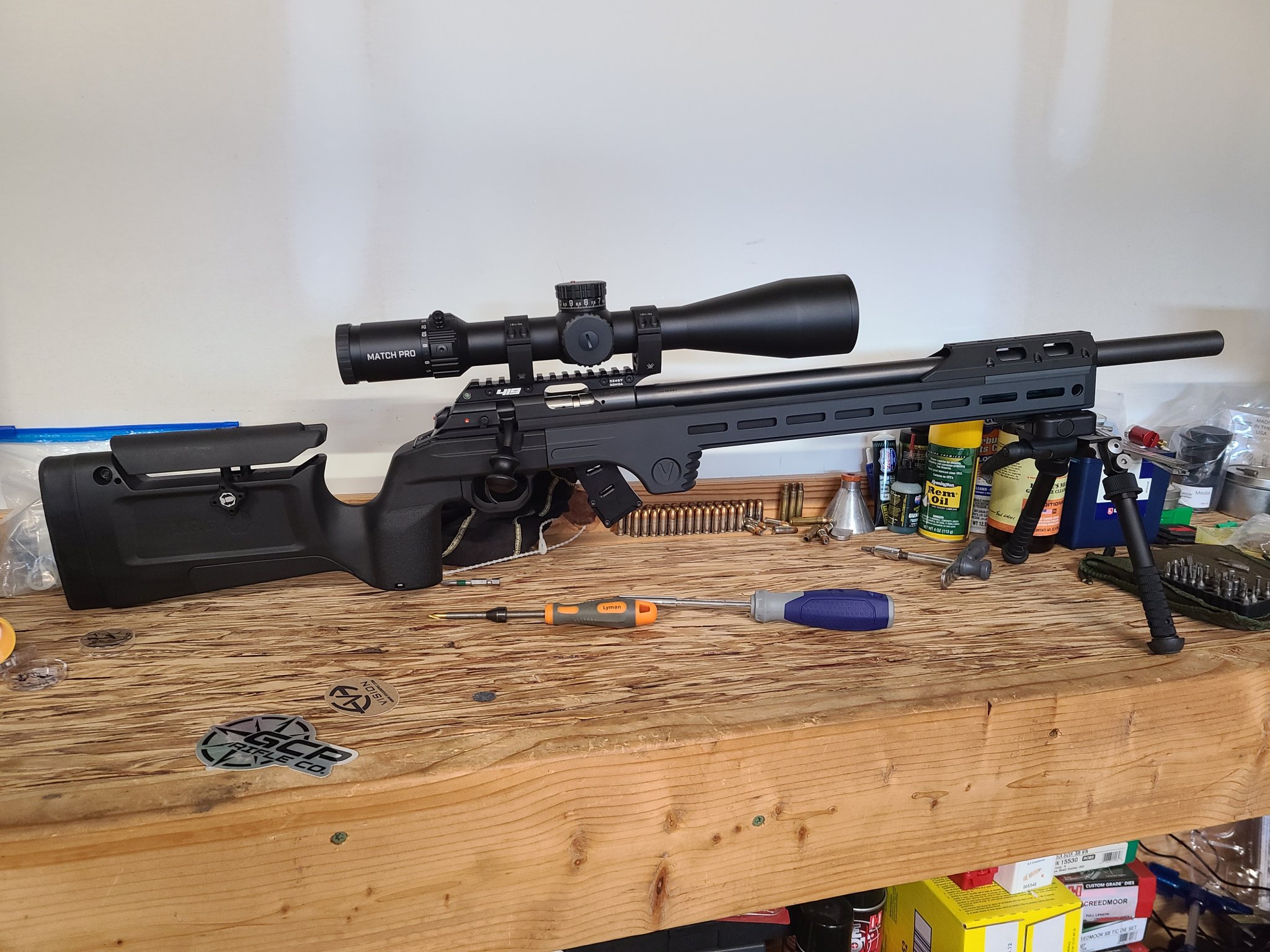

We have had a sorta curvy path on getting our MTR together, but it is getting there slowly. I'm for now just planning to play around and accessorize the stock rifle a little and will look at optimization and/or parts replacement later, if at all.
We broke the rifle in my shooting bench and prone on sandbags with an Vortex Diamondback scope. I got the feeling right away that it was a shooter because the gun wasn't optimized and it was shooting under an MOA at 50-100 yards in lousy conditions, like winds that moved the shooter around a bunch.
About a month ago, my son bought a Vortex 5-25 Strike Eagle and I got a 30MOA rail and rings. Then a couple of weeks ago, I used Lash's approach to mount a rail, then put an Atlas bipod on it. Even with variable winds, it mostly shot groups at 50 yards in the 0.5 to 0.7 MOA range and had a few groups below 0.5 MOA. Best was 0.24. One group had 4 shots into 0.13, then a flier, so I think that's a range to strive for.
I'm normally prone to be a trigger snob, but I like the stock trigger and I've left it untouched so far. We've had good performance from Norma Tac-22 and excellent performance from Lapua Super Long Range. A few CCI cartridges have been good, but none stellar.
I do realize that the group sizes I mentioned above are not hot shit for competitive shooters. Back when I had decent vision, I was competitive enough to know good. Now I'm just a blind old fucker that can't shoot for shit.

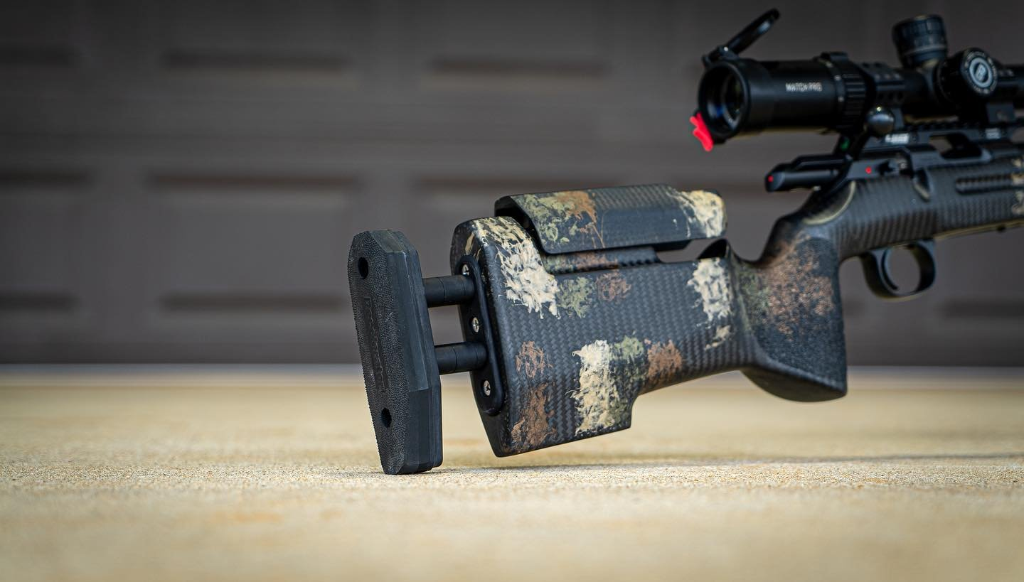

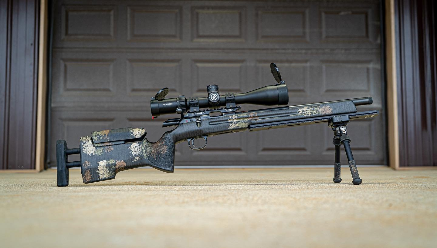

Realized I shared this on RFC but not here. I don’t know who all has seen this yet, but I stumbled across it last month and thought I’d share. Manners recently announced they’ll be offering a version of their TCS (Tunable Competition Stock) for the CZ 457 this year (2024). It's basically the CZ 457 Varmint Precision Trainer MTR stock with an adjustable butt pad but available without buying the complete rifle from CZ.
They said it’ll start at $924 + shipping but will probably have some add-ons like their other stock as well as finish options. I recently spoke with them about adding the Sikes Clutch Knob rail to mine and they offer it for $65 installed (shipping round trip is about $60) so this might be an option when ordering a new one. Price does not include the rail.
Features they mentioned in their Instagram Post:
  • New 2 way adjustable buttpad! This stock has rear hardware that allows adjustment in both length of pull and up/down movement letting you dial it in exactly the way you want it!
  • Adjustable comb. Using the same proven design of the LRH we incorporated a lightweight yet adjustable comb to achieve a perfect comb height!
  • Arca Ready. The stock comes with internal hardware to mount the popular MCS/Area419 weight tunable Arca rail!
  • Molded in texture. This stock comes with palm swell texturing allowing you the perfect purchase on the stock.
  • Full wrap around shell. The stock will be incredibly light, stiff, and hold up to whatever you throw at it. This feature really helps lock in the rear hardware and allows for a molded in bolt notch so that no strength is compromised.

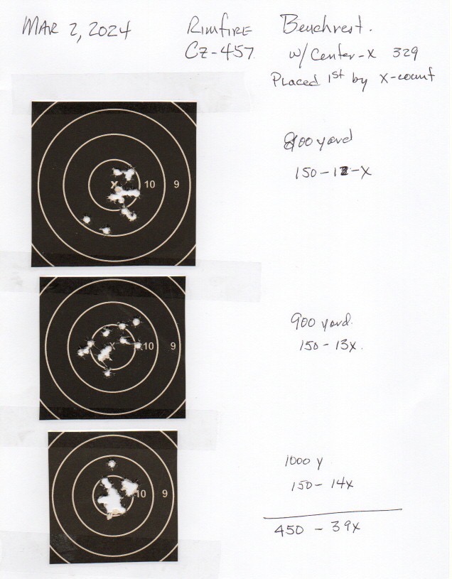

I thought you'll might be interested in what my MTR that I had bedded and shown you how to do it in post #2950. I shoot this competition when I can. Mar 2 was the first one I could shoot this year so instead of using my 40X or Anschutz 54 I decided to shoot my completed CZ 457 that was showing great promise at 100 yards. This competition is shot on the rimfire Palma targets. The targets are scaled for the Palma target at 800, 900 and 1000 yards and for a 22 caliber bullet rather than a 308. The 10 ring is like 1.9 for 800, 1.7 for 900 and 1.55 for 1000. I normally shoot this prone but I broke my kneecap in January so I cannot kneel for 3 months and therefore can go prone. So we have a second relay that are "old" guys that can't or won't go prone. It is shot off of a bench. My set up is a Sinclair front machine rest with a protector rear bag. I was shooting Center-X (speed 329). Right next to me was a friend who is an awesome gunsmith with his new Rim-X that he built himself.
So the competition started and I shot a 150-12X on the first bull. So did the Rim-X. The next bull I shot a 150-13X and so did the Rim-X. AT this point we were the 2 leaders so one of us was going to take first and the other second unless we really blew it. So on the third target (smallest) I shot 150-14X and the Rim-X shot 150-10X And what was really weird was that his 5 10's were on the outside of the 10 ring touching in a circle!!
So my bedded 457 with a Jard trigger and a shimmed bolt to set a tighter headspace beat out a rifle that for sure was 2X in cost. But when I went back and did a comparison of my previous targets, the 40X has never delivered a clean on all 3 targets but with the best of 36X and my Anschutz 54 has delivered a full clean but with a 30 X count and 449 with a 35 X count. I would also point out that my 40X and 54 are in full benchrest stocks.
This now is the the best rifle in my stable and the lowest cost I might add.
So here are the 3 targets thaat were shot yesterday. The X ring on target 3 is .8 inches for reference.

Nice shooting! When you shoot a Vudoo or Rim-X, winning is somewhat expected. When you shoot a CZ, your an underdog. Consequently, there is something extra sweet about kicking but against top end rifles with a CZ. I own a really nice custom Vudoo but still enjoy my CZ's regularly. Largely for just that reason. ;)
