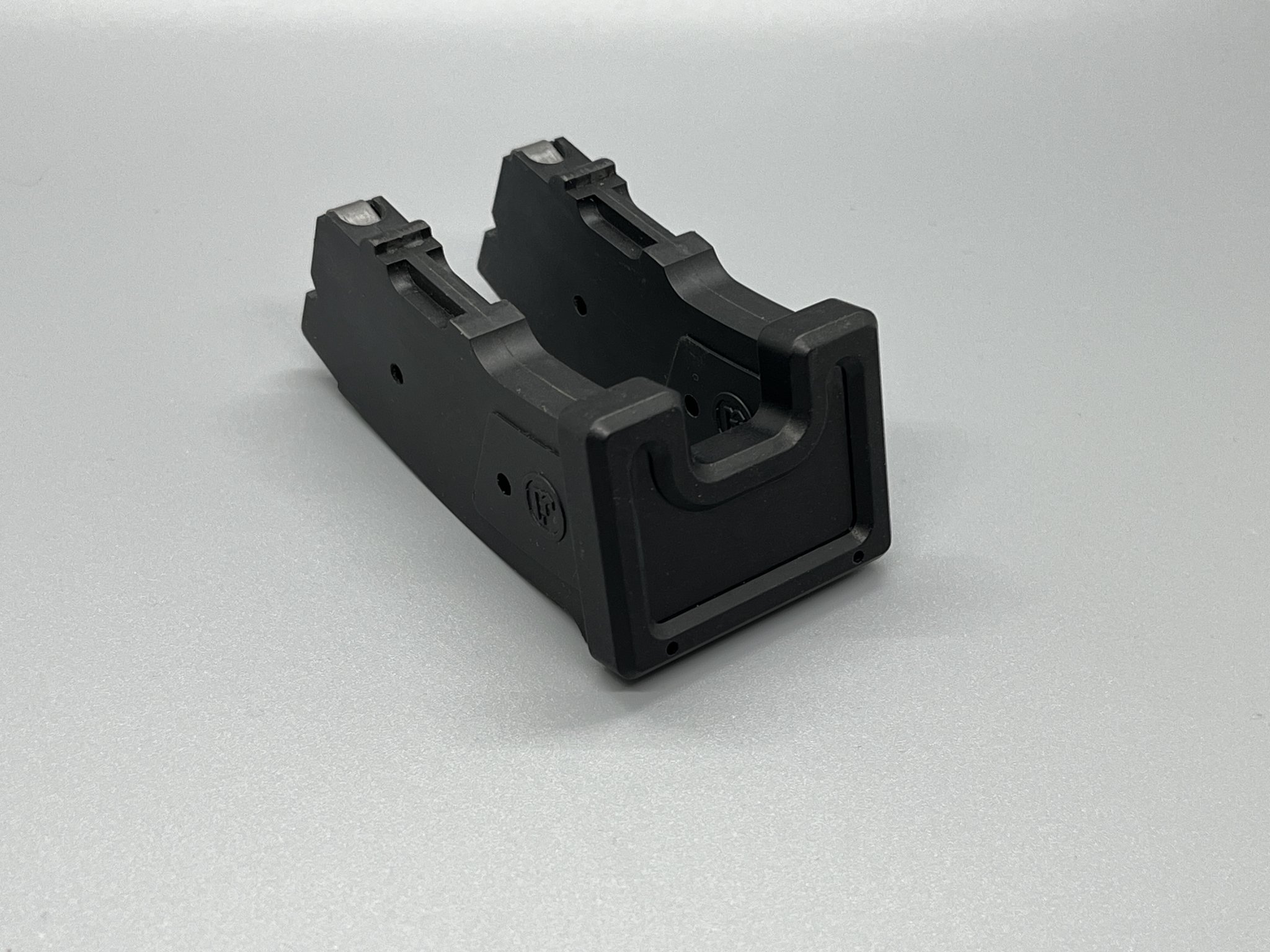

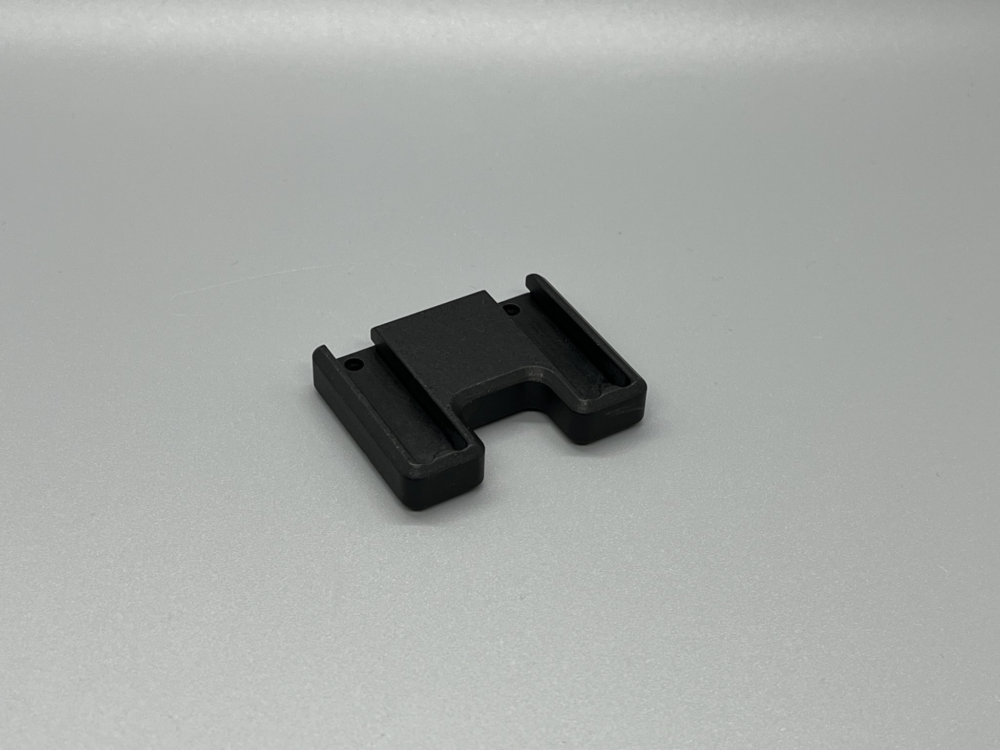

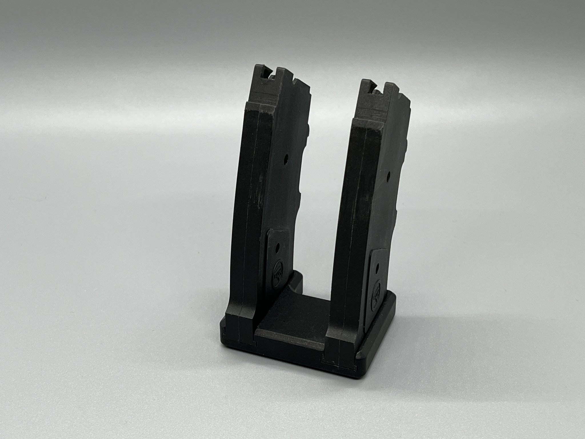

With all the mandatory reloads in NRL22 lately, I fired up the 3D printer and am testing a new mag coupler I designed. Working on getting quotes from a local machine shop for an aluminum version, but I'm not sure how much demand there would be for a group run of them... Thoughts?
That’s pretty sweet. Any chance you’re selling the .stl file or sharing it?

Aluminum couplers are back from hard anodizing and ready to ship! PM me if you’re interested! $50 for the aluminum version, $15 for 3D printed, free US shipping. 100% Minnesota made.
I got to give them a good test a 2 day NRL-X and a few regular matches with no issues. I’ll have them at NRL22 Nationals as well - there might even be one going with a prize gun 🤘

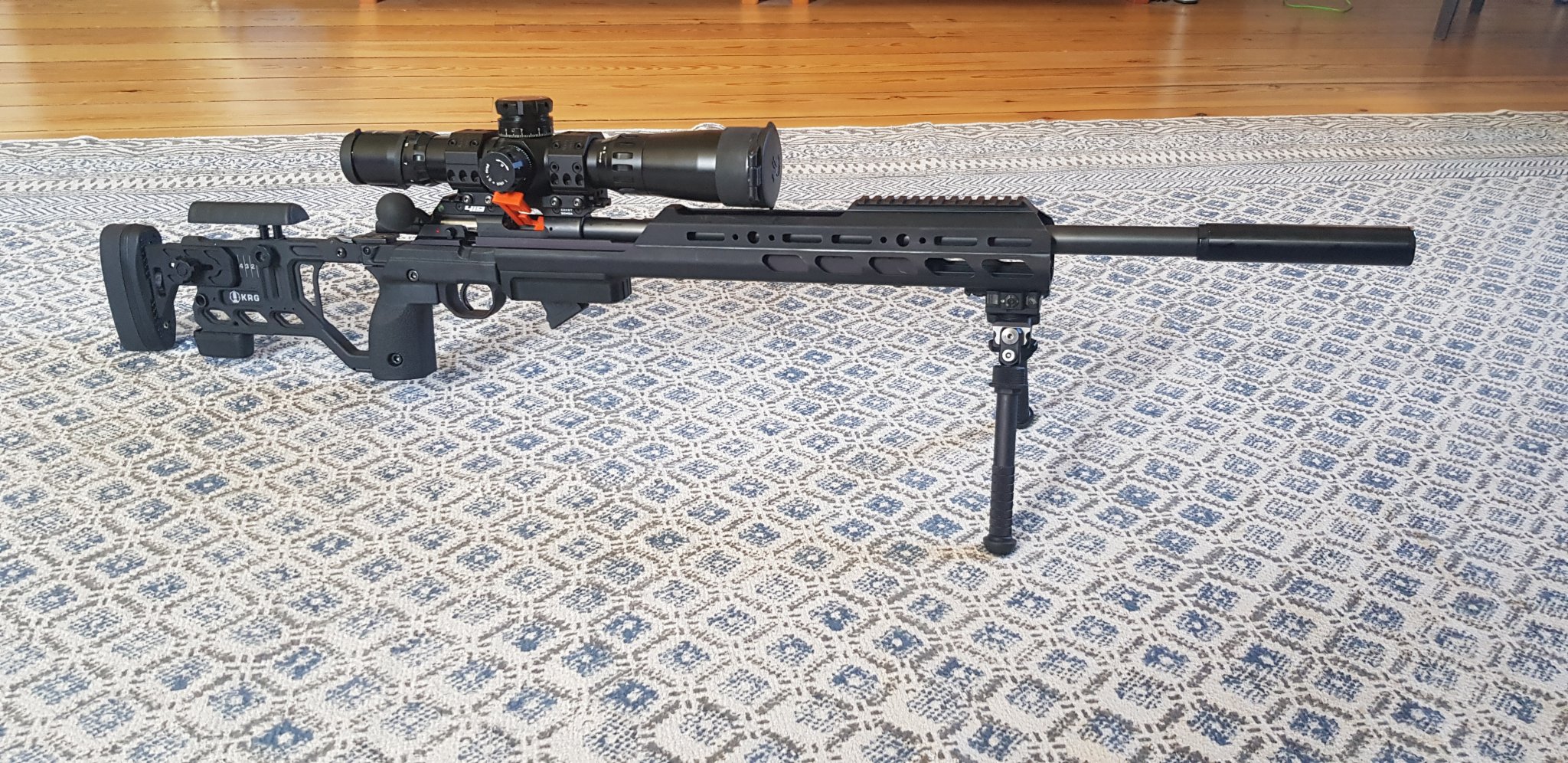

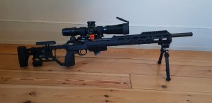

CZ 457 Varmint 20" in a Krg Bravo back bone with a W3 folder and enclosed forend.
Area 419 30 MOA rail for a Spuhr with additionally 20 MOA cant for a total of 50 MOA which is a tad less than half of the total adjustability of the IOR Recon 4-28×.
Old random bolt knob rubber ball, a Atlas PRS bipod and a Ase Utra ECOi moderator.

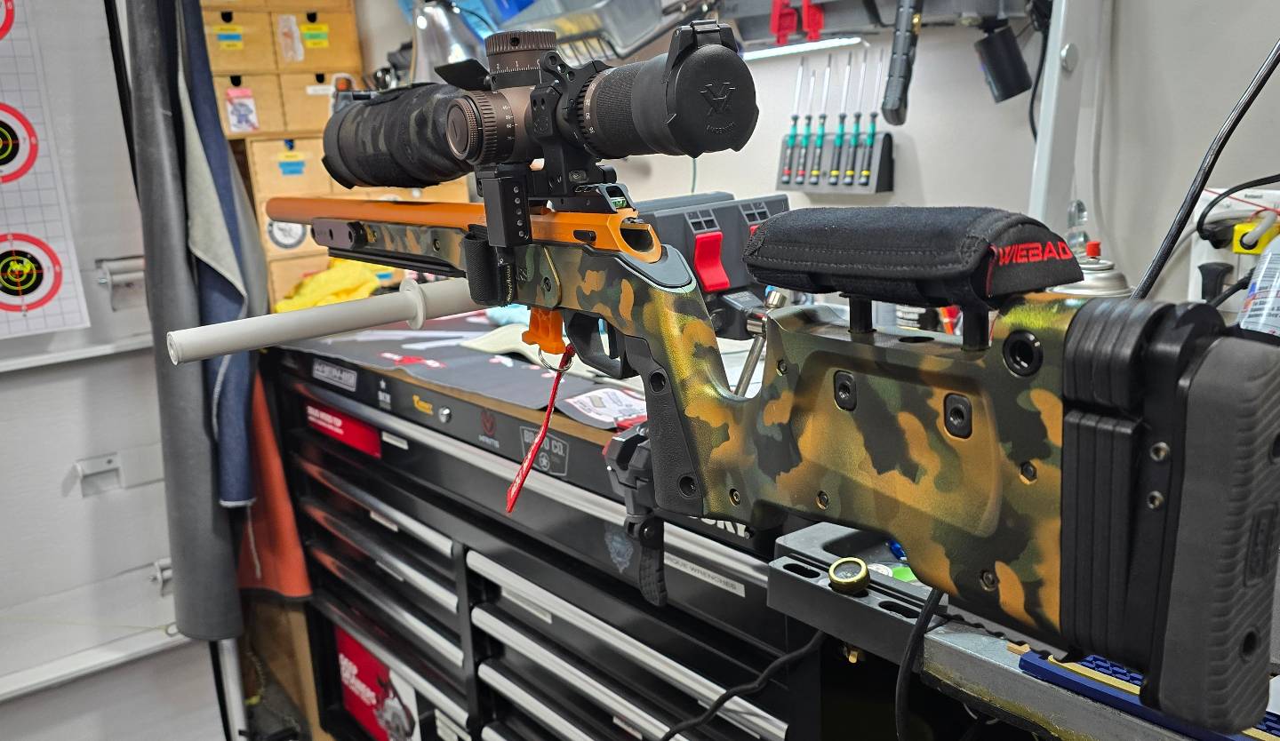

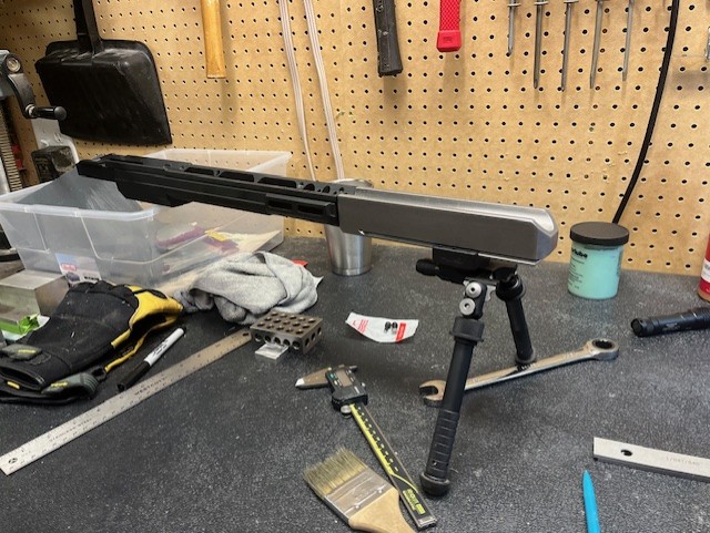

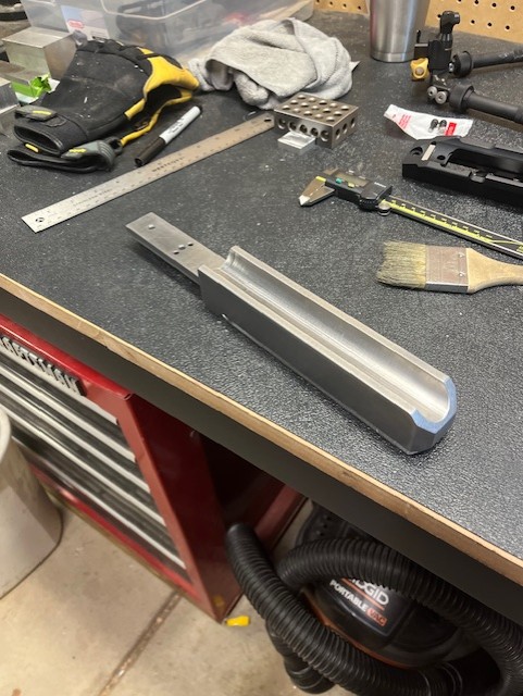

A friend of my was looking for more weight up front for a Bravo based CZ457 he uses for Rimfire PRS. I roughed up an extra heavy spigot for him. A little ugly in its rough state but he is loving the new balance point. Comes in right around 4.5 pounds if I recall correct.

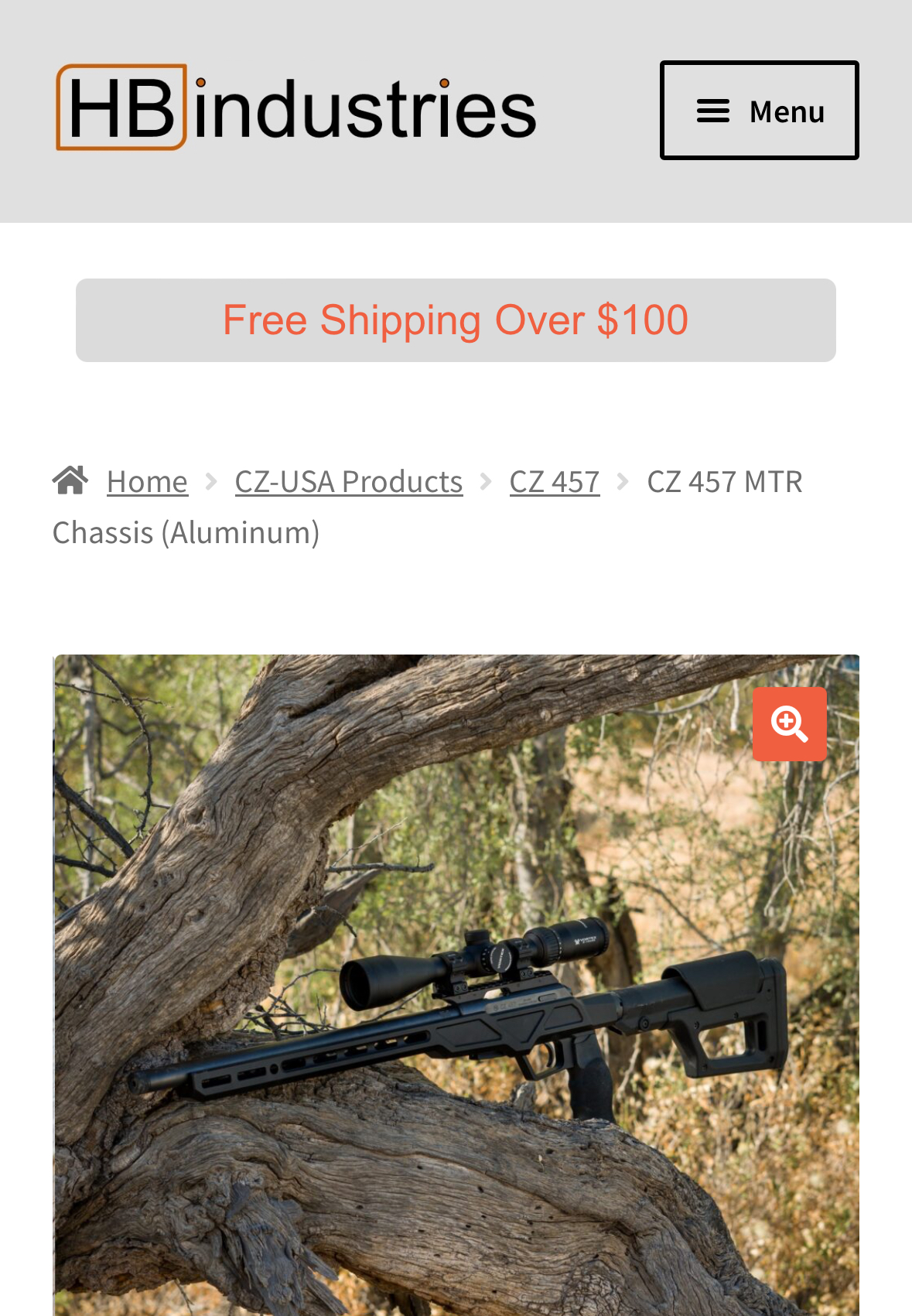

Thanks! I’m thinking of going with an HB Industries chassis, like they used to offer on the now-discontinued varmint precision chassis rifle. The problem is, after getting the chassis set up like I want and whatever cz 457 I can find, you’re into B-14R money. BUT, it’s easier to add weight to a chassis, for balance, than it is to add weight to the hmr stock to that comes on a B-14R.
