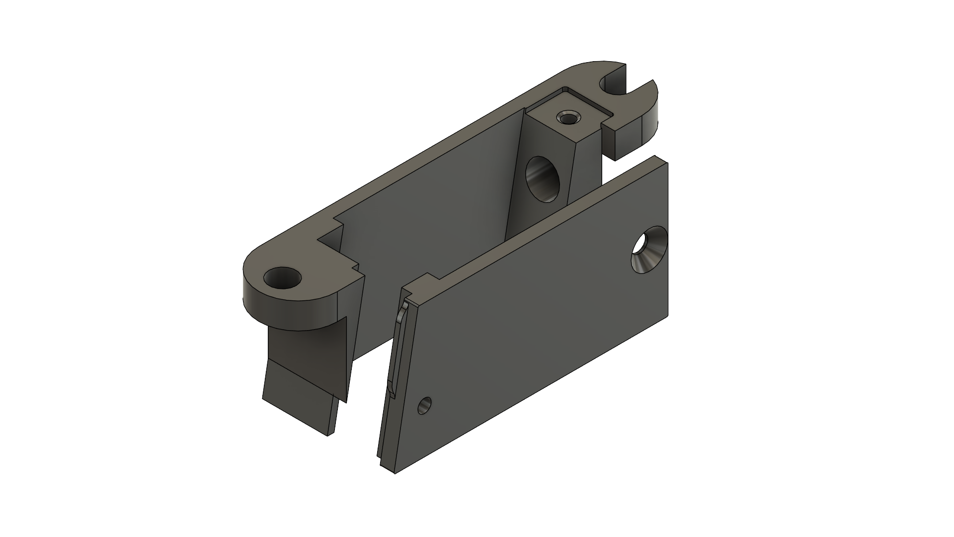

Just received and installed this bottom metal from @Thesepaperwings at L3i. The part is well made and really helps with mag insertion. It also comes with an extended mag release, which you will need once the metal is installed. I will say that I struggled with the release installation, not because of the part, but because of my ham fisted fingers, and I knew I was going to loose that stupid little spring. Simple installation, but like a lot of gun stuff, a little spring going into a blind hole and line it all up under spring tension and insert the pin. After getting frustrated, I put it down and thought about it, then installed the lever without the spring. Easy peasy. I took a silver sharpie and made a dot, half and half on the lever and bottom metal. Disassembled the lever, put a blob of grease on the spring to hold it in the hole, reassembled it, lined up the dot halves and slid the pin in. Why didn’t I think of that first. Anyway, it is so much better, and is so much easier to load. Thanks L3i for a great part, and maybe I helped some of you home smiths out there.
Thanks so much for the support! We're an extremely small company ( 3 people) with very limited resources (most things are packaged on the kitchen table). We absolutely love this sport and hobby so it's awesome to be able to contribute to it.
Definitely going to look into your bottom metal!

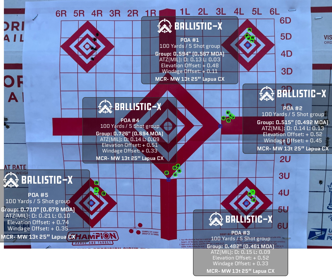

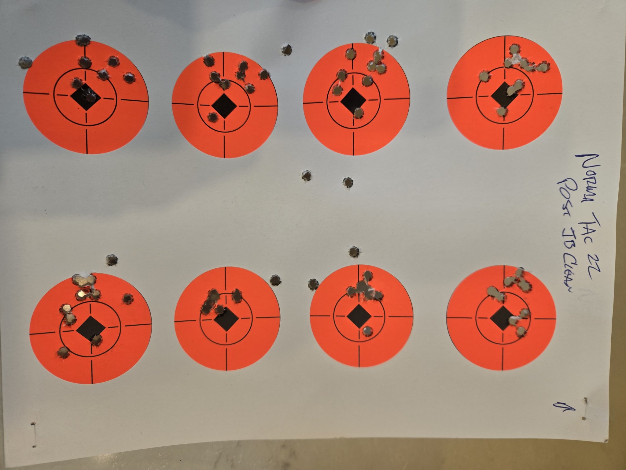

Finally got out to shoot both rifles at the same time in the same conditions. Had to steal the scope of my centerfire rig, but I’m into rimfire mode now anyway.

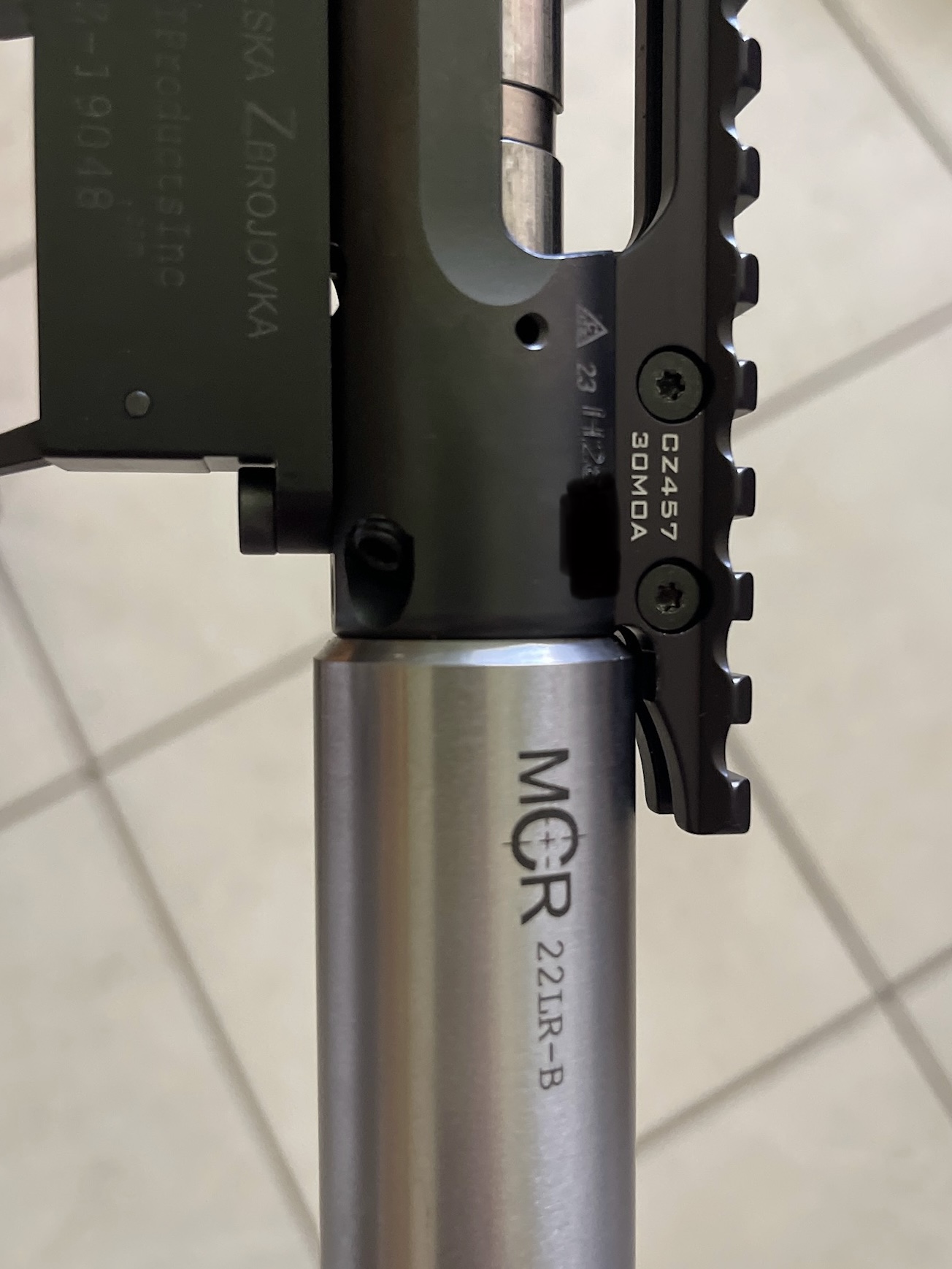

Independent review, but I’ll try to not let my massive appreciation for @jelrod1 @ MCR-rifles.com for donating this barreled action & trigger and MDT for donating the pre-release chassis to the NRL22 National Championship match bias my comments. You folks make some kickass, quality stuff and your support of the sport is hugely appreciated!
Blue rifle: DPG thermal fit 24 x 1.10”, ACC gen1 w/1.5 lbs up front & aluminum butt plate, Razor gen3 on an MDT 40 MOA rail, Timney flat trigger. ~1k down the tube if I had to guess.
Black rifle: MCR built barreled action Muellerworks 24 x 1.18”, ACC gen2, Razor gen3 on an MDT 20 MOA rail, Timney flat trigger. Brand spanking new.
Both shot off a ckye pod (LW double) and heavy Schmedium rear bag. Same lot of Center-X, only a few minutes apart. I’m not a benchrest shooter, just an NRL/PRS shooter and was cracking out 5 shot groups as soon as I got stable. No adjustments for wind.
Both shot well. Only had a few shots out of each that wasn’t my fault at each distance. Further ammo testing and lot testing might be able to tighten things up a smidge, but either are super good enough for my needs. The MCR might get even better after some more seasoning. Pretty awesome to see a slip fit heavy barrel shoot this well.

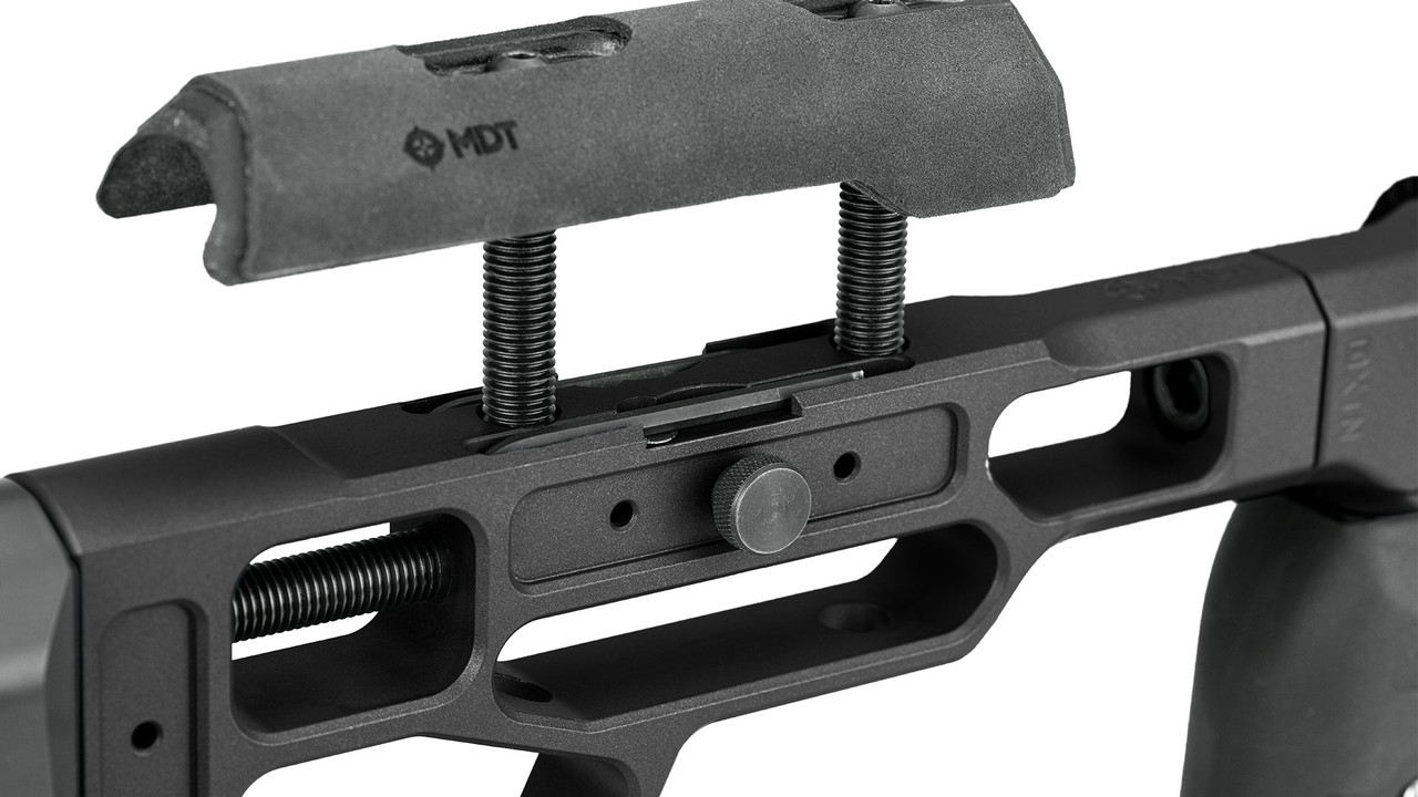

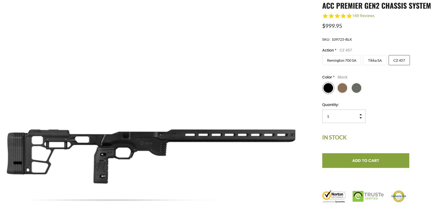

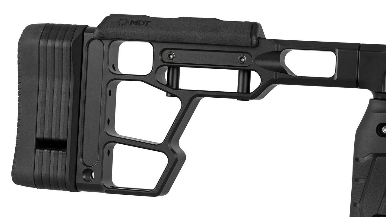

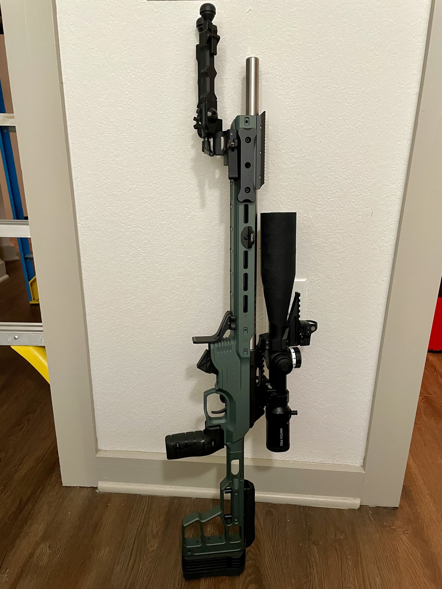

MDT ACC Chassis comparison:
Gen1
Pros:
• Longer forend = easier to balance
• Magwell covers edges of factory magwell, making it a direct funnel
• Tool-less adjustments
Cons:
• Heavier buttstock = more weight needed up front for balance
• More flexible forend
• Rear magwell filler needed for easier/faster reloads (I have a 3D printed wedge in mine)
• Snug access to mag release
Gen2:
Pros:
• Super stiff forend
• Lighter buttstock
• Barricade stop cutout for sausage finger access to mag release
• Extended mag release and rear magwell guide included
Cons:
• Short LOP - maxes out at ~13.5” out of the box, had to make a 1/2” spacer and get longer 3” 10-32 screws to fit me
• Shorter forend is harder to balance, but now that we can get proper heavy barrels, little to no weight is needed.
• Magwell spacer required some filing to allow clearance for L3i billet mags
• Magwell sides don’t cover factory magwell, making a catch for mags while inserting them.
• Grip is tiny and has lots of sharp edges. Feels like it’ll be a throwaway for most. MDT’s good grips are $$$.
I’m not sure which chassis I’ll run moving forward. Both have some solid pros and cons to them. Would love to see an Elite inlet for the CZ. I’d pay the premium to get R-Lock, better adjustments, a fully dialed magwell, the better grip and stay.
Little bit of material removed from magwell filler to allow clearance for L3i mags. This is off the back side, where the chassis makes contact with the filler piece.

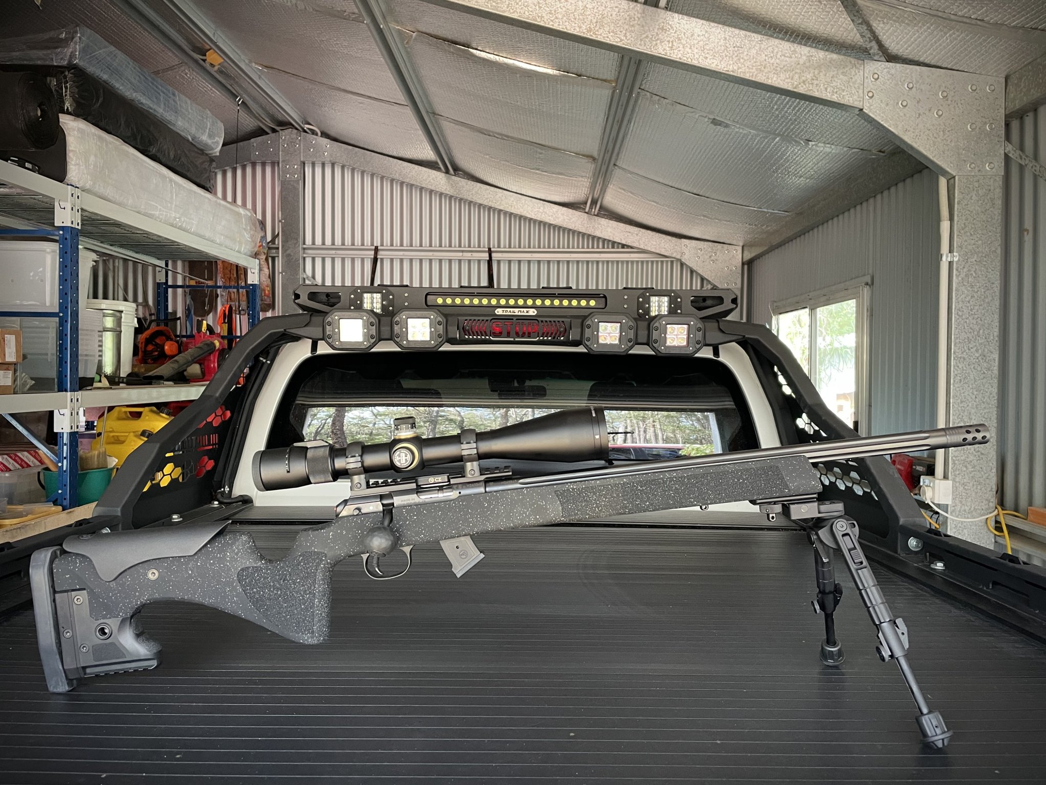

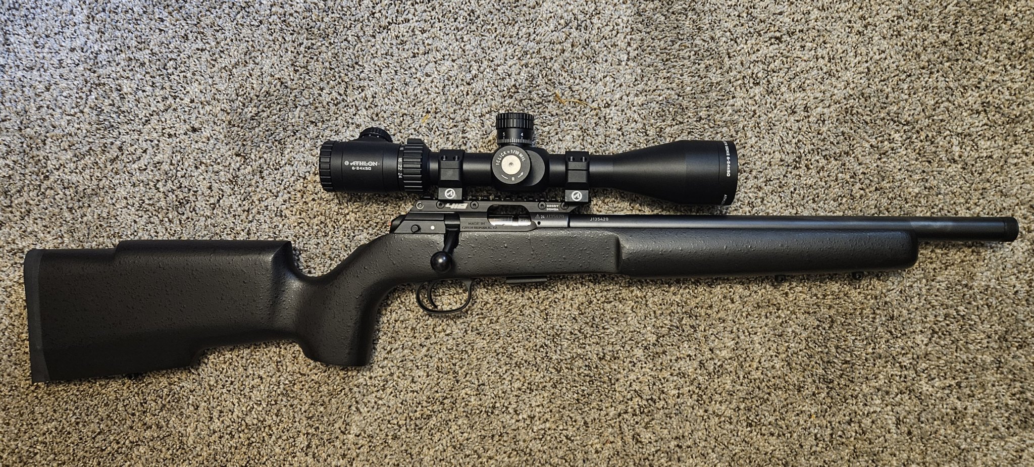

Here is a CZ 457 Jaguar I set up with iron sights, my best group at 50 yards is .308. I did shoot a 198/200 with 8X. S-K Rifle Match
That's what I'm shooting as well. What are you using for a trigger? I adjusted mine but it still too heavy and I want a sub 1 lb option.

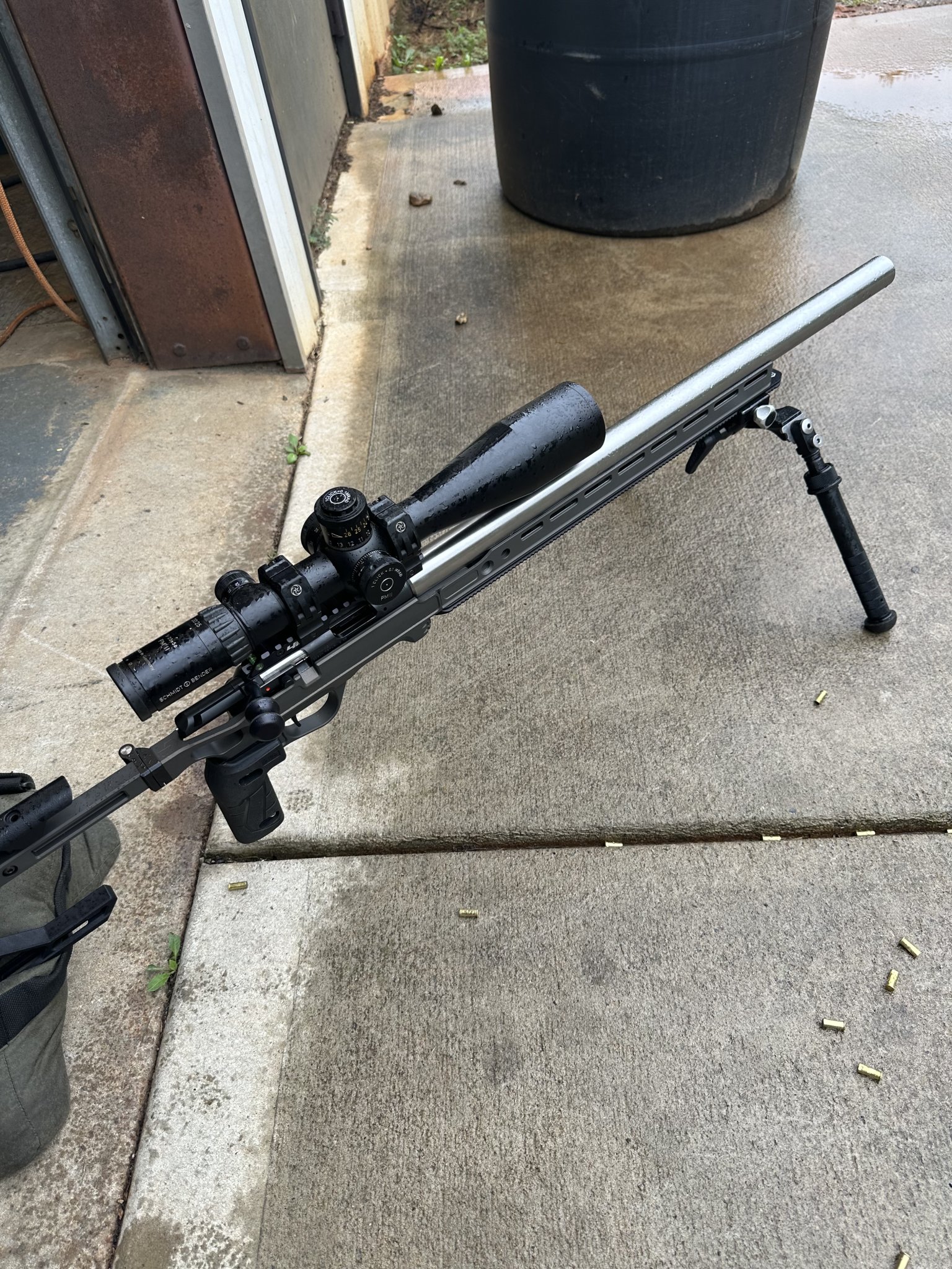

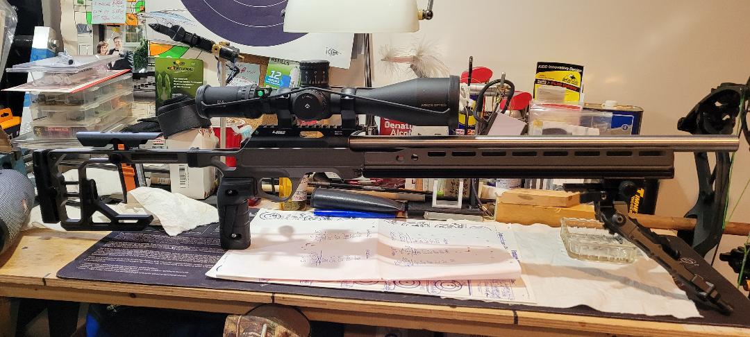

Veeeery nice!! If I may ask, what chassis is that and is it ambi or available as left-handed?
I would put in the work to find a lefty 457 if I could put it in a decent stock/chassis.
It’s a Grey Birch La Chassis with the 16” rail. For a heavy barreled CZ I would recommend against it. The chassis had to be modified to clear the 1.25” barrel which in turn made the front way too flexible. You’ll have to reinforce the front end which mine is currently under the knife for before it heads out the door. That said I don’t think they have a LH model. I could be wrong.

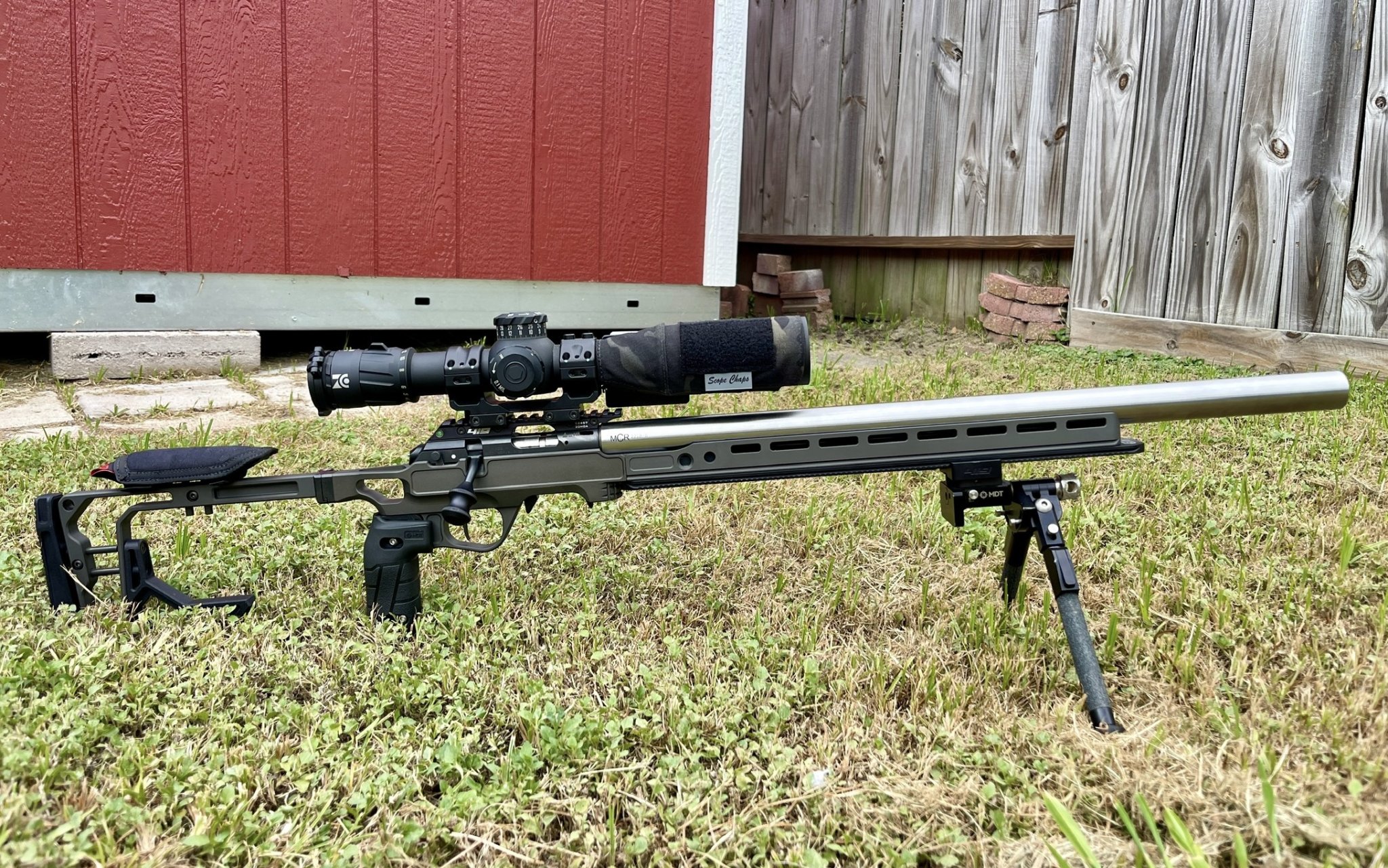

First time poster.
Testing out my new LRP in the backyard.
Scope Vortex Viper 6.5 x 20 x 50 on Burris sig Zee rings. UTG 360 Bipod. The rest is bone stock straight outta the box.
Tested a few different ammos but the Eley Tenex won it for me @ 50 meters
Only put a small handfull of rounds through her and need to make a few adjustments to trigger, but for now its doing what its supposed to.
Grey Birch makes it in a LH version. As 021411 pointed out the 16in forend is very flexible. I installed a 1/2x1x12in brass plate into the channe land sandwiched it with a generic 16in arca rail underneath. Stiffened it up nicely and balances extremely well with a 21in Lilja barrel. With the lack of choices for a LH457 chassis it's a viable option with a little work to the forend. Other than that it's a very solid well machined chassis.
Speaking of.. Modacam made a small steel piece bolted on the inside that bridges the forend with the action part of the chassis. I also have a 17” universal rail from Area 419 installed. He said it stiffed it up by a lot.
She is definitely thick. The barreled action made it in yesterday. I had Jonathan send the chassis separately because of my distrust of having too many eggs in one basket with the postal service. The chassis is arriving Tuesday.

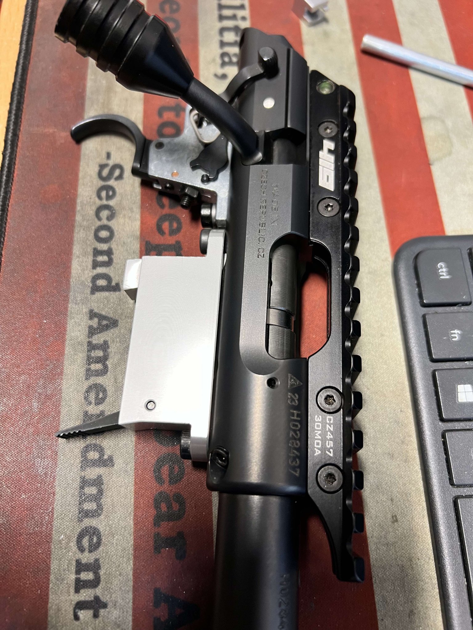

Although I already had a Timney trigger installed I wanted to try out a Jard. After tweaking the trigger with the middle weight spring installed I have it set to about 7 oz. There’s no discernible creep however there is definitely overtravel built in. If you’ve ever shot a Bix’n Andy trigger then you’ll know how it feels.
