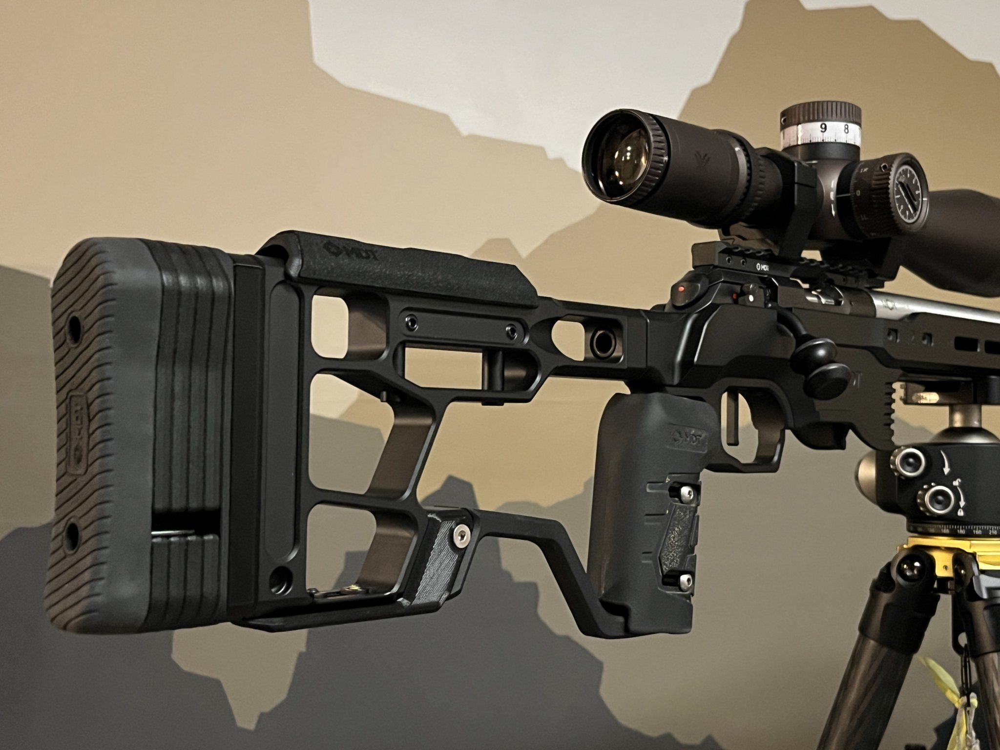

I’m on the fence between three chassis, will mostly be using the rifle for PRS22, will run a 24in l3i 1.18” barrel and would like to keep extra weights to a minimum
- MDT ACC GEN 2
- Vision Pro
- Grey Birch
Do you know if the Grey Birch or Vision Pro will need modifications to fit the barrel? Most CZ chassis weren't designed to accommodate that large a diameter, specifically at the front action screw area. The MDT specifically updated the inlet design of the ACC Gen 2 for larger 1.180-1.250 barrels.
Mine is running a .900 Lilja so no issues there. Somebody here, I forget who, just did a 1.250 modacam build on the Grey Birch...the forend channel accomodates the barrel but he said slight clearance work was necessary to the receiver just forward of the action.
That's the part I was concerned about. That little area right in front of the front action screw is the potential issue on almost any chassis. Aside from the ACC gen 2, I didn't know of any chassis that accounted for 1.180+ barrels. I think most will need that slight modification. I know this was discussed quite a bit in one of the threads here.

Since you specifically said you need a chassis for PRS, I 100% recommend the Prem Gen Ii due to how much better it’s going to balance for barricades.
I recently changed over from an MPA and it balances so much better due to the foreend.

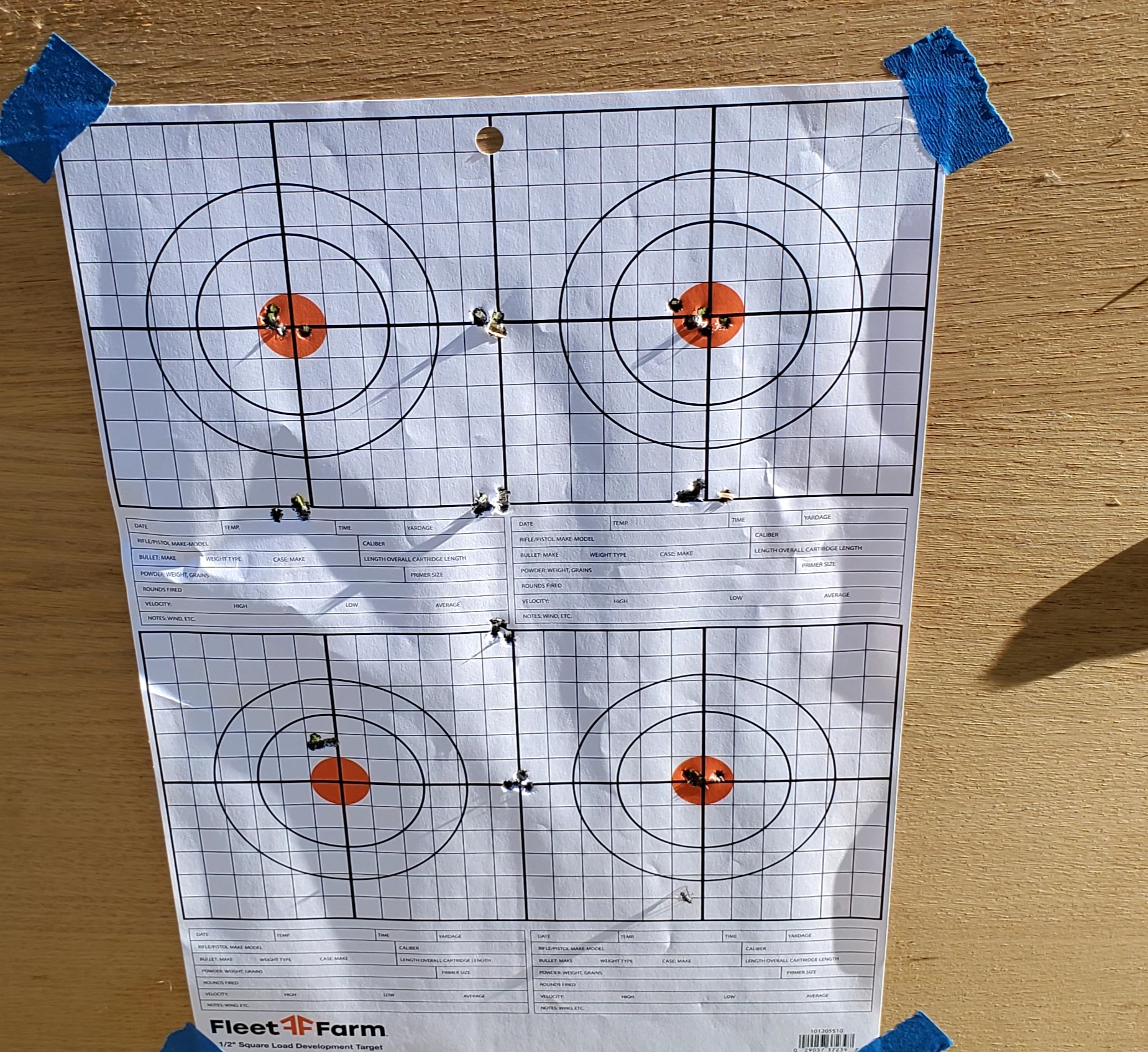

I don't shoot my 457 often enough. Whenever I pull it out to do a quick plink in the yard I'm impressed. Fired a box of SK STANDARD+ in the back yard real quick today at 50 yards.
The bullseyes measure 1 inch.

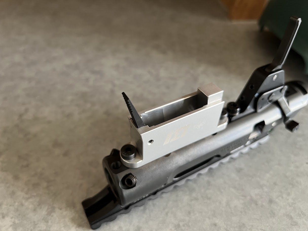

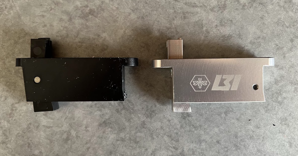

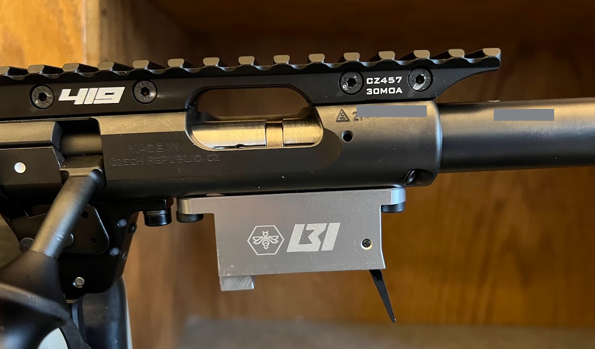

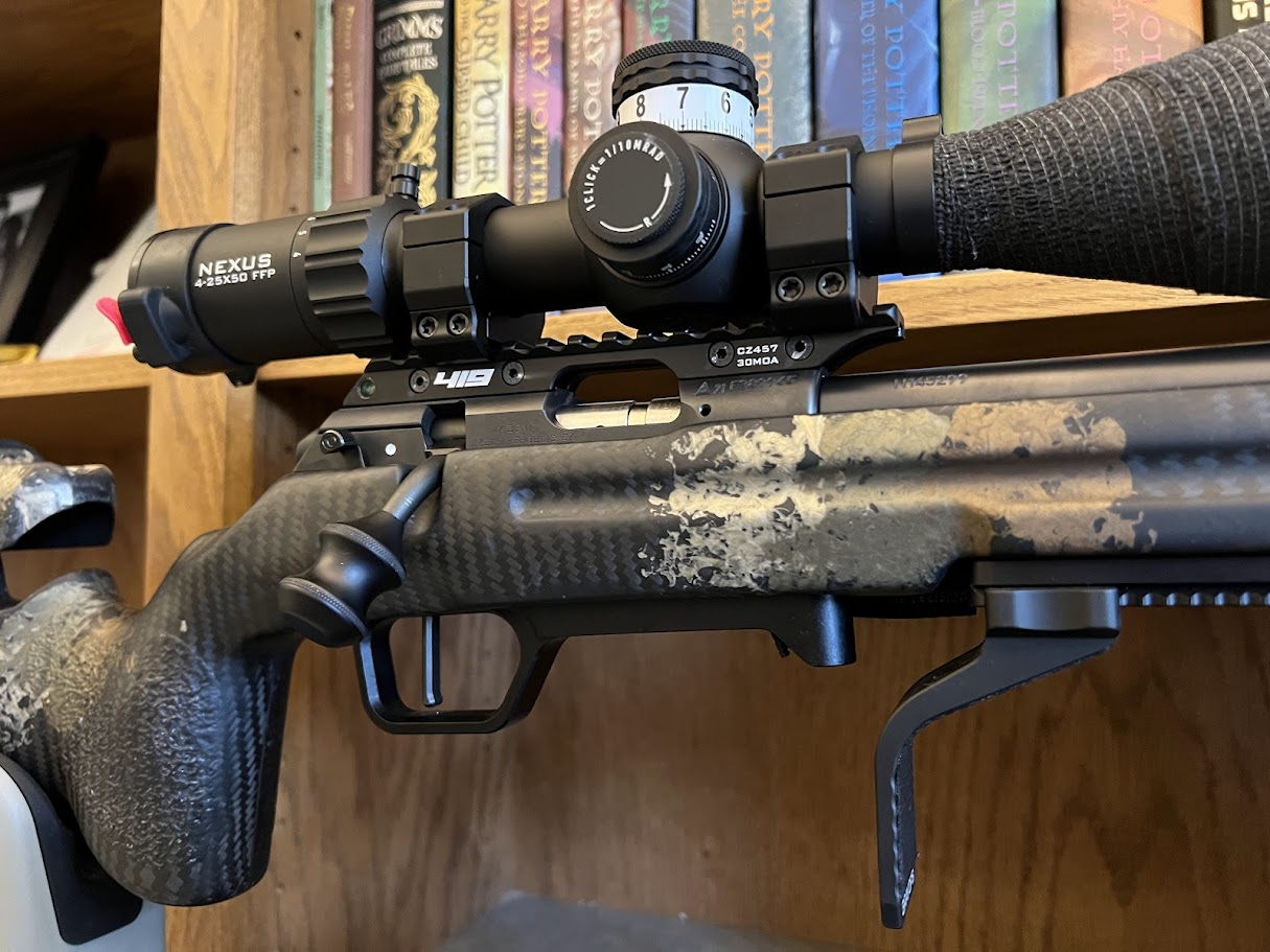

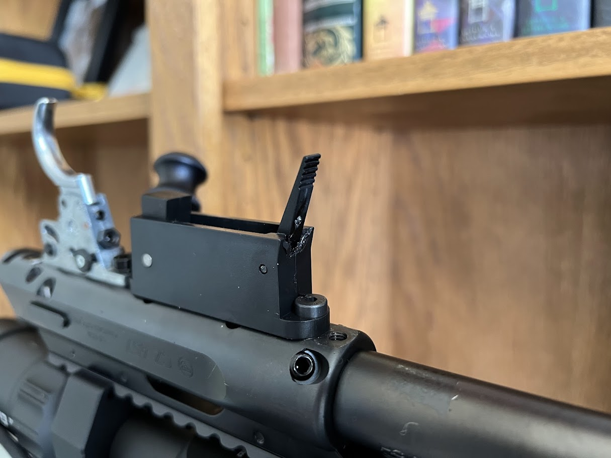

Got the L3i bottom metal in and installed yesterday. Definitely a nice piece.
Turned out the original magwell from the VMTR was starting to break apart so perfect timing. Seemed like a really odd place for it to start breaking, but glad I caught it before it got too bad.
Install went smooth and I'm very happy with the quality. Also glad I won't have to worry about it breaking in the future.
Got everything back into the stock and feels solid.
My magwell has failed twice in that specific location as well

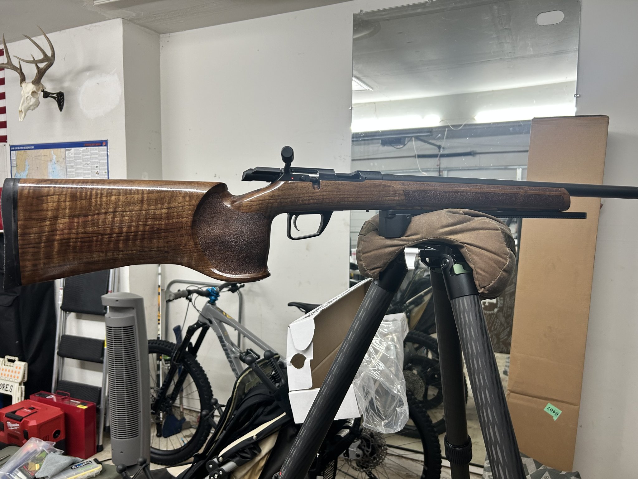

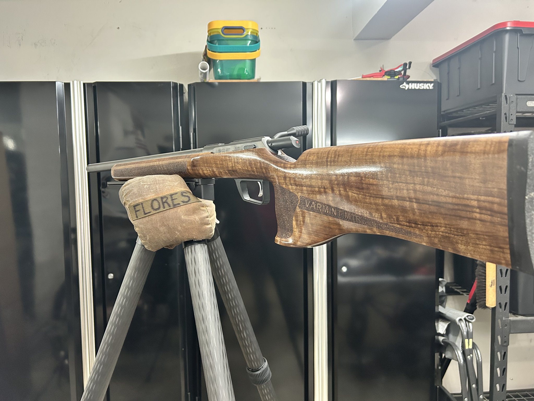

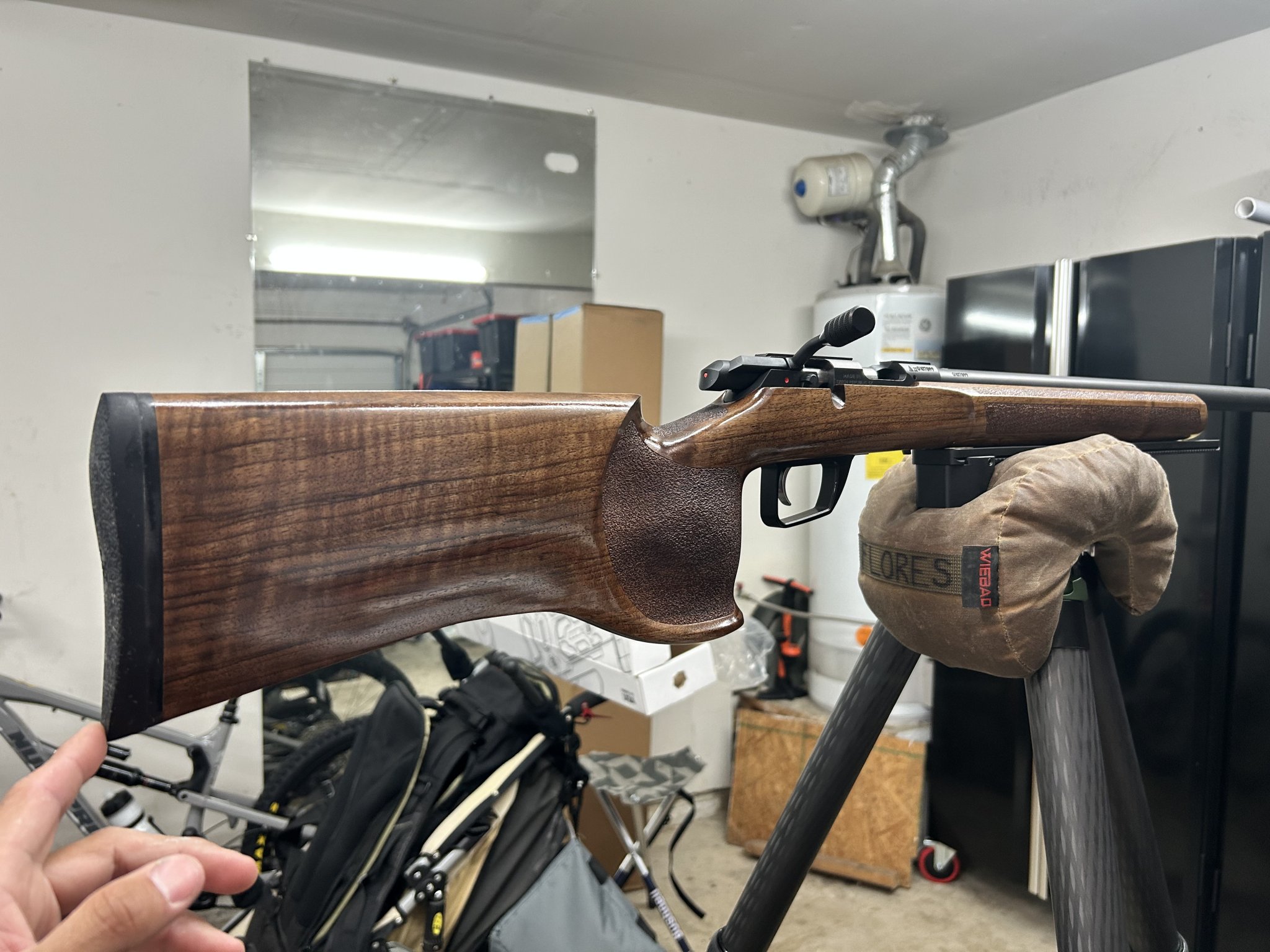

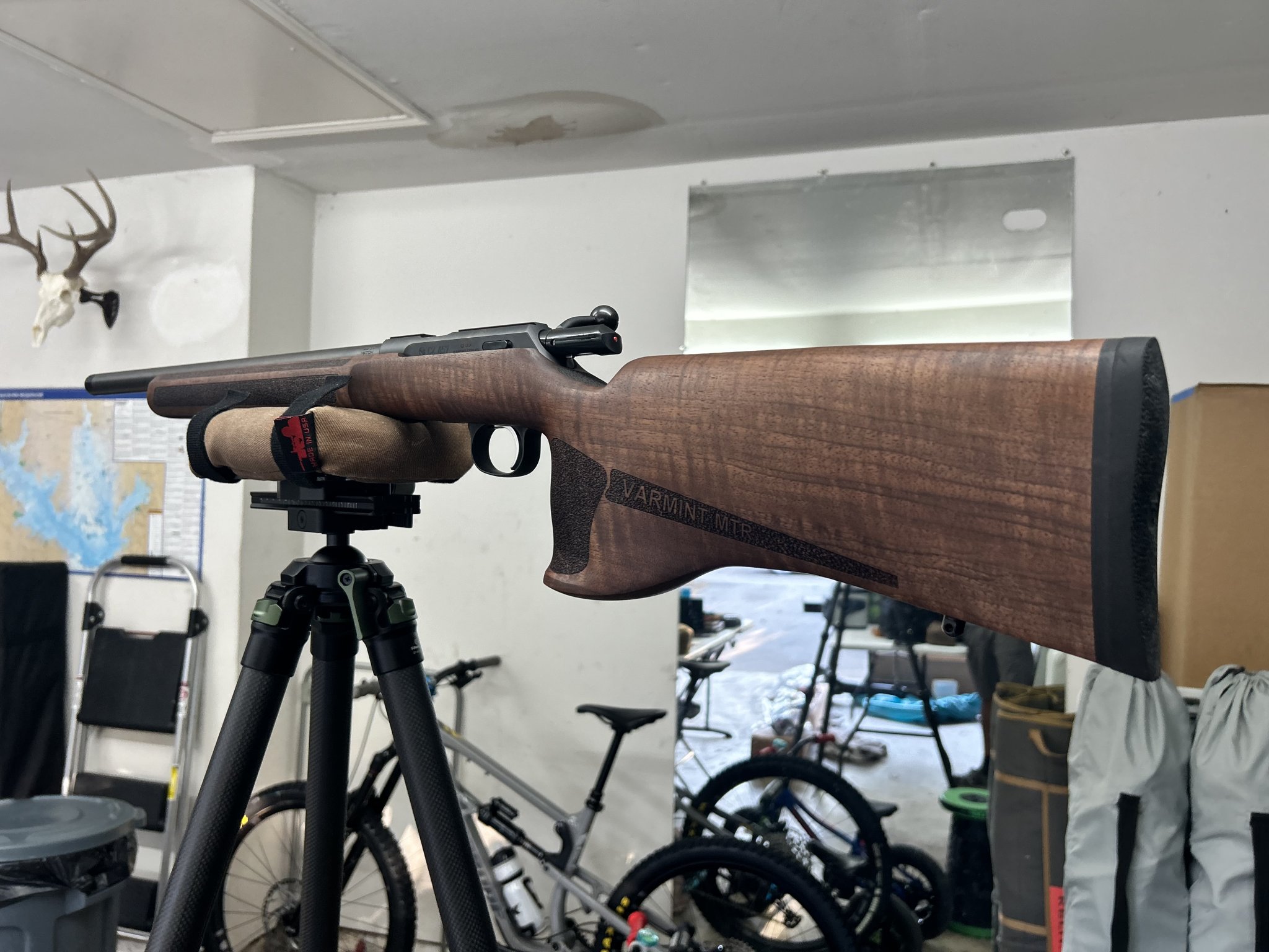

Looks great!! I am also just starting a refinish job on my MTR. Have not decided on clearcoat. What did you use?
Before and after pic of my MTR!
I stripped all the finish off with citri strip.
Wet sanded it with 600 and used the wet slurry to fill the pores in the stock.
I used tru oil and rubbed it in with my fingers. Let it dry over night, hit it with 0000 steel wool and rubbed another coat on it.
I needed up going with 5 coats. Sanding with steel wool in between every coat.

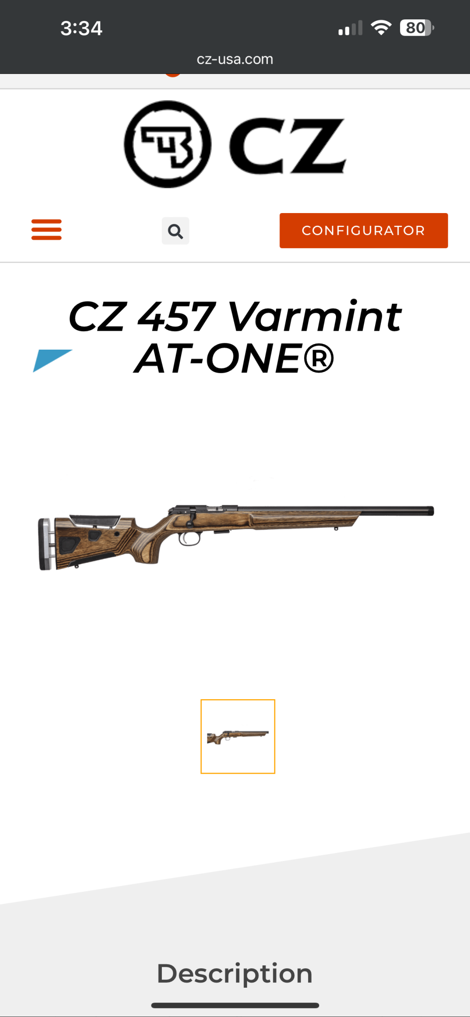

I’m looking at the 457 varmint in the boyds stock barrel options are 16.5 and 24 inches I will be shooting suppressed what’s everyone’s thoughts on what barrel length to go with? I like having long barrels with my 6 mm and magnums etc but not much experience with rimfire
Depends if you're just plinking or shooting matches. For matches, the longer barrel and no suppressor. For plinking, suppressors are fun as hell.
I target shoot at home . I have 1000 yard range and I will want to stretch the rimfire out a little and being heavier doesn’t bother me . I just didn’t know if barrel length changed velocity like it does with the center fire stuff

A heavier barrel will definitely help since you're gonna be shooting that kind of distance. You could always go for the shorter threaded barrel and get a different barrel later. It's only two grub screws to replace the barrel.
Oh easy barrel change I like that . Thanks for the input . So the longer barrels only added benefit is the weight? Like I said I have had 22s my whole life but never a nice one and I have never paid attention to the nuances of rimfire
With 22 LR barrel lenghts over 18 inches or so actually slow the bullet down, you will loose muzzle velocity. But it have shown for many manufacturers and gun smiths that it's beneficial for accuracy, hence why many precision 22's are around 20 - 22 inches.
Lots more to it, but that's what I've learned reading and listening to the 'big names' in the rimfire world.
Yeah, I wish they had an option in the middle somewhere

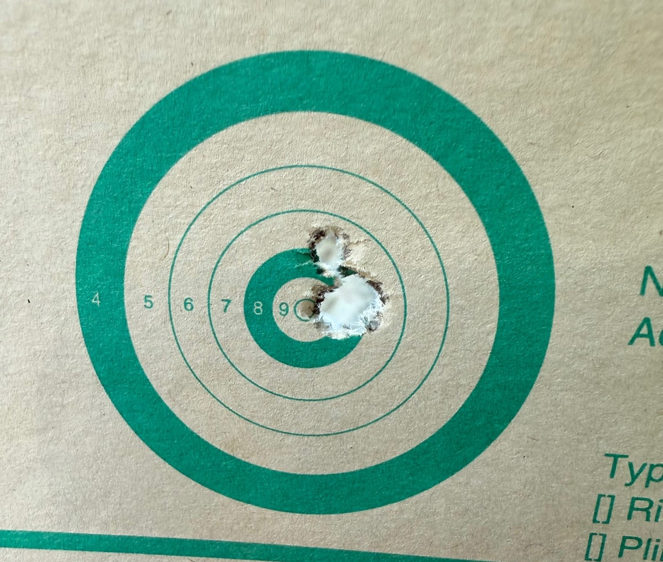

Pulled my 457 out of the safe after several years of squatting. Getting it ready for my range to start Extreme Long Range Rimfire-300 to 500 yards. Made a few mods to it. MDT 50 moa base, MDT bipod, Anarchy Dragon Scale bolt knob, JARD trigger set at 3.5 ozs, and DiscoverOPT 5-25 MRAD FFP scope. Tested at 50 yards with SK Rifle Match. 5 shot group. We shall see if this old dog will hunt soon.
