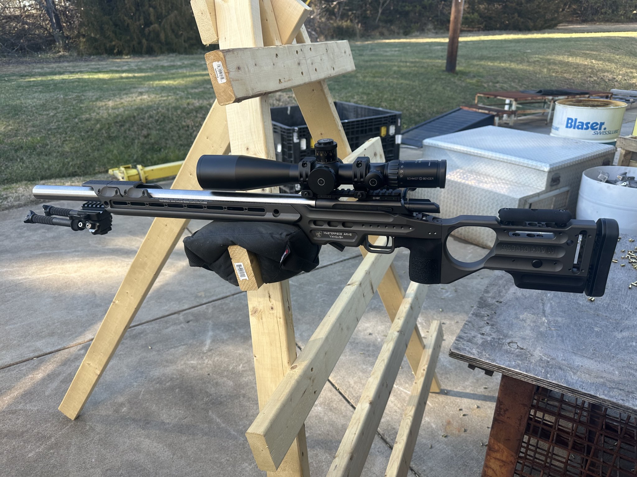

Been guilty of not shooting the CZ enough since I had it completed late July early August of this year. I needed to zero some rifles this Christmas morning so I took her out. I still plan on getting the ACC Gen 2 for it.
I had one box of Polar Biathlon left over from my Vudoo and surprisingly the CZ shot well with it. Attached are two back to back groups with the Lapua before I moved onto another rifle to square away.

Interesting to see you are running an arca rail on the La Chassis. Are you doing that to try to stiffen the forearm up? If so, how is that working? On my wife's build that is my only knock on the La Chassis would be the flex in the forearm. I kind wish they would look at making something like a competition forearm that would have more wall thickness to stiff it up and even a bit wider to give you better stability. However, I do understand to build a chassis that light you have to give something somewhere. I like Grey Birch's modular design because it allows them to create use specific forearms and butt stocks in the future.
The GB La Chassis was never intended for a truck axle barrel. The forend is super flexy so the add-on arca rail helps a little but the flex is definitely still there. Honestly it’s place holder right now until I can get off my ass and order the Gen 2 ACC.

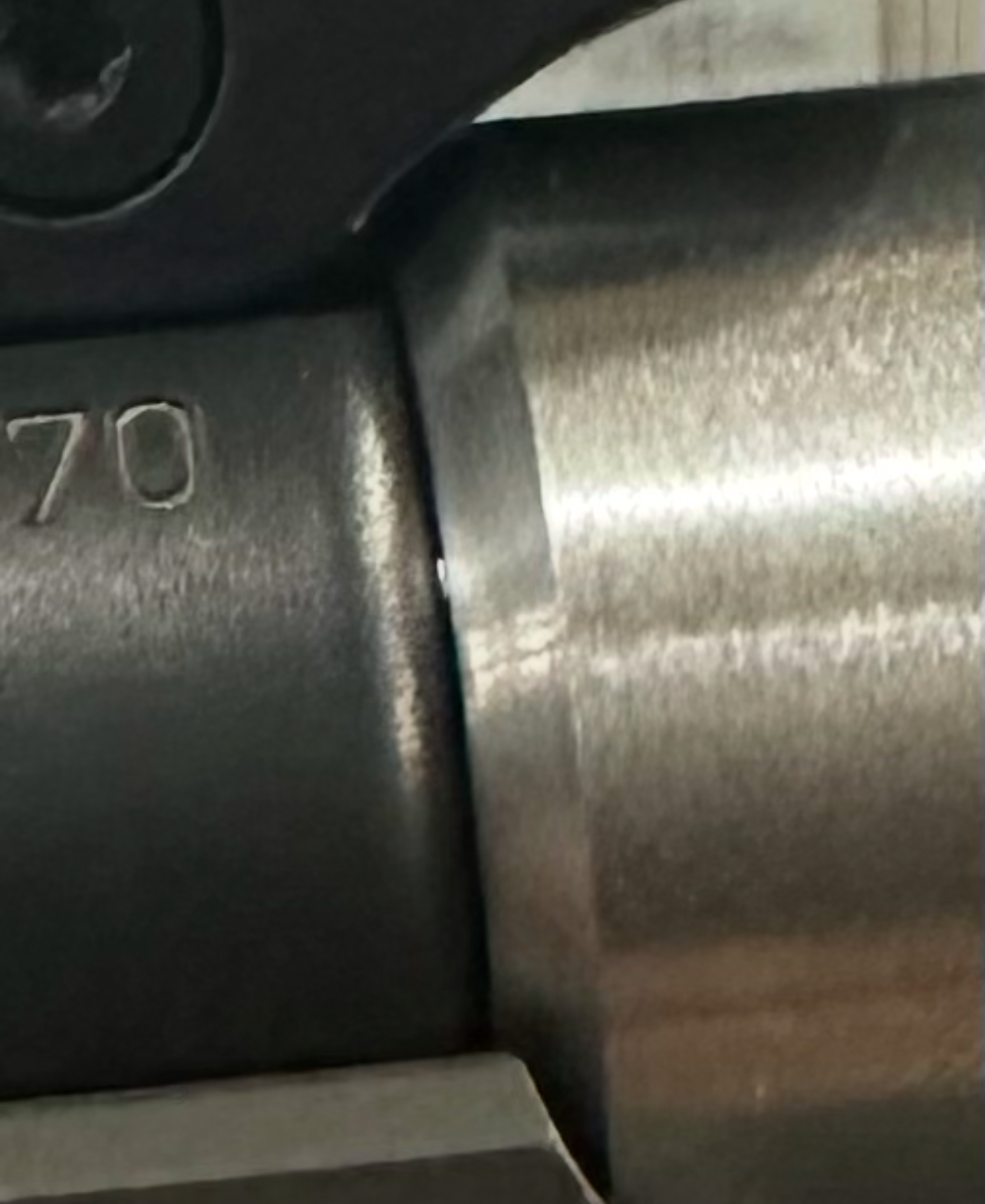

Got the DPG extractors in this afternoon. They were a bitch and a half to install because of the thickness. Get ready for some cussing. You have to work to get the factory spring over the edge of the extractor.
I was having intermittent failure to extract. Not enough to piss me off but it happened on occasion. The points of the new claws are sharp and bolt close is a little firm but hopefully it’ll wear in a bit.
For giggles the factory claw thickness is about 0.074” and the new ones are roughly 0.077”.
I cycled a few rounds and had no issues. The brass has little marks from the claws. Live fire will happen tomorrow.
PS- yes I need lotion.

Cool! Are the extractors hitting the relief grooves in the barrel and being forced outward on bolt close? DPG might have different dimension grooves than on your barrel (looks like MCR?).
The two CZ's I've had extraction issues with have had aftermarket barrels. Swapping extractors fixed one of them. The other (Lilja) is beyond help to get it 100% it would seem.
I do have a good friend who is competent that has a factory CZ that cannot extract/eject reliably.
The vast majority of CZ's are fine out of the box, but no product is ever 100%. There is a need for replacements since CZ supply chain cannot seem to keep up.

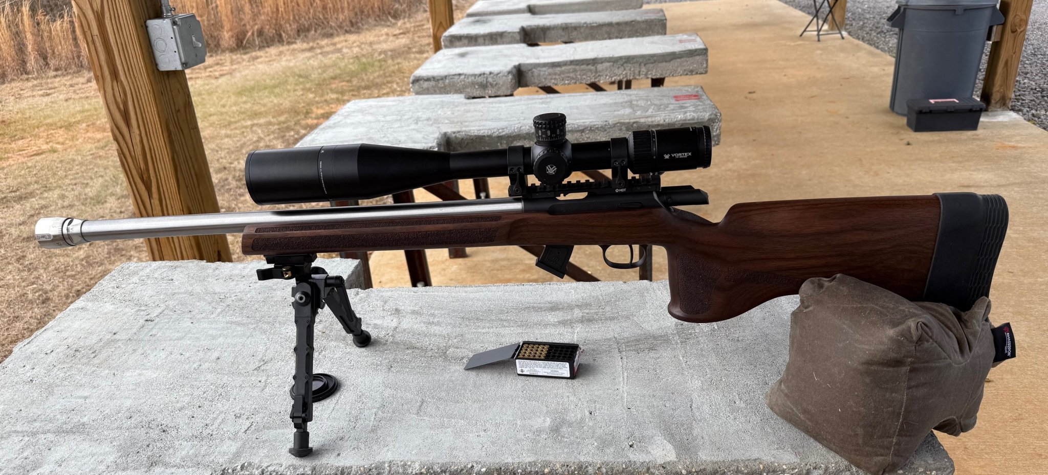

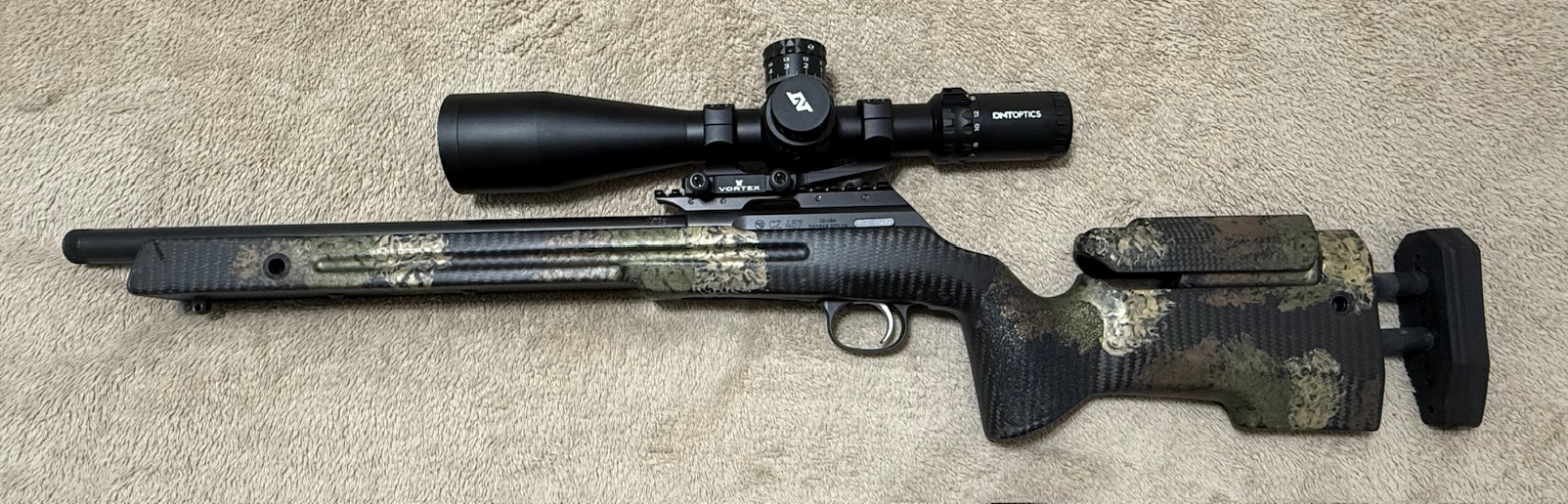

Just received my CZ 457 with 20" MTR barrel. I am going to install a Area 419 Arca rail and 30 MOA scope rail.
topped with a Athlon Helos BTR gen2 6-24x56. It has a beautiful walnut stock but I'm thinking getting a WOOX Furiosa stock.
Can't wait to try it out.

I have a Tikka T1X in a woox Furiosa and a cz 457 varmint mtr. Both get shot in PRS rimfire, cz is base class and the Tikka is open. If you plan on shooting PRS or NRL22 with it make sure you get the Furiosa ultra forend as the regular Furiosa forend gets pretty tall when you have an arca rail stuck under it which makes it harder to thread into and out of barricades. Also the longer length from the ultra forend will help with balance, I do like the regular Furiosa grip a lot but haven't held the ultra grip.
Fwiw I'm going to take my Tikka in a different direction and make it light by swapping a grey birch la chassis with a 16" handguard and I'm considering a carbon barrel and going with a lighter scope also.
I did extend my CZ forend because the foundation universal arca rail was much longer than the stock and I had issues snagging it on barricades a couple times so this will hopefully make it a little less likely to get hung up on goofy barricades. (It's mounted to the rail only so technically it isn't a stock modification, just a rail mounted weight)
I did extend my CZ forend because the foundation universal arca rail was much longer than the stock and I had issues snagging it on barricades a couple times so this will hopefully make it a little less likely to get hung up on goofy barricades. (It's mounted to the rail only so technically it isn't a stock modification, just a rail mounted weight)View attachment 8592551

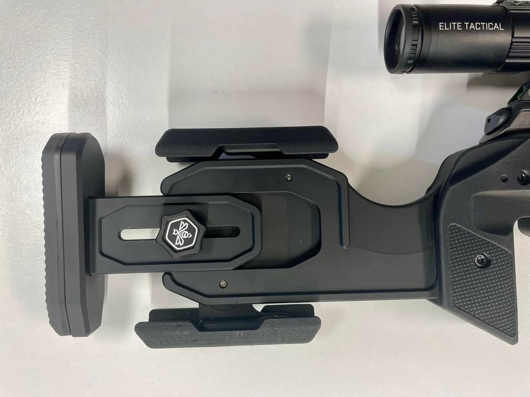

Mine's in a Grey Birch LH chassis, balances well without a ton of weight added up front. MPA makes a great chassis, just wondering why they did it in the Vanquish and not something with a lighter buttstock...not everybody wants to run a 24x1.25 barrel just to help weight balance their rig
I’m sure a few of us caught wind of it a while ago but had to stay tight lipped myself included. Well it’s official now.
Kinda expensive compared to other chassis options, even from MPA. It's even way more expensive than Manners stock. Wonder why that is?
Manners won’t accommodate barrels larger than an inch unless the channel it’s enlarged. They will not do it for you at the shop. I won’t comment on the pricing as I don’t run a business.

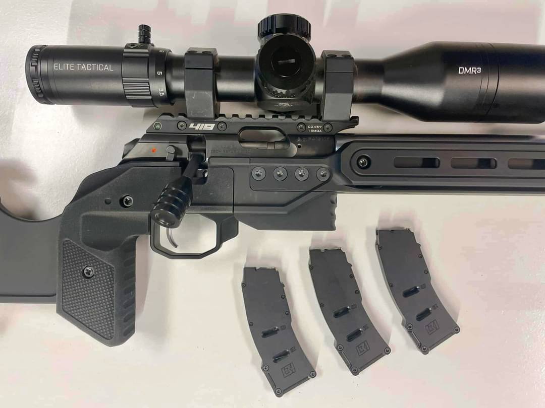

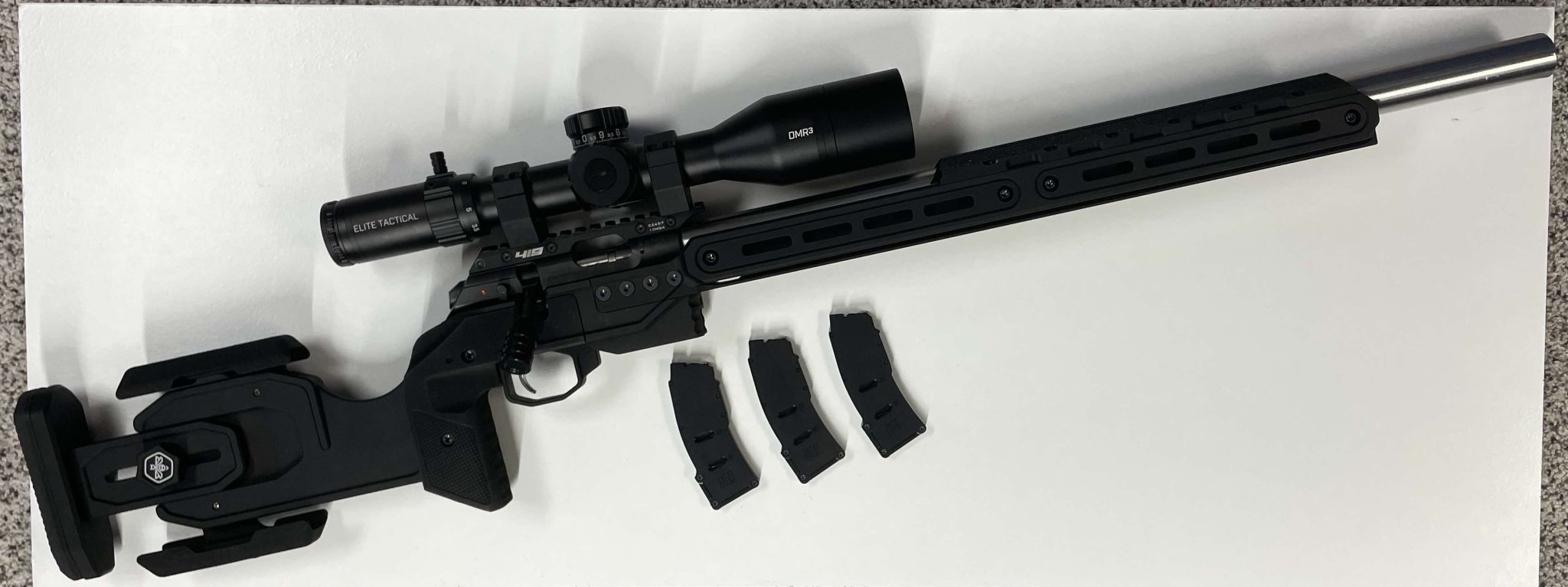

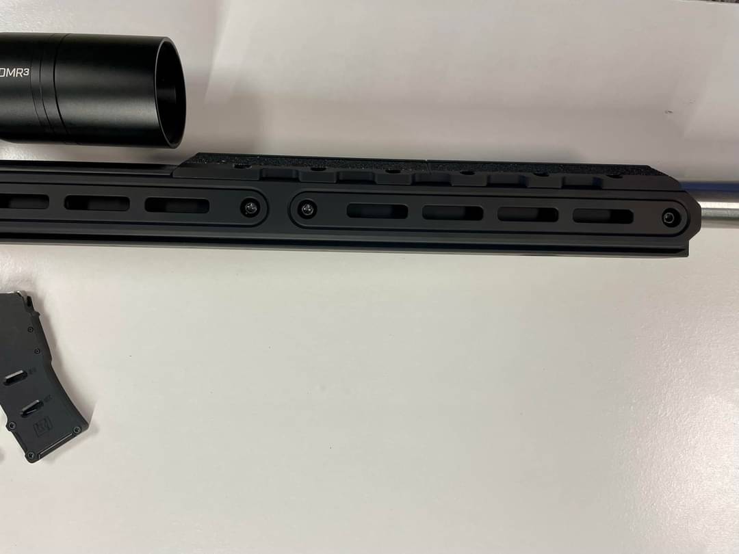

Spoke too soon in my earlier post, questioned the Vanquish as the right chassis for a rimfire gun. Apparently MPA added 6oz to the forend while removing 1lb from the buttstock compared to the center fire version. That and the new mag release are big upgrades. The barrel channel is stated to be 1.350in inlet, hopefully that includes inletting directly forward of the front action screw. Looks like they did their homework on this project. And in a LH inlet also...don't know that I'll jump out of my Grey Birch right away, but I'm certainly going to follow the feedback once the first one's are seen in the wild.
I think the new chassis from L3I is a scam. First, he has all this cool shit for our rifles, bottom metal, barrels that won’t fit our channels, etc, so we go buy all that stuff. Then after we have fully kitted out our rifles, he comes out with a chassis that has all that good stuff built in. I think it was his plan all along! Well, I for one, am not falling for it! But, I will ask for a friend, when will they be available, and what is the price? 😁
