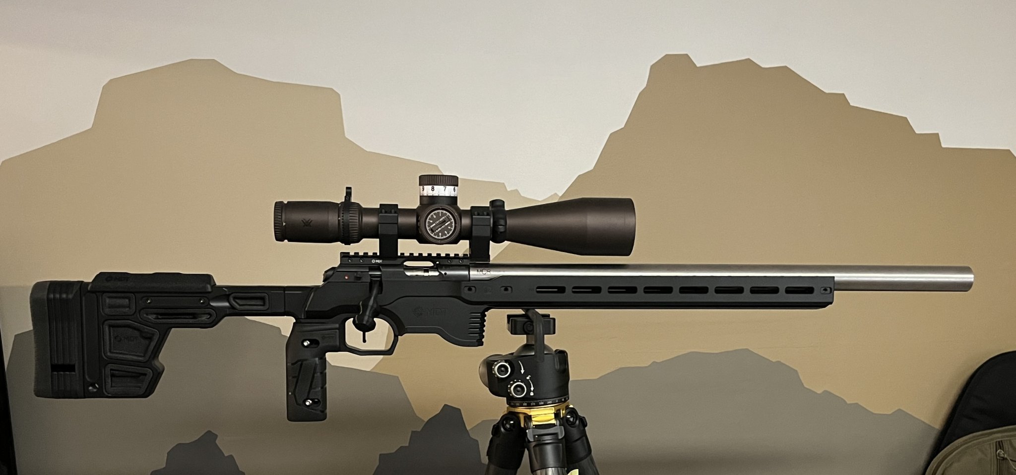

Hope to have my new 457 MDT ACC next week!

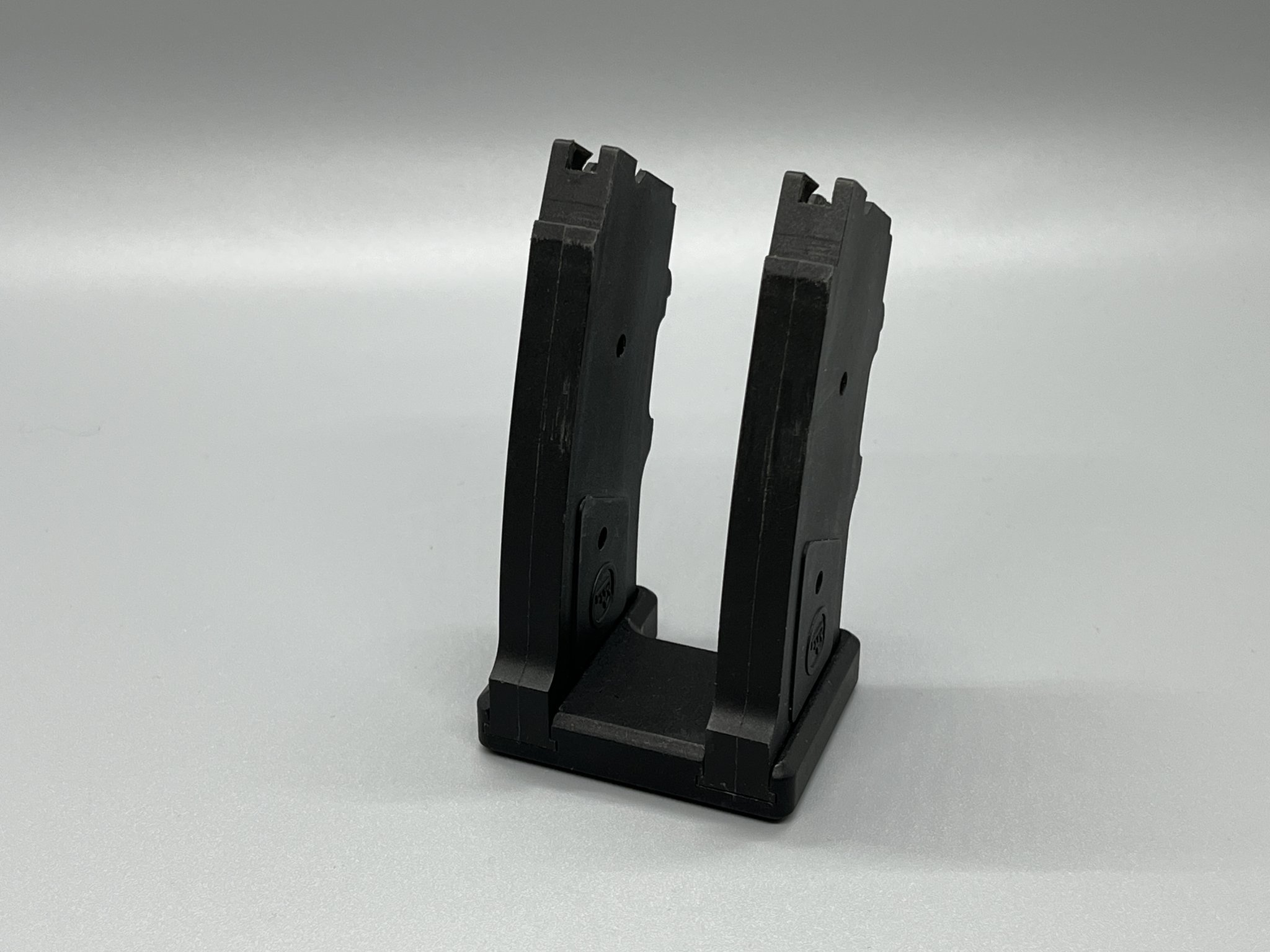

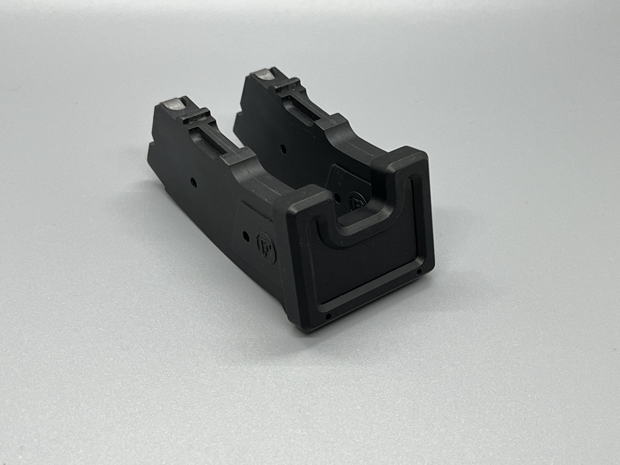

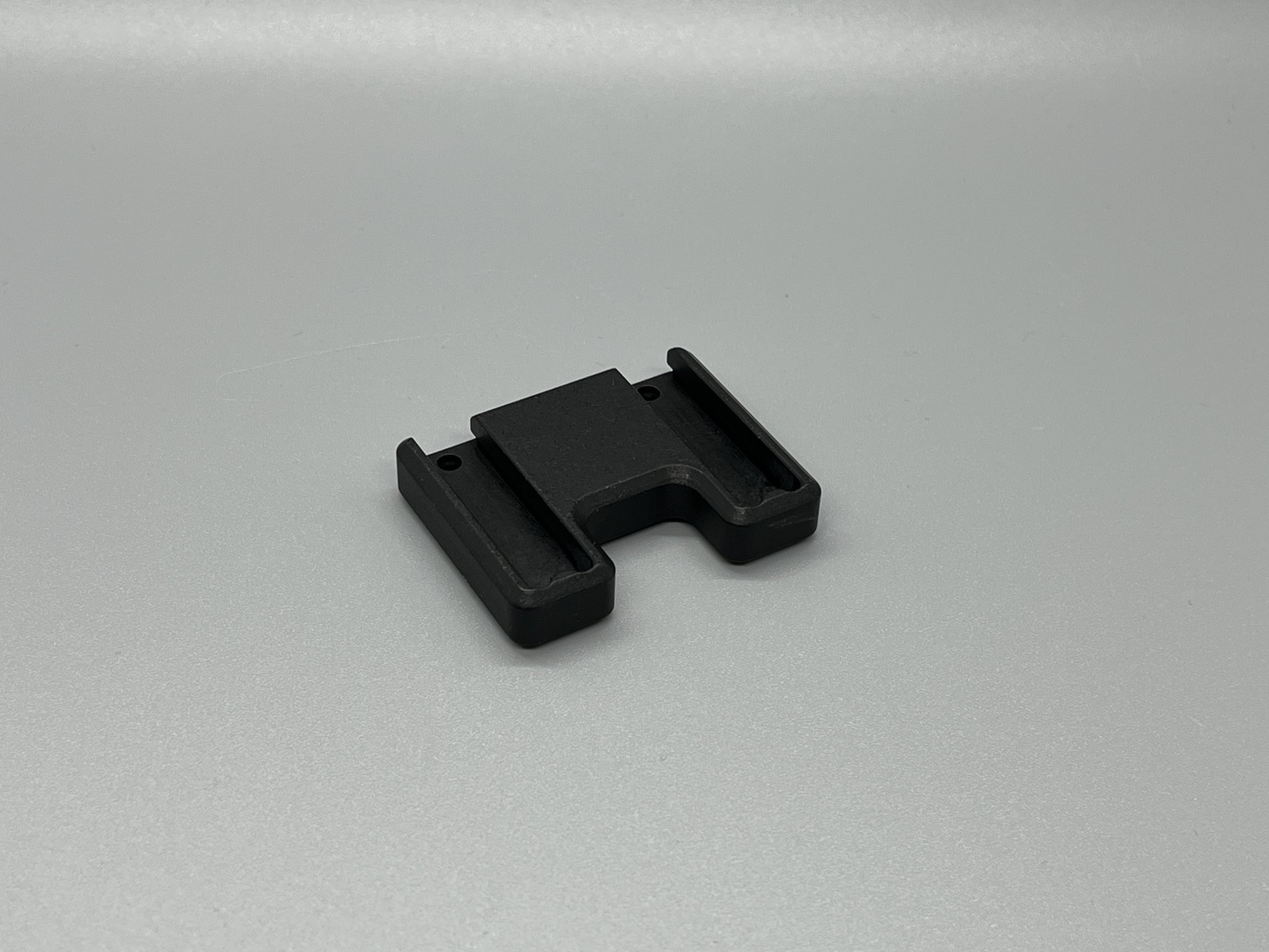

I've been using a SAP AICS mag pouch with a 3D printed insert that fits CZ mags, but now that I have couplers available, I can have a spare on the gun at the ready and do mandatory mag changes in only a few seconds.
Aluminum couplers are back from hard anodizing and ready to ship! PM me if you’re interested! $50 for the aluminum version, $15 for 3D printed, free US shipping. 100% Minnesota made.
I got to give them a good test a 2 day NRL-X and a few regular matches with no issues. I’ll have them at NRL22 Nationals as well - there might even be one going with a prize gun 🤘

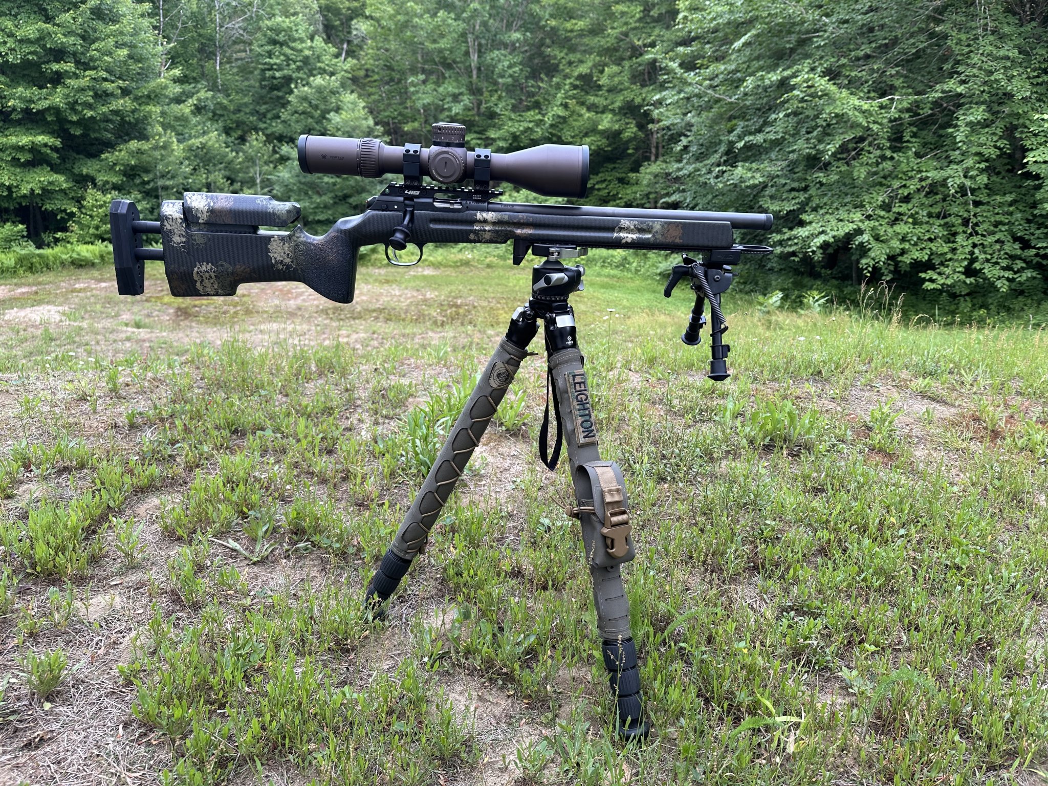

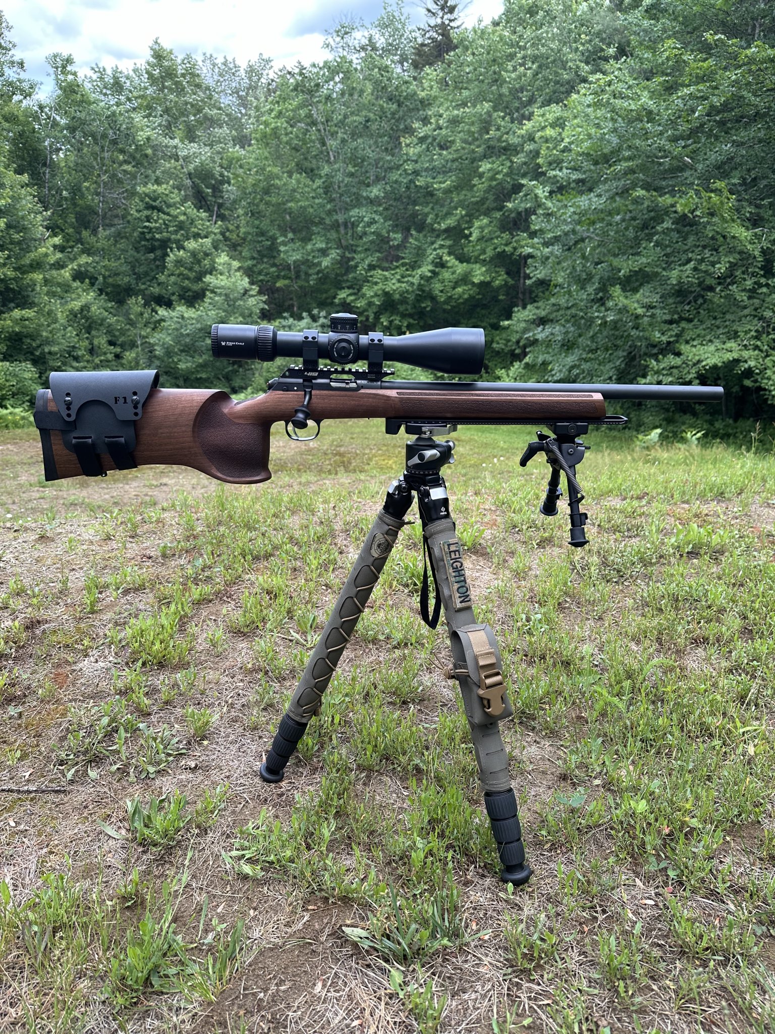

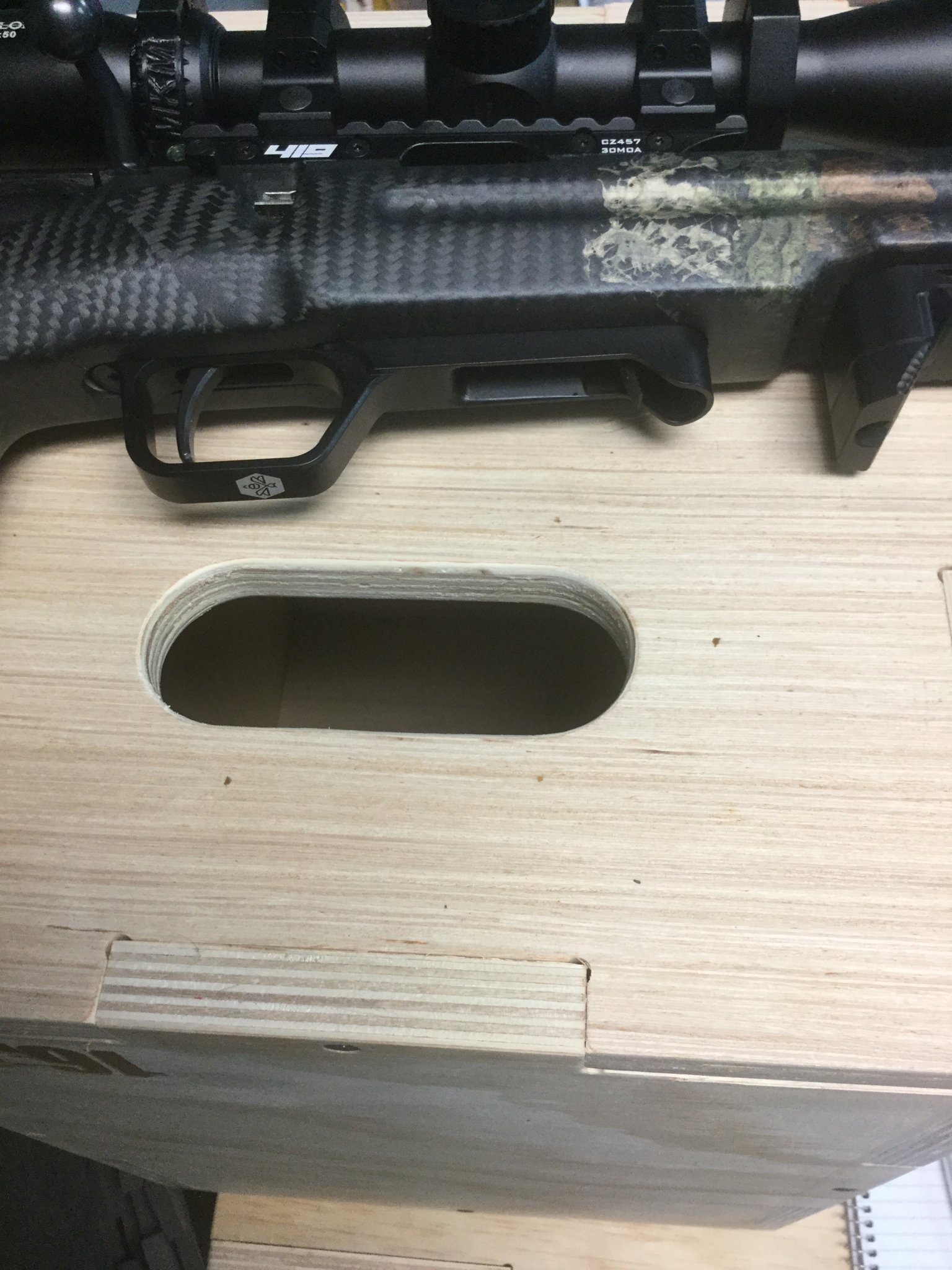

So here is the @1911Shootist assembly mounted up and installed on a vpt. Fits good with about 1/8" of clearance between the stock and mag body. Haven't had a chance to run it yet, but so far looks good. The top of the mag is below receiver height and it is level with the stock, so I don't see it interfering with ejection. Also a good view of the Area 419 barricade stop for USMC22.
^^^Looks good! If I had to do it all over, that is the route that I would take. When I bought my vpt , A419 was out of the MTRs. I should have called them and found out how much wait there was. Nice rig you got there.
Thanks! I’ve got the manners mtr with the adjustable cheek piece and length of pull waiting on the scope. Area 419 sold out of their mtr’s quick! Not sure how often they get them but they go quick.

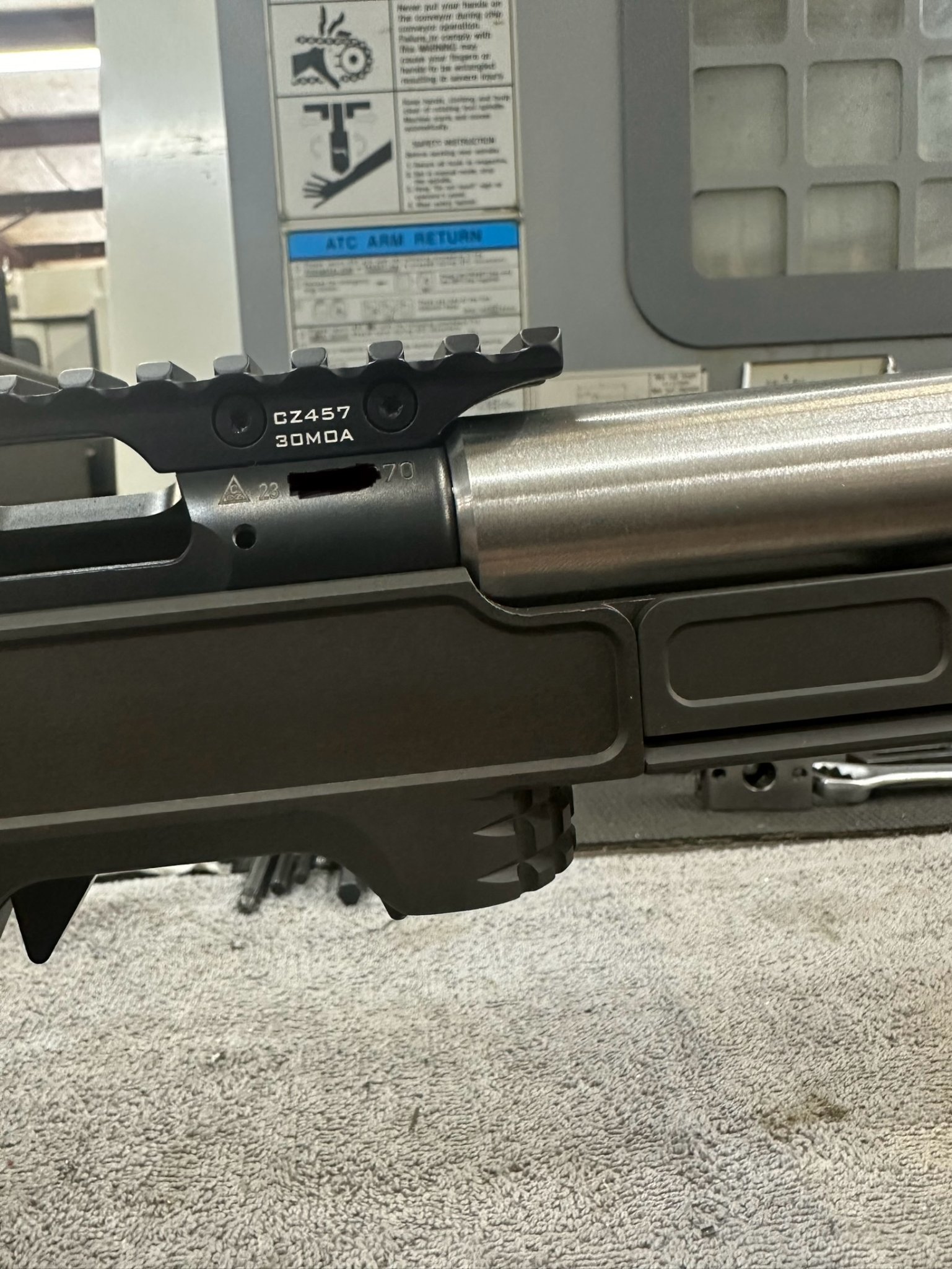

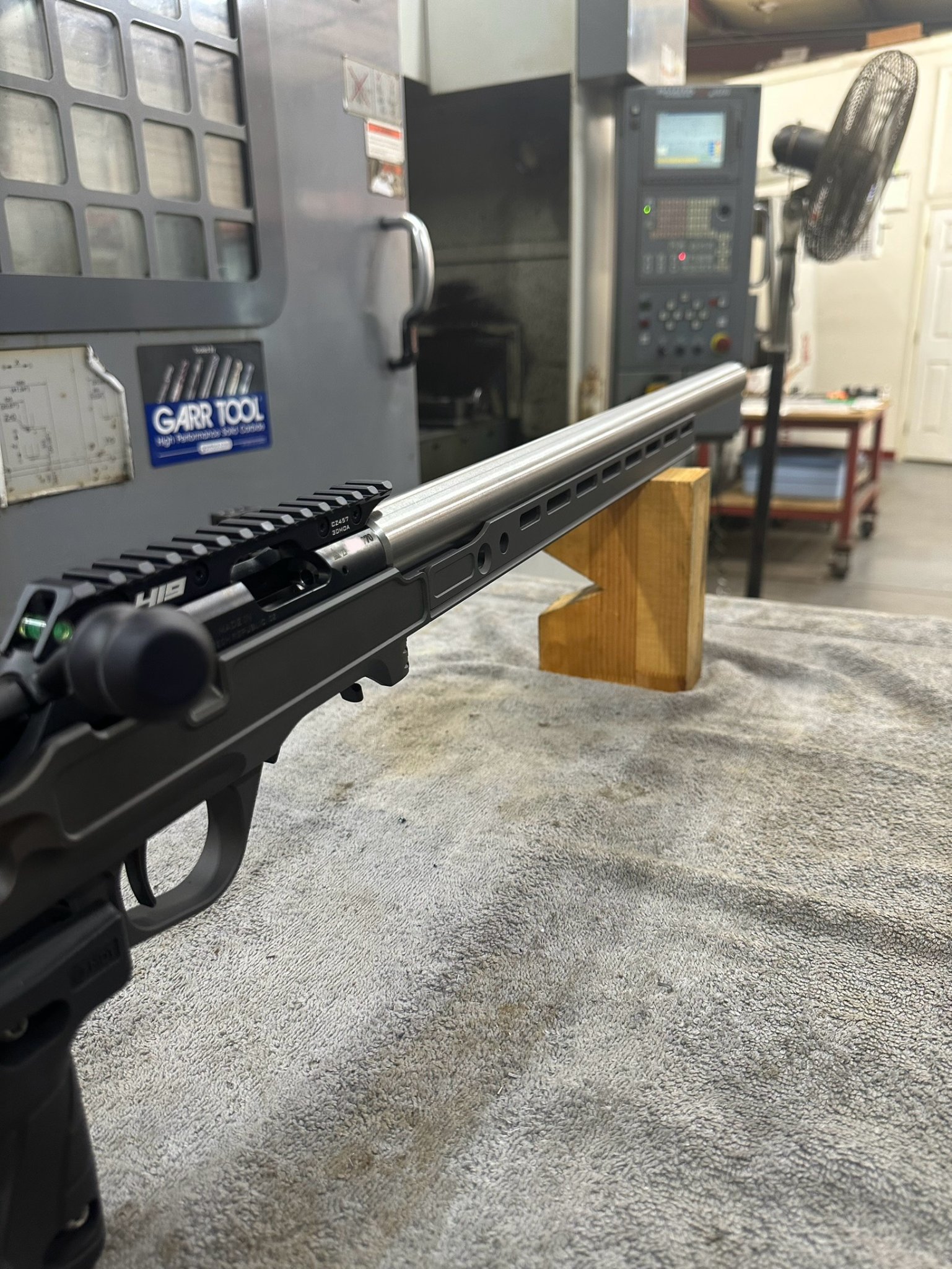

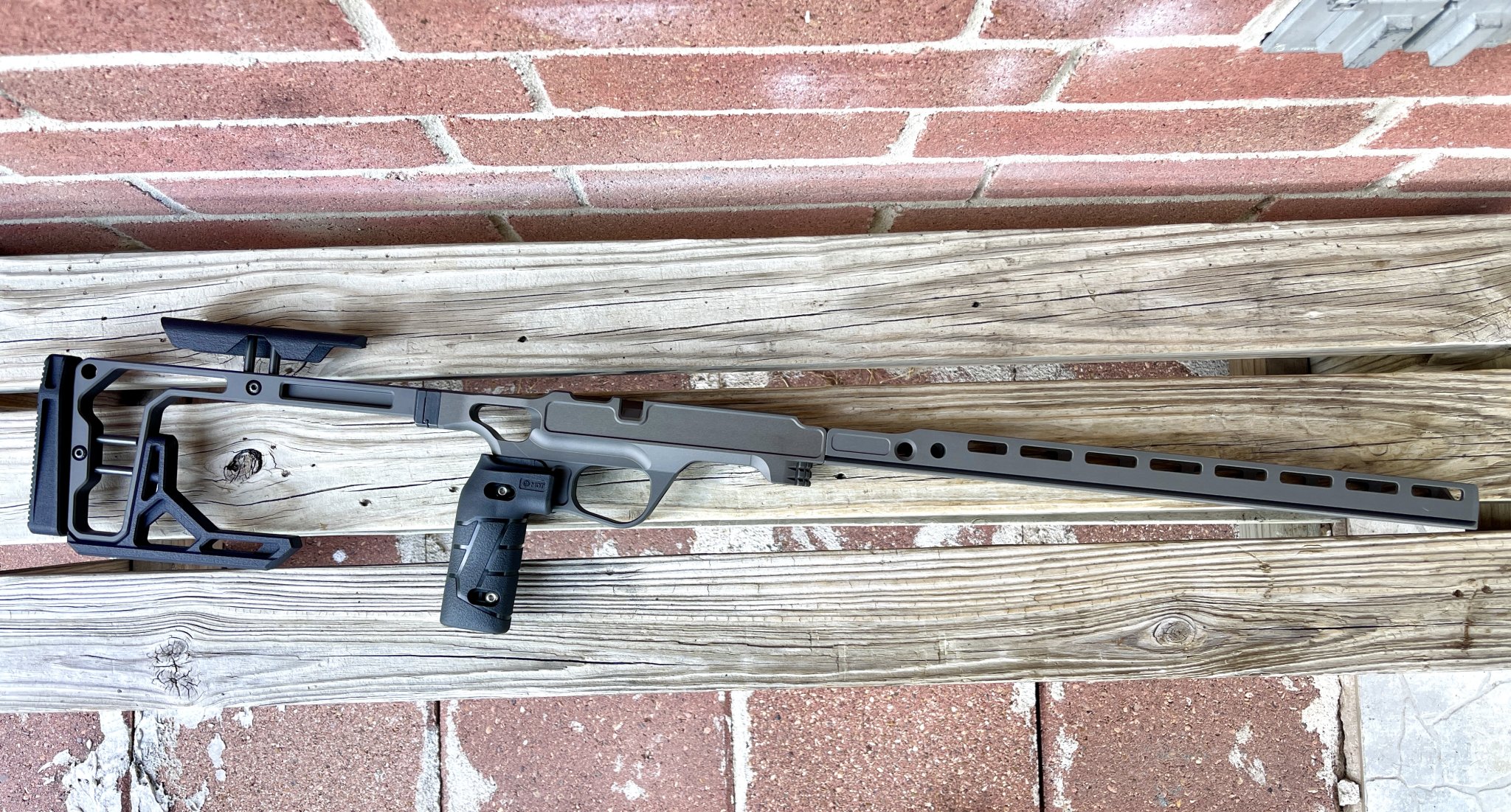

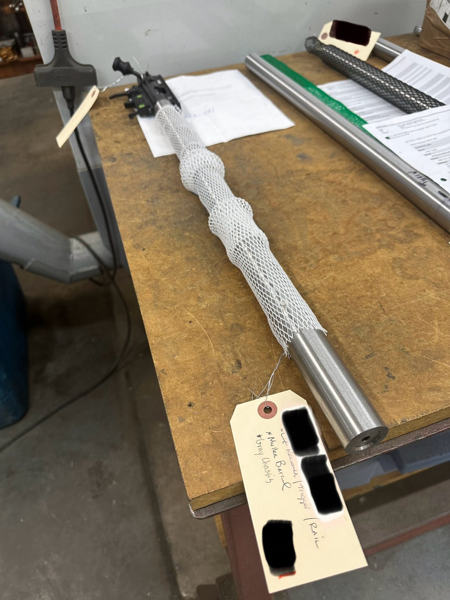

Finally got the La Chassis in after 2 weeks. I currently don’t have the action to drop in since it’s at MCR. Initial impressions just handling it seems well built. It’s not substantial like an ACC but appears to be solid enough. As pictured it’s exactly 2 lbs 14 oz on my scale. A member on RFC said the forend was flexy but manipulating it by hand so far doesn’t appear so. Again I’ll have to wait until I get the barreled action in to verify.
Grey Birch said that the chassis can fit 1.25” barrel but I’m going to send it to MCR so he can verify himself and modify if needed.

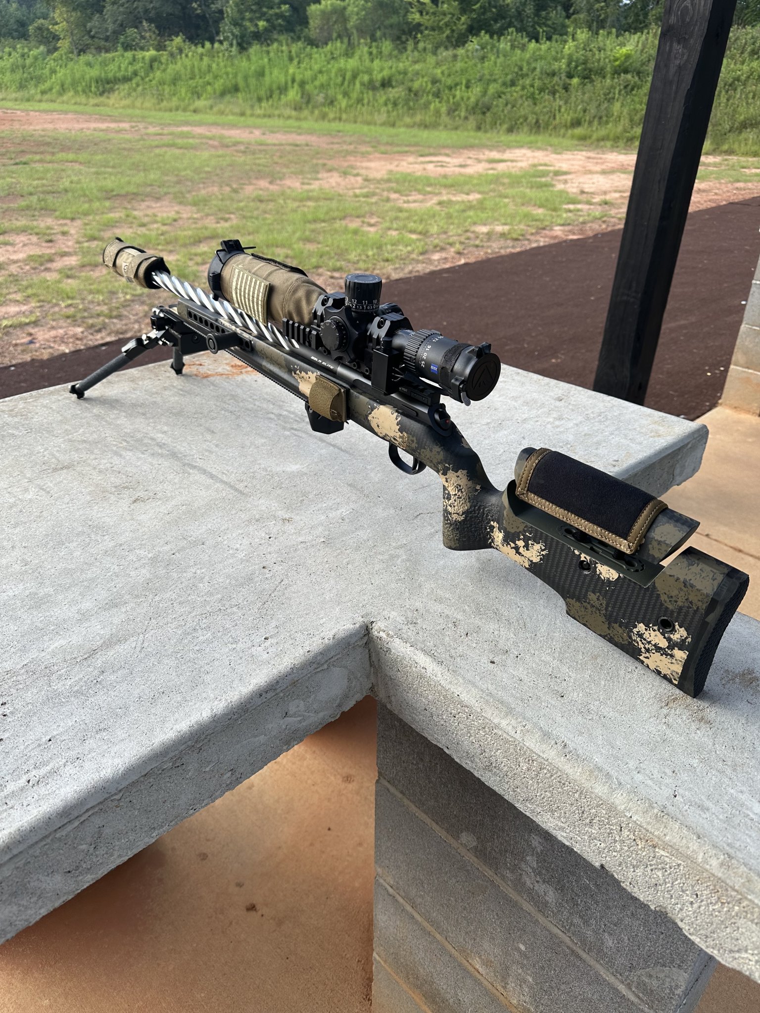

Monkeying around this morning with a newly installed ATS tuner on the CZ 457 VPT, 16" stock barrel and SK Rifle Match. Going to verify "11, 11.5, 12" and explore around "18" next time. Just picked up the Garmin also, what is considered "good" with .22 in regards to ES/SD?
full paper pic

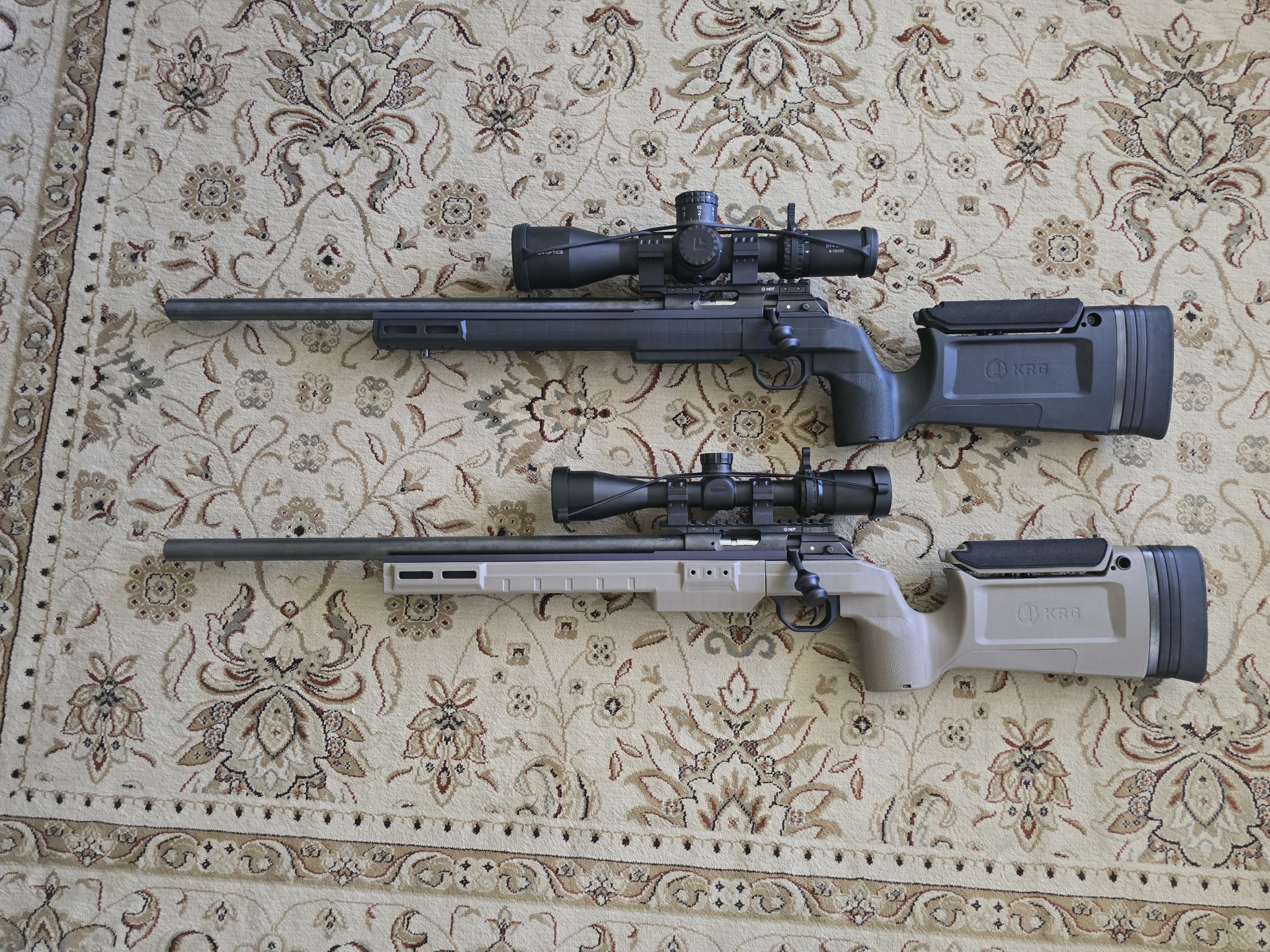

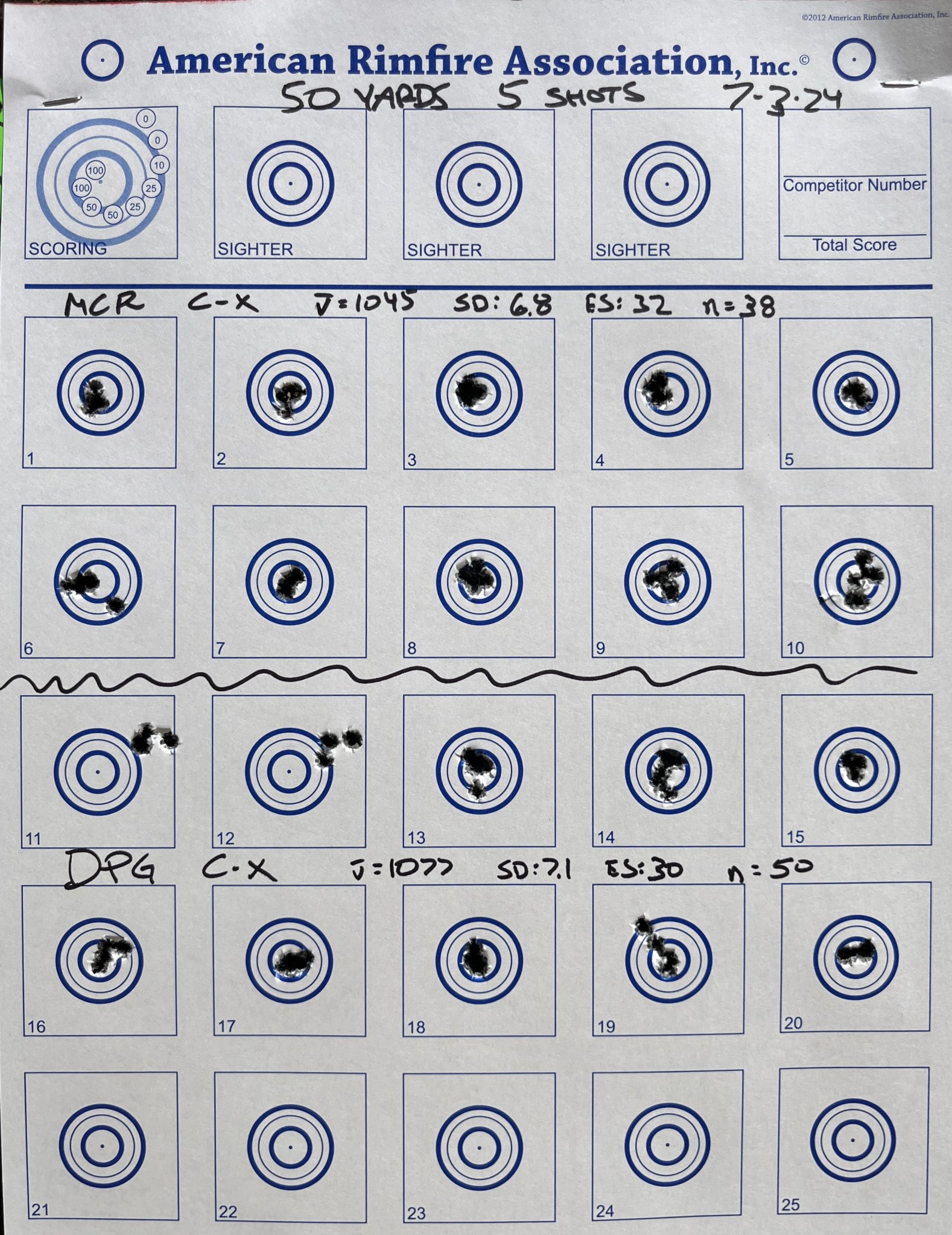

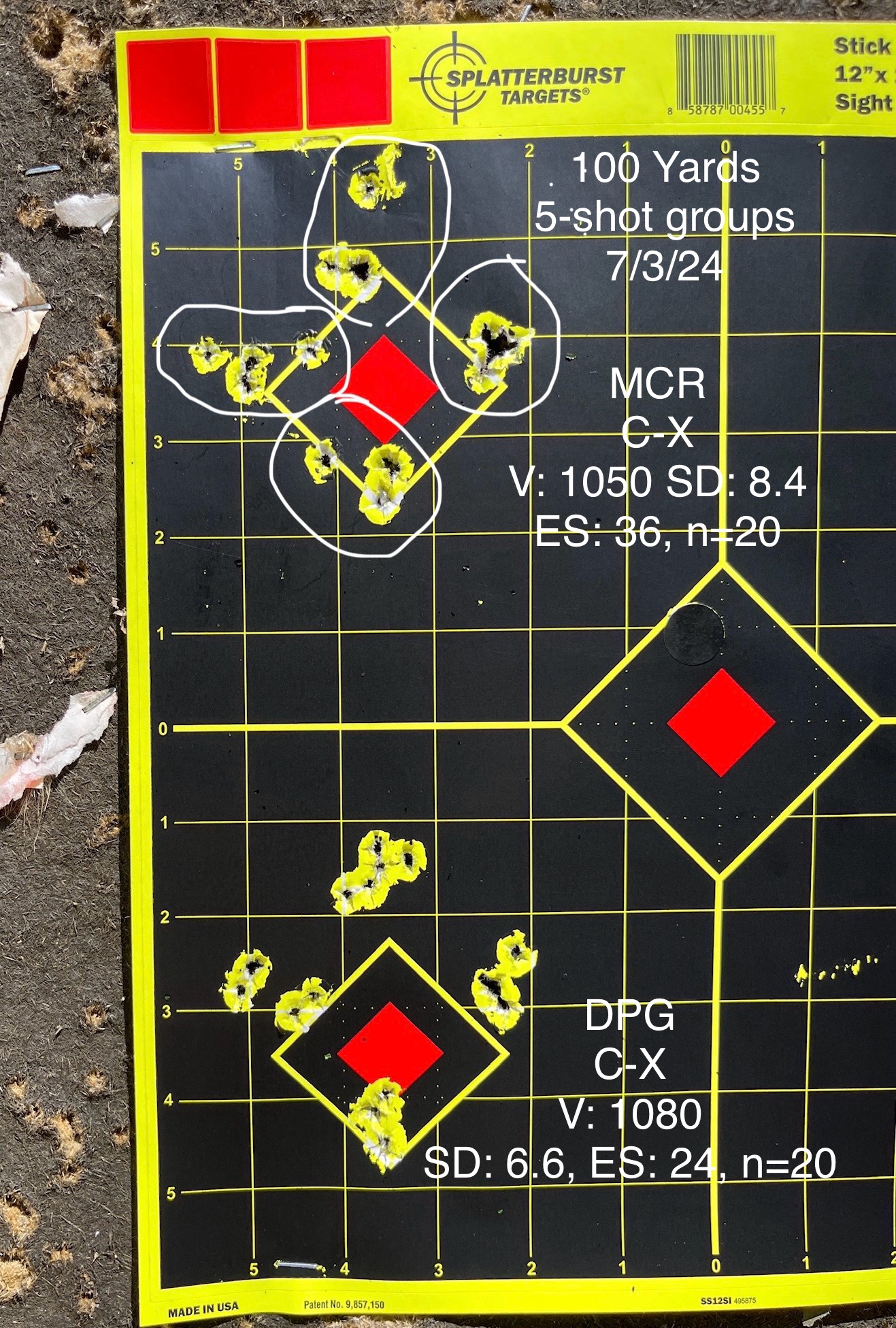

Finally got out to shoot both rifles at the same time in the same conditions. Had to steal the scope of my centerfire rig, but I’m into rimfire mode now anyway.

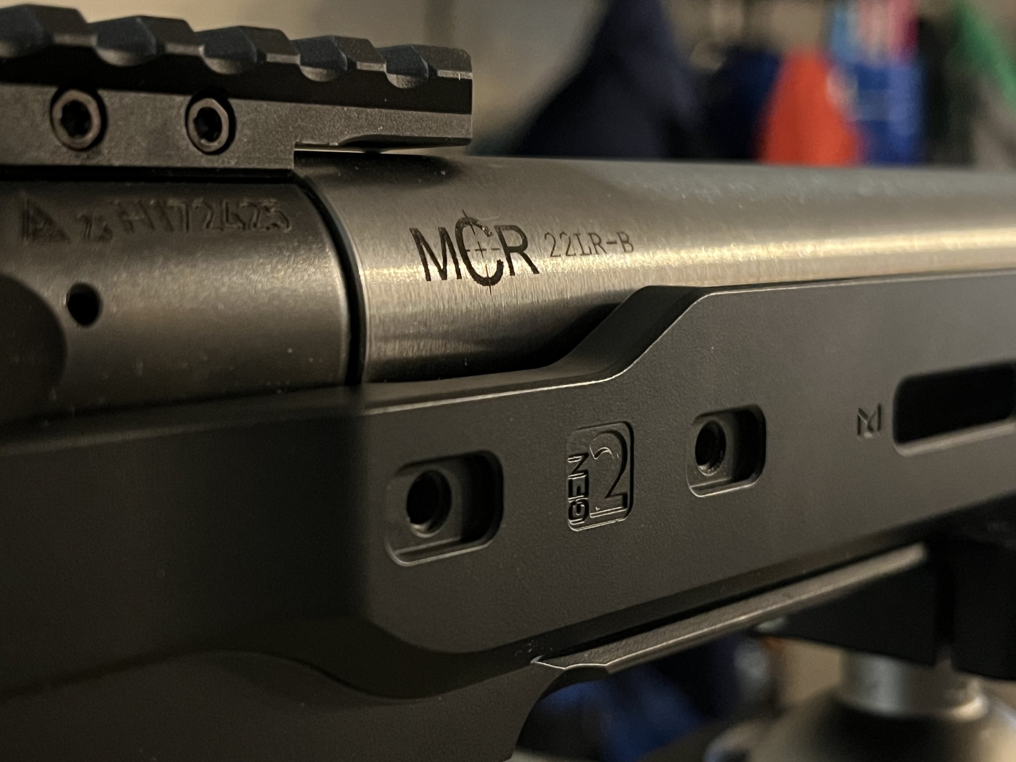

Independent review, but I’ll try to not let my massive appreciation for @jelrod1 @ MCR-rifles.com for donating this barreled action & trigger and MDT for donating the pre-release chassis to the NRL22 National Championship match bias my comments. You folks make some kickass, quality stuff and your support of the sport is hugely appreciated!
Blue rifle: DPG thermal fit 24 x 1.10”, ACC gen1 w/1.5 lbs up front & aluminum butt plate, Razor gen3 on an MDT 40 MOA rail, Timney flat trigger. ~1k down the tube if I had to guess.
Black rifle: MCR built barreled action Muellerworks 24 x 1.18”, ACC gen2, Razor gen3 on an MDT 20 MOA rail, Timney flat trigger. Brand spanking new.
Both shot off a ckye pod (LW double) and heavy Schmedium rear bag. Same lot of Center-X, only a few minutes apart. I’m not a benchrest shooter, just an NRL/PRS shooter and was cracking out 5 shot groups as soon as I got stable. No adjustments for wind.
Both shot well. Only had a few shots out of each that wasn’t my fault at each distance. Further ammo testing and lot testing might be able to tighten things up a smidge, but either are super good enough for my needs. The MCR might get even better after some more seasoning. Pretty awesome to see a slip fit heavy barrel shoot this well.

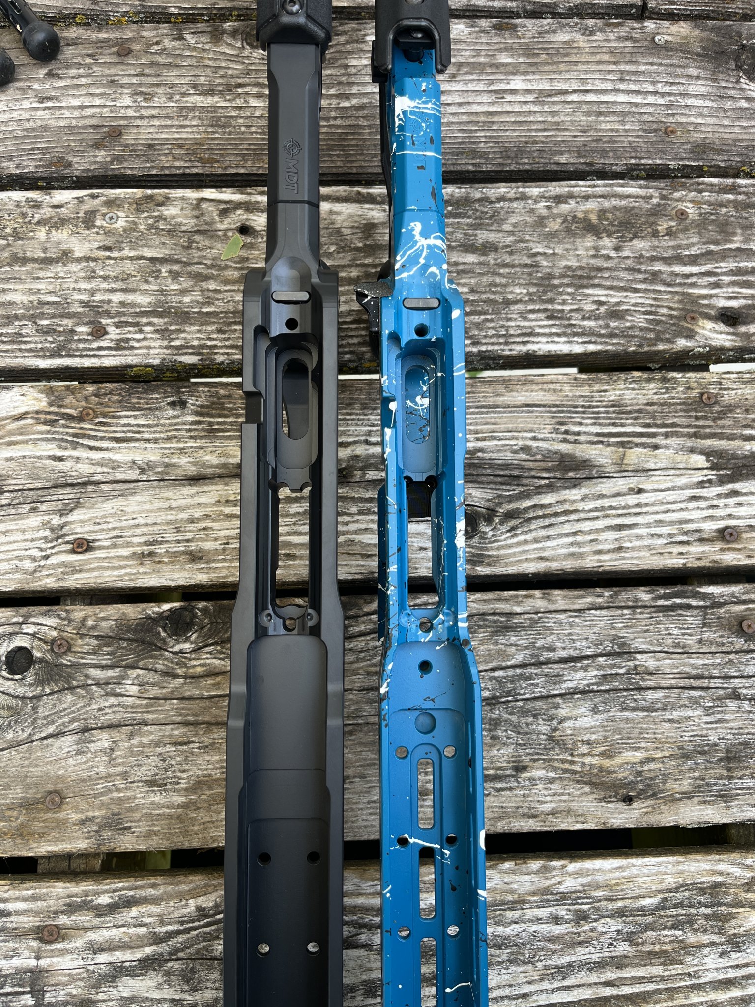

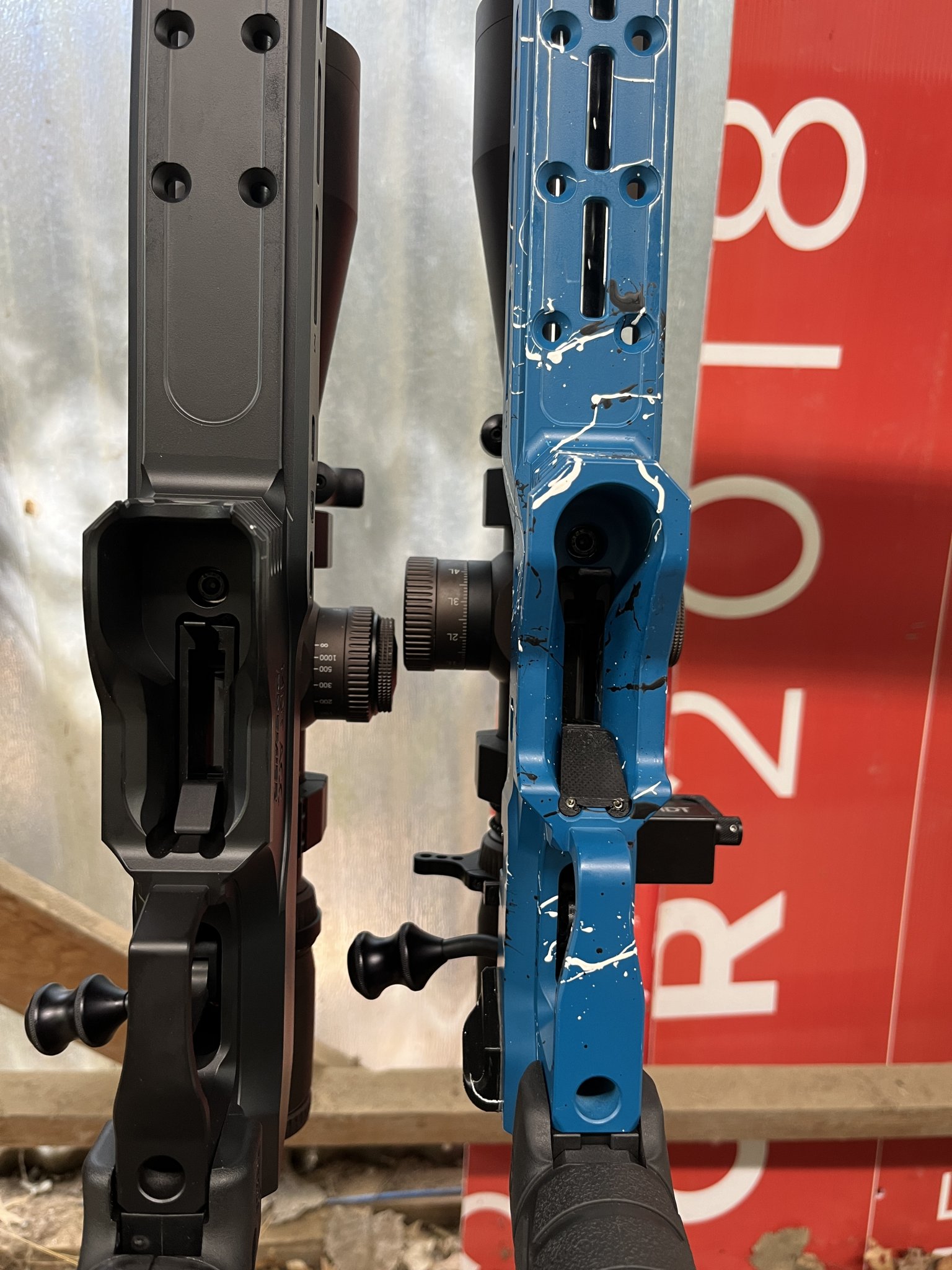

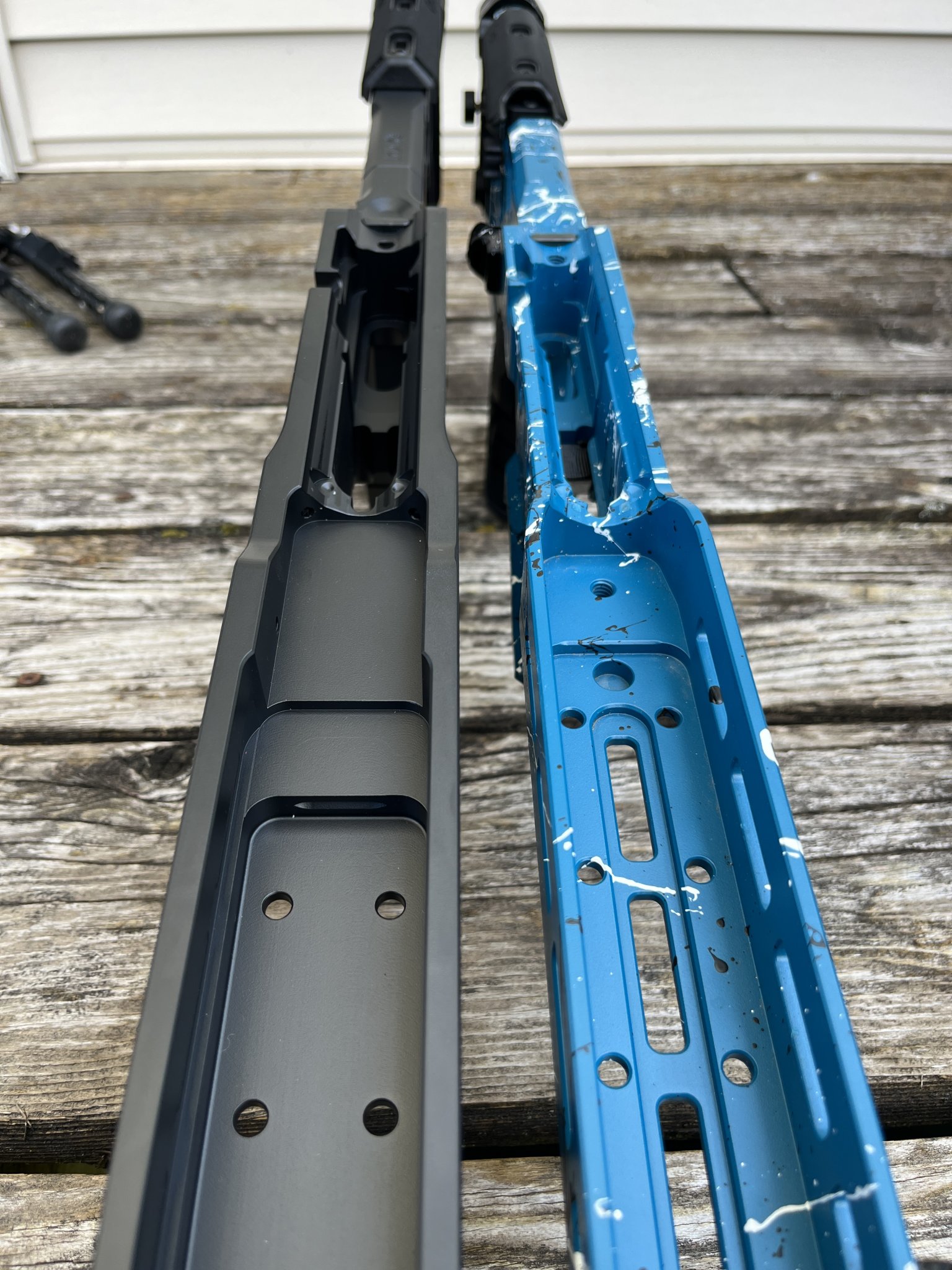

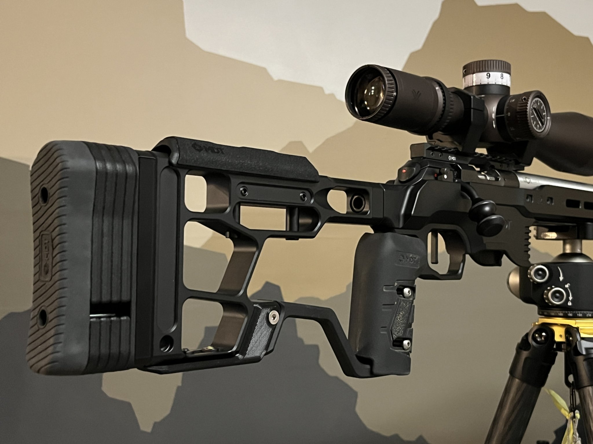

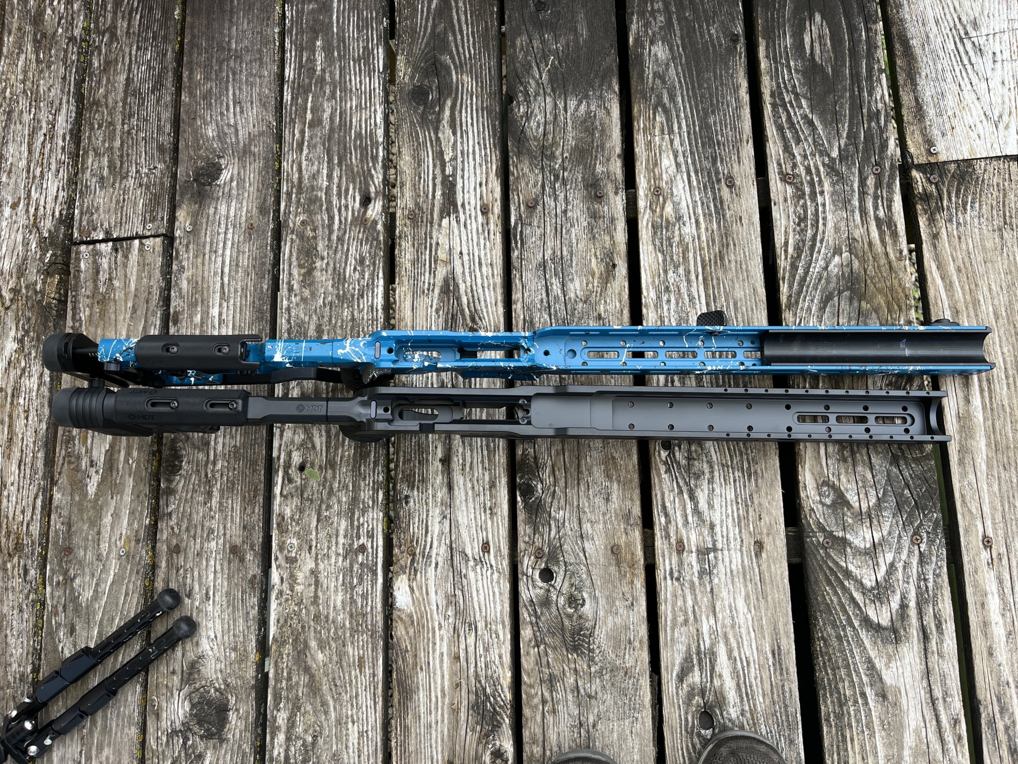

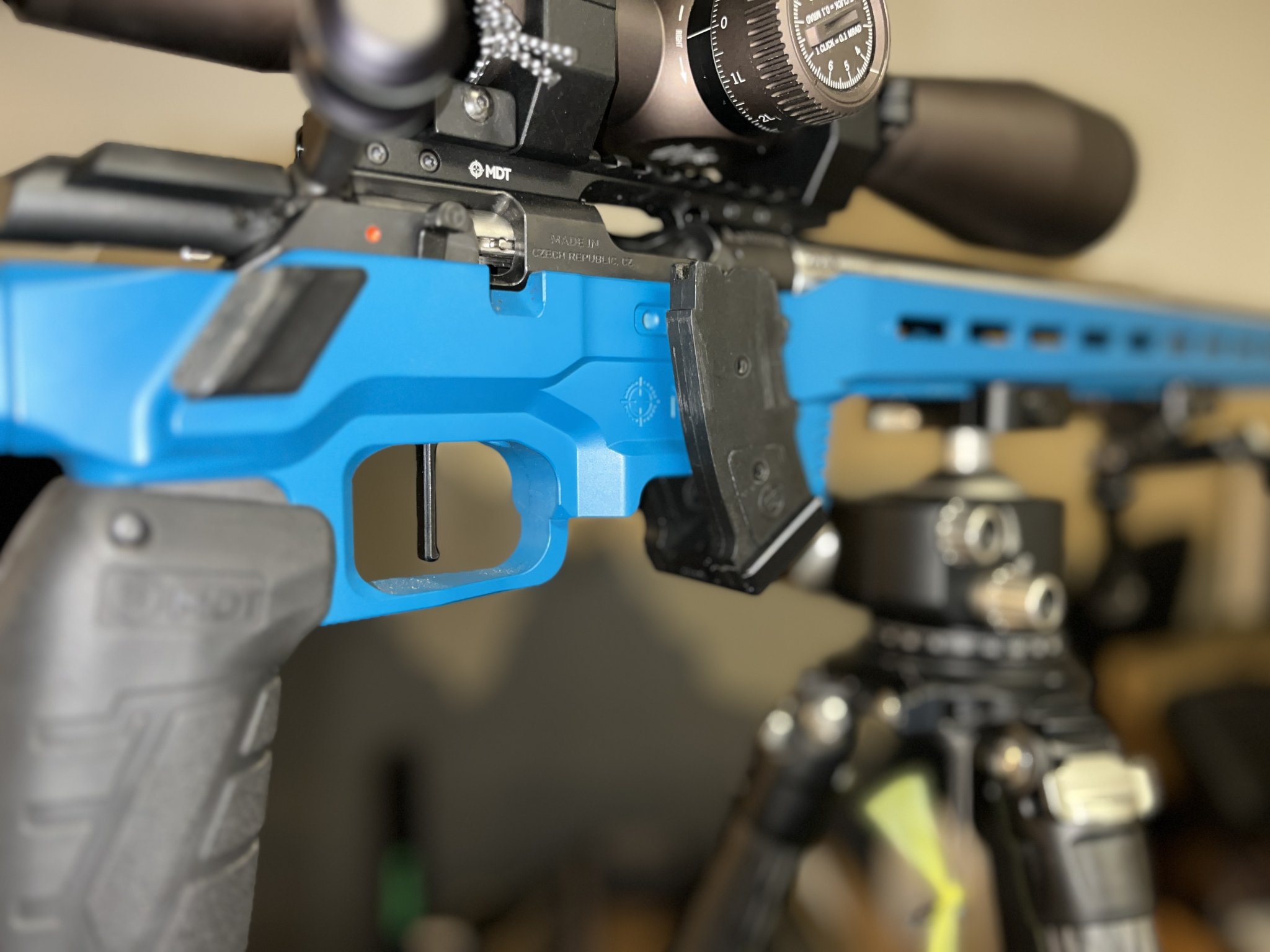

MDT ACC Chassis comparison:
Gen1
Pros:
• Longer forend = easier to balance
• Magwell covers edges of factory magwell, making it a direct funnel
• Tool-less adjustments
Cons:
• Heavier buttstock = more weight needed up front for balance
• More flexible forend
• Rear magwell filler needed for easier/faster reloads (I have a 3D printed wedge in mine)
• Snug access to mag release
Gen2:
Pros:
• Super stiff forend
• Lighter buttstock
• Barricade stop cutout for sausage finger access to mag release
• Extended mag release and rear magwell guide included
Cons:
• Short LOP - maxes out at ~13.5” out of the box, had to make a 1/2” spacer and get longer 3” 10-32 screws to fit me
• Shorter forend is harder to balance, but now that we can get proper heavy barrels, little to no weight is needed.
• Magwell spacer required some filing to allow clearance for L3i billet mags
• Magwell sides don’t cover factory magwell, making a catch for mags while inserting them.
• Grip is tiny and has lots of sharp edges. Feels like it’ll be a throwaway for most. MDT’s good grips are $$$.
I’m not sure which chassis I’ll run moving forward. Both have some solid pros and cons to them. Would love to see an Elite inlet for the CZ. I’d pay the premium to get R-Lock, better adjustments, a fully dialed magwell, the better grip and stay.

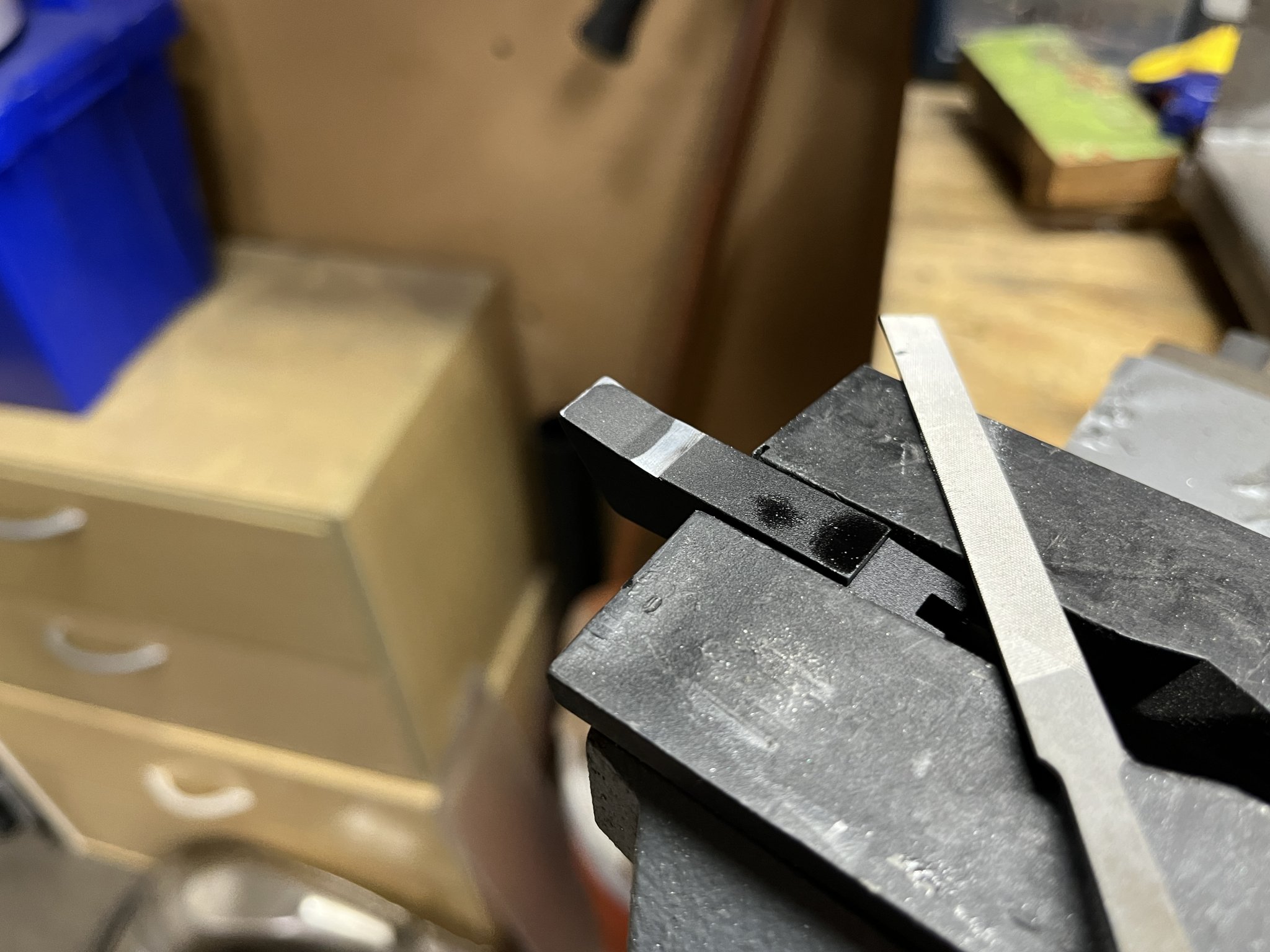

Little bit of material removed from magwell filler to allow clearance for L3i mags. This is off the back side, where the chassis makes contact with the filler piece.

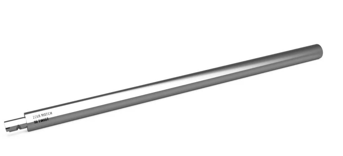

total noob here, if i had a cz 457 and my gunsmith squared and threaded the reciever and put a krieger on there, would I be giving up anything over a vudoo/rimx as far as accuracy, SD, feeding, etc
Lots of people have tested and proved that a CZ with a good barrel can keep with Vudoo and RimX. The CZ 457 action quality is top notch and even slip fit match barrels like from places like Modacam or Lilja (an others) are on par with the best rimfires out there. The main reason to go Vudoo, RimX, or B14R is if you want a Remington 700 footprint. There are more options for chassis/stocks, triggers, and bolt knobs for that platform. Also, it can be used as a trainer for centerfire a little more effectively.
DPG does what you're talking about with truing up the receiver and threading a barrel onto it. I've only heard good things about Kenny's CZ 457 builds like this and most will agree that there's no loss in precision/accuracy going this route.
