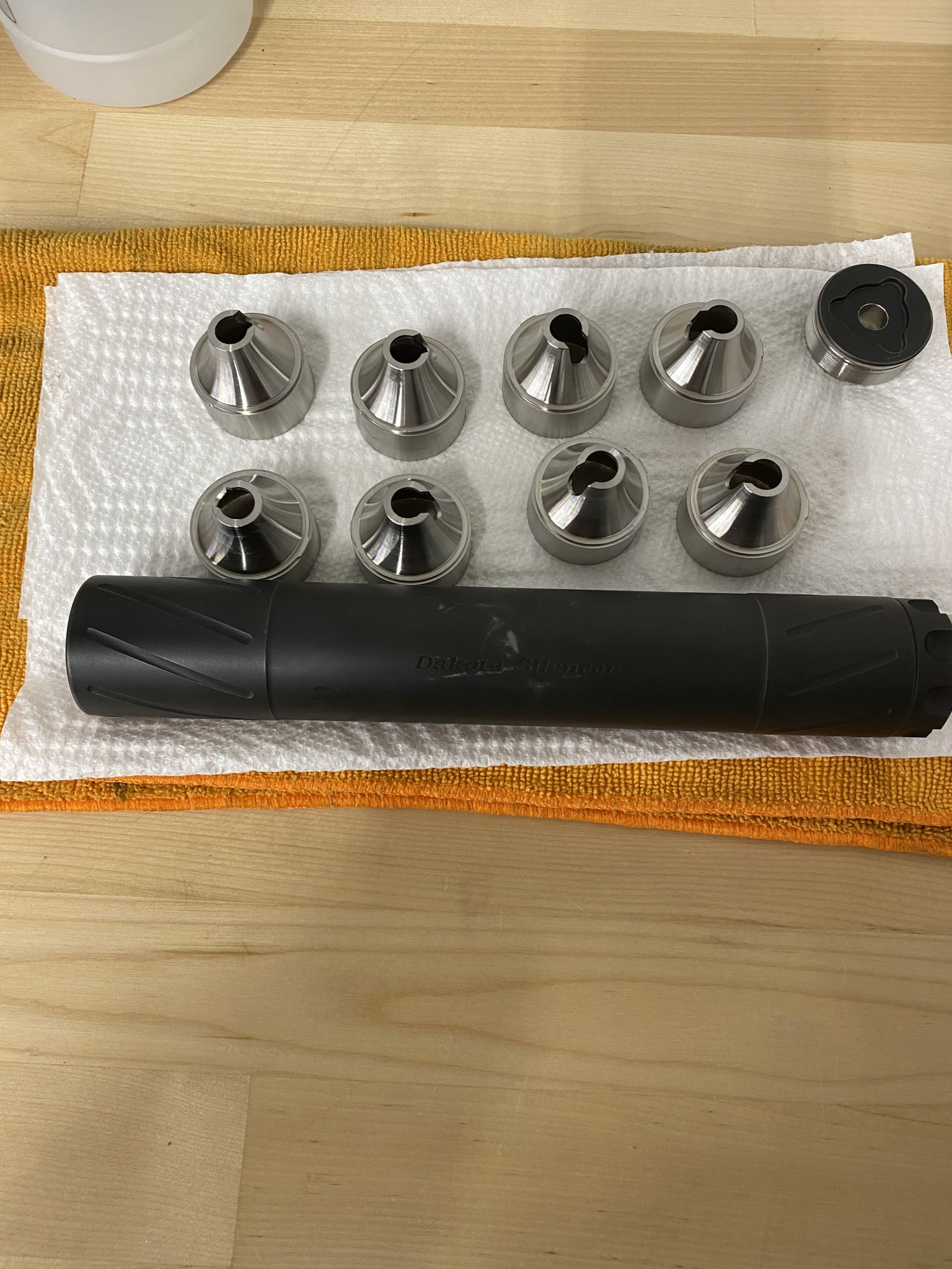

Do you apply anything to the baffles after cleaning and putting it together? I got it clean but noticed some of the finish on the outside of the can was warn off (small area). I think one of the baffles was touching the can while running the ultrasonic cleaner. Oh well, just gives it character.
You could use fireclean. I find it to be easier to clean the next time around.
