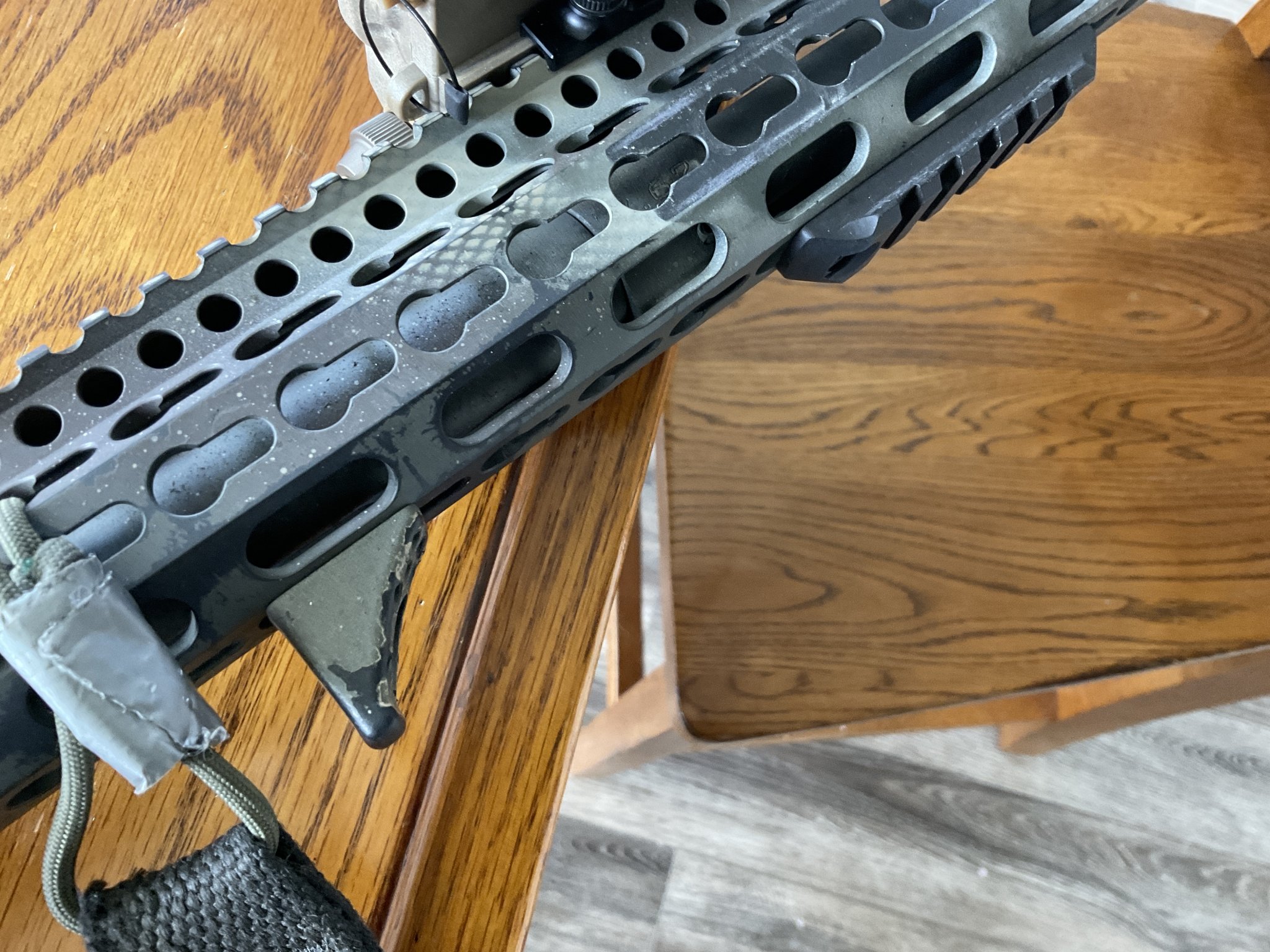

Just like @msgriff said, it has an adjustable gas block. It takes a iddy biddy tiny small thin, you get the idea, alen wrench to adjust it. You better switch it back and forth after every outing or that thing will freeze up and will easily strip. Why DD went with such a small allen wrench adjustment we will never know.
So I have searched hi and low on that gas block, I can’t find it. It’s the Key MO version and for some reason I did some research and this doesnt have it? I could be wrong
