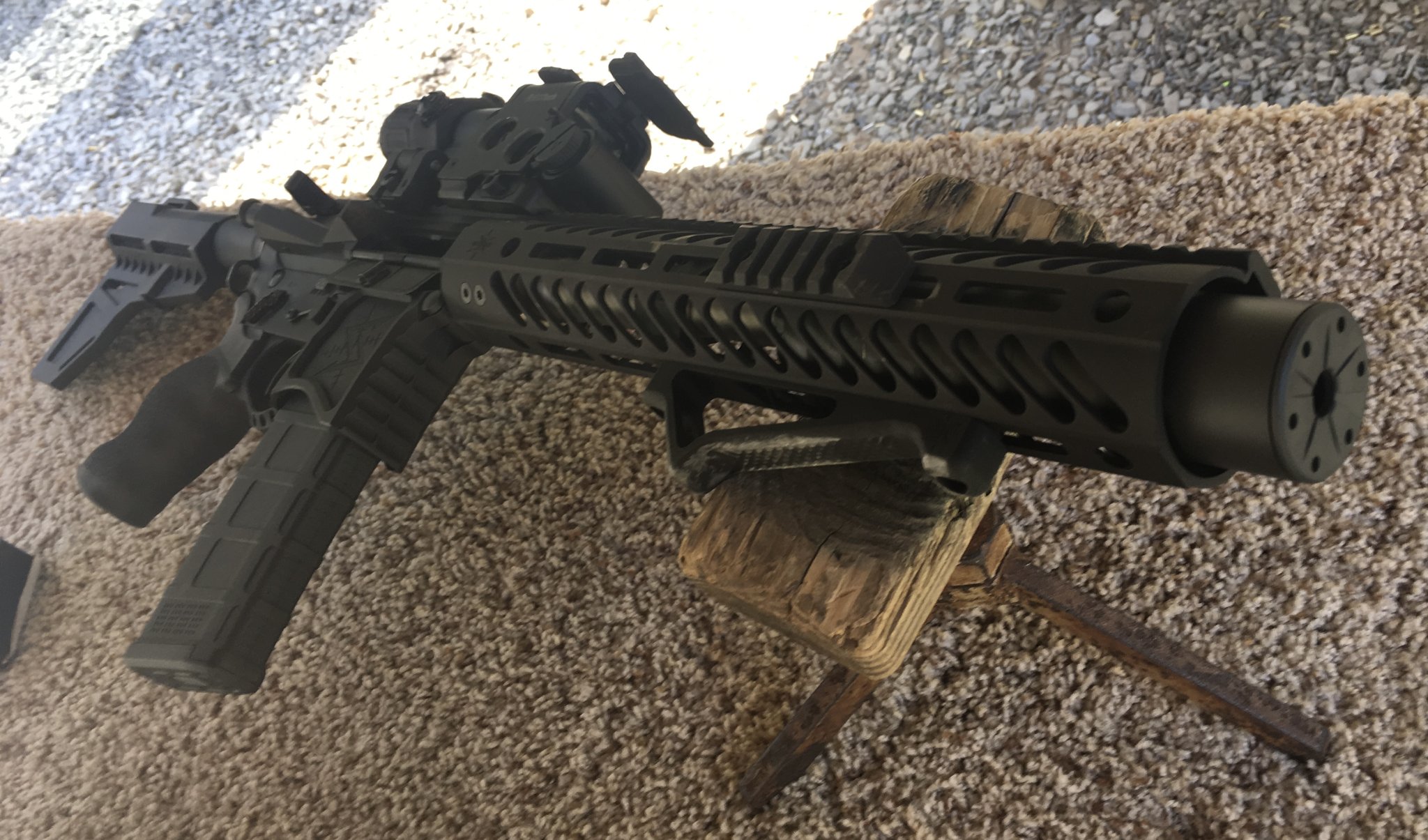

I thought the Maxim Defense PDW brace would feel uncomfortable, but it honestly didn’t feel that much different than a SOPMOD to me. Way more comfortable than I ever expected, forgot about it quickly when shooting. I made a Coyote Tan elastic strap for it to replace the black one. The stiff action spring feels great when cycling actually, like this is how the AR-15 was meant to be with 90gr TNT. Really slick little set-up.
I like the SB Tactical HBPDW Brace though for compactness/aesthetics and 3 position vs the Q Honey Badger Stock or brace.
This one has a MC Cordura appliqué I made for it and the other parts are painted. I replaced the black strap with another home-made strap that isn’t black. This is a 10.5” Grendel PDW:
