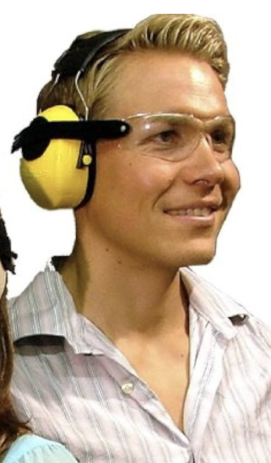

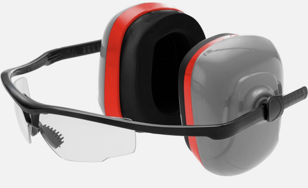

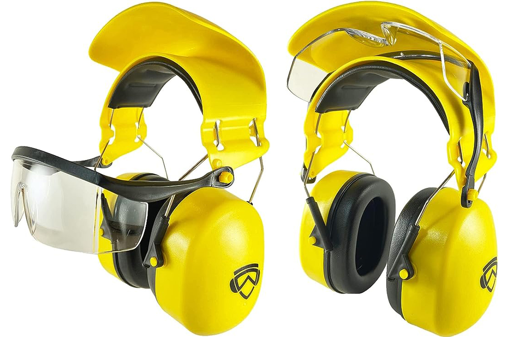

While looking around, I found some other options. Don’t think any are electronic-type, the kind that allows you to hear normal sounds and cuts out for gunshots.
These are all goofy looking, except maybe the arborist setup. But that would look a little Tier 1 at the range lol.
I put these here for curiosity’s sake, not for serious recommendation.
Groggles​
Amazon product ASIN B0C8KYCLLV
UNINOVA​

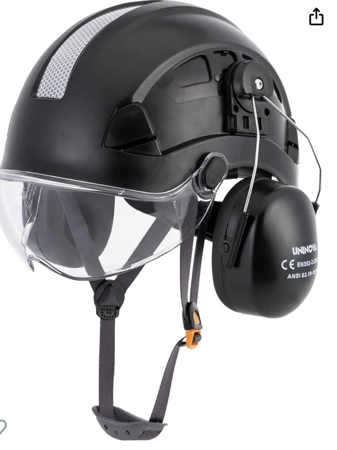

An arborist thing. I’m sure there’s some super-fancy actual military versions with integrated eyepro. I just haven’t seen them (nor looked for them…yet lol) Amazon product ASIN B0BVH9Z2SD
eBay thing​
Again, I put these here for curiosity’s sake.
I suggest the following pair. It’s the eyepro I linked to in an earlier post and it is way simpler, cheaper, better looking, and is also more adaptable than the stuff I posted above. Use with your existing muffs.
Kinda dumb pic (hair?), but shows how they work.
