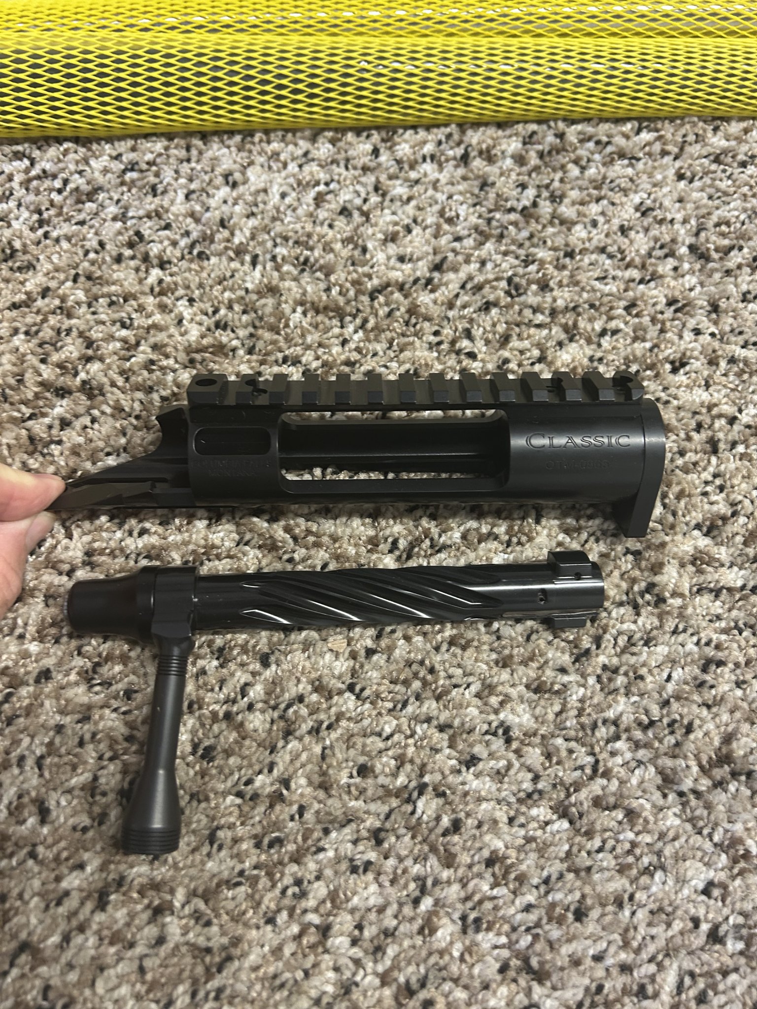

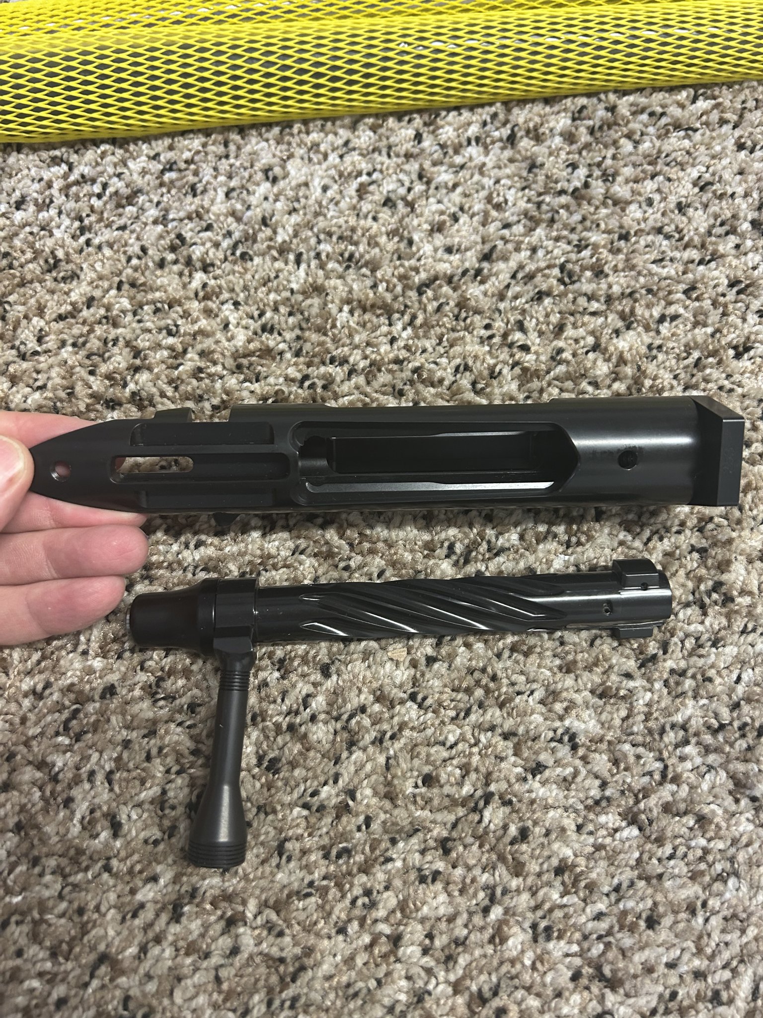

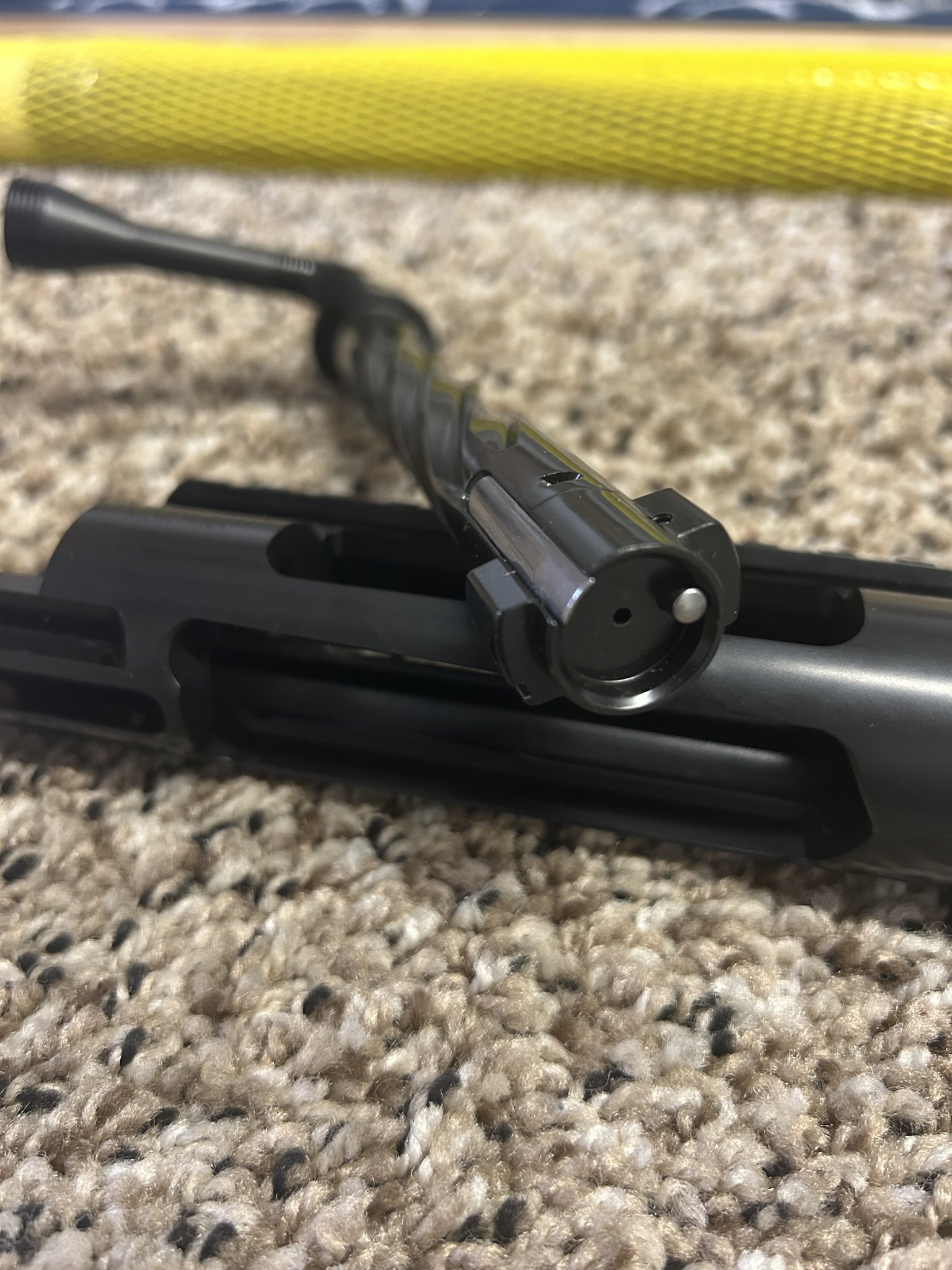

I'm not aware of the fitting problems. I've been shooting a Defiance "Classic" for about 5 or so years on my 6 ARC bolt. Mine is a custom "hybrid" using the coned nose from the Elite actions along with the leaf ejector. I believe that comes from Winchester originally.
I prefer that to the plunger ejectors although I just bought a Ruckus with the plunger.
Best action I've ever used. It is so smooth it borders on incredibly so. Mine has around 2700 rounds on it and it is still exactly the same as when I got it. (cleaning regimen applies - including bolt disassembly every 1000 rounds which is very easy).
I like the way it works so much that I have a Defiant Ruckus on an UPS truck going to my FFL as I write this. That will be for a new 6mm GT build.

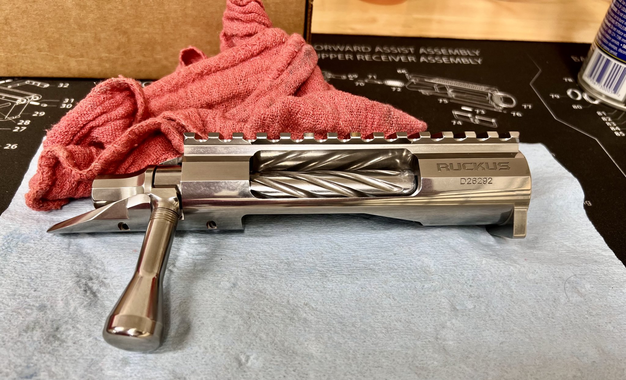

Can't go wrong with either. The reason is that they both take prefit barrels, which is the trend these day. The reason they take prefits is because they are both considered premium actions. There is more than that like repeatability of the action barrel threads for timing etc. I'll leave it there because there really is a lot involved.
And I just got mine new action today - its massive:
