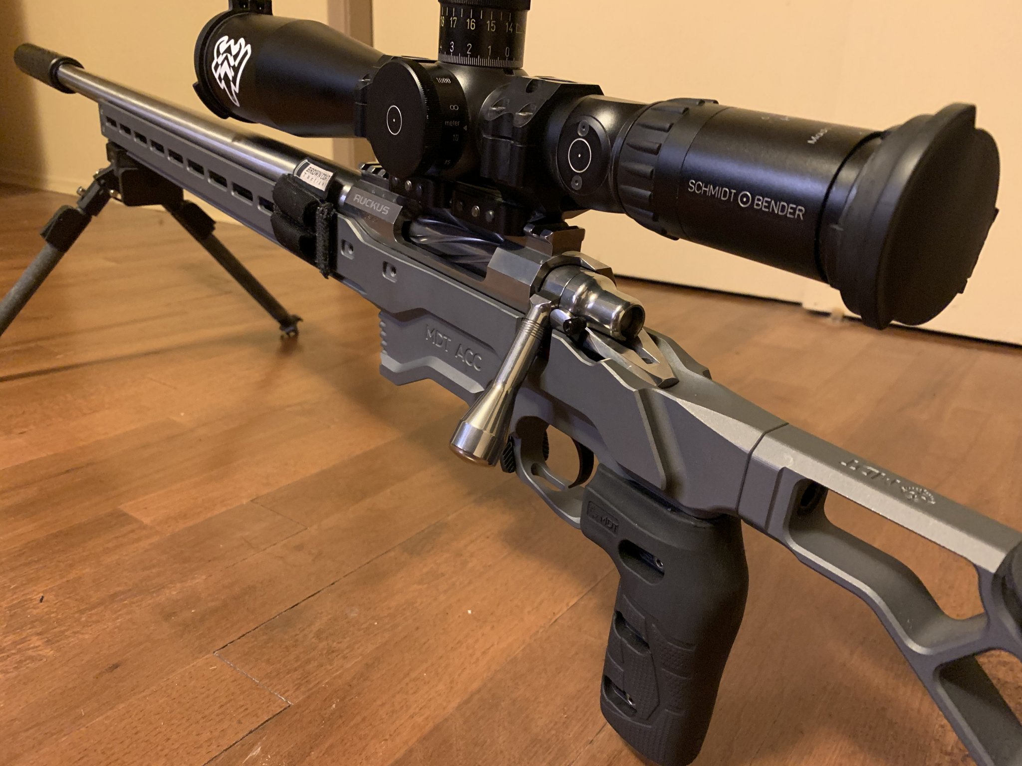

how much did it affect the pricing to have it turned to a left handed action?all built up and ready. Chambered in 6 dasher. View attachment 7266464
The price doesn’t change for a left handed action.how much did it affect the pricing to have it turned to a left handed action?
They make both right and left hand configurations. No price difference.how much did it affect the pricing to have it turned to a left handed action?

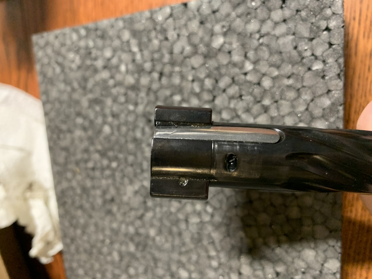

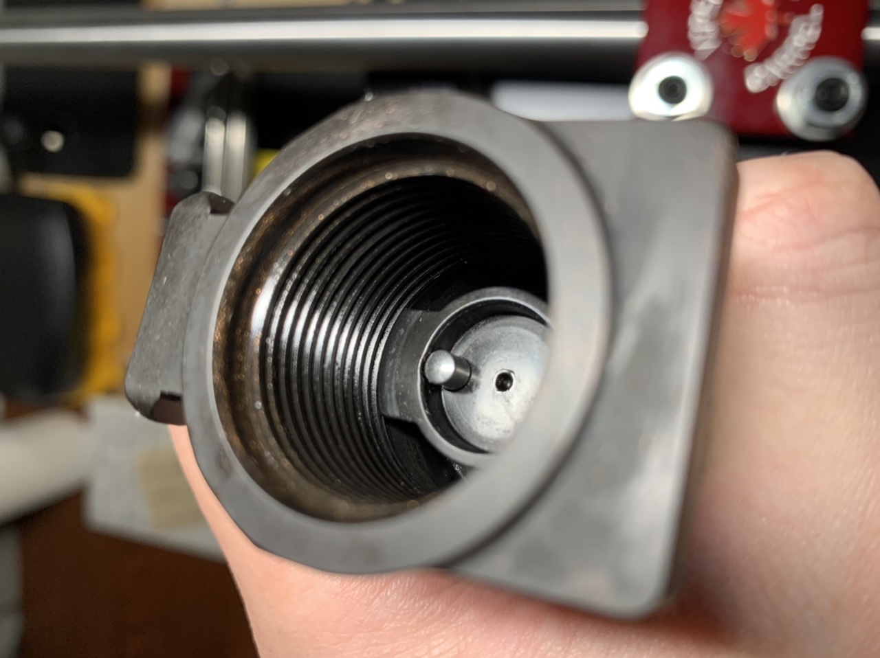

Is that a magnum bolt face? I’m sure defiance will answer this question.I need some helps with my Ruckus. Do everyone have their Ruckus come with recessed bolt head? Mine comes with a flat bolt head, and it doesn’t work with PVA prefit barrel. Do I need to specify what kind of bolt head I want when I order?

It is a magnum bolt face. The bolt face is correct about the shape of bolt nose is not quite right. The one I got (I believe is a flat bolt nose) didn’t work with prefit barrel that I ordered. Defiance is trying to find the best way to help me out.Is that a magnum bolt face? I’m sure defiance will answer this question.

I am in Canada, and this is the first Defiance for me. I didn’t know there are actually different bolt nose choices. I ordered it from one of their retailers in Canada and I had specified that I want it to work with prefit barrel with this action.
The retailer is working with Defiance now to help me.

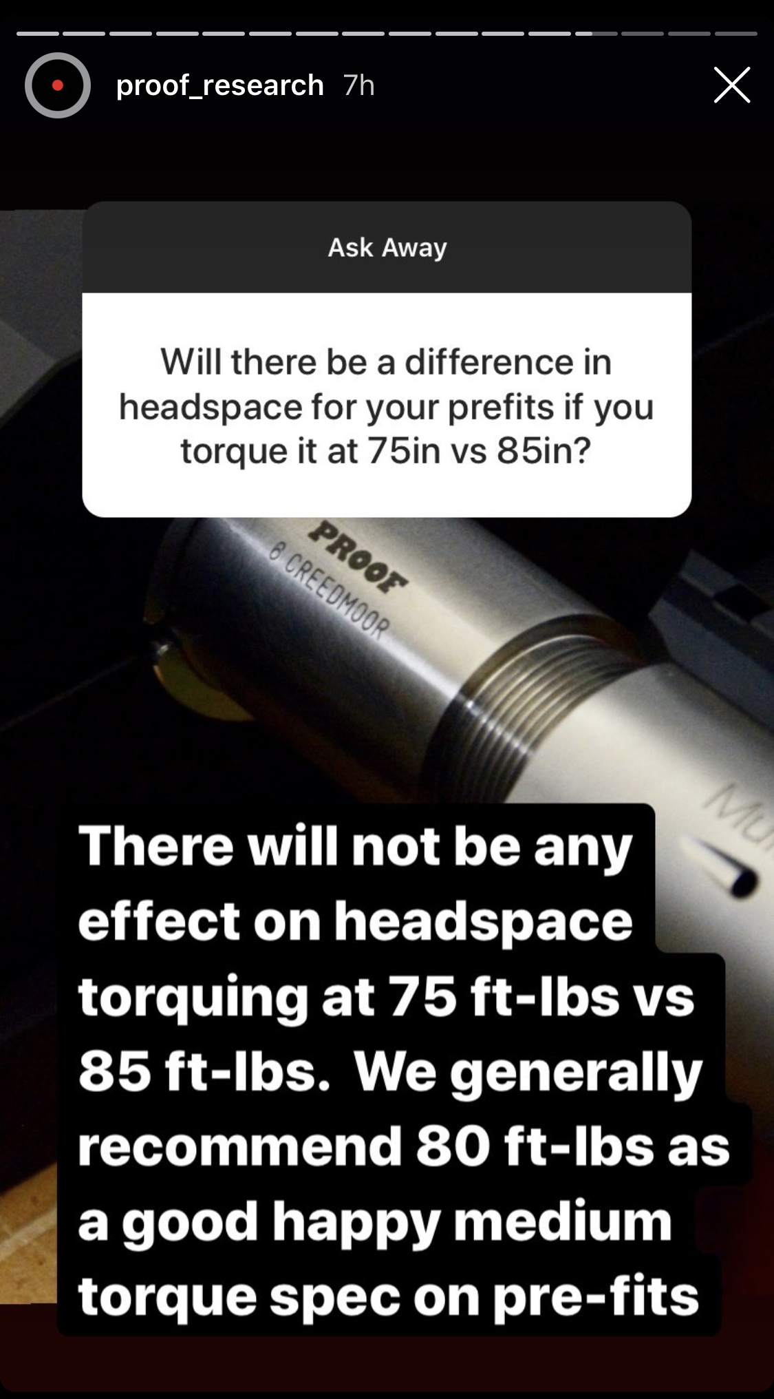

Torqued to 85ftlbs.
‘My Proof barrels say do not exceed 65 foot pounds.
This could be a factor.

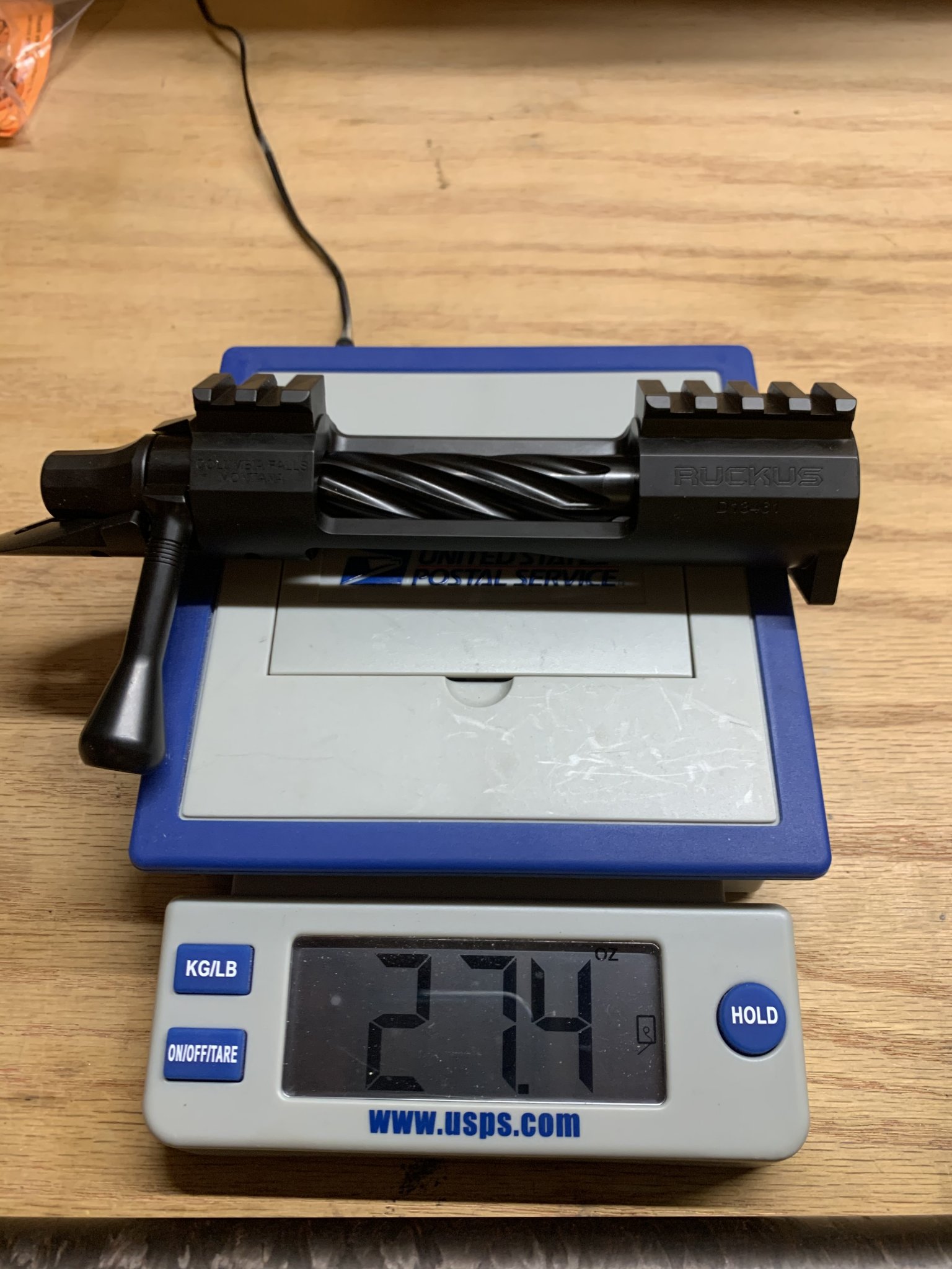

Nitrided Ruckus GA Hunter with hollowed out tear drop handle.... talking with Cody I think it will weigh under 28 ounces for a medium action.

Anyone else spun a Proof Prefit on a Ruckus yet? Just got a 300wm Proof prefit and Ruckus in and measuring long on the headspace. Closes on go gauge (.220), nogo gauge (.223) and go gauge with masking tape (~.2248). Does not close on Field (.226). All Forster and measured accurate with mitutoyo caliper. Torqued to 85ftlbs. Was hoping this was going to be spin on and go but guess I might have to drop it off to get the shoulder bumped just a hair. Emailed proof to see what they expect to measure.
She's a pretty one at least.
edit: Proof's Response - " SAAMI spec is .220-.227 ... .226 gage does not go so should be fine."
I usually don't like a brand new barrel closing on a nogo.
