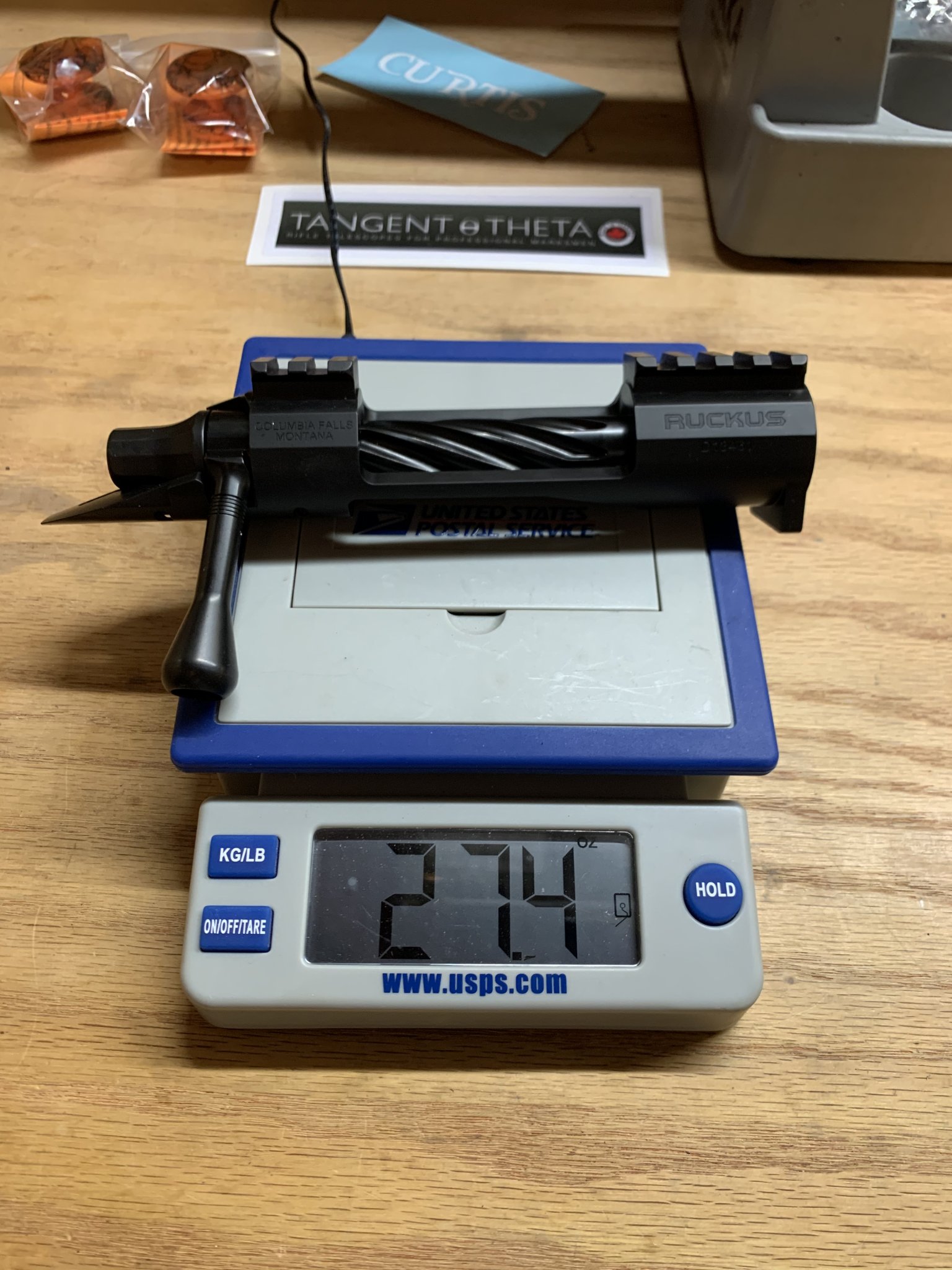

Defiance medium nitrided actions (700 SA length):
Ruckus GA Hunter with hollowed bolt knob:
anTi-X is 22.4 oz.
anTi-X is 22.4 oz.
Mine is 22.36oz so can confirm. Thank you for the measurements! Have you handled both actions? I’m curious how you’d compare the feel of the actions when cycling both in bolt lift/close effort as well as chambering rounds.
I’ve handled both actions but have only shot the ruckus. The anTiX is awaiting my decision on what to build. I have to say the nitrided Ruckus is very smooth,
smoother than my cerakoted Templar/Rebel actions. Using it with a 308 and it is smooth but solid. Has shallower depth flutes than the anTiX.

Well all that's left is the scope & rings, both on "lay away" to avoid "supply chain" issues.
I'm used to "truing" the REM action, which takes some set up. However, now just having to cut the chamber & FH, builds go much faster.
More to follow. 🍻😎👍
