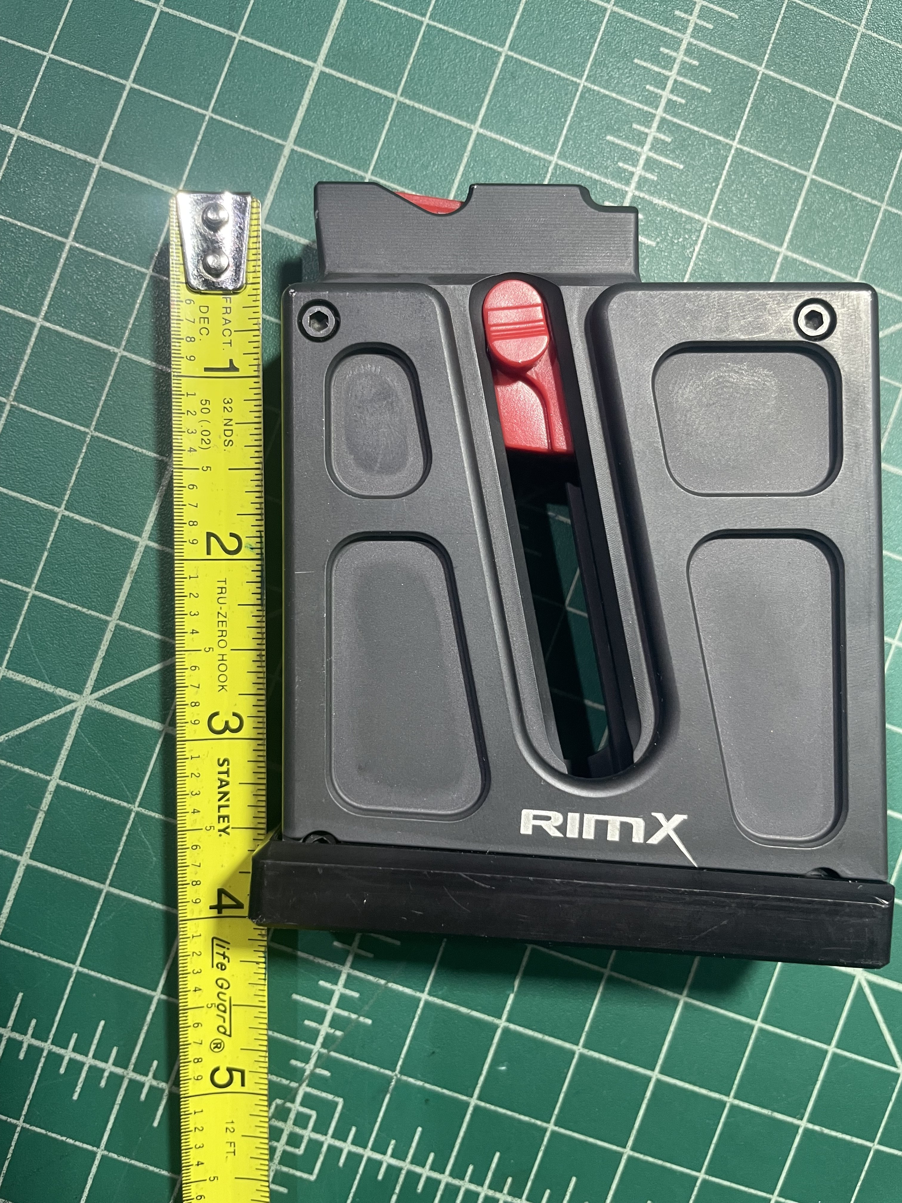

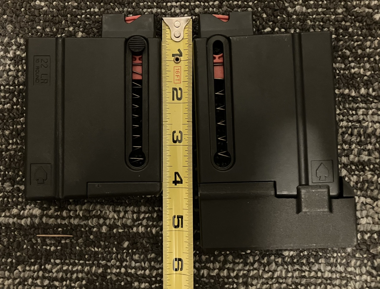

Can anyone confirm the overall dimension of a factory Vudoo mag? Is it similar to the below?
Not interchanging mags, just checking barricade stop length.
