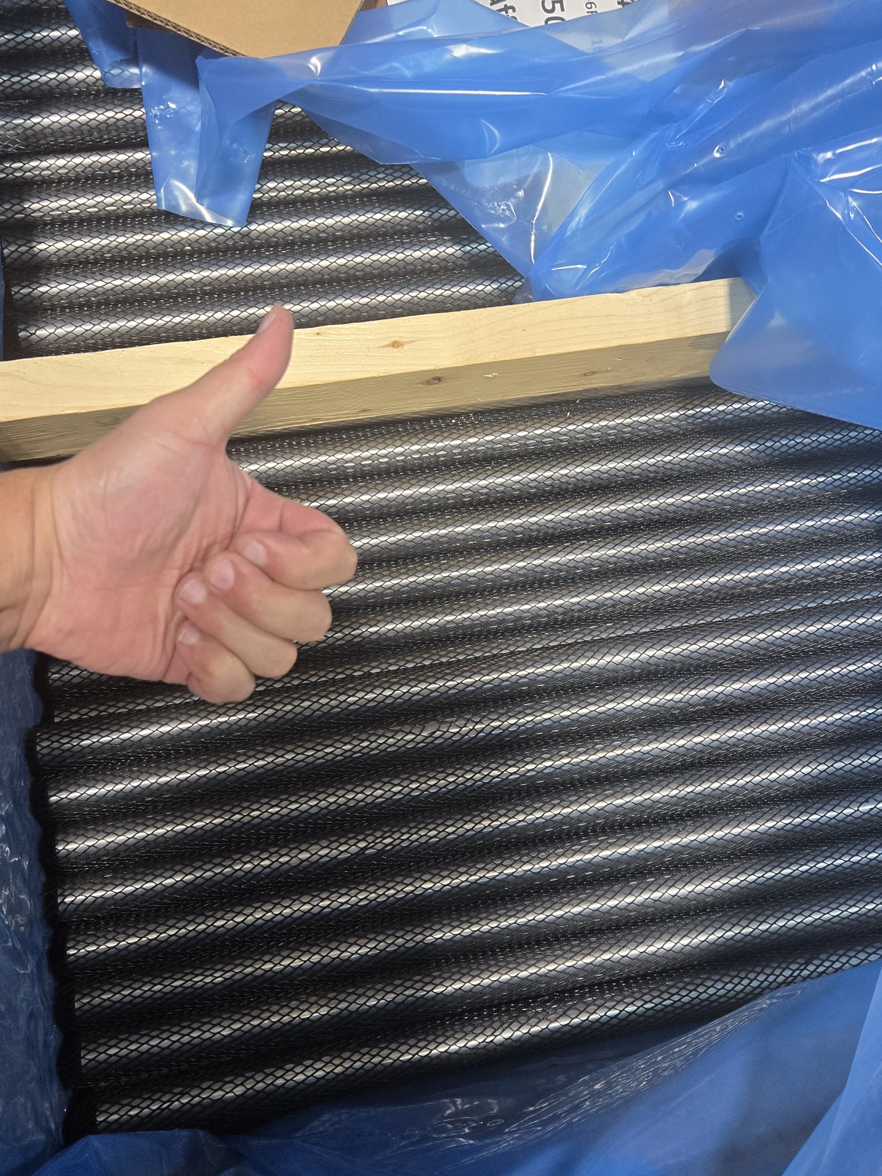

Material stock piling. Barrels waiting for a good 22lr action.

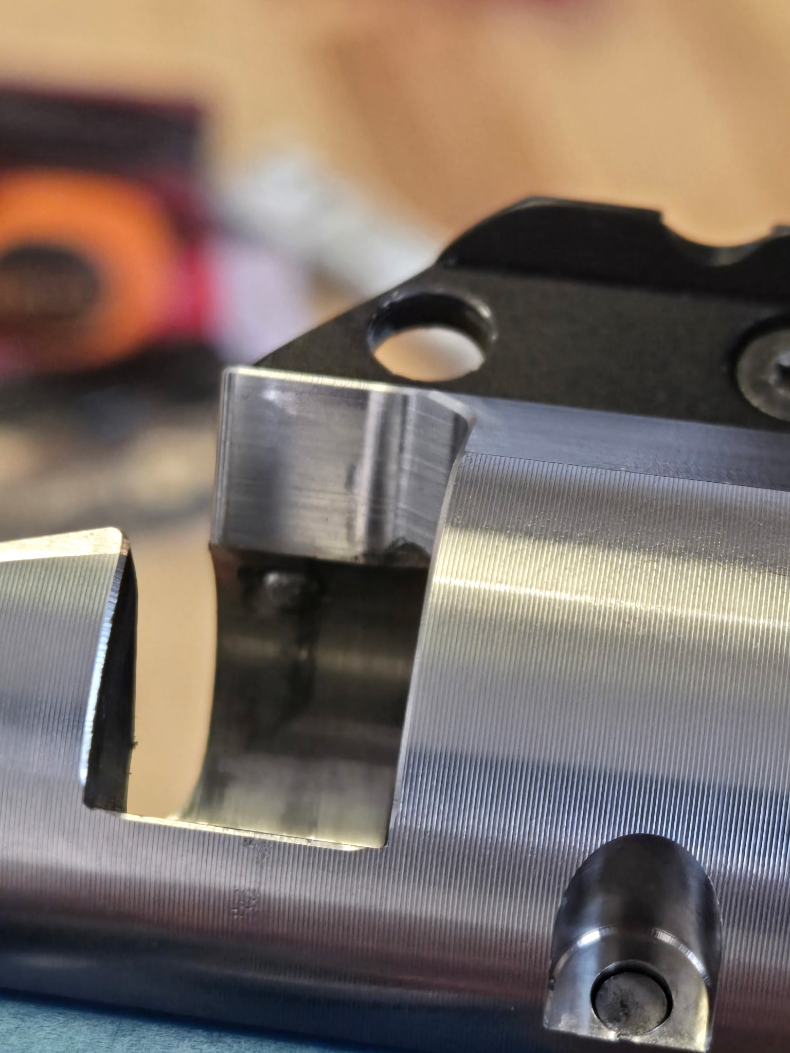

The video I posted was a testimony of its smoothness right off the cnc without deburing process and DLC, which only make it better

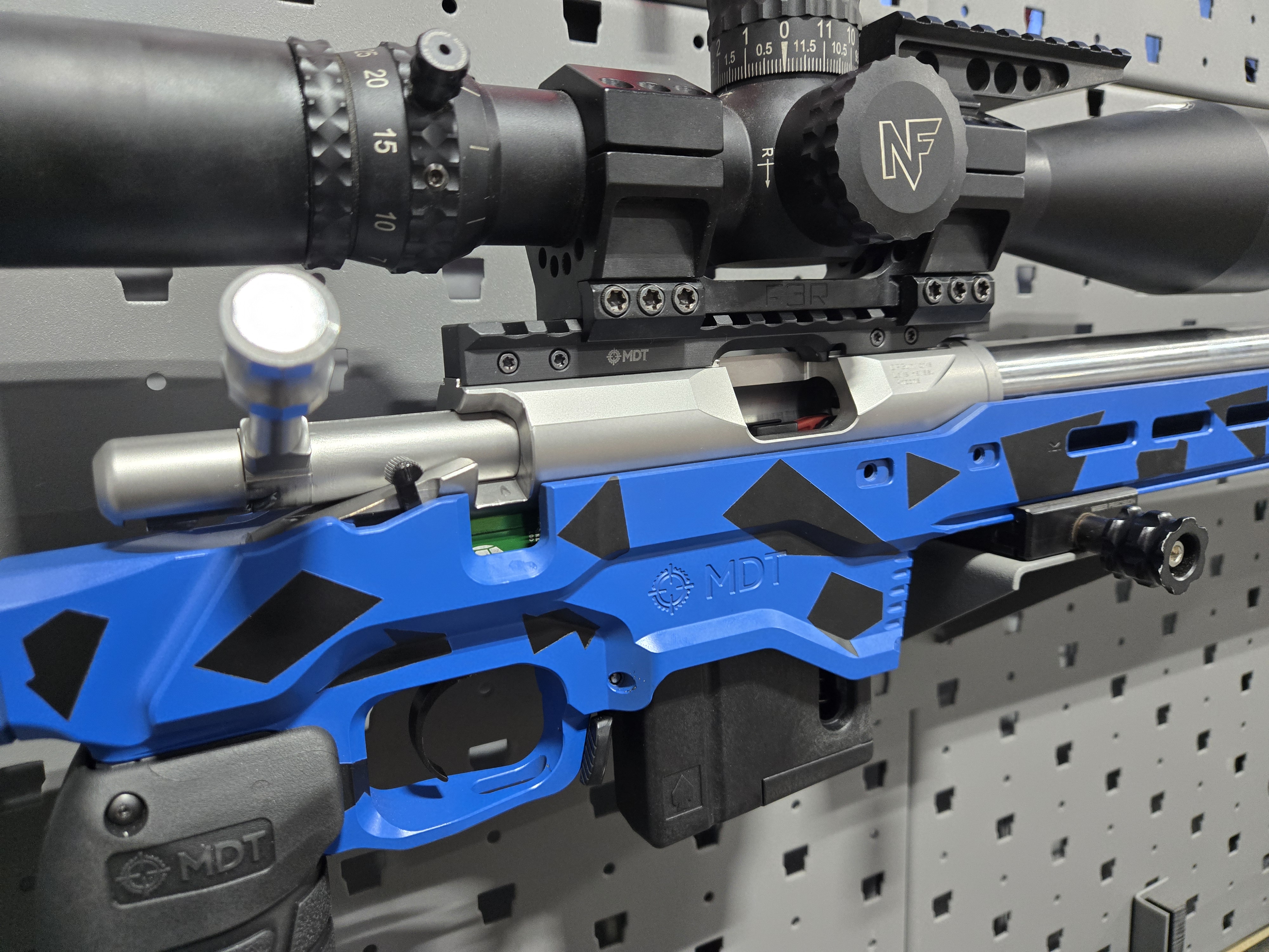

Itll look like this

I prefer the MDT bases to keep the scope to bore axis low. Configured with a 30 MOA MDT scope base, it's only 0.075" higher than the other 700 clones

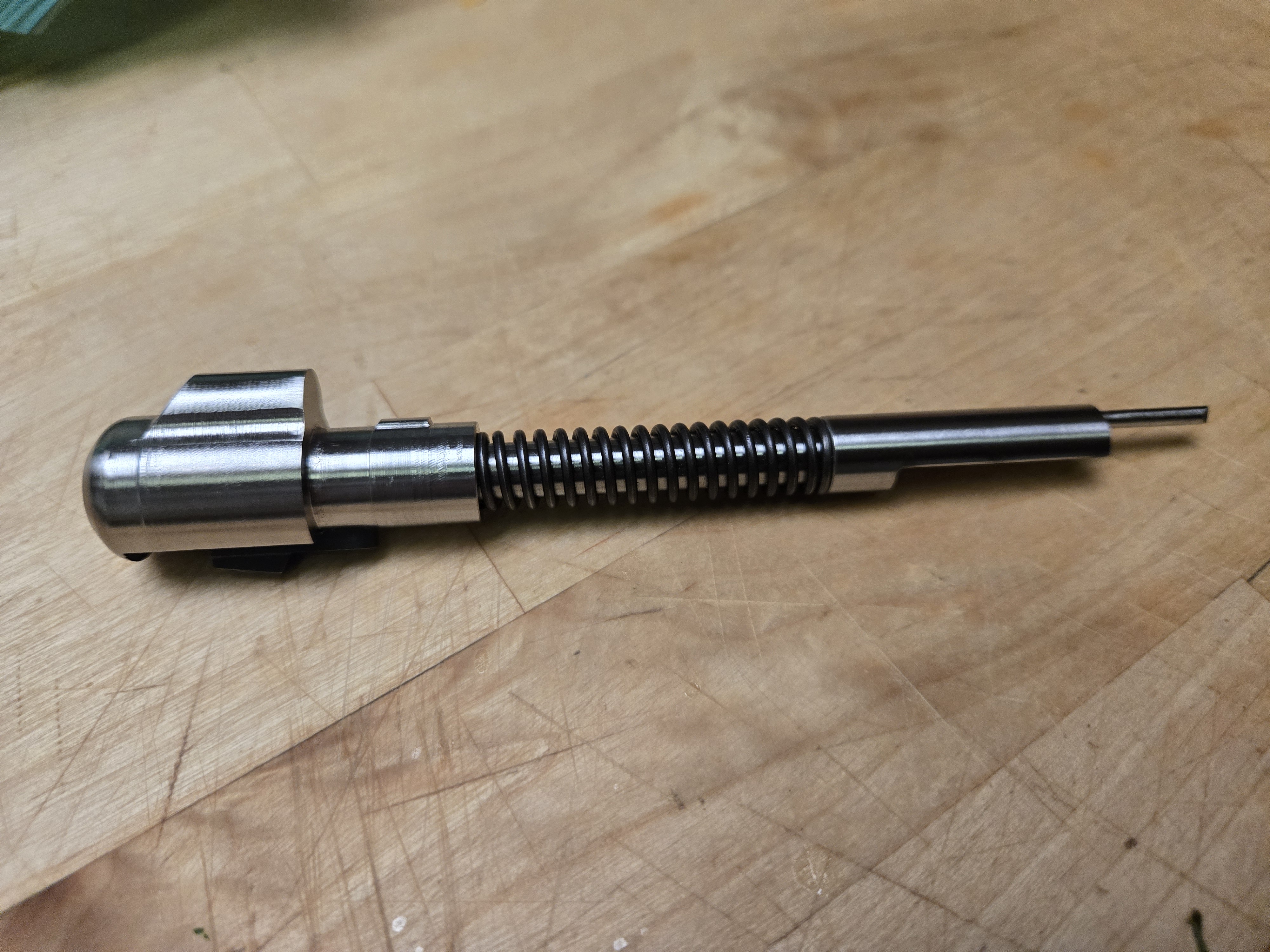

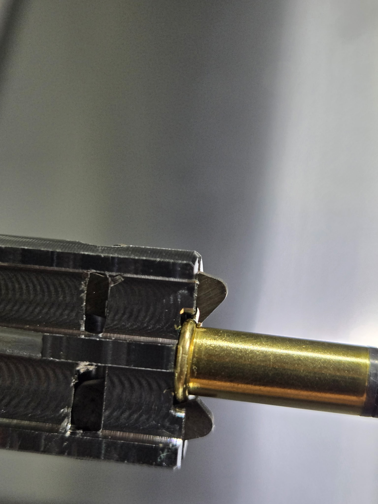

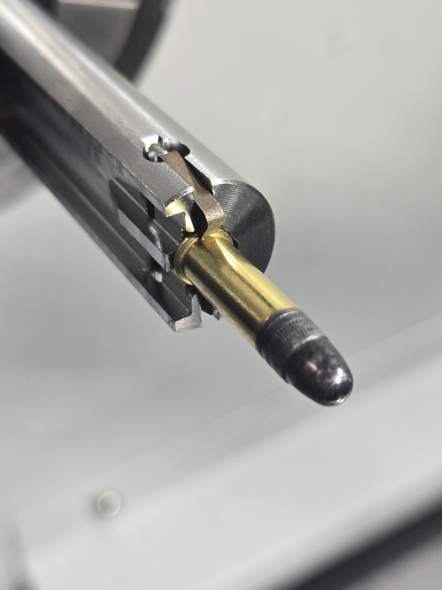

Just finished up finalizing and testing the firing pin assembly.
Edited: also just got the Form 2 approval, time to burn serial numbers!

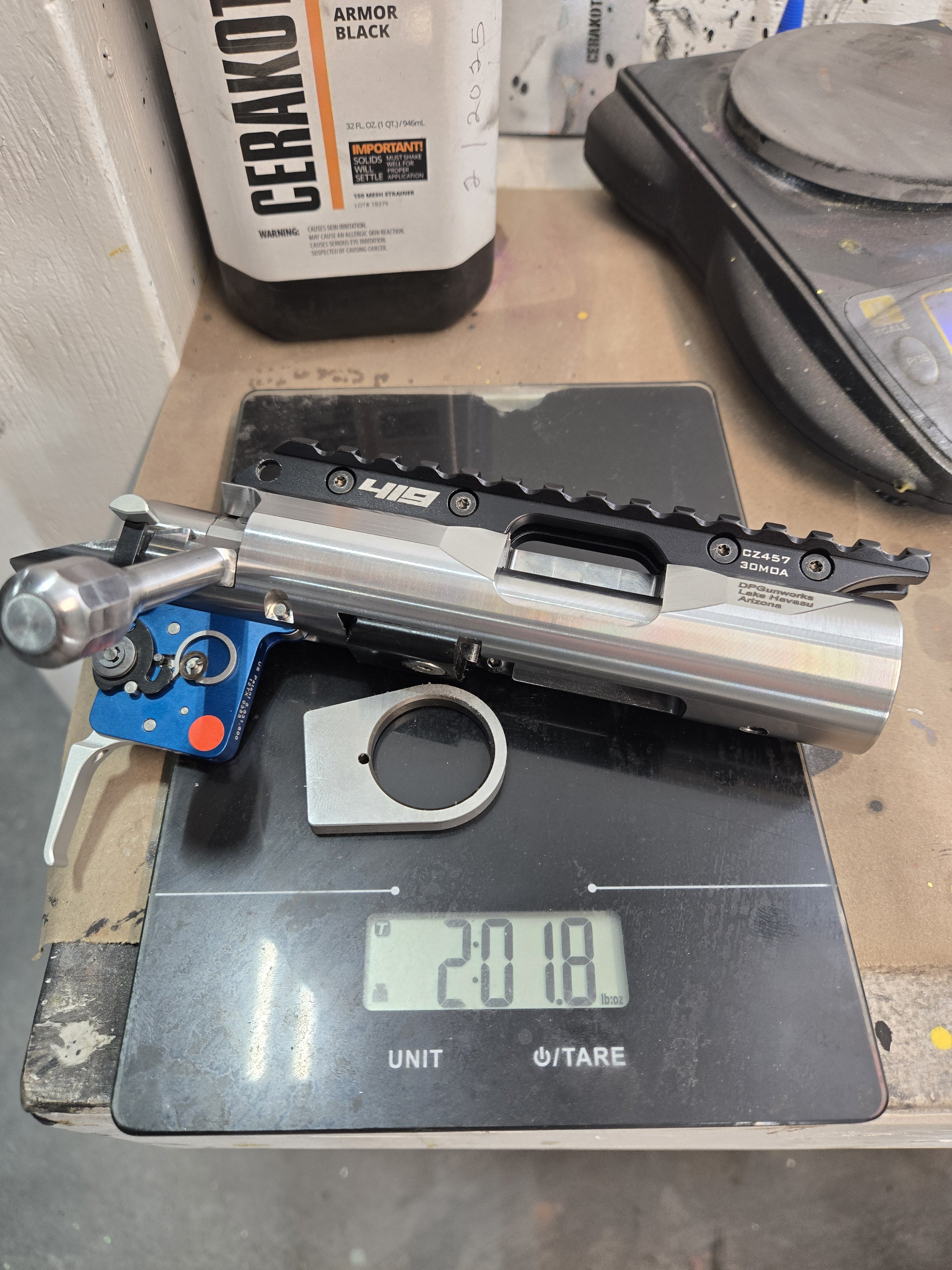

@BillZ All components except accessories attached, Firing pin, springs, extractors will be DLC coated
60 degree bolt throw, technically prefittable due to a certain feature which allows to adjust out tolerances and action tennon threads are timed and mill turned

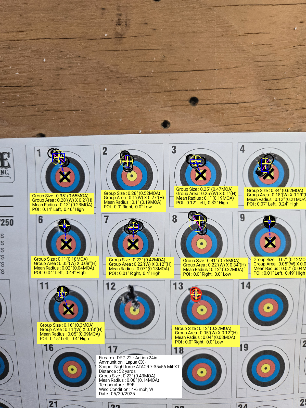

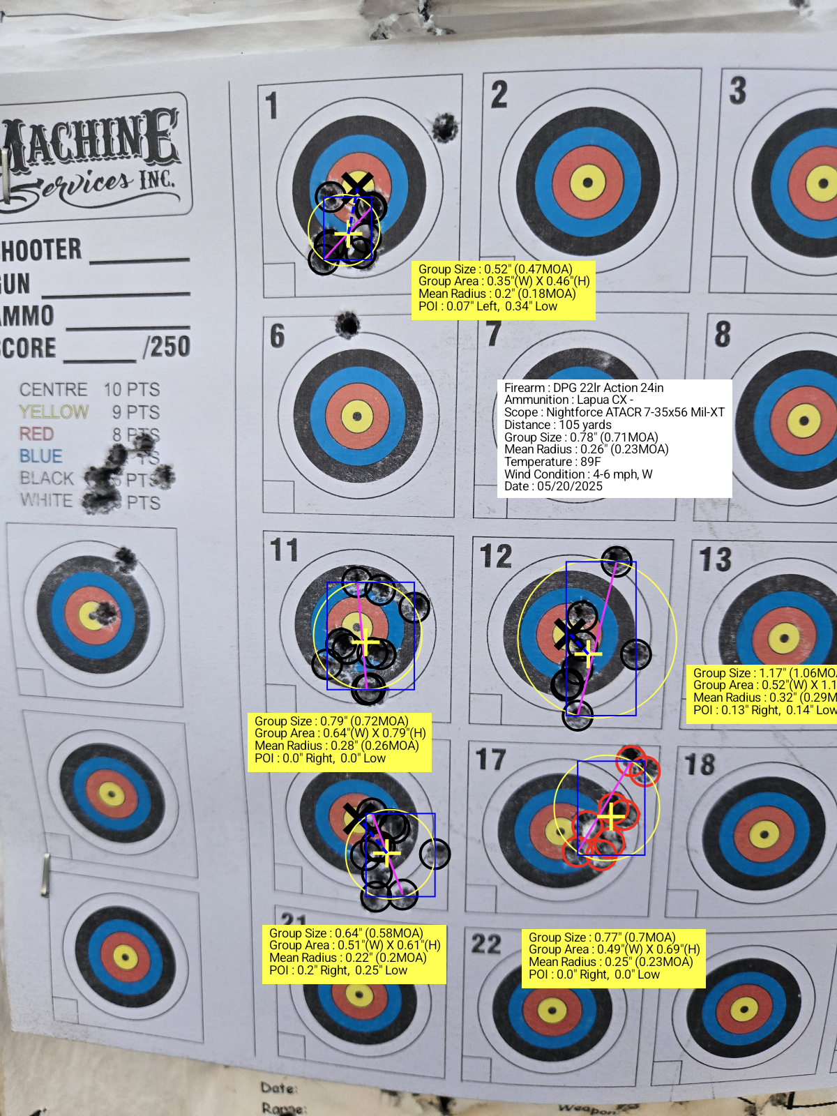

Groups at 50 and 100 meters. First 100 shots View attachment 8692035

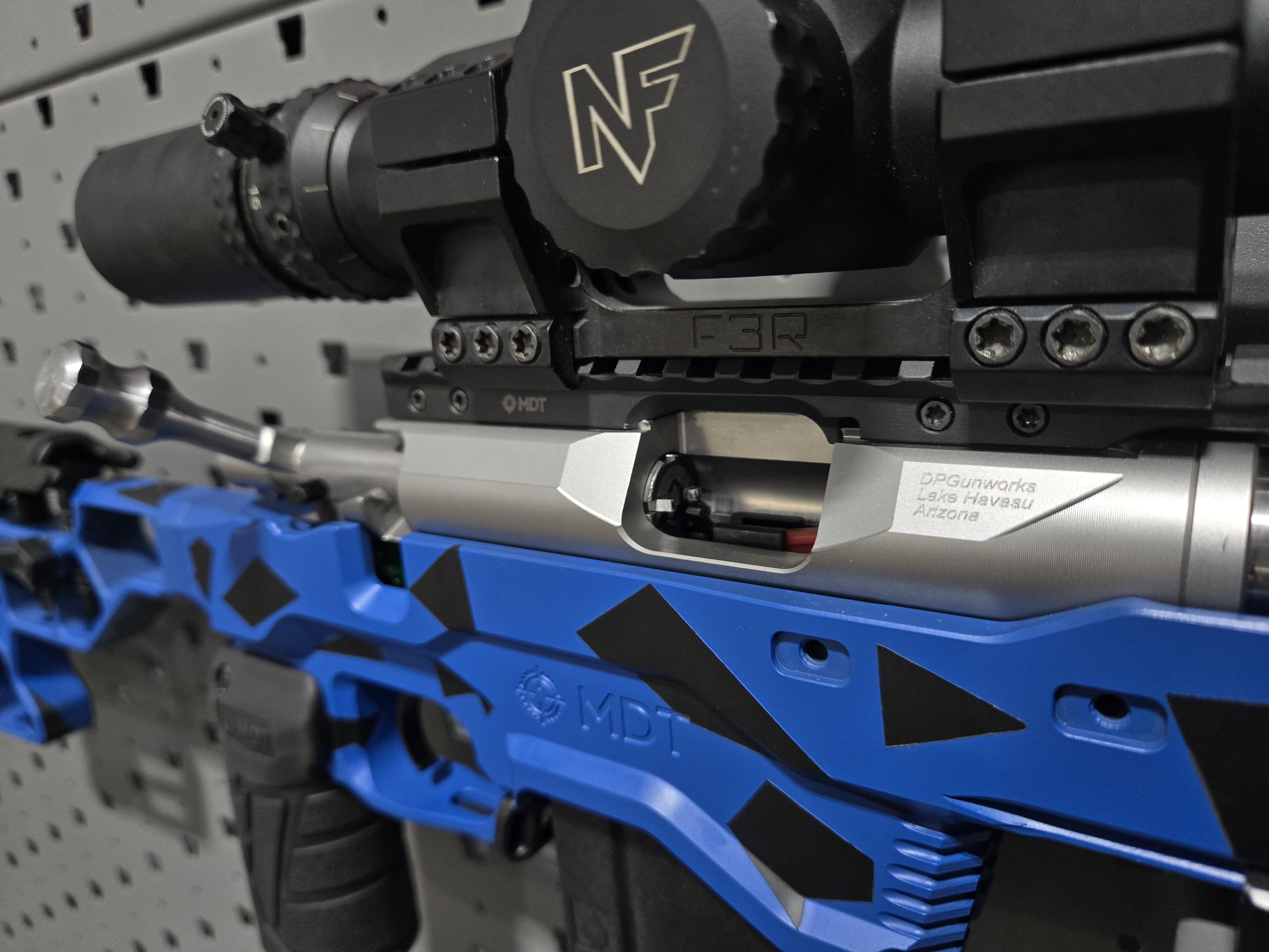

This action has been revised and ball milled to add a super cool feature with the bolt, and is literally riding on ball bearings. Smooth as silk.
Can’t update pics from here in the villa since we’re pretty remote but when I get to Florence tomorrow I’ll try to see if pics will load.

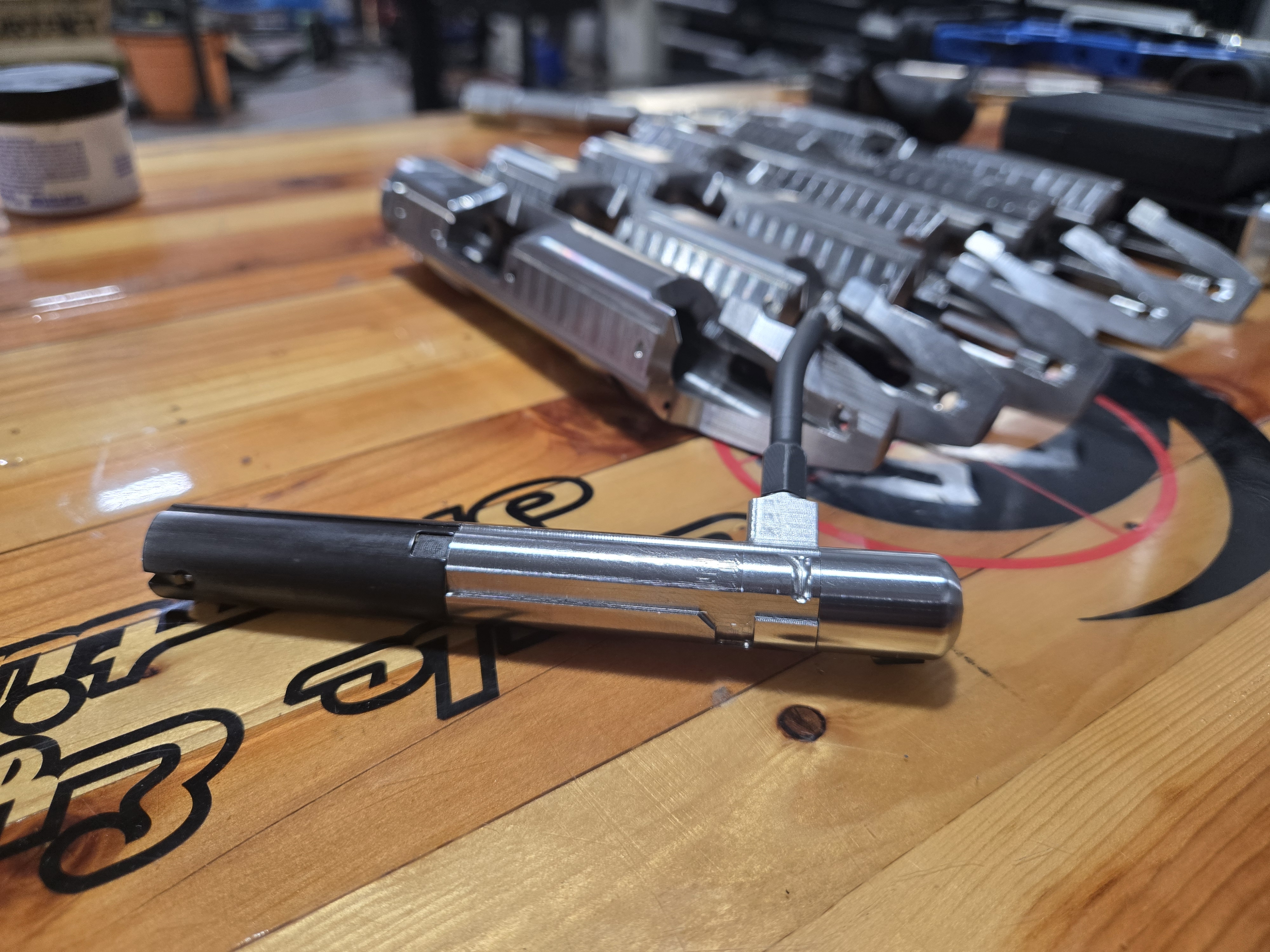

Im ready for production. Got the first 5 rifles ready for T&E. Gravestone match will be the first public hands on.. The bolt head was the last small piece to the puzzle. Just got that dialed in today. These last little implications gave me a pretty high confidence that itll leave a solid first impression with anyone who handles it. All up to my pro shooters to give the thumbs up.
Only part I need to figure out to make in house eventually is the firing pin assembly. Im on the list with the great support @RAVAGE88 MB is giving to support our community. My machine can make the firing pin assembly, but its not proficient unlike a Swiss lathe. I have leads to a good used Tsugammi. But Im about to dropped cash on a Xyil X7 VMC to start making my own Rim-X AICS hybrid metal mags (7075-T6 top half and polymer bottom)

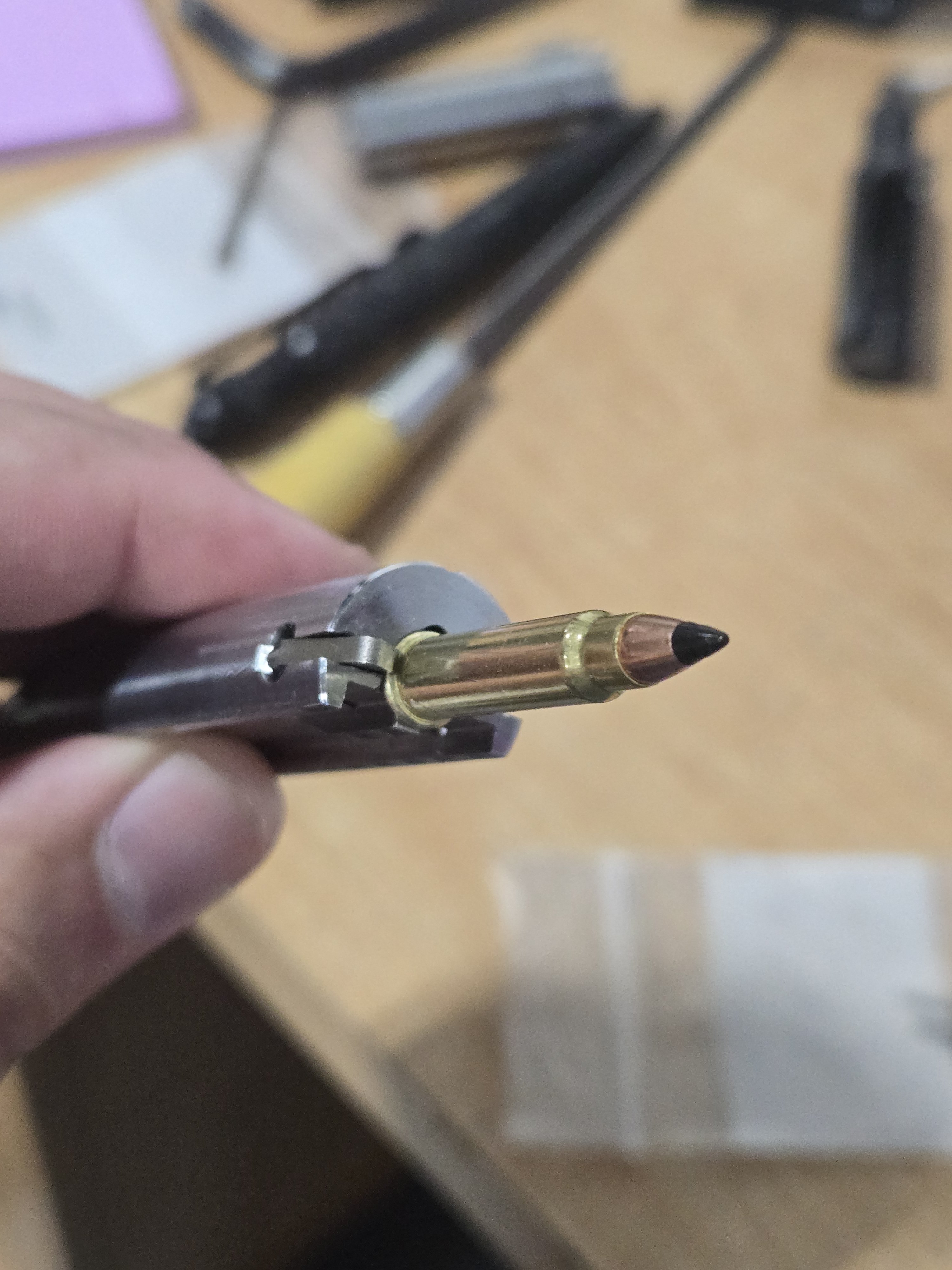

Its not a fixed extractor. It uses a 40x style extractor which I wire edm from S7.
WTO switch lugs do not require torquing the barrel on. They are a tapered lug that the shooter will just need to hand tight a barrel to the shoulder and tighten a T25 torx to 30in lbs

Fully assembled action is just over 2lbs
Barrels can range from 6.5 to 7.5lbs in a 1.20in straight
Action #5 btw.. Bix trigger works flawless. Been gravitating towards a Bix lately
Barrels can range from 6.5 to 7.5lbs in a 1.20in straightView attachment 8697375
Thanks for this Kenny. Is the Bix sear low, med or high? The default shipped is usually medium. I ask since some (early) RIMX needed to have low sear for functionality.
Reactions: EagleEyeShooting
It works with medium and high. Haven't tried a low but my Flavio 0.5oz BR trigger works which says it shouldn't have an issue.
