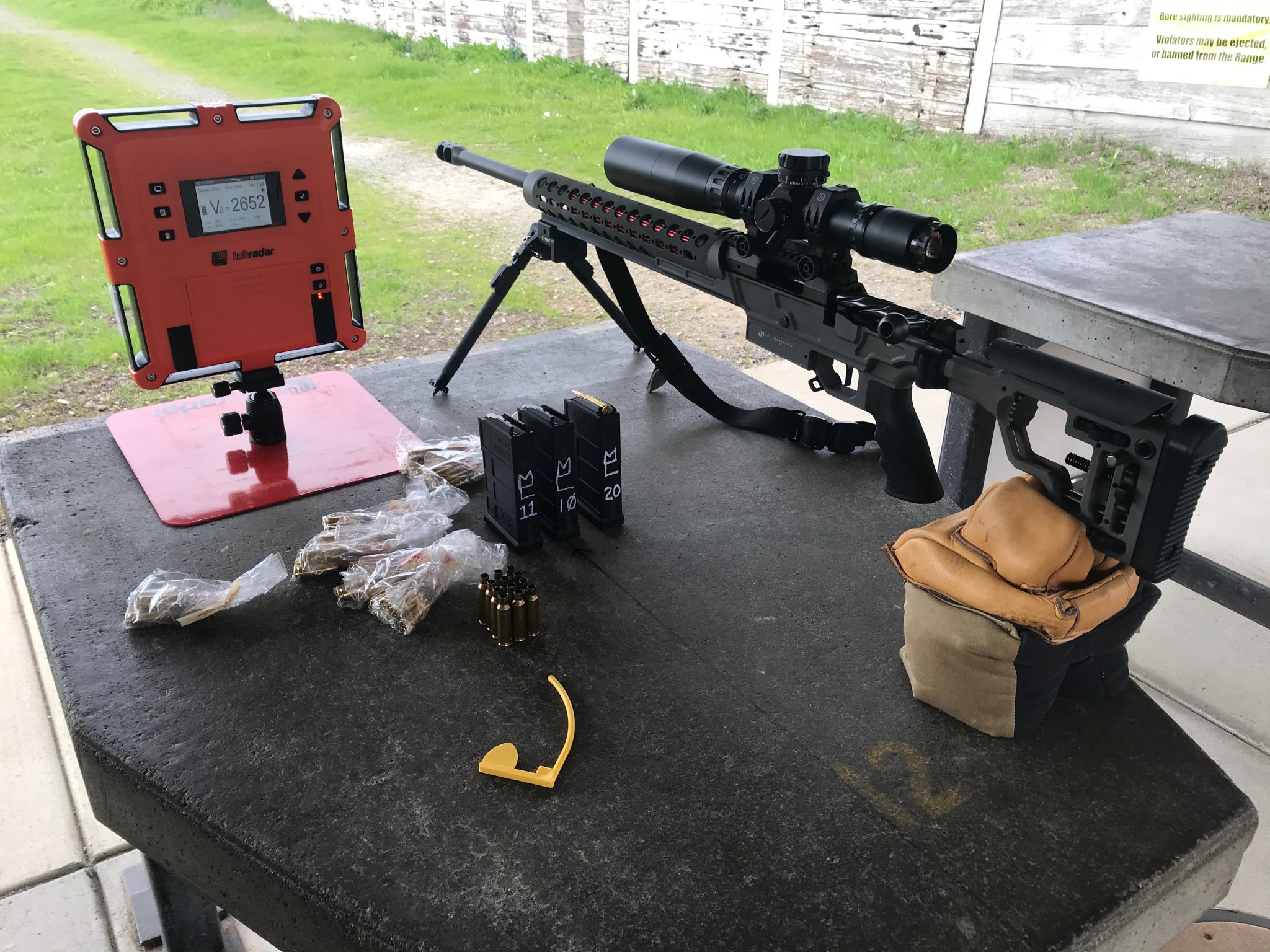

I was shooting my hand loads, Which were:
Lapua Small primer brass
Federal 1205M primers
43.3Gr of H4350
Hornady 135Gr A-tips.

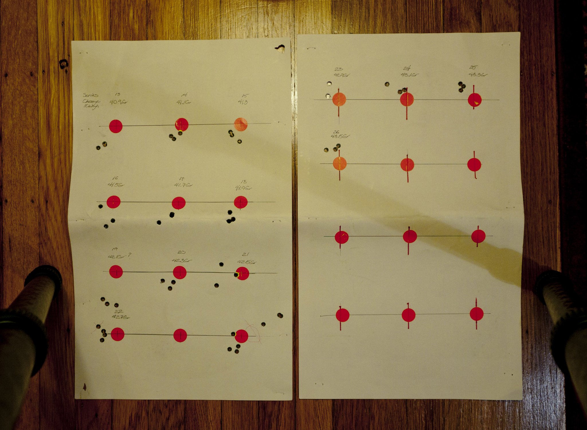

Prior to leaving for this training, I had hoped to be able to do more precise load development but it didn’t quite work out that way. I had a quasi Satterly ladder test set up. That consisted of three rounds each in .2Gr increments from 40.1Gr to 43.5Gr. I chromo’d all of these initial shots and averaged the MV’s.
You can kind of read the charge weight above each dot.

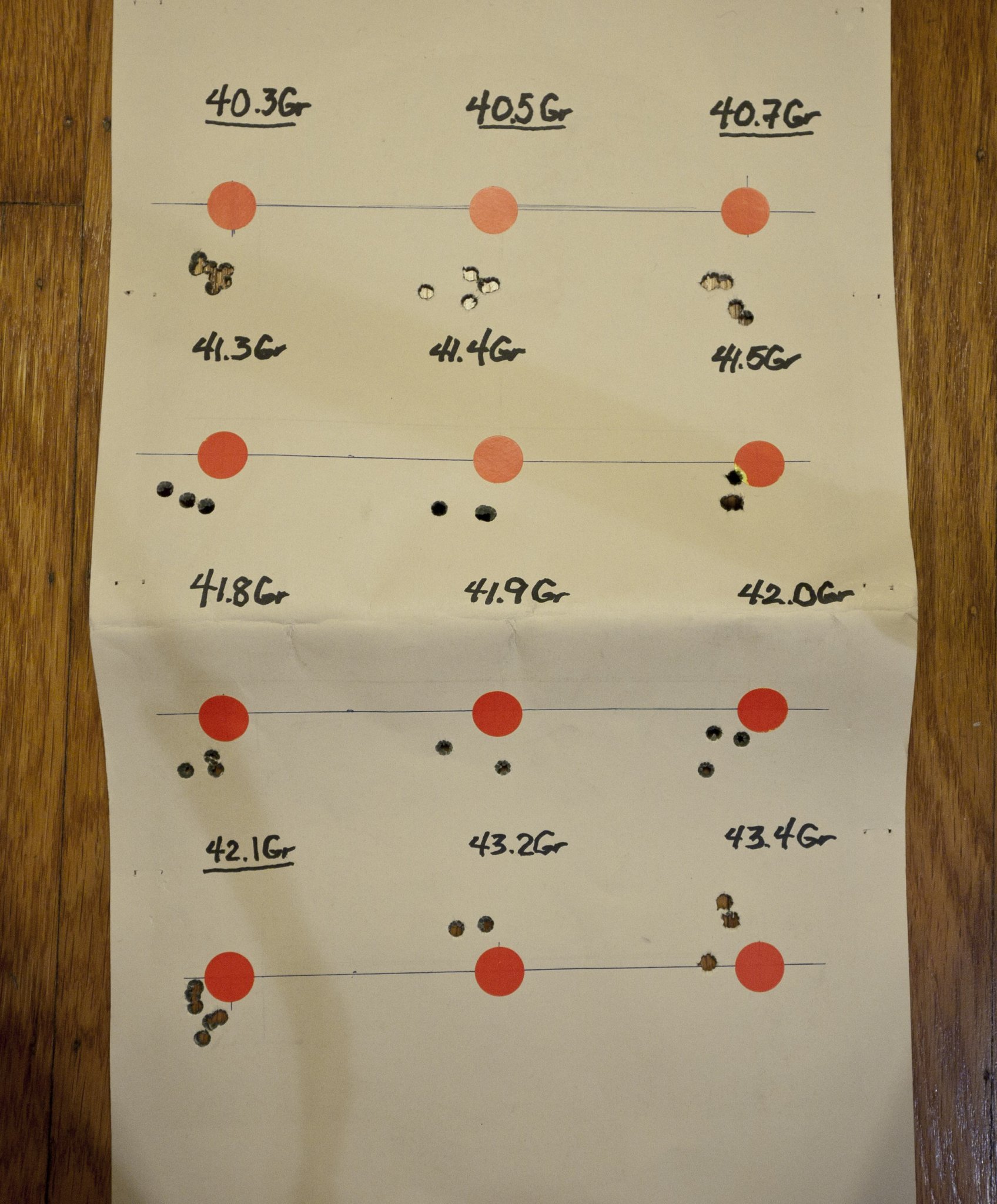

The last target with charge weights written in the easier to read Sharpie, I shot on a second day. Yeah, I screwed that part up.
Based on the groups, which were unfortunately shot on two days that differed wildly in both temperature and RH. But none the less I was able to find I think three nodes.
40.3Gr
41.9 Gr
43.3Gr

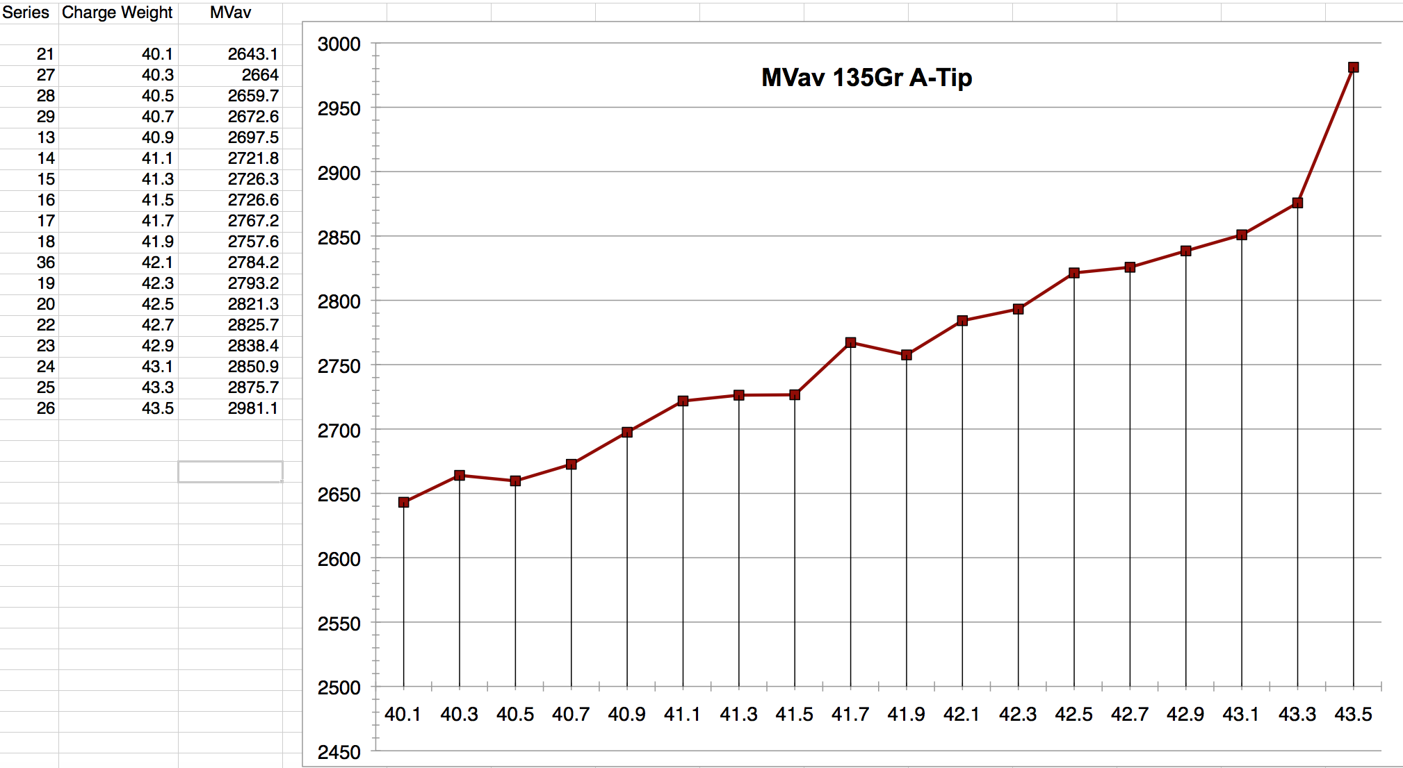

Sadly, I screwed this up and shoot these on two different days. I also forgot my sand sock the first day so the shooting was considerably sloppier. But, what was unequivocally my best group at 43.3Gr was shot that day. So do not take this graph as anything more than data points. Do not correlate any two points or derive any particular trend because of the differing conditions. My bad on that, but data is data.
Something else that seemed to merit noting was how the feel the recoil impulse of the rifle changed. As I got to the hotter ends of the loads, the rifle definitely felt palpably different. On the first day starting at the 43.1Gr charge weight moved more cleanly, more solidly with one consistent recoil impulse. Even the hotter loads I shot the second day, in much colder weather, still made the rifle feel very different in recoil.

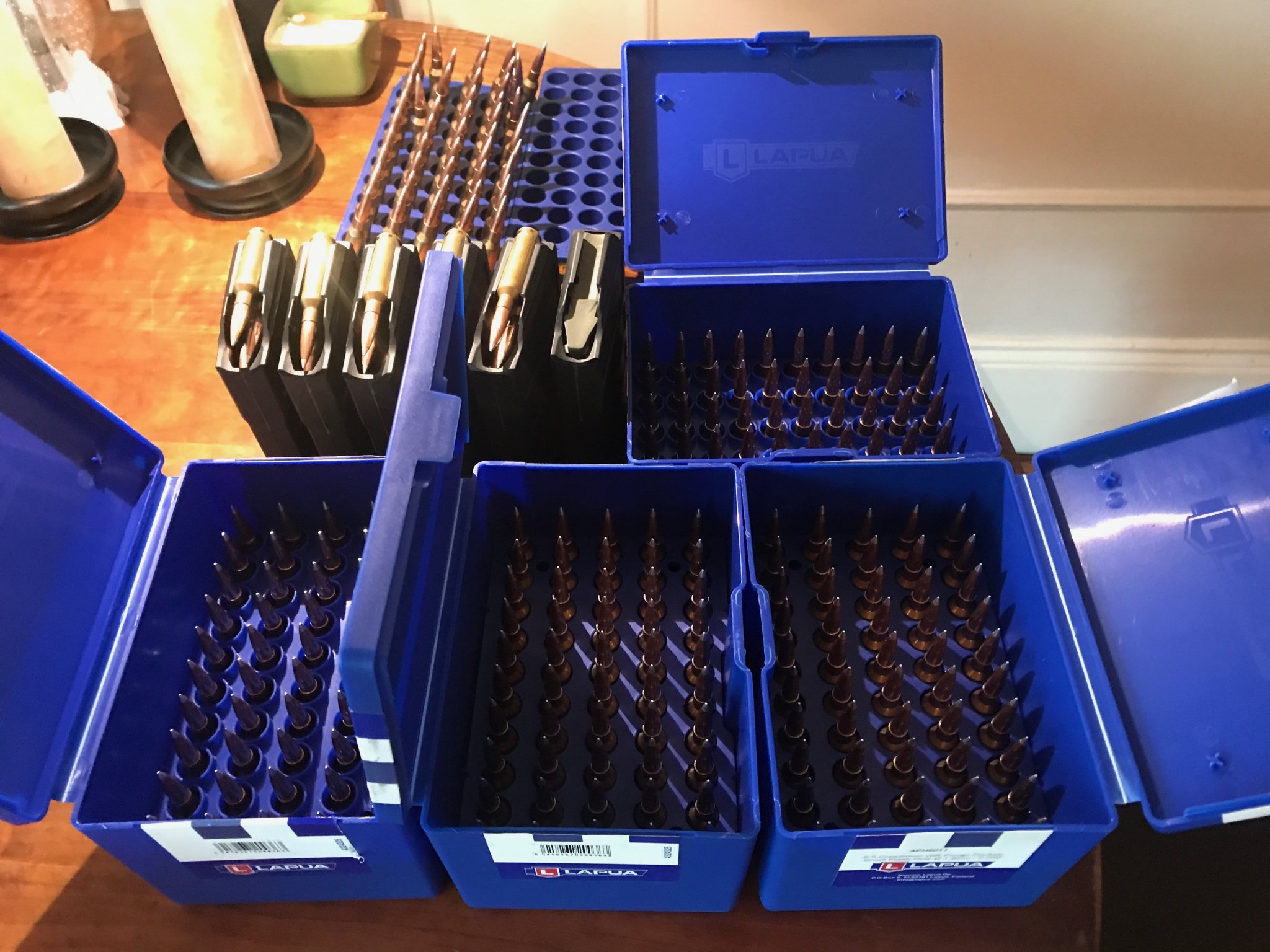

I opted to load the 43..3Gr charge weight to load up the three hundred round the class description said to bring for this training.

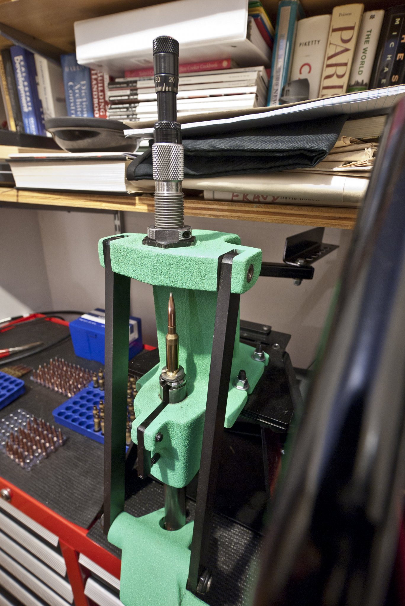

I'm having issues with concentricity. This is mostly because I'm having reach way up into the bottom of the seating die as I'm raising the ram on the Redding Ultrmag press I use for the big rifle rounds. I have to do this, even with the 'VLD' seating stem in the Redding Competition Seating Die. I'm thinking I'm doing something wrong? I'm having to use nylon washers to steady the micrometer seating stem because I am so close to the end of the threads.
I talked to the folks at Redding and they recommended just backing the die further out of the press. Seems simple right? But the net result is that I ruined like three peices of brand new brass and a half dozen bullets thought the course of this process because I didn't guide it up into the seating die and get it centered into the 'VLD' seating stem 'just so'. I also have a hat a dozen rounds that are so visibly out of concentricity that I just pulled the rounds.
