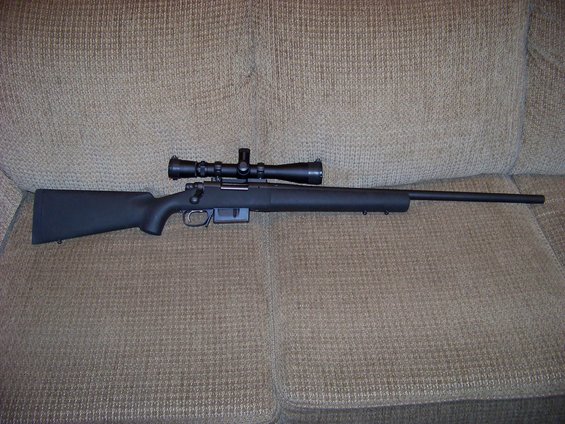

Here is mine with the new scope today.
It still has the same Remington Barrel it came with. Everything else is pretty much changed out though.

Here is mine
I think I should have saved my money up and got a better rifle. It took me two years to find a load that would shoot under one inch at 100 yards with a 5 shot group. But it still shoots and I have fun with it.
